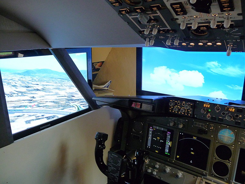

I'm only building a single side cockpit so I don't need a very wide view. I've calculated that with a 50" screen, my screen would be as large as my sim so that would be perfect. And a 50" is high enough to not see the bezels up and down, so my view can perfectly fit between the glareshield and roof of the sim, that already makes the immersion feeling better. This is my setup now with a 32" :
I may use 3 small screens with the triplehead but then I have 3 bezels around the screens + have to buy a triplehead. If I just change to a 50", I don't need to buy anything and the whole front view will be covered.

50 inches of TV real estate can fill up front windows pretty well
Here, the two screens are not even yet close side by side but the effect is real good...
Themax
wow, nice !  :) And I only have to fill 1 front window, I think it will be big enough  :P
