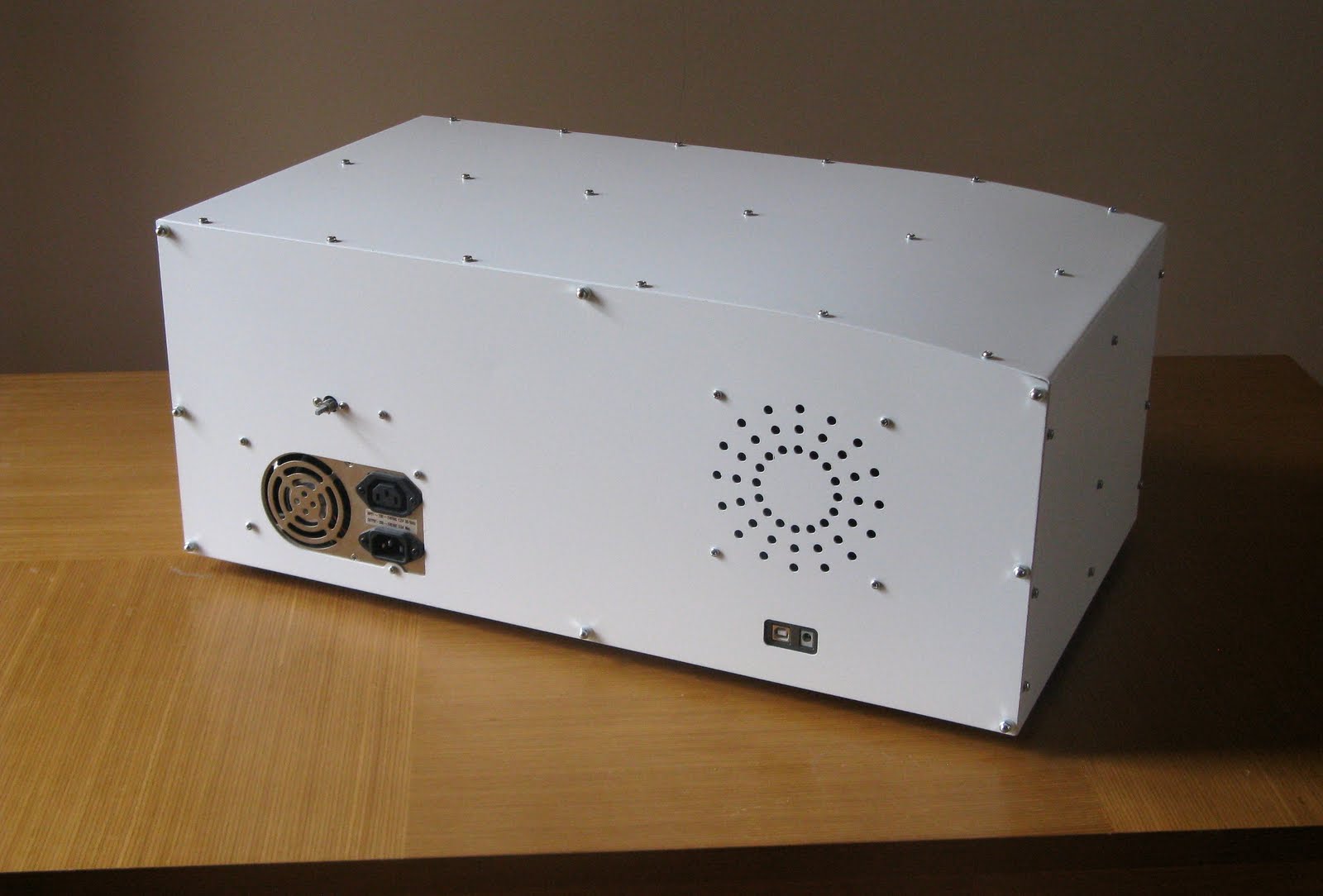

I thought I would move myself out of the "New here? Introduce yourself" section. I'm building a generic flight simulator based on a C172 that targets the 6 primary instruments as well as ignition, lighting and a Saitek radio. I've now assembled the case built out of MDF and threaded rod. This is the bare skeleton that will hold my acrylic panels. Next stage will be to coat it in primer and paint it white. It will then be draped with sheet aluminium, which will be also painted white.

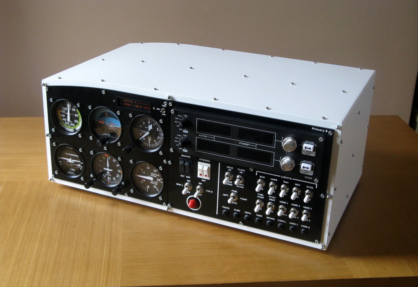

I use simkits instruments for the left hand side so it would be their TRC software that runs all the instruments. I must admit they aren't the smoothest on the planet, but beautifully built and blimey they are very expensive to buy! I have seen a video of GA build (Steve1970 on Mycockpit.org) using a screen for the instruments, which I am guessing is the PMGA software. I envy how smooth they run.

I'm starting to cover the case in 1.2mm sheet aluminium. Once the pieces have been "bolted" to the MDF frame with machine screws it's off to get powder coat painted a nice white colour.
My work collauges keep joking around, saying that I am making a microwave! I have to admit it is rather similar. I'm not sure how well my sim can heat soup though. Perhaps i'll give it a try...  :laugh:

Some updated photos of my project. Aluminium case is almost complete. Just needs to get powder coating and then I have to move onto the wiring and testing....that'll be fun!

Almost complete. Just need to add a couple of decals and I'm done.

Great work. That's going to be a sweet 172 simulator indeed. Will be a lot fun when completed.
For a "microwave oven " it is a very sexy one for sure....very very nice meticulous panel!!!
