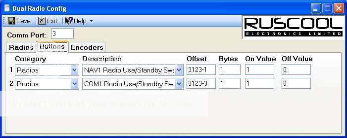

Looking at the radio configuration program from the radio system that my father designed (and from talking to him about it for you), the offsets to use for swapping a tuned standby frequency to an active frequency for the NAV and COM radios is 3123. There are different 'bits' used in this offset for the various functions (e.g. 3123-2 is for NAV2  and 3123-3 is for COM1).
Similarly, the offset for the 'Radio Audio Switches' is 3122 and it uses different 'bits' for each function (e.g. 3122-6 is for COM1)
Here's a screenshot of what the buttons section of his radio configuration looks like.
I hope this helps you out.
