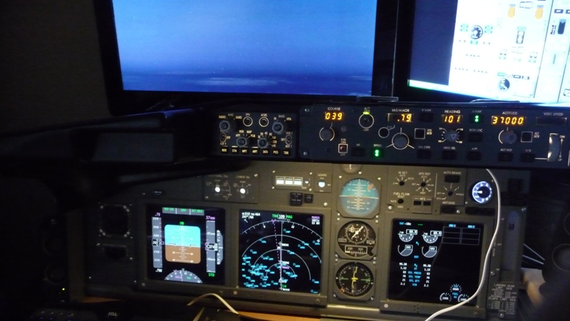

But I don't know why I'm telling all these things ! Let's come back to the virtual aviation, the progress on my 737ng home cockpit  :)
Remember my last update in July : http://www.youtube.com/watch?v=B4N3JbWXQg0

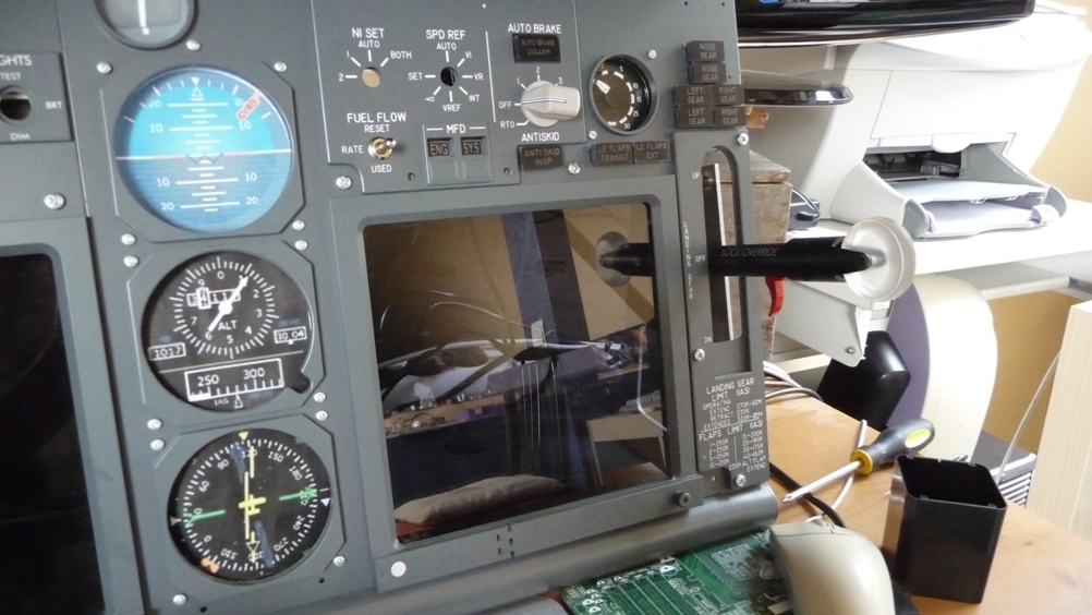

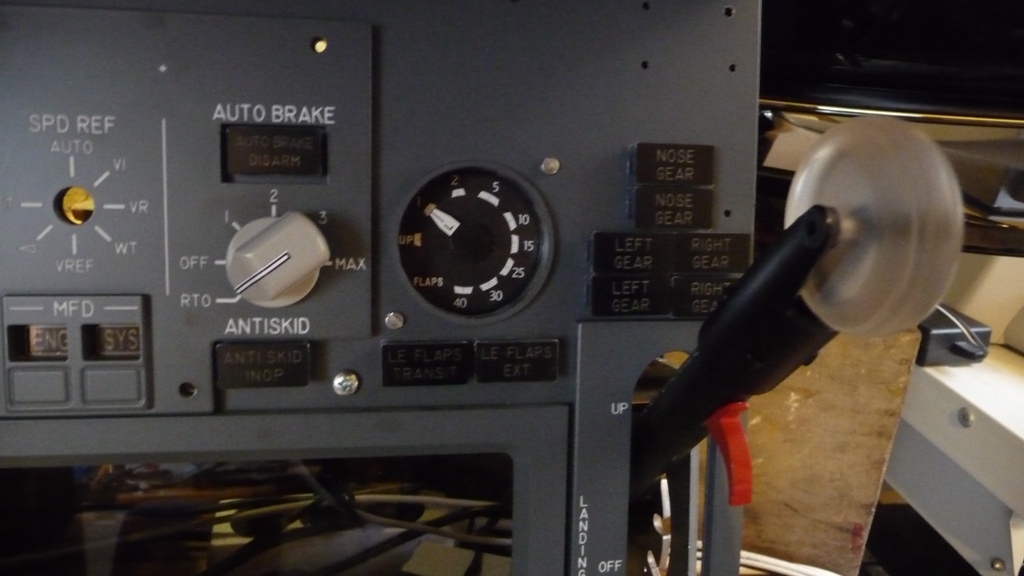

I started to interface the center panel, adding the landing gear lever, flaps gauge from simkits (It's the usb gauge kit, allowing you to build any gauge you want) and starting interfacing the switches (autobrake, etc) and annunciators (landing gear, flaps ext, etc).

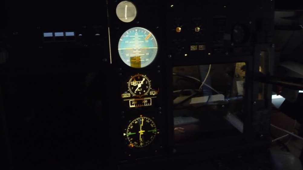

Hi Maxime,
the pics of your HC are indicating that you are a friend of details.
Especially the stand by instrument in the middle. Does the combined altitude and speed indicator really work ? Where did you get it or rather how did you make it ?
Uwe
Themax
Hello,
thank you  ;) For sure I'll enjoy my PPL  :D
It took me 5 minutes to make the standby instruments... because it's just paper  ;) Actually I don't plan to use working standby instruments. In stead of having empty holes in my MIP I printed the 3 standby instruments and put them behind the mip :
I just have to put a light behind it and during night flights the standbys are fully backlighted :
You can see the tape on the standby's but that's because I don't had transparant tape at this moment, but I just have to put them again, that's not a big problem.
Maxime  ;)
