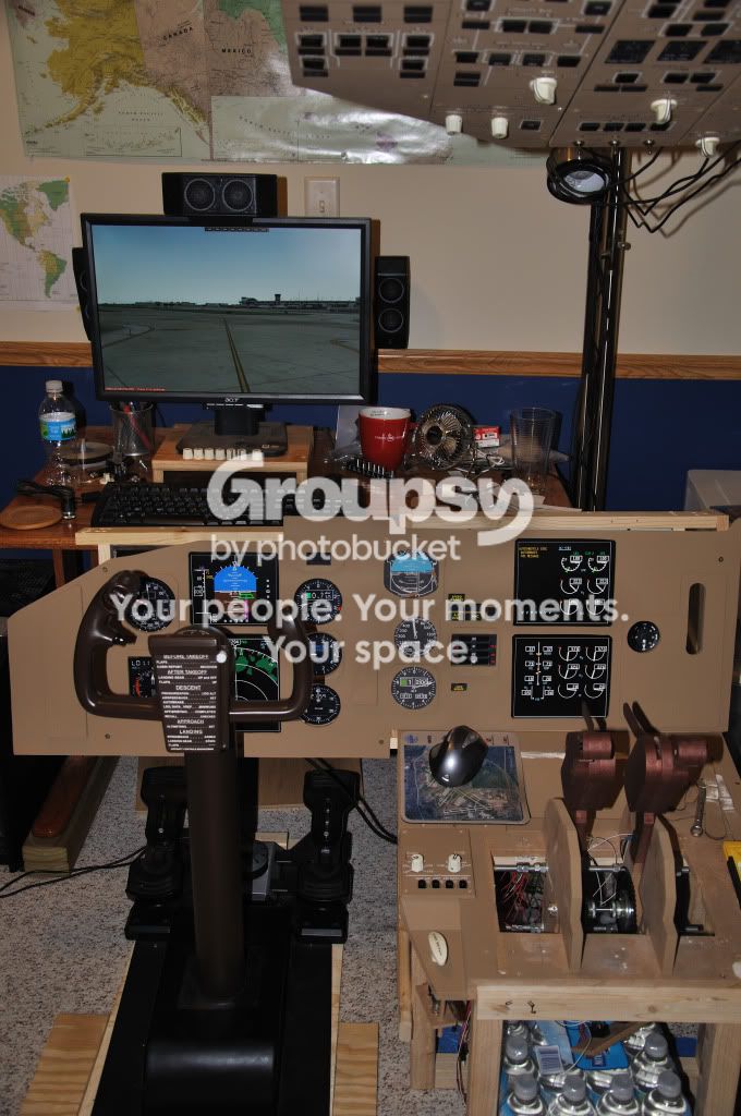

Thought I would share some PRELIMINARY pictures of my 757 MIP... it is by no means complete, I have buttons and switches to add. But this gives a good general idea of what it will look like. Lit up by 2 19" monitors running off my brand new second video card.
Also pictured is my wonderful ACE 757 yoke. Man what a joy it is flying with it. It clearly becomes the focus of all the pictures once you get a glimpse of it!
I am pretty happy with the results. The one problem with using the monitors is that they are not flush with the back of the MFD panel, simply because each monitor has a little bit of depth around the edge with the plastic casing... does anyone know if this plastic frame can be removed without impeding the monitor usage? That way I would be able to have it completely flush with the panel and not have to worry about the little 1/4 inch gap, which makes for slight viewing problems from different angles.
Anyways, feedback, questions and/or suggestions are always welcome!

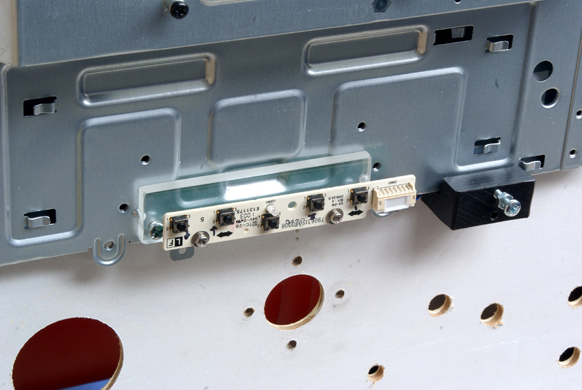

Here is a photo of monitors after the frames are removed that we are using in the Lear 45 MIP.   Take your time removing the frame, check well for hidden screws.  Also removing the frames may void any warranty . . I'm using used monitors so it did not matter.

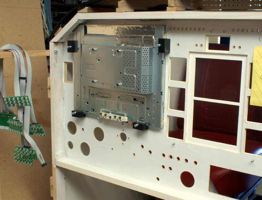

The first photograph shows one of them temporarily fitted in place (or rather precariously balanced!) and the second one shows a small mounting plate that we fitted to the rear, which allows us to still reach the monitor's original controls (contrast etc.) if and when we need to; the cables inside were (just) long enough for us to take the small PCB from the front to the back.

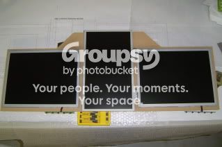

Took the monitors out of their casings today, and it was a snap, literally! Just four screws in the back and a snap on trim in the front and it was all taken care of. Remade the monitor frame holder for the captain's instruments this evening and reinstalled it and the instruments look great! It is amazing what a different it makes having the LCD flat against the panel. Will be reinstalling the EICAS monitor after redoing its frame tomorrow.

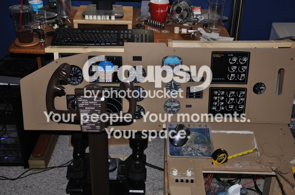

Just wanted to post some updated pictures. I have finished making all the cuts for all the gauges that will be displayed. I have also started adding frames around the gauages to make them look more like the real counterparts (it's kind of hard to see this in the pictures, sorry!). You can also see the throttle levers coming together, pictures of those to follow!
Enjoy.
Matt
