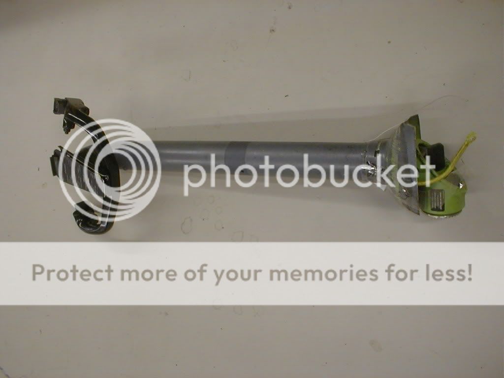

The collumns i have on hand is not cut and maybe that will make the linking easier? I wonder where the yokes sideways movement is coming out of the column. Is it the cross beam it self that actually roll? or is it a rod inside?

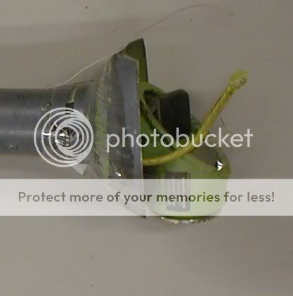

When I asked the seller about this, he wrote: "the internal column moves a tab at the bottom visible in the picture.". Is that the black thingy?
Se the pics:
http://i37.photobucket.com/albums/e55/gosttveit/col1.jpg
http://i37.photobucket.com/albums/e55/gosttveit/col1detail.jpg

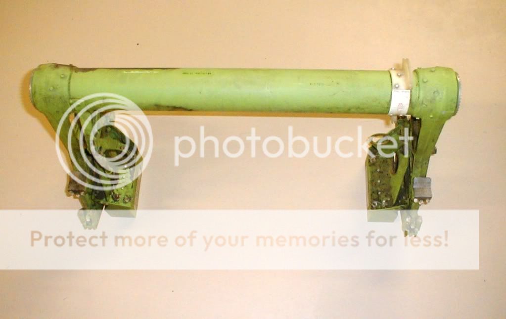

Crossbeam is also available for another 600$, but it seems so frekin' big.
http://i37.photobucket.com/albums/e55/gosttveit/xbeam.jpg
Yes, I guess it was my e-bay auction you just missed. But I see that was a good thing since you will not need those items anymore now that you have real yokes.
Anyway, my yokes were cut just above all the linkages so not too familiar with real assemblies. All I can tell you is that the inner tube rotates when you turn the yoke and I guess that is the black 'thingy' you see at the end.

NAX228 :
You have the priviledge of having the yokes and columns complete ..... don't cut away anything - you even seem to have the tube that connects the 2 yokes.
If you rotate the yokes to the left and right, you will see that the black part on the bottom (the slider) also rotates. This slider goes into it's counter-slider which is "U" shaped and which is attached to a roll from which pulley cables go to the roll of the other yoke. This way both yokes are linked and absorb the elevator movement of the columns.
