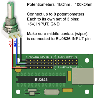

Tried to wire up a 10k pot.  Left and right stubs to 5v and ground.  Middle stub to input.  No luck.  Tried all the axis (X-RZ)...nothing.  Wired it up to the hat switch connections and the pot rotated the view so I know the pot works.
Any suggestions?  Am I doing something wrong?

Isn't that for rotary encoders?  The BU0836X board has 8 analog inputs (3 connections for each; axis, 5v and ground) so that's where I hooked up the pot.

Well according to the diagram on Leo's site you only have to connect up the pots to the three connectors.
I know that is for another board but it's the same chip and the pots on his site are 10k ohms as well...

OK, I managed to find an old pot and hooked it up to the X axis on the interface. I then plugged the interface into the PC and VOILA... on the game controller page the X axis has now appeared and it available for calibration.
Seems that you need to connect the pot up and then connect the interface via the USB for the axis to appear.

I don't know if it's any help but this is from Leo's website. I found it in my documents.
Construction tips
•What to do with unused inputs?
?Unconnected buttons will appear as not pressed - just ignore them
?Unused analog inputs are automatically disabled. They will reappear as soon pots are connected and BU0836A is powered up. In other words, if they are not connected - you will not see them
•Which pots are the best?
?Any value from 1kOhm to 100kOhm will work fine. If you don't know where to start, get 10kOhm ones
?Use linear pots (taper B.) Avoid non-linear, log pots with tapers A, D or Y used in audio level controls
?Any pot will work but the best ones are industrial quality from Spectrol (Vishay) and Bourns. They have life expectancy of few million shaft revolutions. I keep a small stock - please email me for information.
?Good wiring helps! For ultimately clean signal don't share +5V and GND signals between pots. Connect each pot with its own set of three wires.
?If you can vary your mechanical construction try to use as much of pot travel range as possible.
