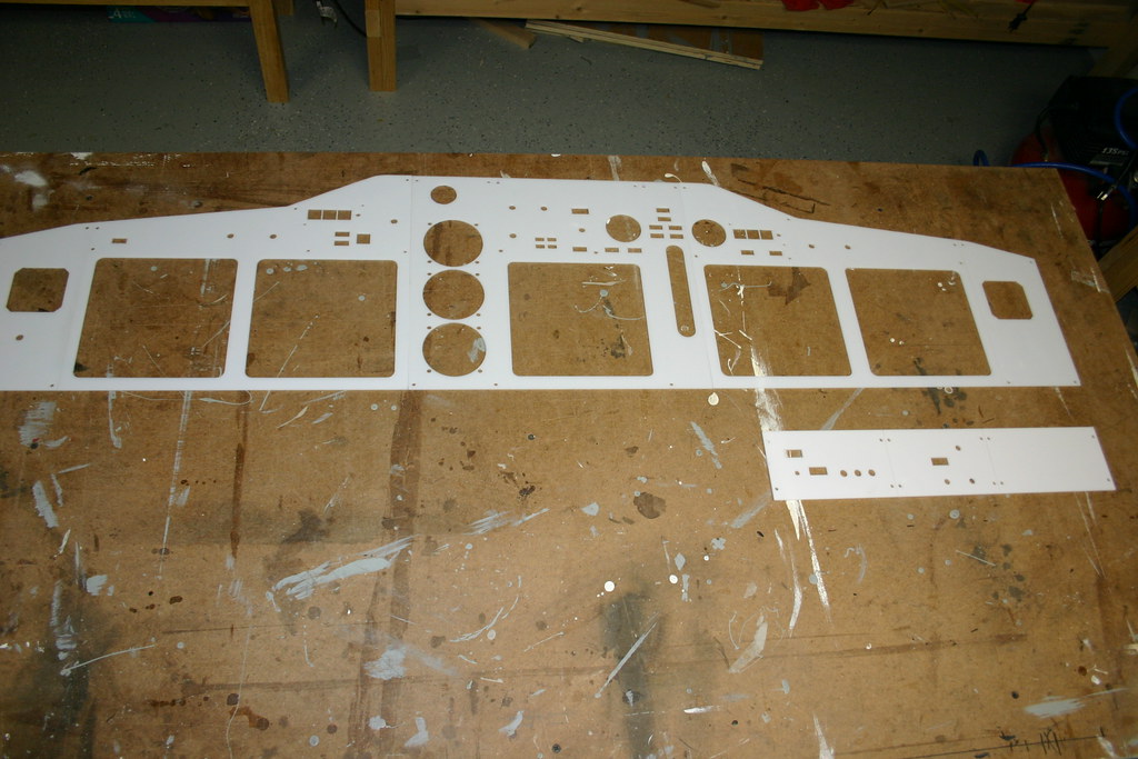

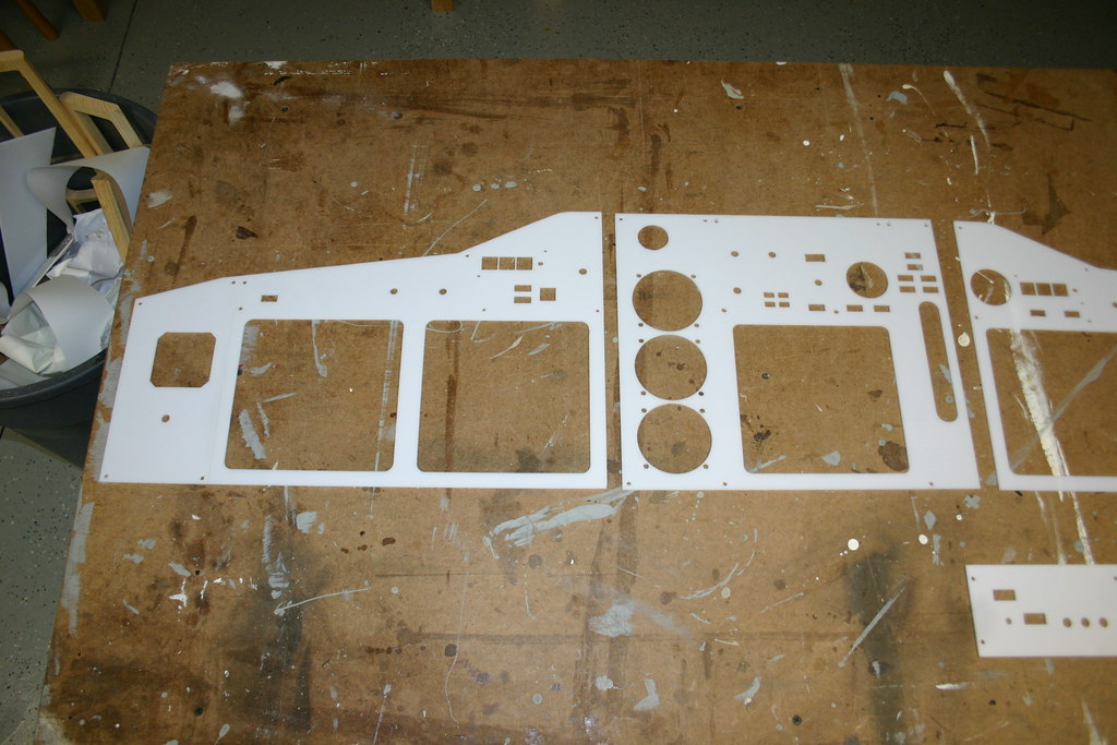

Well after a lot of .dxf cleanup and cad work (with a great deal of help from my close friend Vince in Italy) I was able to cutout my MIP panels and my right lower backer panel on the cnc last night out of 3mm poly.    I am really happy with the result.   Today I will finish left lower backers and start cutting the DU bezels for the MIP and also start building the MIP framework out of plywood.    I plan on building as much as I can and buying what I can't build or dont want to.  In this way I hope to have a little part of me in my sim rather than all bought.  Thats half the fun after all aint it? :)
Here are some pics so far...

Wow, those panels look great, great work on the CNC. Those are going to look really nice, what material did you use?

These are made of 3mm Poly.   I will be making all the front panels out of 6mm Acrylic but I had this poly laying around so decided to use it.  It is stronger than the acylic and often used for outdoor signs.

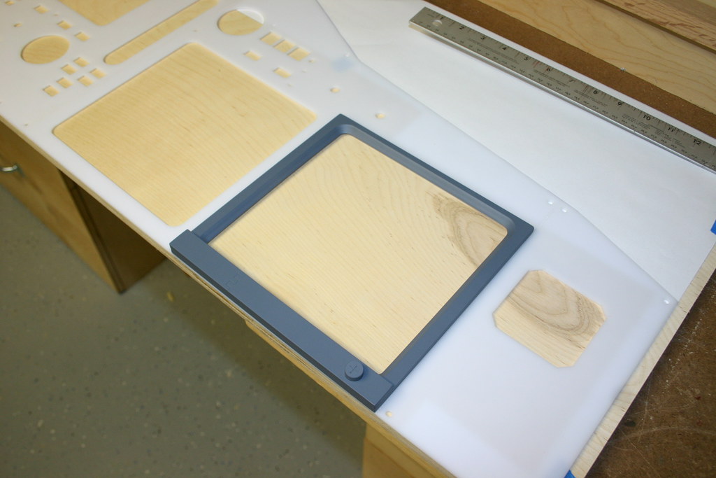

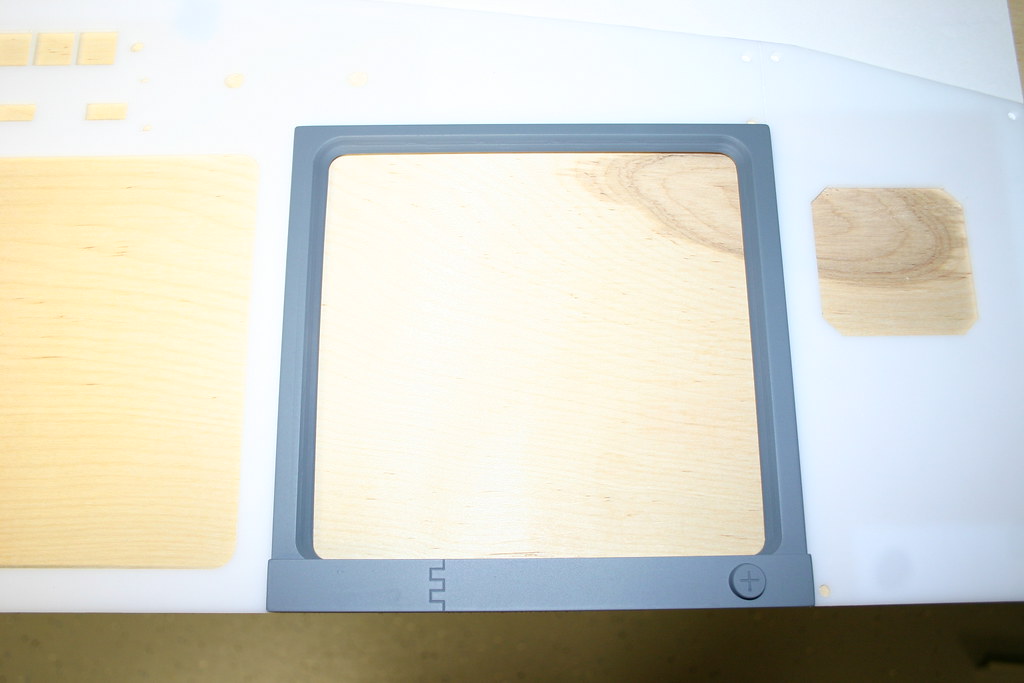

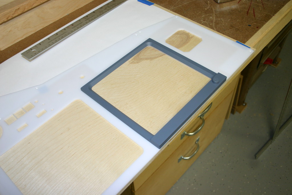

Here is what I got done last night.    This is my first "prototype" DU Bezel.   Made this on my cnc in three parts.   I have a little sanding to do on the bezel and have to adjust my gcode a little for the rest of them but I think for a first one this turned out pretty good.    Sometimes it is hard to do all this when I know there are plenty options out there to quickly buy but this sure is fun and like I said, it will have a little of my personal touch in the mip.   Again I must also give credit to my friend Vince in Italy for helping me create toolpaths to cut that bevel properly around the inside.  Vince is a cam wizard.   For those of you that don't know Vince please allow me to introduce you.   See his work on his blog at http://www.learjet45.info
Also thank you to Phil for providing dimensional drawings.
NICE JOB!!!  Those look incredible..  I am looking forward to seeing more.
Very nice work there. They look just like real to me :)
Very very nice, while you are at it, cut as many as you can, pretty sure you will find interested builders!

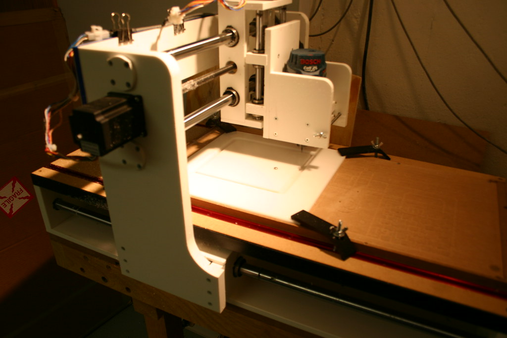

I have a unit I bought from a guy on Ebay.  It is called a "Masters CNC" and is pretty basic but works like a charm.  It is a 2'x4'x3" capacity so great for cockpit stuff.    The 737 Mip panels were challenging because my cnc was not big enought so I actually cut everything within range then finish the tops on a scroll saw.   Everything else I need to build I think will fit fine though.

Here is my CNC working hard cutting another DU Bezel..
Here is my current run of DU Bezels..4 down 2 to go.....  (I modified them after the first to have the bottom latch panel look more realistic.

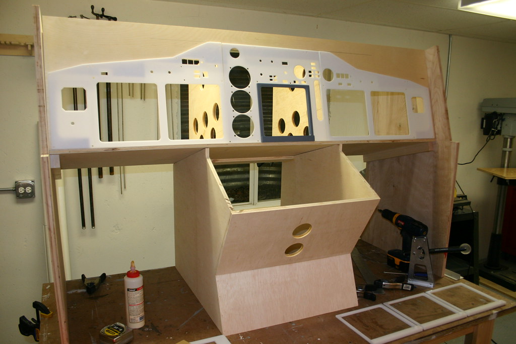

Here you see the progress on my MIP.  Found some good examples out there and some drawings that have helped.  I am pleased with the way it is coming together.  Of course everything is just sitting loosly right now as I fit more pieces.

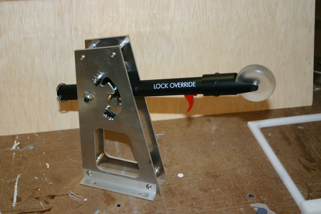

Here is the superb Open Cockpits Gear Handle.  Nicely detailed and strong feeling.   Great price.
