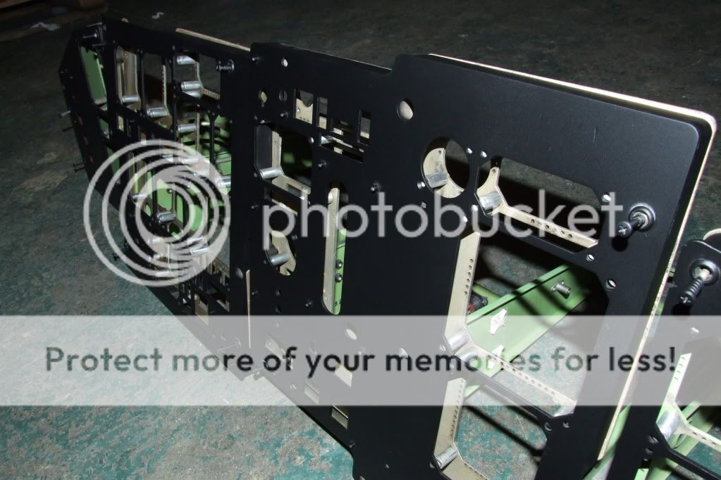

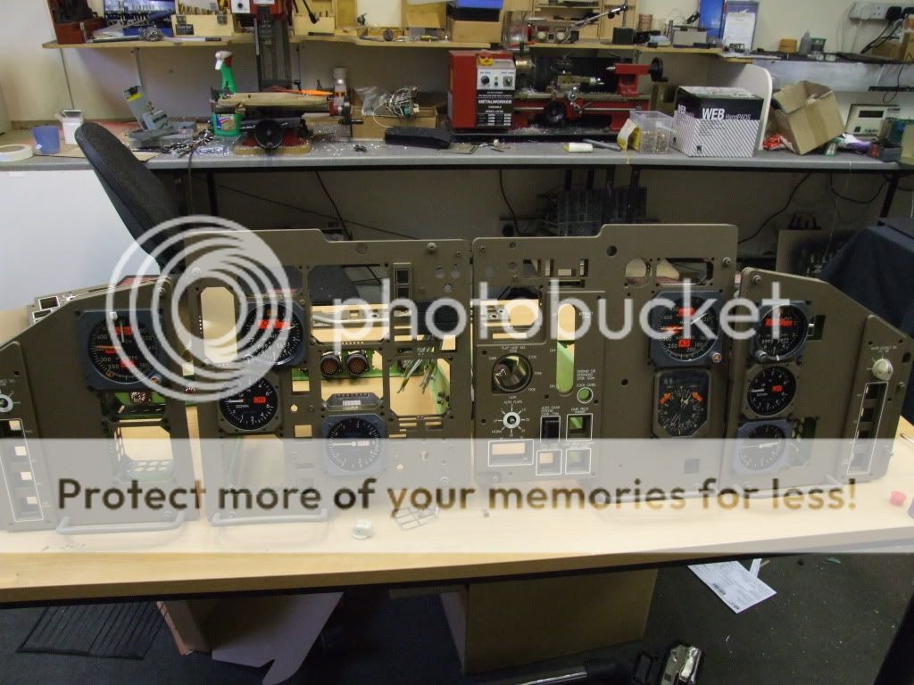

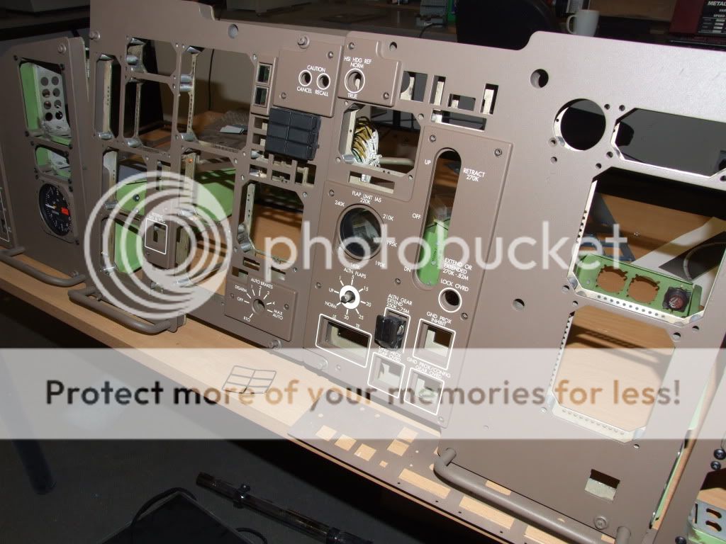

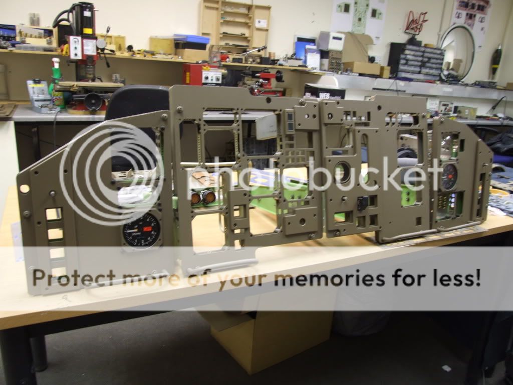

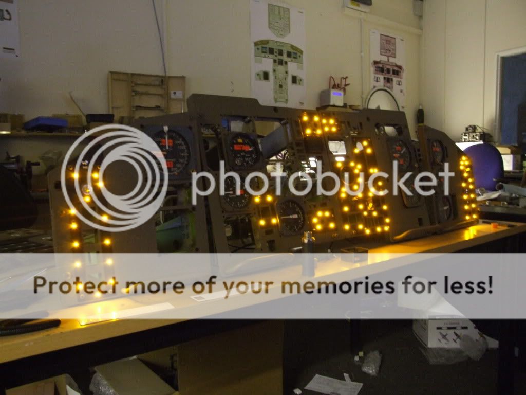

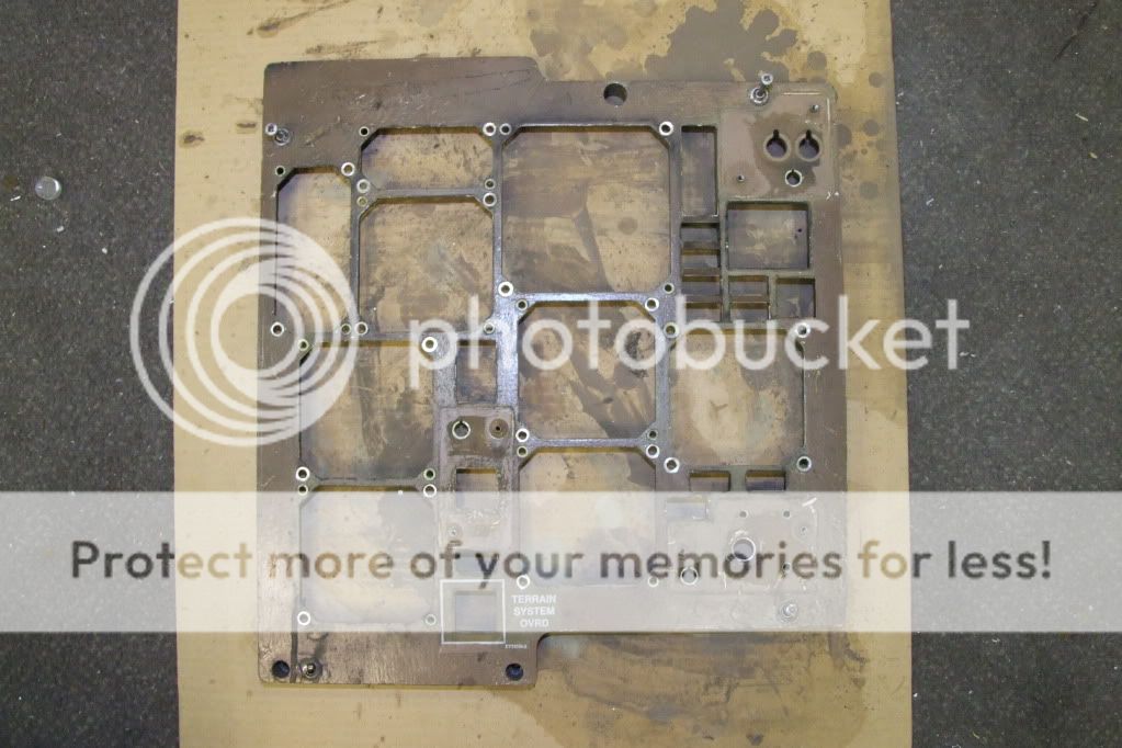

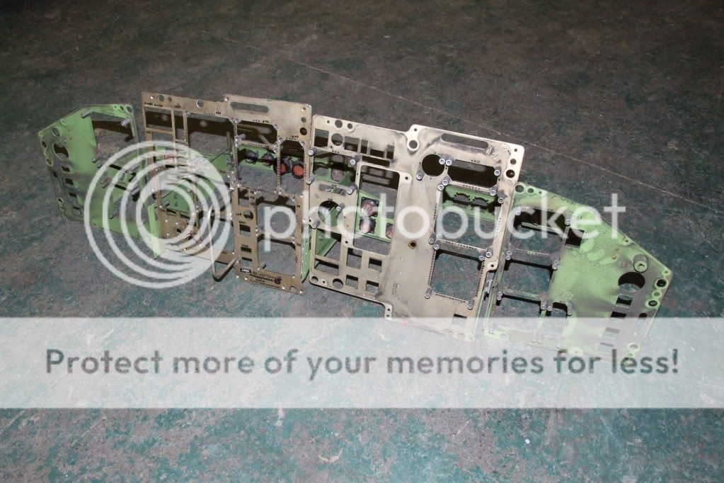

Had a bit of time to myself recently, rare occurrence I know so decided to bite the bullet and make a start with my build, there is only so much planning and approaching the challenge with a level mind and mapping things out but the more I look into it the more questions I come up with, so I decided to throw caution to the wind and get my finger out and finally make a start!!
So... where to start? Well the only main part I got is the MIP, its not from the same aircraft, I know the main CAPT and FO came from N307AA as for the two outer pieces I have no idea, so nothing matches up, but be honest who cares, it adds a bit of character to it, because several airplanes have already laid down there lives to build this sim nothing matches up, colour,  instrument config, and not to mention the fact this is from a 20 year old airplane so its not in the best condition, infact its disgusting if im honest, yeah I would like to keep the used feel about it, but I just cant live with the condition of this thing, so best route it a complete restoration, strip it sand it and re paint it, so this is what I did.

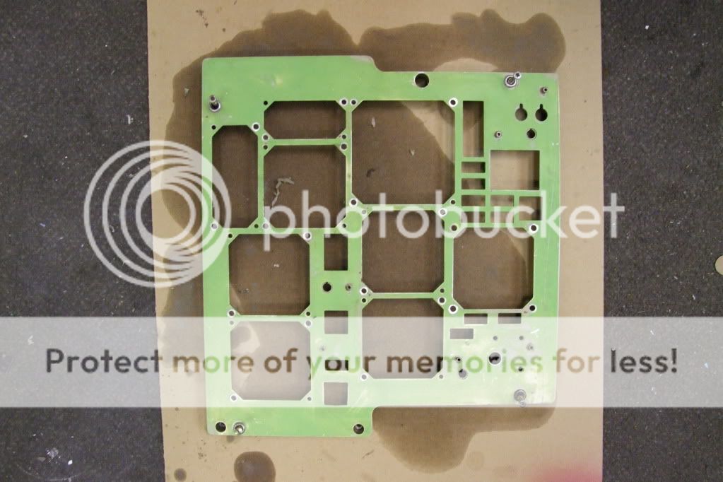

Apologies but I have not got the original pictures at hand showing the before condition, then you can appreciate how minging this thing was, but I will upload those later, I stripped the paint of using cellulose thinners, I found out just by chance here that it would melt away the original top coat but leave the green primer intact, I wanted to keep that as over the year when things get chipped and scratches it exposes the green primer and just adds to the overall realism, tricky stuff like round the panel dzus fasteners I sandblasted then applied a coat of 2K acid etch primer because of the bare metal, then a coat of matt black, reason for this is that's how I will make the panels for it, and the undercoat has an effect on the outcome of the colour on brown (not noticeable on 737 and A320 grey colours) hence the stealth MIP (I actually preferred that and for a moment thought about following Kens approach of changing the entire colour of the flight deck to suit personal tastes, I admit the brown can be hard on the eye, but a 75 in black?  Managed to find a real bargain on eBay, matched set of new VSI gauges paid 25 US for the pair, a quick coat of baby poo brown and they look the part, something else to interface later.
As for the panels I was in two minds, restore the originals or just make a new set, had a good look over the originals and there in such bad condition even I cant repair them, so best bet was to make a new set entirely from scratch, and lets be honest I have been making panels for such a long time may as well build some for myself, also because im using LED's it means that everything will match up in the long run, and I know a few people have been after 75/76 MIP panels so did a small run of them, but here is the semi finished MIP
Next job now apart from from the MIP re build is make small PCB boards that convert the annunciators to run off 5V and are LED driven to make as much of the electrical system run at the same Voltage, machine the engine select panel, engine standby gauges and the ISIS gauge, the 2 autoland panels, this is going to be fun :)
But, finally i have made a start, long way to go yet though :)

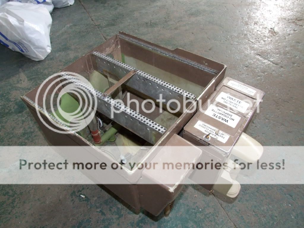

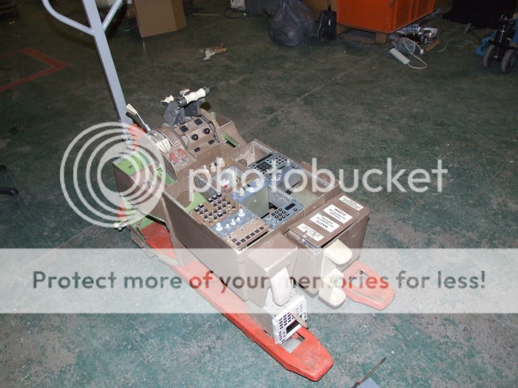

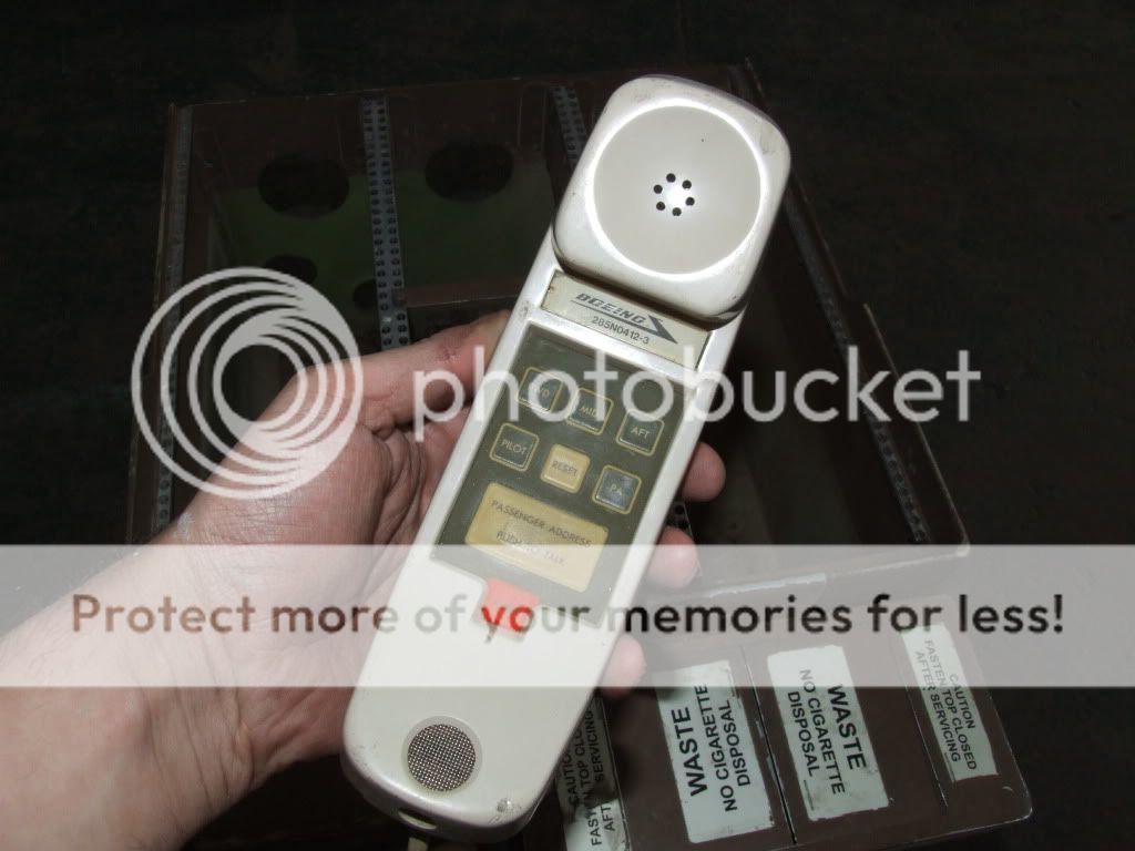

Anyhow, a rather large box arrived on Friday! yup the ped box arrived, even has the phone :)

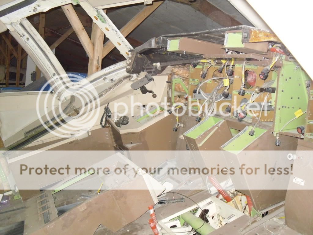

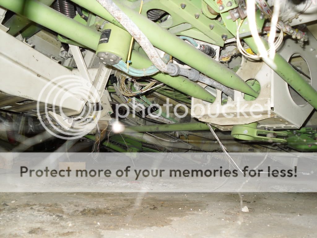

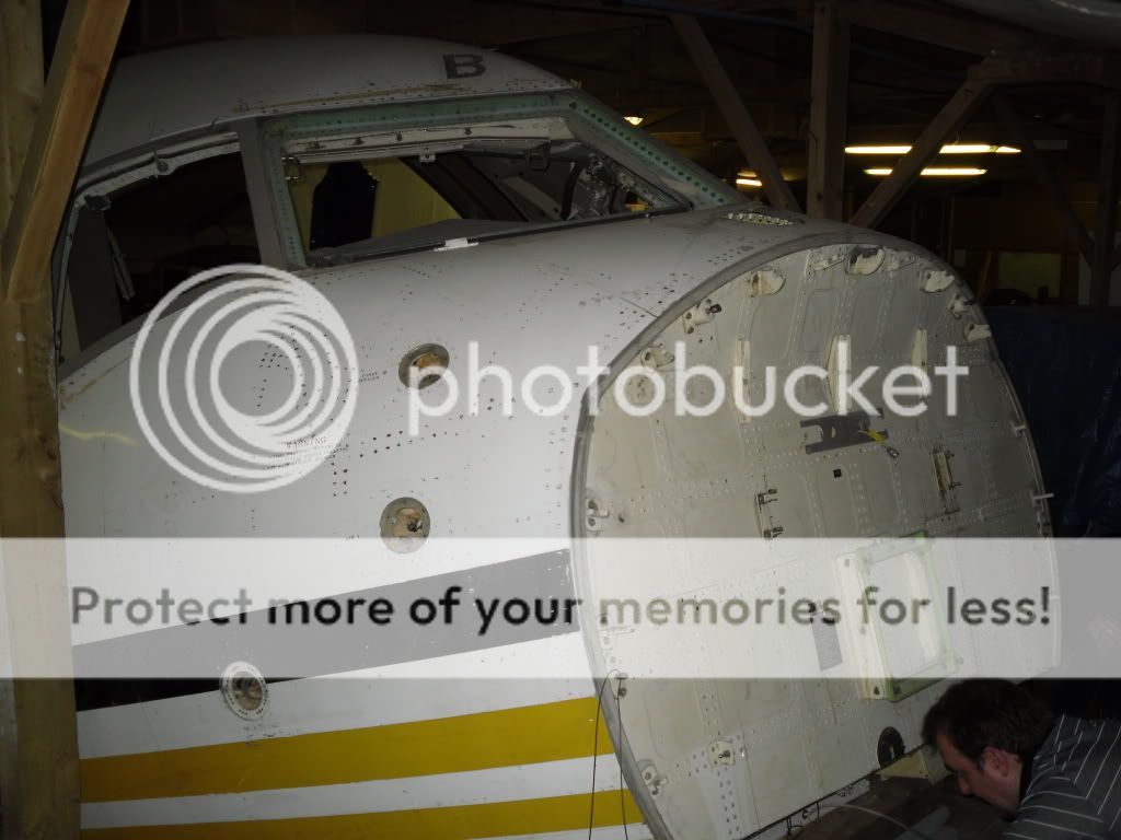

And today's little mission, 700 mile round trip to go and measure up the nose and make a plan on how the hell i get it back here, but we think we have it sorted, so here is some pics of my baby, V8-RBA, former royal brunei 757-200, the first large jet for royal brunei and this jet certainly put them on the map, so a lot of history behind her, okay its missing a lot but considering how i obtained her its a true bargain, its got everything i cant make and more, and under the floor the important mechanical stuff is the cleanest i hae seen, anyhow enjoy the pictures :)

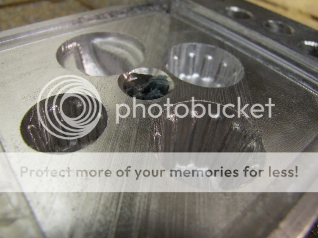

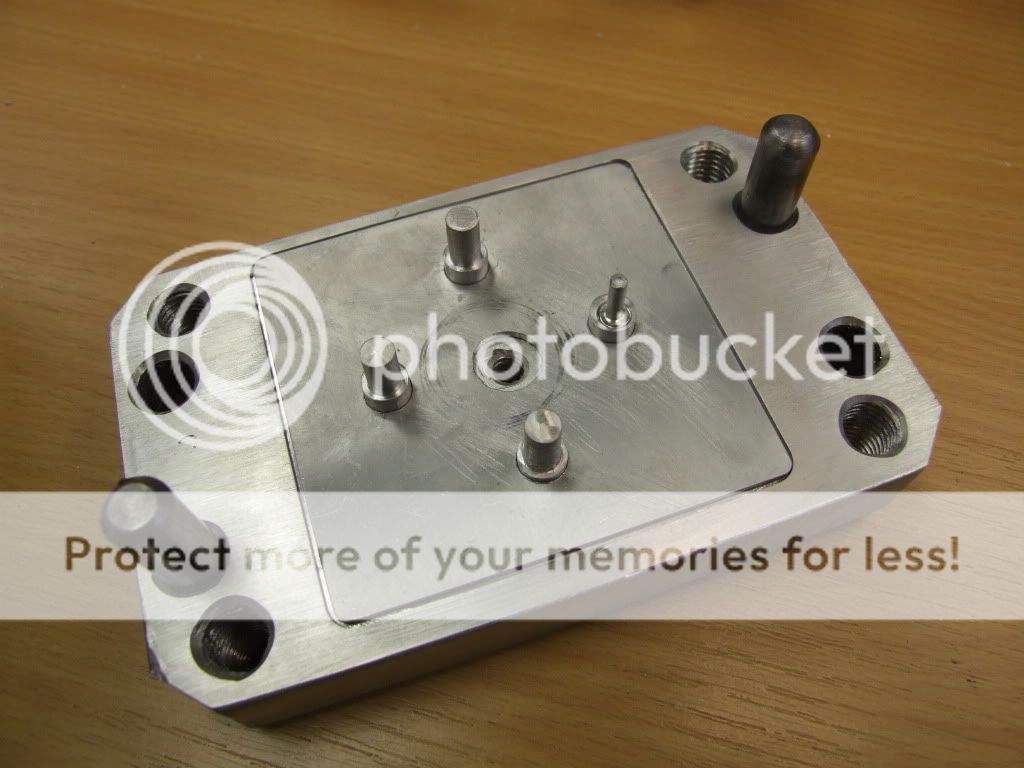

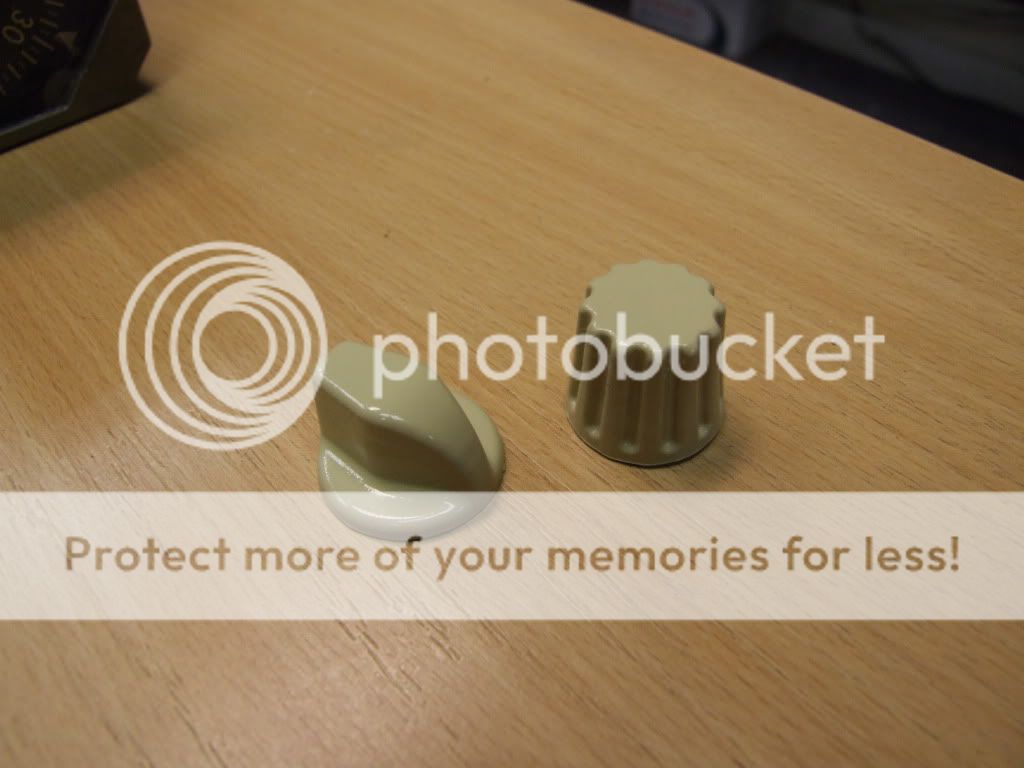

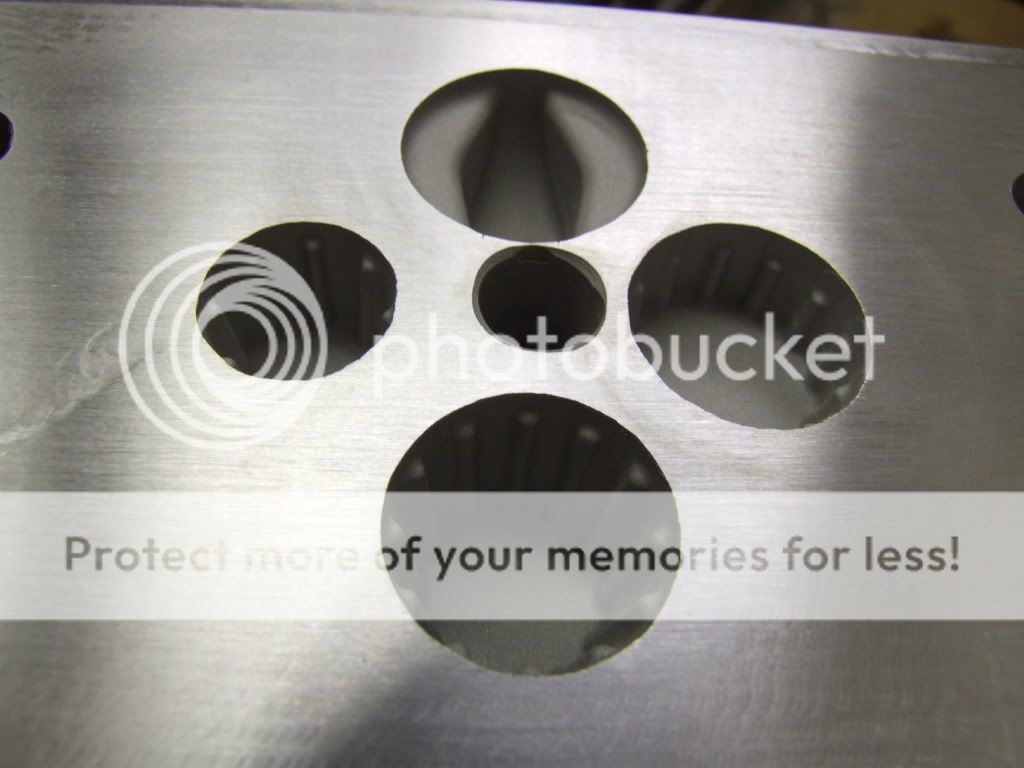

Small issue has come about, Knobs, and getting hold of decent ones, I for one tried making my own years ago with good results but the whole process of casting with resins and stuff is something i cant be bothered with, messy affair and in some respects it can be a risk to your health, but its time to re visit the matter using a different approach, injection mold them, so after a brew and a scratch of ones head i set about designing and producing a moulding tool to produce a set of knobs,decided to start with the knobs found on the NAV1 radios and the most common type used on the 75, no particular reason but its a good place to start, so fired up the CNC, found a large block of aluminium and started to play.
First issue I came across is selecting what bit to use, the smallest radius found is 0.5mm, required a 1mm bit, that i didn't have so used a 1.25 bit, 3 flute, problem is the negative cavity for one of the molds is 24mm deep and obtaining a 1.25 bit that is fluted greater than 24mm is imposable, so ground down my own bit to suit, first cockup i made is that the taper i put on the bit was greater than the draft angle on one of the cavity, this caused the tool to clash 22mm down, but i never noticed until the job was done, this caused the bit to step away leaving a small step in the mold and leaving deep machine marks in the side walls of the cavity that were too deep to polish out, when i realised what happened i had allready removed the job from the CNC, obviously loosing its true zero position, but i thought i would continue and use this as a test and re make the tool later.
Knowing that i had made a mess of things i continued onto making the moving half of the tool, again i made a dogs breakfast of this also, but i tried out using a rotational sprue bush so i can select what knob i wanted to mold, 1,2 or all 4 if needs be, threw it on the machine and gave it a run on 2 of the 4, and to my supprise it ran spot on, shame the end result was not up to spec, but I'm gonna re do this one and others, and figure out how to over mold metal inserts into the knobs like the real things
But at first if you don't succeed have a brew and try again!
Anyhow, time to get my knob out (sorry just could not resist that) enjoy the pics

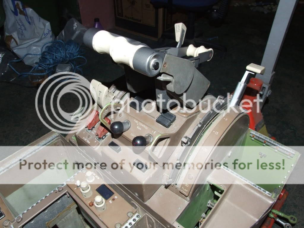

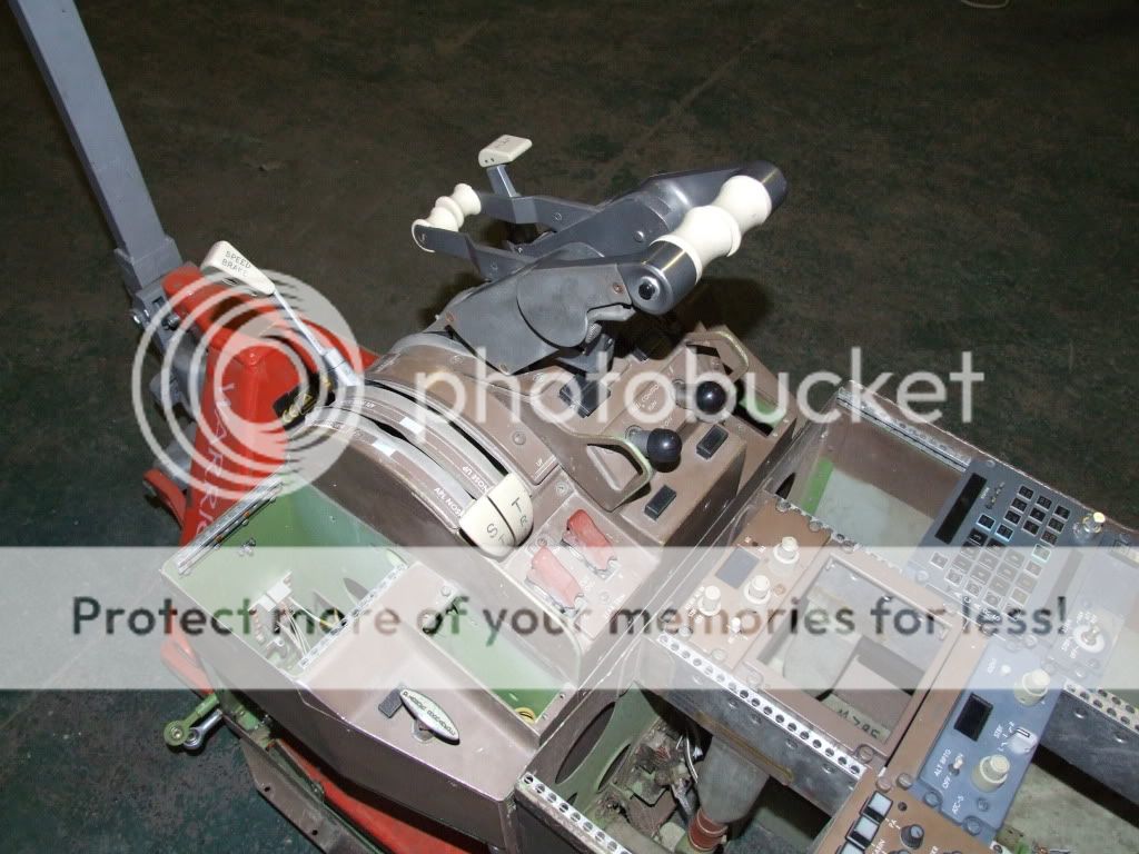

Okay just done something very silly, but never in my life did I ever think i would get my hands on one of these :)
Officially skint, but happy, looks like im walking to work for the next couple of weeks :(

Heheheh, or just sell the house and live in the workshop, actually i do that anyway, hmm just noticed its 3:50am, i got work in 3 hours, bugger! u know what its like you get stuck into something and the hours just fly by.
Anyhow, report on this weekends mayhem..

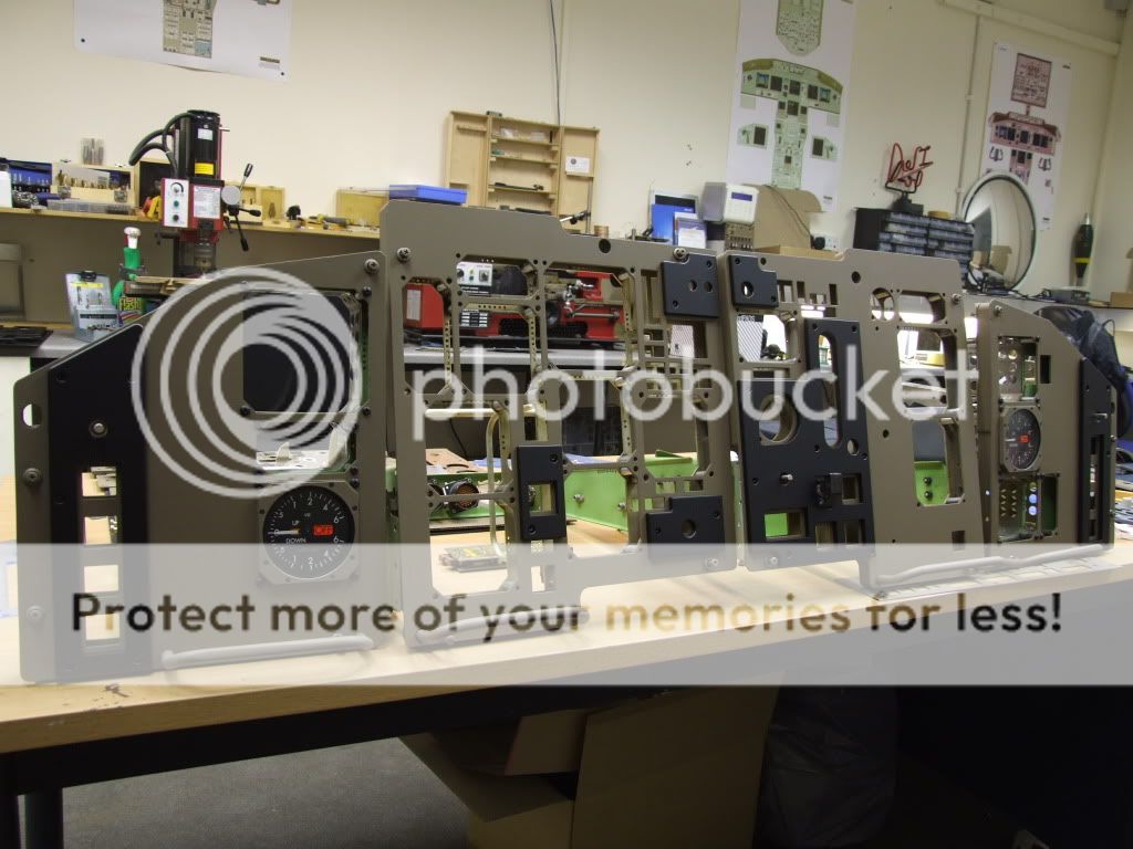

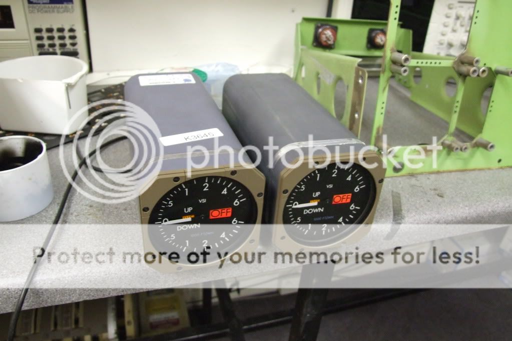

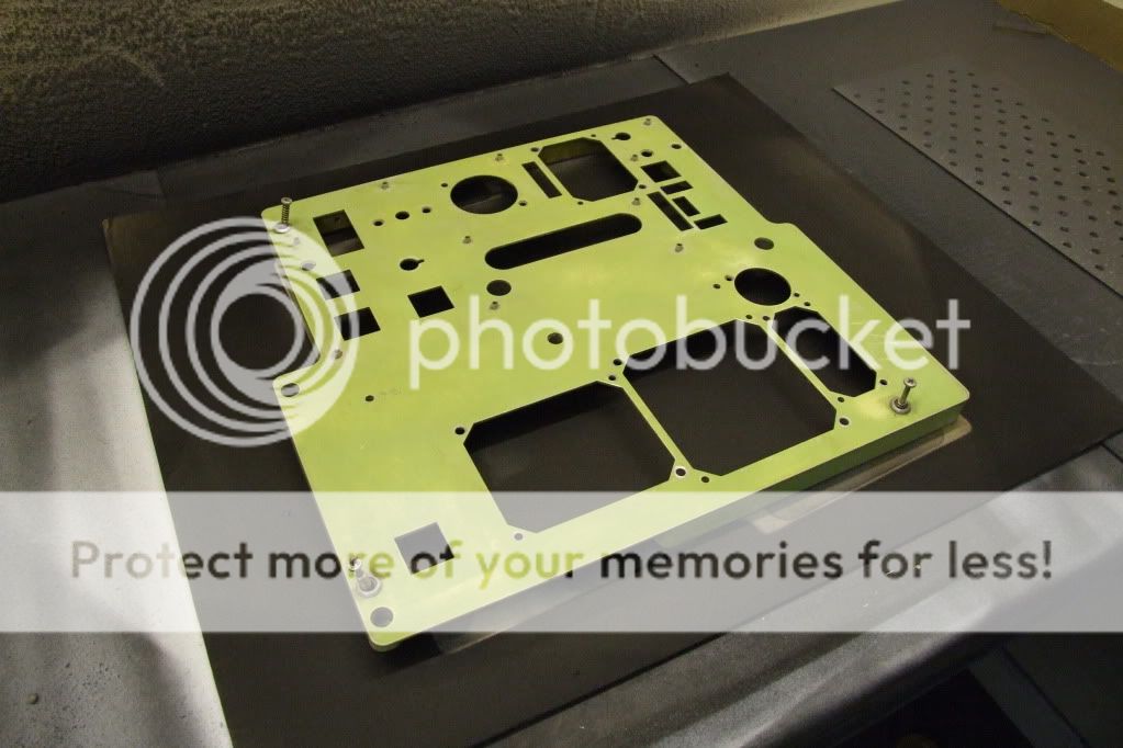

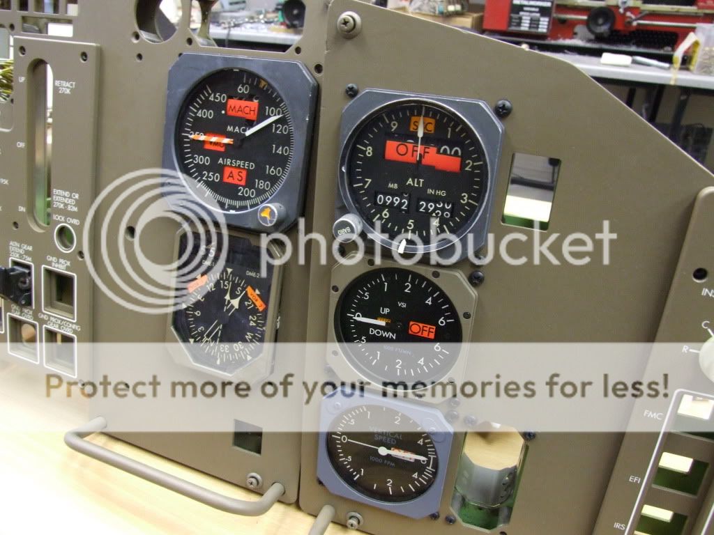

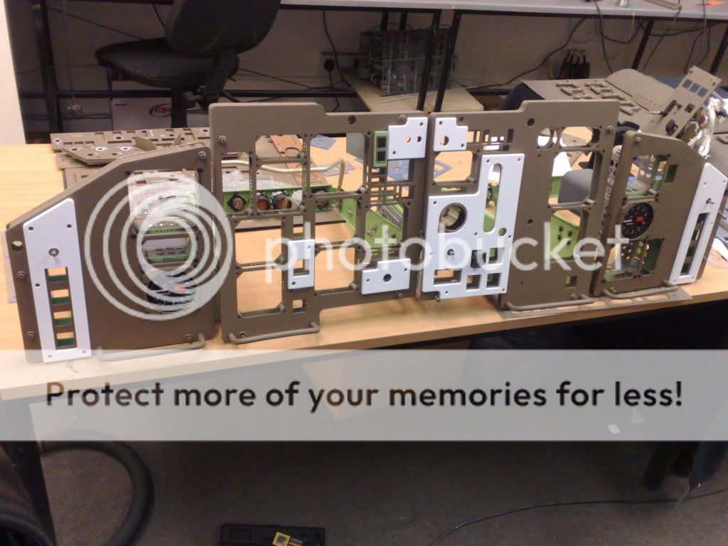

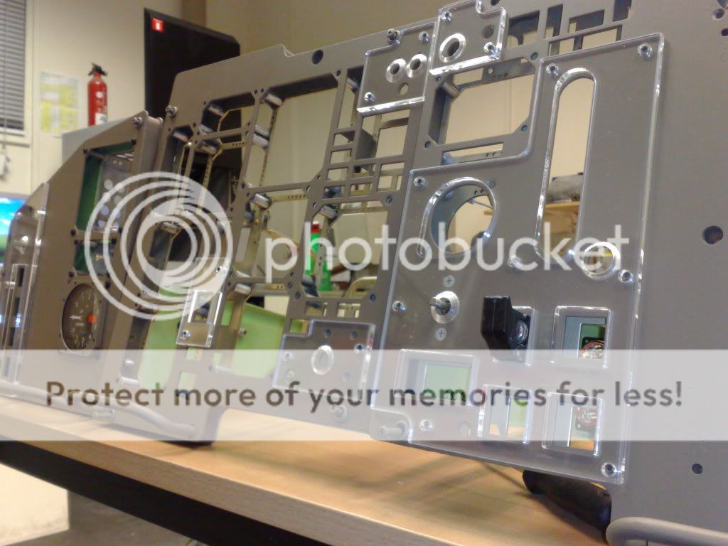

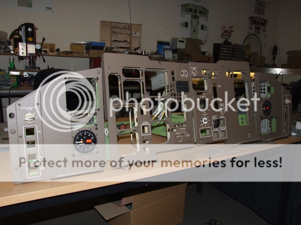

Supprise letter from the PO saying "customs to pay", uh oh, this don't sound good, so off i went to the PO and i got there and found a huge heavy box with my name on :), however £170 GBP import duty, ouch! not happy, gets on my wick paying VAT on something that's lets be honest, scrap metal! anyway rant over, big box of gauges, i was so happy, i got all these gauges over the past 7 months from "aircraft stock" over on eBay, brilliant people to deal with, i asked when i buy something do they mind keeping hold of it to combine shipping, they had no problems with this, so every month i purchased 1 gauge at a time and built up a little collection over the months, okay there not true 757 parts, ex DC-10 and L10-11 (i got a soft spot for both those 3 holers, will miss them when they have gone) but there are things even i cant get hold of, but a bit of work and i can mod them to match 757 ones, all part of the fun,
The ever increasing MIP

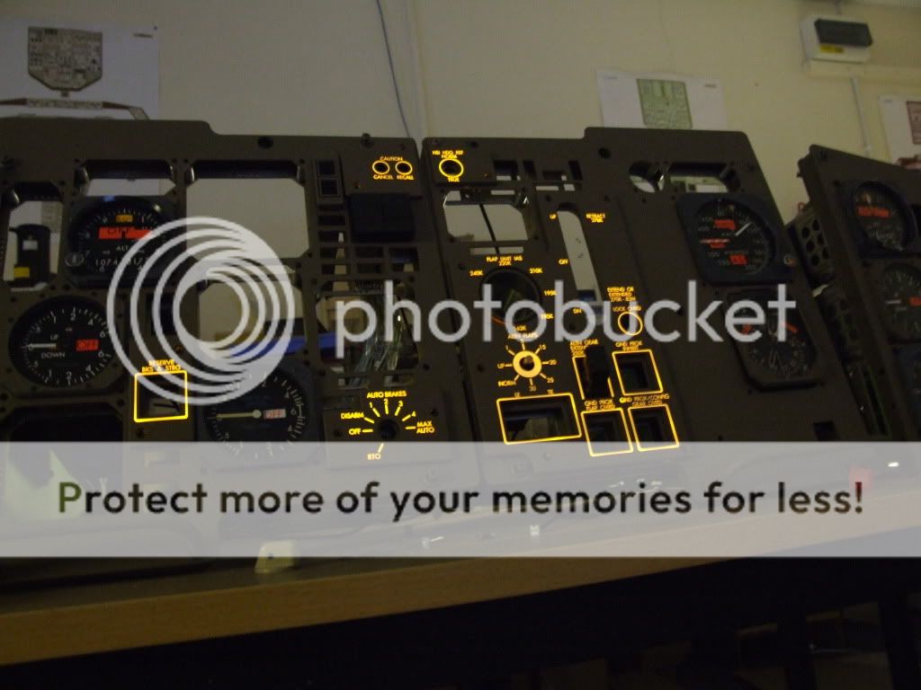

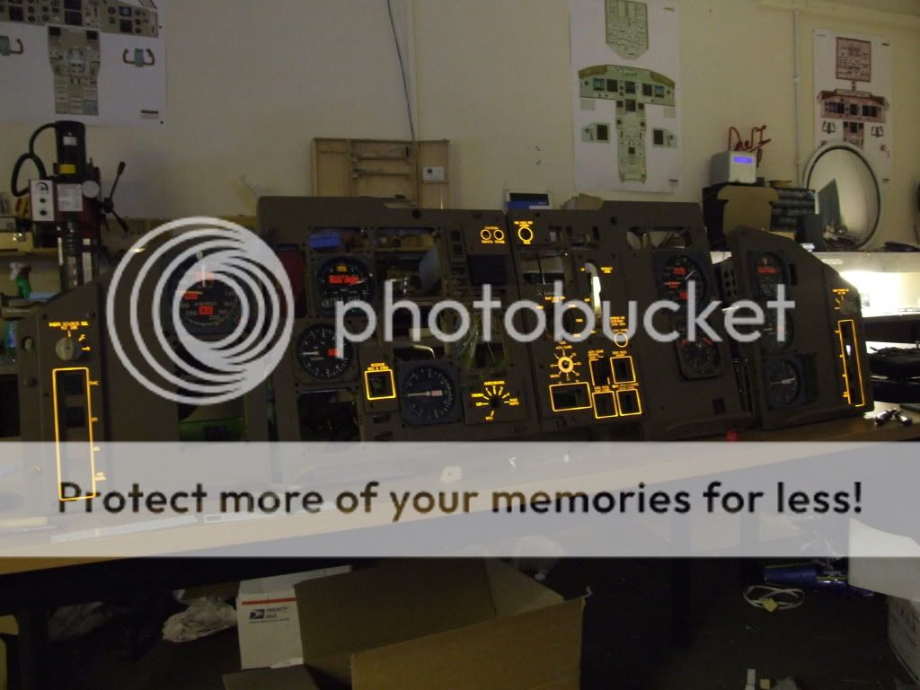

Also managed to design up and make the MIP light plate PCB boards, spent most of this weekend with soldering iron in hand, had a go the  annunciator LED conversion PCB to but ran out of time before i could assemble one, something for next week pending work don't send me of somewhere, the panels worked out quite well, did a dry fit first before i laminate the PCB to the panels them selves, there are a few tweaks and resistor changes to make to balance out the illumination spread but not bad for the first attempt, saying that I should be good at this now, and I made a set for me :) now needing to source the correct panel screws, normally i use M4 but as this is going back onto OEM stuff the threads are different size, so will have a look to see if i can match up the same parts if not replace the rivnuts for metric ones,
Now going to offer up the TQ and PED, turn workshop lights off and sit and admire with a brew (sack going to bed)
