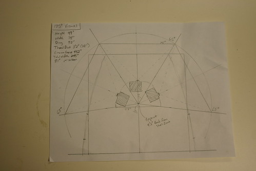

Tom,
Looking at your posts about reducing the size I am somewhat grinning.   I always said that the pixelation really isnt that noticable to me and although not as great as an LCD screen I could live with my setup.   Well.......
My Diameter is 12ft and therefore my screen height is 4 ft and width of each section is only about 80".   My projector throw is only 3.5'.   Therefore my eyepoint to screen is close like what you are testing Tom.   My windows are filled up with the view and unless I stick my head up against the windows all I really see is projected view...no room.  This is what I always thought that moving closer gives better resolution than further away so I kept mine as close as I could while still filling the windows with view.  I believe that for a 737 at least and todays technology, 12 ft is the optimal diameter of the screens.      Don Harrison and a few others can attest to the view that have been over.  Here is my diagram of my setup.   This says 195 degree and I did adjust to 210 degree but still pretty close to same dimensions.
Well, now I understand why you were not too bothered with the resolution. It all makes sense now...your projections must be quite a bit sharper than mine since my projectors are about 6' from the wall. That's almost twice the distance and the pixels must be twice as large.
I think I can see a new screen in my future unless I learn to live with what I have. But knowing that it is just a question or replacing the screen, the tempation may just be too much.  :)
