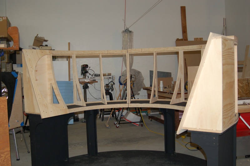

Here's a pic of the new framework:
..and a walk-around video:
http://www.youtube.com/watch?v=zdOnzHXpyNk
We're getting closer! :)
g.

I'm getting more excited as the first full-size display comes together - I've got it modelled in Sketchup to make sure it will fit in my office, but seeing the model on-screen and seeing the real thing take shape are two totally different things.
Pieces are coming together quick at this point - it shouldn't be much longer now.
Just for fun, I stood in the assembly and held up a scrap of foam roughly the size of a 19" monitor at arm's length - it just about fills about a third of the vertical view and maybe a bit more than two of the ribs - I plan to tie my jaw shut before the first startup of FSX just to keep my jaw from hitting the floor.
-Wayne

FYI folks, I've gotten the ribs for the screen cut and the arms for holding the screen in place were cut last night.  Just need to sand, seal & paint the arms.
The funny part is, the display system will be complete long before we've got a cockpit to stuff in the hole. *laughs*
g.
