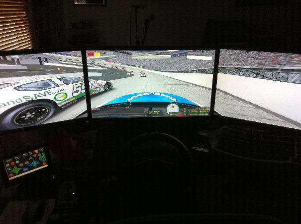

I have 2  separate 3 screen simulators using 2 different sets of hardware and maybe can shed some light on this..
The flightsim one uses ATI 5870 card, and 1 card supports FSX in widescreen (5760X1280) called eyeinfinity.
all the monitors can be different brands/model/sizes/resolution, but it will set the resolution to be the equivelent of the smallest monitor.
eg. if the LHS screen is 1024X768, then all the 3 screens will be 1024X768 regardless of what they are.. so final res will be 3072x768.
The racing sim uses Nvidia cards..
You need 2 graphics cards (configured in SLI) 200 series and up, and generally speaking all the monitors have to be the same brand /model /resolution.
Currently there is no support from either ATI or NVIDIA to support 2 monitors in widescreen - minimum is 3

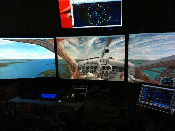

I have 3 monitors for outside visuals and at present a fourth for the PDF and MDF screens in my MIP. I am running FSX on Vista and have 2 Nvidia GT 9800 video cards (I have a 3rd card but that is not working). Each card has 2 sockets for 2 monitors. I have set up multiple display through the Nvidia software.
I start FSX (on the centre monitor) and load my plane and flight plan and click 'fly now'. When the plane is loaded, the centre screen shows the cockpit and the other 3 screens are black. I right click anywhere on the centre screen to get a menu option, click on hide tool bar and the tool bar appears at the top.
Go into View/Newview/cockpit/virtual cockpit and drag that new window to the right screen and do the same for the left screen. I then click on View/Newview/instruments/PDF (and then MDF) and drag those new views to the screen in the MIP.
It is then just a case of resizing and zooming to get the views you require.
After shut down, the next time I load a plane, it automatically goes into multiple display mode with the black screens but I still have to reload the individual windows from the View on the tool bar.
I have FsXPand but I need a more powerful computer for FsClient to get the MIP screens the way I want them so I am at present stuck with just the windows instrument views.
I hope that has been explained ok. It works fine for me.
