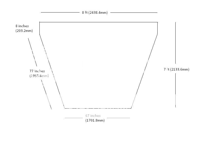

Hi to all,
I am expecting my dual linked yokes from ACE soon, so I have to build a new cockpit base for my project to host my new yokes, since my cockpit base was designed for CH yoke columns Initially.
My intentions are to build a base in such a way to host also my next purchase (after the yokes) which most probably will be an FDS 737 nose section. So I was seeking for the external dimensions of the nose sections in order to proceed.

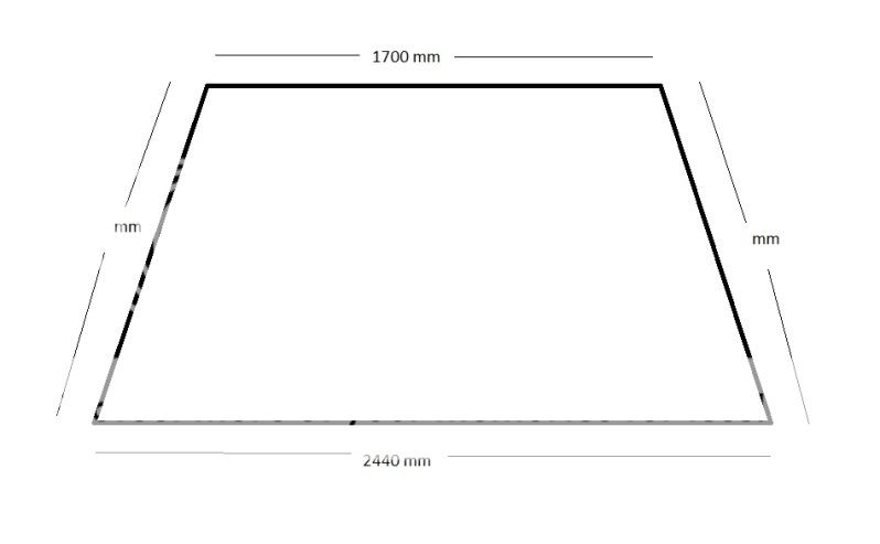

So FDS owners please feel free to fill in the gaps in the following picture,
Thank you in advance,
Nick1150
Thanks Jack,
I was thinking of building a base just enough to accomodate the shell, and not in a rectangular form, like Ivar's for instance:
So I have the forward and aft dimensions but I need the side dimensions to finish my drawing.
Thanks

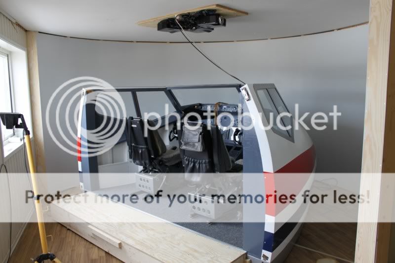

My base is constructed in 5 pieces too, in order to fit the elevator my home. My cockpit is situated in the top floor (loft) of my home, so it was very important to build it in the basement-garage and lift the base one by one on the top floor:
Here are some pics:
As you see it is constructed in 5 parts, and here are the exact dimensions, which were given to me by another fellow in this forum when I ordered my shell from FDS:

Hi Nick,
So, using your measurements I came up with this structure for the start. That will be from 2" x 6" lumber. The central block position can be adjusted to properly accommodate the throttle when I receive it. The top block under the MIP could actually be done as a single block, not in 2 parts.
For some verifications, could you measure the distances:
-From the front end of FDS shell to the front edge of the seat cushion, (for both seat movement positions - full forward and full back).
-The gap width between the side of the seat cushion and pedestal.
(I calculated it to be ~8cm. My seat cushion is 44 cm wide at front. Those measurements are just for rough orientation as you have Webers and I have IPECOs.)
Thanks again Nick!

Hi Nick,
Here are the info requested:
Don't forget I have RSP J-rails, but anyway having the seat in the center position (full height) with the J-rail full aft it is 131.5 cms and full forward it is 107.6 cms.
My seat cushion is 51 cms in the front and the gap is ~ 6.5 cms when J-rails are set on "flight mode".
Did several measurements in regards to your drawing and I must say that with a few mms we are almost identical in all aspects. So in my opinion you are in the right track ;)

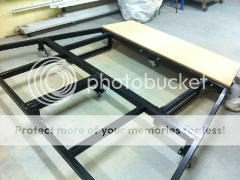

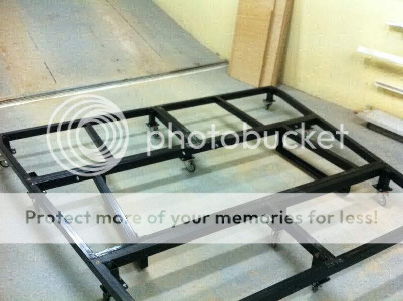

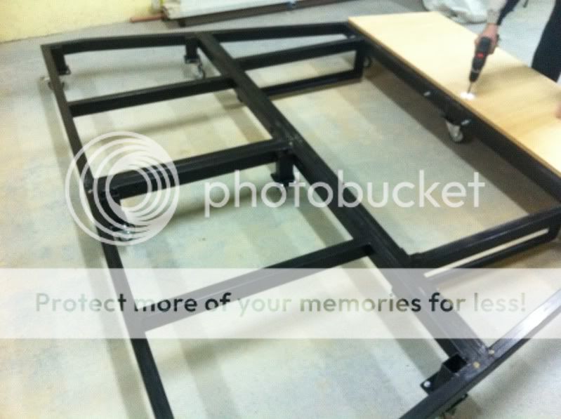

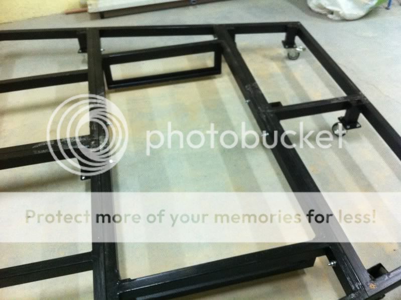

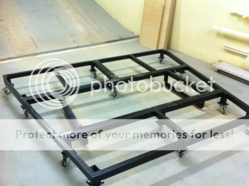

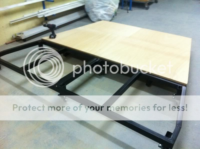

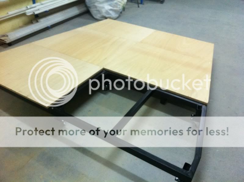

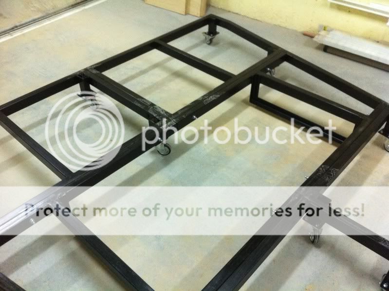

Thank you Nick! This will help with arrangements. I already built the base - here is a couple of pictures.
