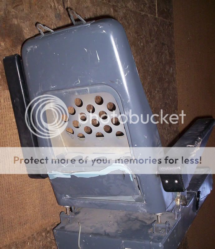

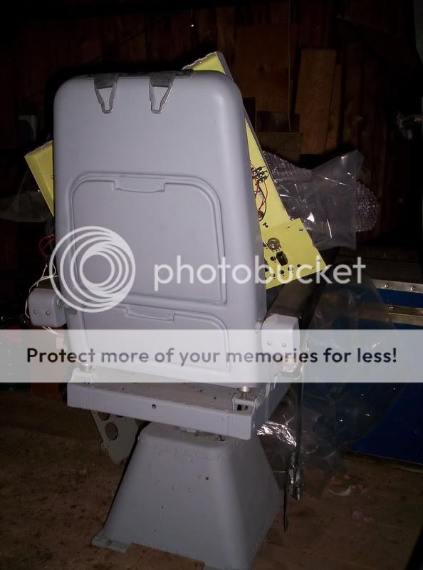

Quote from: Trevor Hale on October 16, 2009, 02:34:03 AM
:eek: Nice Seats...
Yep, happy with them, they even are electric  with the proper power supply which I do not have, but the manual controls work.
Hey, they were not that nice when I got them!!
Wow,  you have really cleaned them up haven't you..?  Man what a difference.
degreasing with solvent spray,Automotive sandblasting, repainting with semi gloss primer, rehupholstering the armrests...etc etc,
