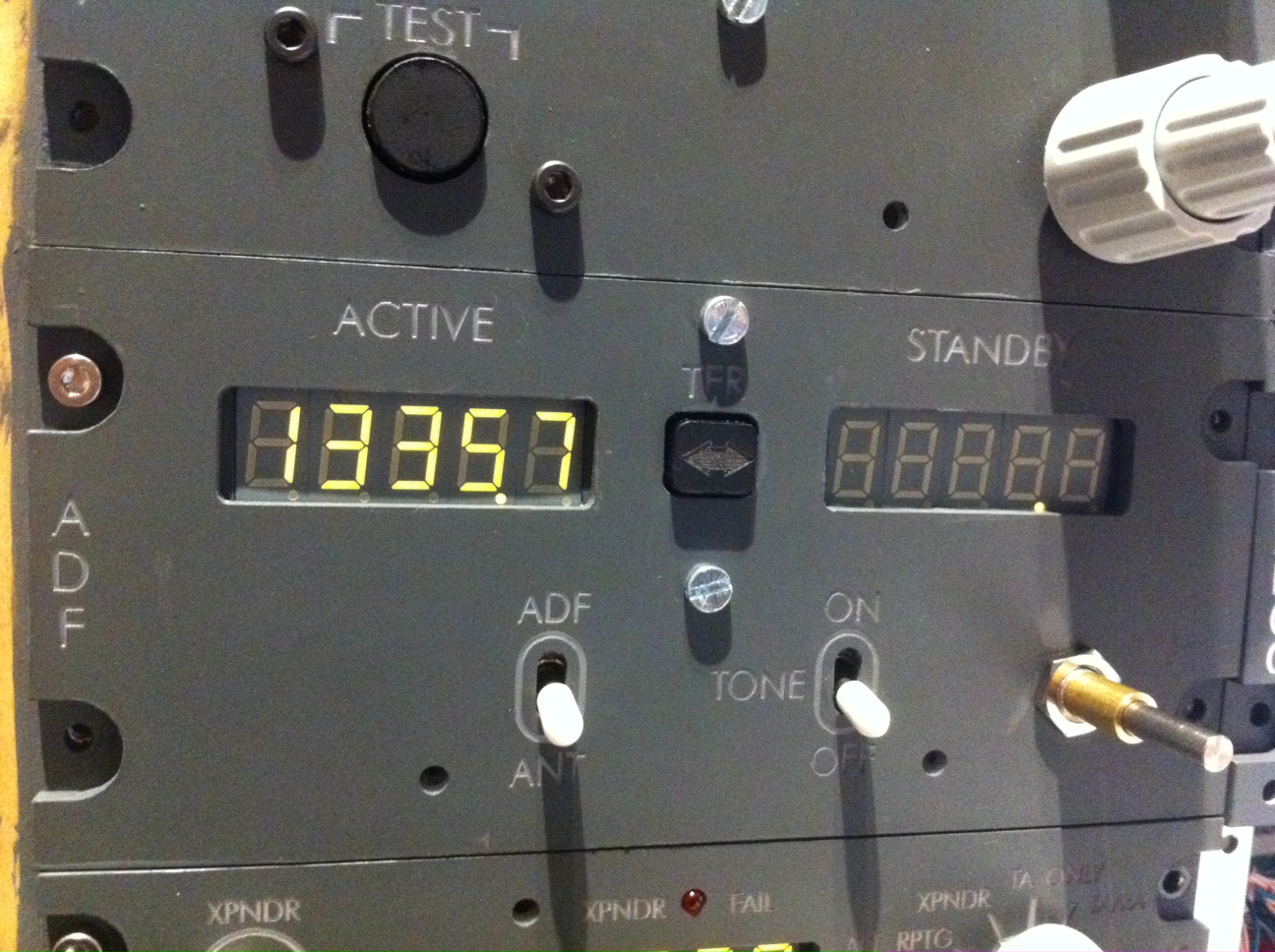

Hi all,
Does anyone know how to encode the SIOC for the ADF pannel, for the boeing 737 please ? The code you'll find below works, but I can't find the offset of the ADF standby when using Peter Dowson's list and the FS Interrogate program.
The only offsets I can find are the ADF frequency and the ADF extended one. The pannel I am currently using has two slots that show the digits of the Active ADF and the Standby ADF.
I really hope one of you can help me in modifying the code so I can display the Standby ADF (now that I can't display the Standby ADF, the encoder directly modifies the Active ADF).
I don't know if it helps, but for additionnal information, I am using Prosim 737.

Hi Vuelosat,  there is no offset for the ADF Standby hence the reason why you can't find it  :).  Try my attached code kindly written by Nico Kaan who is the pre-eminent SIOC wizard in my book (I would highly recommend reading his SIOC tutorials if you want to learn more).  This will give you control over the frequency by two encoders, one operating the 2 higher digits and one operating the 2 lower digits and it also gives you a standby frequency via the code itself and will pass it to FS once you press the Transfer button.
