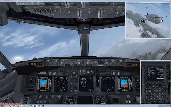

Hello,
We are a small software development company who have just launched an addon for FSX. We would welcome your suggestions for any new product features which would be useful to cockpit builders. Here is a basic description of what we have done so far...
OpusFSX - Flight Simulator Interface for Microsoft FSX
*  Ideal for cockpit builders both large and small
*  User friendly camera control and docking
*  Windowed views for multi-screen PCs
*  Ultra high performance IPC comms
On standalone systems OpusFSX provides excellent camera control and docking facilities, including support for multiple windowed views, all within its Live Camera user-friendly interface. OpusFSX also provides many excellent new weather themes for Microsoft FSX.
In addition,
On networked systems OpusFSX provides the optimum solution for all cockpit builders by allowing you to offload some of the display workload from your main 'flying' system onto one or more OpusFSX client systems. This is achieved through the Live View and Live Camera interfaces. All systems must have FSX installed. Your main (most powerful) FSX system becomes your main 'flying' OpusFSX server, other FSX computers (PCs or laptops) connect as OpusFSX client systems.
Your main 'flying' OpusFSX server is the machine through which you control the aircraft. The networked client OpusFSX systems are synchronised to the server through multiple ultra high-performance IPC links, the client systems are used primarily as view controllers. The networked systems allow you to create a multi-screened simulator system without placing the full workload and burden on your main system.
From this set up it therefore follows that all in-cockpit or instrument panel views used to control the aircraft must be displayed on the main server. All other views (scenic or external) can be offloaded onto the client systems. You can create wide panoramic vistas this way, or additional external aircraft views, without draining the resources on your main system or degrading its performance.
Please refer to our website http://opussoftware.co.uk/opusfsi.htm for further details where you can download a trial version of the software.

I downloaded the version 1.44.1 and retested. Pictures below illustrate my process.
This time I did not create any views in FSX and only created three cameras  (all checked as Windowed View).
The views now point to correct chosen direction whether it's done interactively or by entering the value. I set zoom to 0.5 for all three views.
I saved all cameras.
After restarting FSX and OpusFSX the new views appeared cascaded in the upper left corner.
I undocked the views and moved/resized them.
After clicking "Save Views" button the undocked views suddenly got stretched well beyond screen.
Close/open views or restarting FSX/OpusFSX  restored the initial screen with three small windowed views cascaded in the upper left corner.
I undocked the views and clicked "Restore views" button.
The views got  restored to the correct positions  but stretched like after using "Save Views" button - which is not the size I set for them before saving. I don't know how/where OpusFSX saves the view parameters, so far I was not able to check what it saves.   :huh:
Do I understand it correctly, that  only undocked views can be  saved/restored by OpusFSX? And therefore, there is no way to save/restore docked windowed views, unless they are manually undocked first?
P.S. BTW, you have the typo in your camera definitions parameters:
Description = OpusFSX Cutomized Scenic View

No problem, its very nice to hear from you.
You are correct in your asumption, at present, only 'undocked' views can have their positions and sizes saved. Although we will investigate adding all 'docked' views other than the main 'View 00' to the procedure if you wish  :).
Do you use docked windows or always undock them?
Would you find such a feature useful? If it helps I don't mind trying to do it.
We did try to undock the windows automatically within the software, but every attempt resulted in FSX failing; usually complaining by not accepting any further mouse or keyboard input :(
There is a very good reason why the windows get streched then restored when clicking on Save Views. It is a process we have to go through in order to determine the current 'internal scaling' of the view within FSX. So the procedure you witnessed was carried out deliberately by the software to convert the FSX window coordinates (sizes) to the actual true 'physical' screen sizes. Unfortunately this process has to be done completely outside FSX since MS did not provide any proper view control within SimConnect.
We will see if we can achieve this in a way that is hidden to the user. What you should have seen is the window first being streched first much larger than normal, then after a short time being restored to its original size. If the views got restored to the correct positions after subsequent undocking, then the process worked, if not then it looks like we have some more hoops to jump through in order to decipher what FSX is doing internally.
What physical screen resolution do you have and what display resolution have you set in FSX?
That should help us to unravel what is going on.
Many thanks for your cooperation Nick, look forward to your reply.
