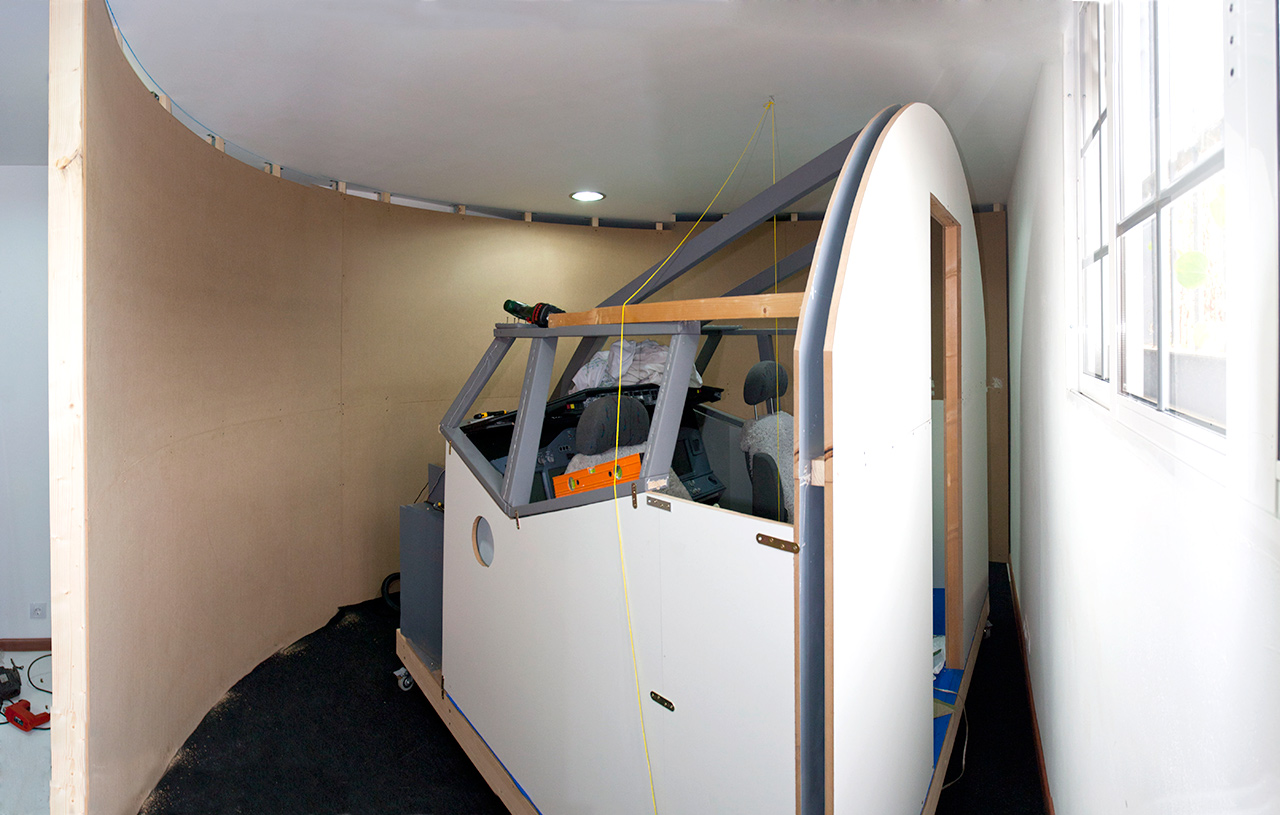

FredK
Hi Edward -
Sorry for the delay in answering your question........
The following are the dimensions for my 737 sim......
Curved screen with 135 degree arc
Arc is 16 feet
Radial distance to pilot eyepoint is 82 inches (screen is offset to achieve a constant radial to the pilot's eyepoint)
Bottom of screen is 24 inches higher than the cockpit floor
Screen height is 48 inches (72 inches higher than the cockpit floor)
Distance to projector lens from screen is 48 inches (Mitsubishi projectors)
Using this setup I have an exact complete fill of the 16ft wide x 4ft high screen area after warping.  Note that this is achieved using a 4:3 projection aspect ratio to maximize height in my case.  Currently I am using Nthusim which only allows for butt edging for multiple computer projection.  I am planning to switch to Warpalizer for edge blending though. Based on my calculations I still will be able get complete screen fill using overlapping projection at a wide aspect ratio at the same projector distance to screen that I have now (which is as far from the screen as I can go given the space constraints that I have).
My cockpit dimensions (glareshield height and window dimensions etc.) are accurate to the real thing.
Fred

Hi Fred,
Many thanks for the data and the pictures of your cockpit. Looks very good.
I can now finish my paperwork. Still not very easy since I have less space than you and I have to deal with a pitched roof! But I think it will just fit. Looking at your pictures I wonder that you have so much coverage of your side windows considering the 135 deg FOV. Unless  your eye-point is ahead of your screen center.....I cannot explain it otherwise. Anyway, you managed it.
Success with your re-warping!
Edward
