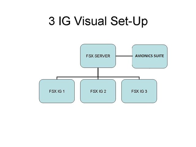

Hi James...Thanks for chiming in.
I have setup XP10 essentially the same as I have with FSX (pretend it says XP Server instead of FSX).
All the Sim-A avionics are on a seperate computer, BUT the Sim-A Server is on the same PC as the ths FSX/XP10 Server.
The weird problem is that Sim-A Server does not "connect" to XP10 running on the same machine with or without XPCLient running. It will happily connect to the one of the client XP's if I assign their IP???? Not ideal as the flight model is the one on the Server PC.
As for flight model...yes X737. OK I havent tested against the numbers yet....just feels different...maybe good maybe bad :) (Kidding)
As for drivers...their fine...Austin has done something inside XP10 to prevent warping with Sol7/NThusim...I just hope it wasn't intentional  :(
