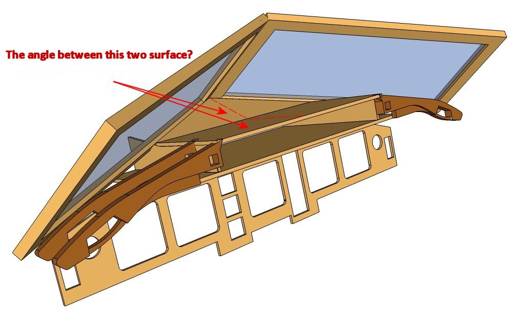

Are looking for the angle between these two surfaces on top of the Boeing 777 glare?
Appears from the information I have been able to find that the front triangle surface on the top of the glare that's ending up in the front widows is tilted at some degrees upwards?
Or is it more or less horizontal as on the 737?
Asking as we are in the process of starting to enclose the 777 cockpit we are building (http://www.cockpitbuilders.com/community/index.php?topic=2299.msg17529#msg17529), starting with the front windows.

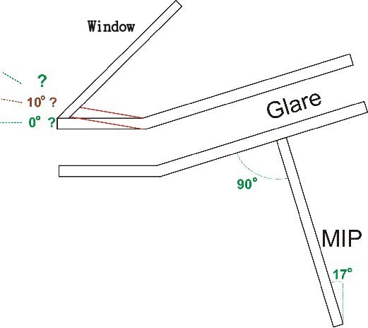

The drawing under might give a better "description" of what I am looking for.
Have been looking at a lot of pictures found on the net, all taken from an angle that makes it hard to figure the angle I am looking for.
From the pictures it looks to me that it is angled slightly upwards (my guess 10 degree upwards), but then again I might be wrong  :( on the 737 I think it is horizontal (0 degree) but that the 777 is a little different?
My thought is that 10 degree wrong on this detail, starting building on the shell with the windows first, can make the rest of the shell look all wrong to.
Looking forward for any input, trying to solve my dilemma!

Is flat, and if its not flat it's as good as, many times I have thrown paperwork or a coffee cup on it and its flat :)
pebo
Thank you Rhys! Flat it will be then   ;D
