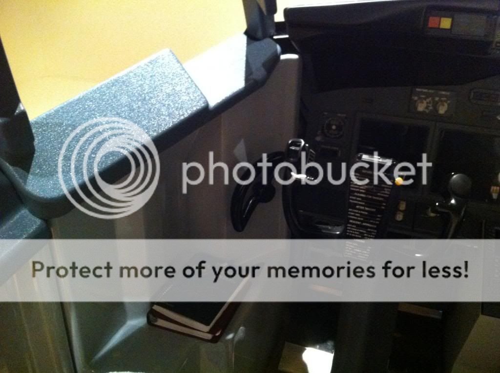

Nick1150
I finally decided to go with the opencockpits solution, eventhough I do not have any other part from them. The truth is that the OC tiller is great and it does the job in a good price...
Here is a pic with the interior liners installed
It looks good! OC makes a good product. I have a couple of his Nav heads and I'm ordering an ADF soon.
I'm not sure how you mounted the tiller, but I would never mount anything to a liner or trim panel. Those are supposed to be mounted to the airframe. Too much stress on the plastic, especially if it's original. I can't believe what a set of 737NG interior panels are selling for these days. I'd like to ask them if they want the fillings out of my teeth too.
Nick1150
The specific OC module is supported by a big plate with 4 screws on the plastic liner of FDS. I use it for 2 months now and I have no issue with it, so feel safe in case you want to follow this route...
The alternative was to mount the tiller on the shell but this would mean that I had to create holes on the backplate of the tiller and to the FDS shell, which was a different approach than the above, and actually it would have been completely opposite than the one that OC has designed the model to do.
Hope that helps...
