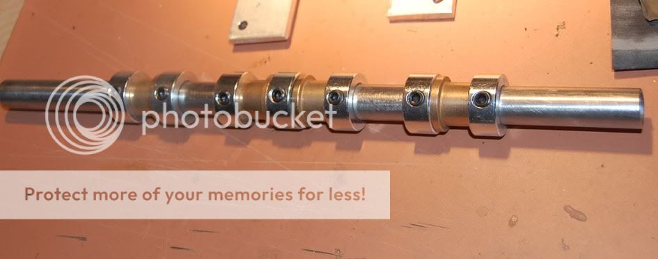

Just to wet your appetite, this is the main axle for the 4 levers...
I am starting the assembly, based on the 787 throttle.

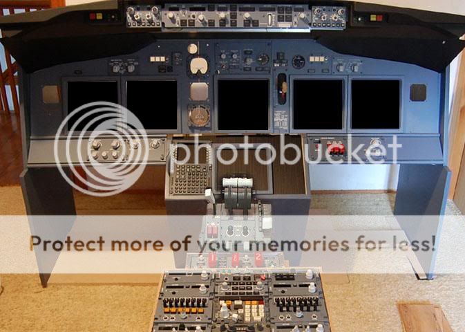

this is a "paste up" of the 787 throttle in my 737.
Woot..  Looks nice..  *DROOL*
Ehem..  though shouldn't you be working on a shell and liners to show us before a throttle quad??  LOL   :idiot:

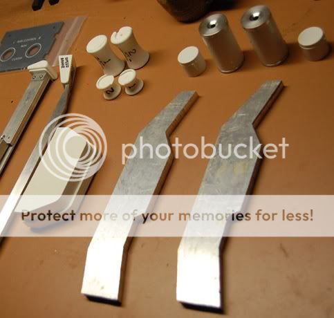

UPDATE UPDATE
I know...it is going slow but all parts start to line up and will eventually come together.
The big item were the 3/8" aluminum levers. Most shops asked around $300 to $400 to laser cut them. Finally a HVAC shop cut them today for $25. Worth being patient.
I can handle the finishing/polishing.
BTW: I will NOT use the 737 knobs  (+the fuel cutoffs) , They look too small for this design, selling the lot for $25 +ship.
The flaps and spoilers ones I 'll use.

Wednesday 3H30:
first rough lever..
Very nice Jack. I am looking forward to watching this come together....
Frigging Stunning.. I love it..  Good show, I can't wait to see it work out either.
Absolutely top notch. This is looking good Jack. Keep it up
That throttle arm is outstanding. Very nice!
