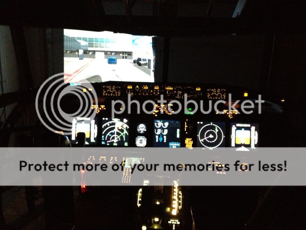

After three years I can finally fly my cockpit!!!!!
Finished all the MIP wiring except a gear micro switch that went bad, finally asssigned everything I could and tried forever to get the FSX PC to talk to the Avionics PC.  They could see each other and every other PC in the house, could connect to every PC but each other.  If I hardwired them they were fine, but wireless they were not.  Haven't pulled network to the garage yet but  I will.  I found an old switch, so I left them on Wireless and created a secondary network and now SIOC and FSUIPC can talk fine.
Have a strange issue with SIOC and my Rev Sim TQ.  SIOC is connected, but shows stopped.  TQ still functions though so not sure what that is.
I'm flying off of a little LED PICO projector on the garage door until the Plasmas arrive and I build their base.
Overhead wiring will be next!
Damn this is fun!
