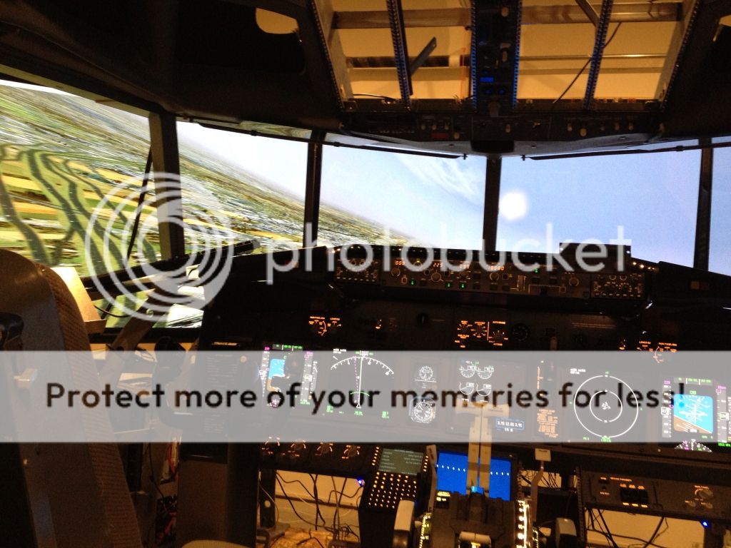

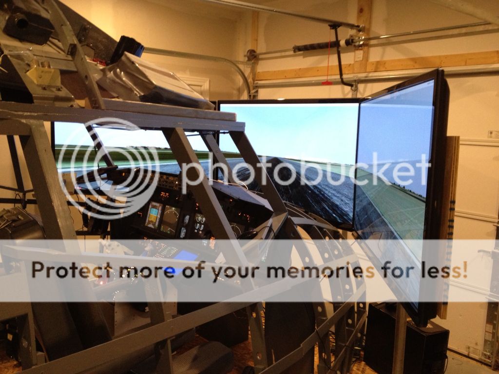

More displays arrived. Still dialing them in, but going to try a night flight.....

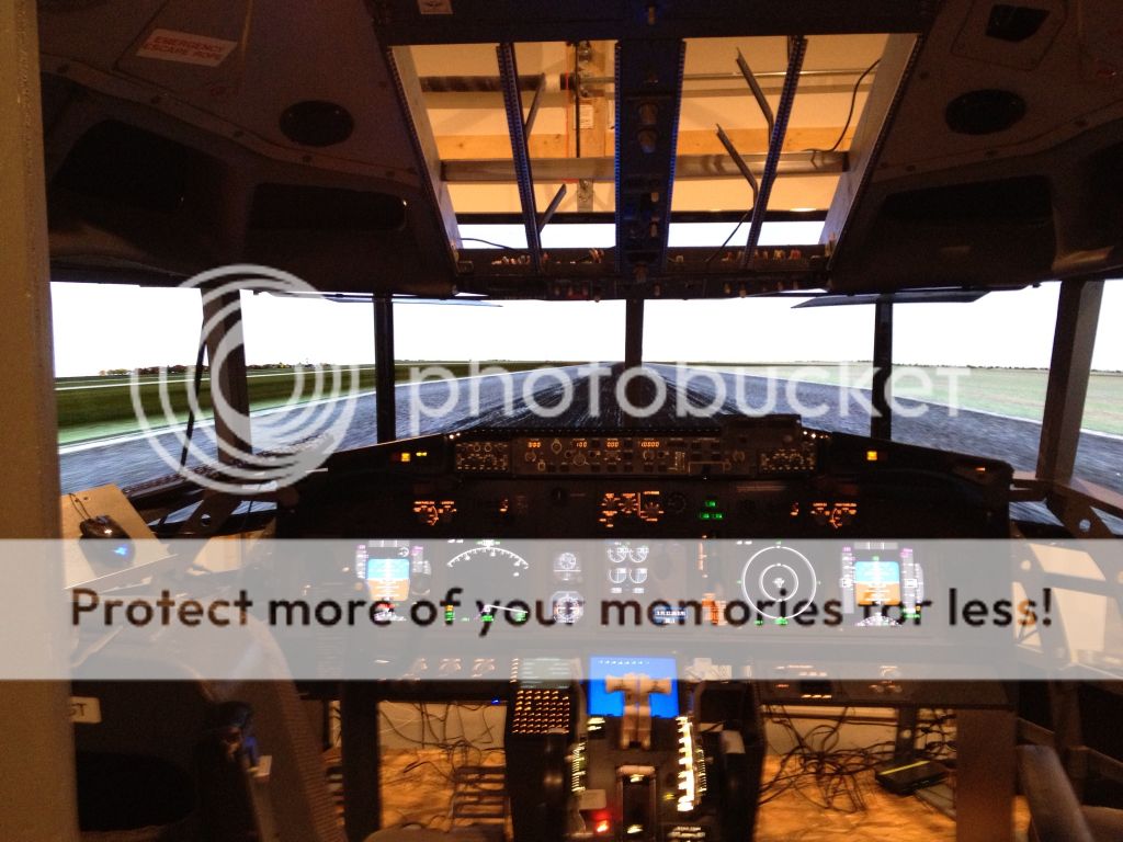

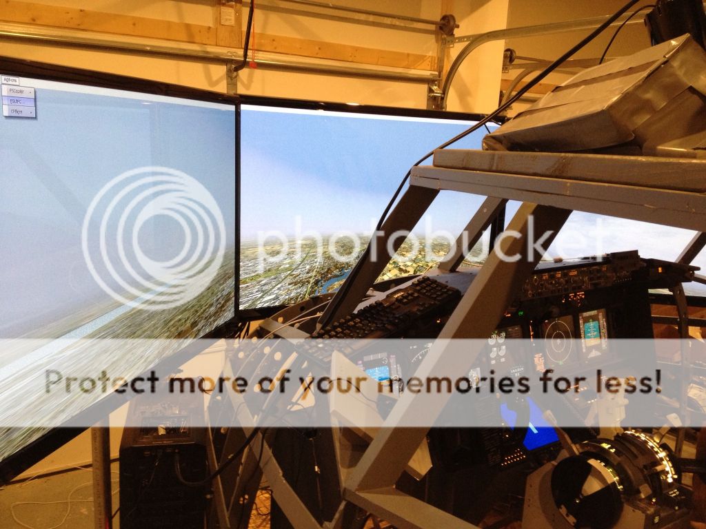

Having some issues getting three undocked to line up.  Tried the window maker file and I ended up with outside windows that needed to be rotated in.
Changed to 40 degree windows and had to zoom just past 1.0 to get them lined up, but now everything seems to close to me, though it does stay nicely aligned..  Guess I will tweak some more.
It did bring the old P3D machine to its knees.  At KDFW, 20% traffic, dream team airport I'm getting 6 on the ground. Older i7 though and dual GTX 285s that are being replaced Friday with a GTX680.  Need to bump the over lock for now and then grab an ivy bridge i5 and new MB soon.
Ack, been too long, forgot to set wideviewaspect=false to get stuff to work right on three screens
Ok, all aligned

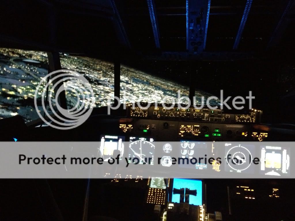

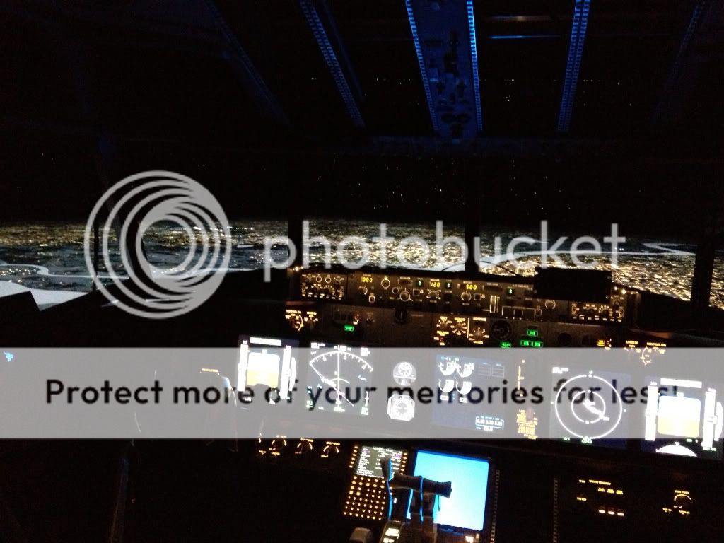

Quick night flight

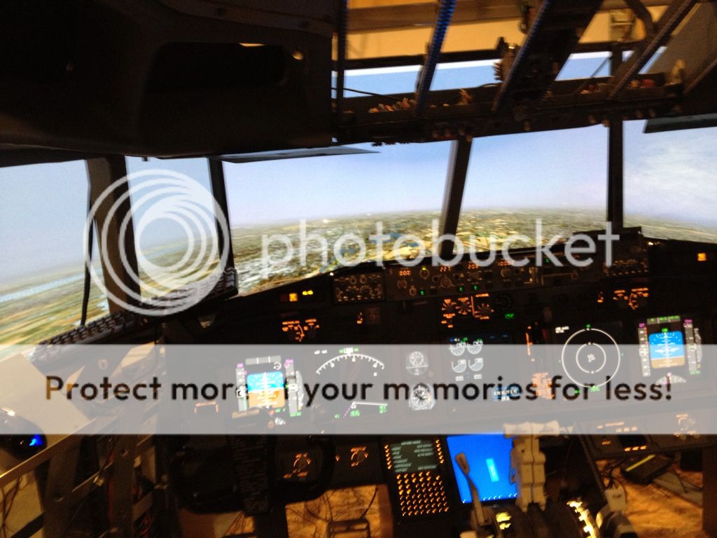

Approaching KSTL
Go into views from the FSX menu line (Alt key) and at the very bottom of views you'll see or might see 4 blank spaces. Each space represents a window view and you'll see a checkmark by one of them. That checkmark represents which view is active and has the white outline, so you need to check the blank space that is for the background window 1 view.
Most times it is the very first one you need to check; however, go through each one so you'll know which one is which. By the way, once you do get it to the background view and not see the white outline box, and then if you click on any other window in front, you'll have to go back and change that checkmark again...

I'm curious as to the distance between the MIP and the TV's...i.e. say from the very front lip of the center portion glare wing to the center monitor.
I am setup  in a 6ft wide by 10ft space - with my MIP/Stand pretty much up against the wall and using 3 24" monitors for now (monitors aligned to the sit near the back end of the Engravity Desktop MIP) - this would be a pretty nice upgrade if I could get it to fit in the space I have!

Matt,
My screens are against the front of my shell and its 36" to the center of the glare fron the glass on the screen.

Thanks for this info...hmmmm - certainly got my wheels turning, might be able to make this work - side to side component would have to be examined but its all in the angle of the "monitors".
Certainly 3 60" would give more FOV/coverage than 3 24"!

I have mine angled I so they are just under 10ft width wise, and using a 150 FOV.  Of course two more would be perfect, but I'm sure Scott will beat me to that :)
I tested what adding another on each side would be like with Mike when he was out.  We shifted the monitors to the left side.  It was pretty awesome and we both agreed it would be perfect.   The only thing is that I was running two off the one left side computer at 3840x1080 on X-Plane and I had to dial down some of the X-Plane rendering to keep the frame count up.    I am not even sure how this would work under FSX and Wideview setup but may need additional computers.  For the moment I am happy with the performance of my three and though nice to have the other two I just dont think the extra 2K is justified.
Who knows....I have been known to change my mind :-)
