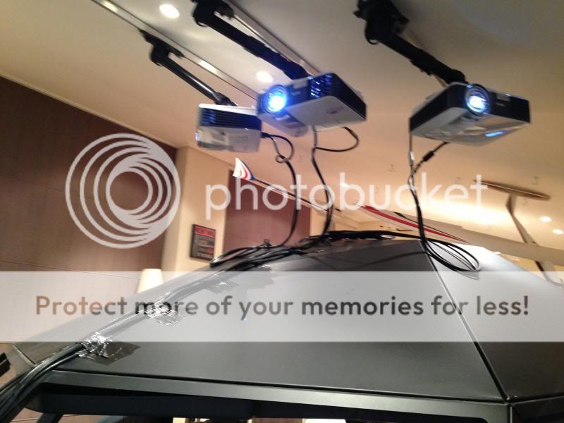

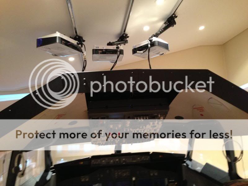

Quote from: Maurice on February 24, 2013, 04:03:12 AM
Nick,
These projectors mounts seem like very fancy & expensive ones. What brand are they or are they the ones made to fit a particular brand of projectors?
Hello Maurice,
Very sorry for taking so much time to answer, but I haven't received any email notification.
Today I wanted to post a question and read all these replies since my last post!
Sorry for that again,

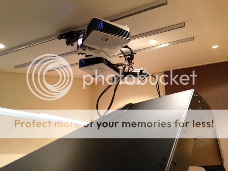

About the projectors mount... Actually these mounts are very cheap but need work to create. I bought 3 cheap universal projector mounts, like 9.99 euro each and I created with the help of a friend talented in metal works this result mounted on a usual curtains rail. The result is to have all axis available, including forward and aft, changing the throw distance that is.
It's not something expensive but it needs time and effort to build it.
My ceiling is inclined, and also at the time I was building my cockpit base I haven't decided yet about my projectors, so I needed a flexible solution then, in order to be ready when the time comes.
Hope that helps...

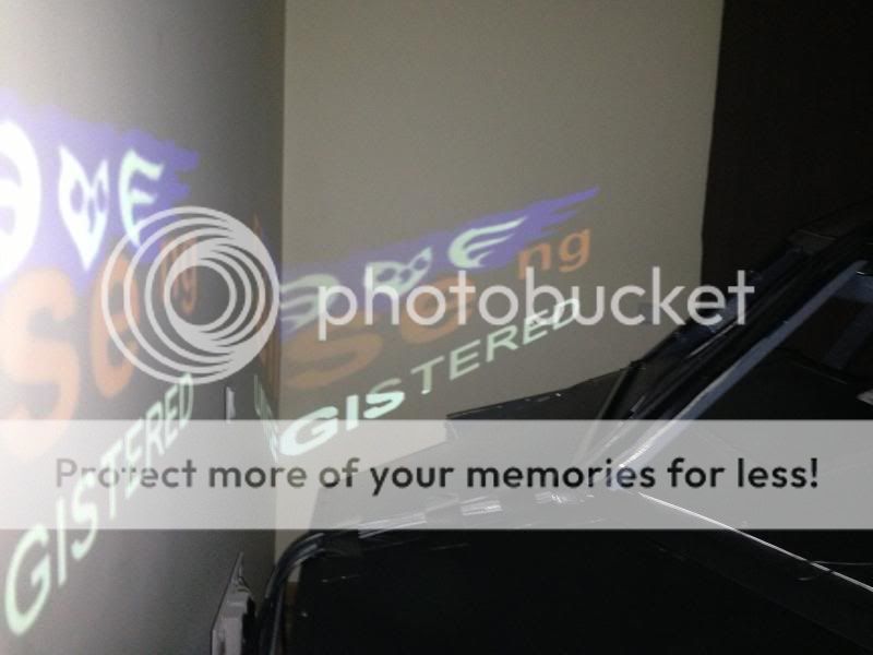

So I finally decided and bought my 3 projectors. I decided that Benq MW817ST would be my solution, and all 3 of them are now ready for their first tests on my cockpit, hopefully this afternoon after work...

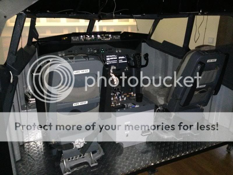

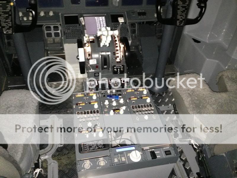

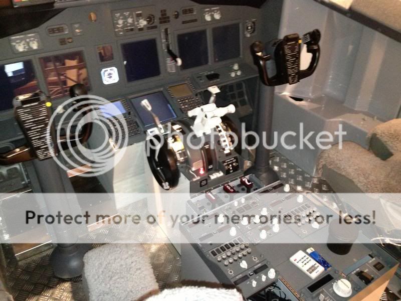

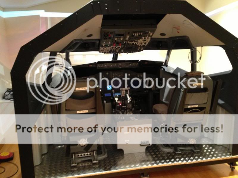

aaa and a few pics of my cockpit just for the fun of it... Just finished my metal cockpit floor and purchased the rest of my pedestal modules from CPflight, all cables have been made from the start, solenoid switches are on the way to be installed on my overhead and also 4 speakers have been installed on the cockpit ceiling for the call outs only.... This hobby never ends!

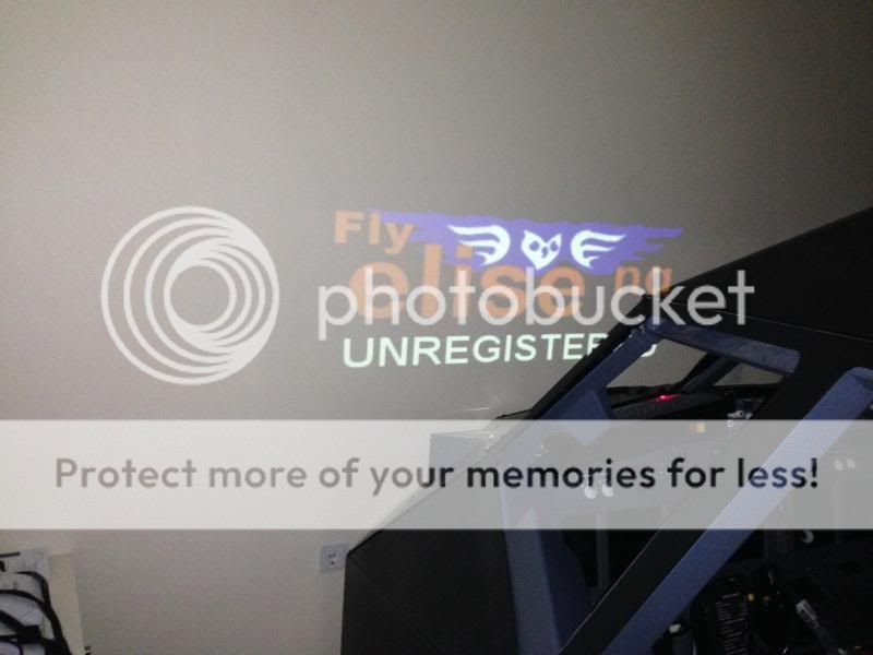

Hi to all,

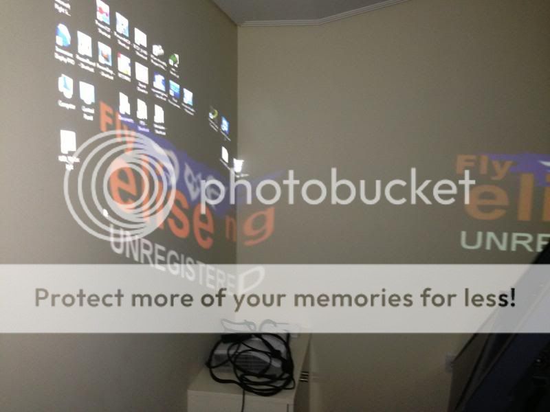

So after a long weekend mounting, testing and tweaking with my new setup, I went to the Fly Elise Pro solution. I have made a test flight, and one thing I can tell you... I am not going back! 180 degrees FOV makes a difference !!!
These are the good news... the bad news are that now I HAVE to decide about my screen ;)
