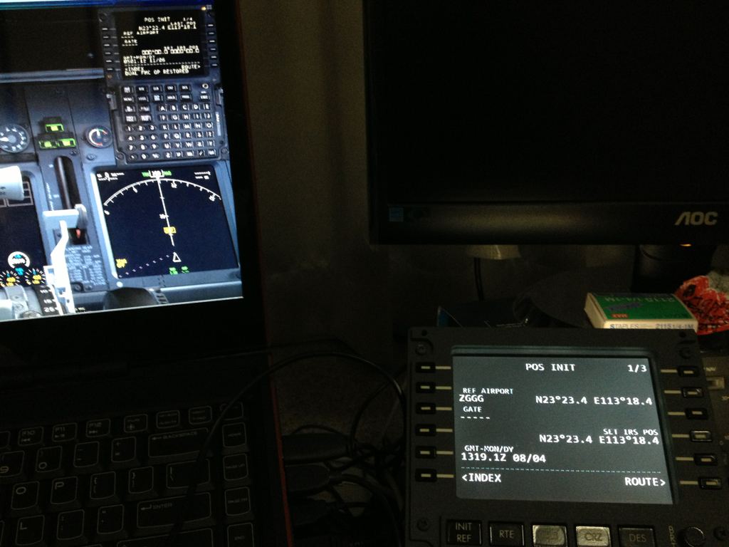

bratwurstdimsum
#11
Hi everyone,
Thank you for your answers.  I think I might have misled you a bit.  The issue is not whether or not I can get access to certain menus or functionality within the FMC itself, this is merely a side effect I noticed.  My main issue is that what I type into the FMC is "out of sync"with what PDMG 737 and what the other stock 737 is doing.  Once SIOC 3.7B and prosim has fired up I have a proper functioning FMC but the information does not appear to be "going into" the 737 aircraft in FSX
If you look at the picture below, on the right, I have already entered in my POS INIT for Shenzhen airport (ZGGG) but when you look at the PDMG FMC, it has not registered the same information, nor do the displays or alignment lights reflect that the GPS is aligned.
Thanks for the tip on the APU though, I have fired the overhead and turned on the APU - didn't make a difference to the problem above :)
wpslider
Looks like your are using Prosim + PMDG!?!
If you use Prosim FMC, you cannot use PMDG FMC at the same time. Prosim will not send anything to PMDG systems. Use Prosim OR pmdg.
Prosim is a simulation of all 737 systems and cannot be mixed with other systems from PMDG or other addon. Use FSX basically for the outside view.
markfire
Hi
You can't use or expect to see the results of an input into the fmc or any other hardware on the pmdg software as you are communicating directly with the prosim server system.
Use the default fsx 737 in outside cockpit view only. Ignore any instruments other an the prosim ones.
Open up the prosim cdu and you should see your inputs reflected there
