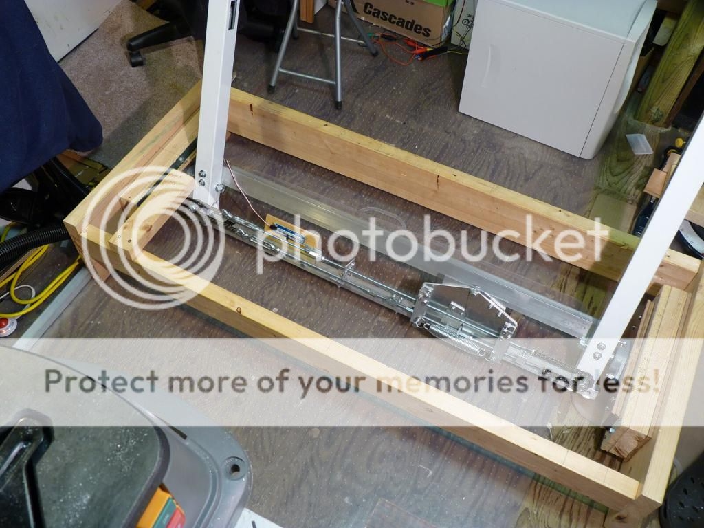

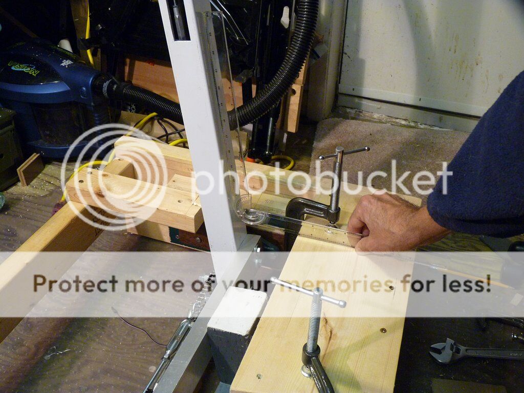

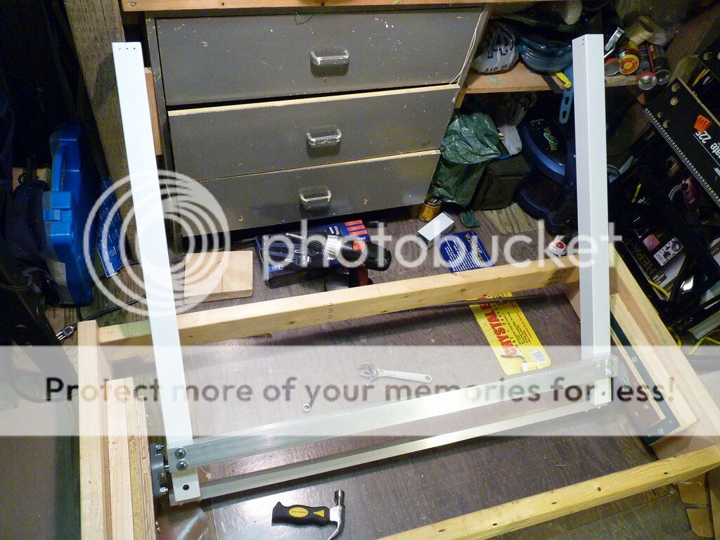

Here is my dual linked yoke system for my sim. I  work on them in my workshop outside the simulator. The wooden box matches the sim's yokes compartment, so the yoke can be just moved into sim compartment later. The whole assembly can also be easily taken out for maintenance.
The mechanical design is based on the info posted by Edward (sluyt050) here:
http://www.cockpitbuilders.com/community/index.php?topic=3614.msg28297#msg28297   Thanks Edward!!
It is not fully completed yet, and I do not have actual yokes right now.

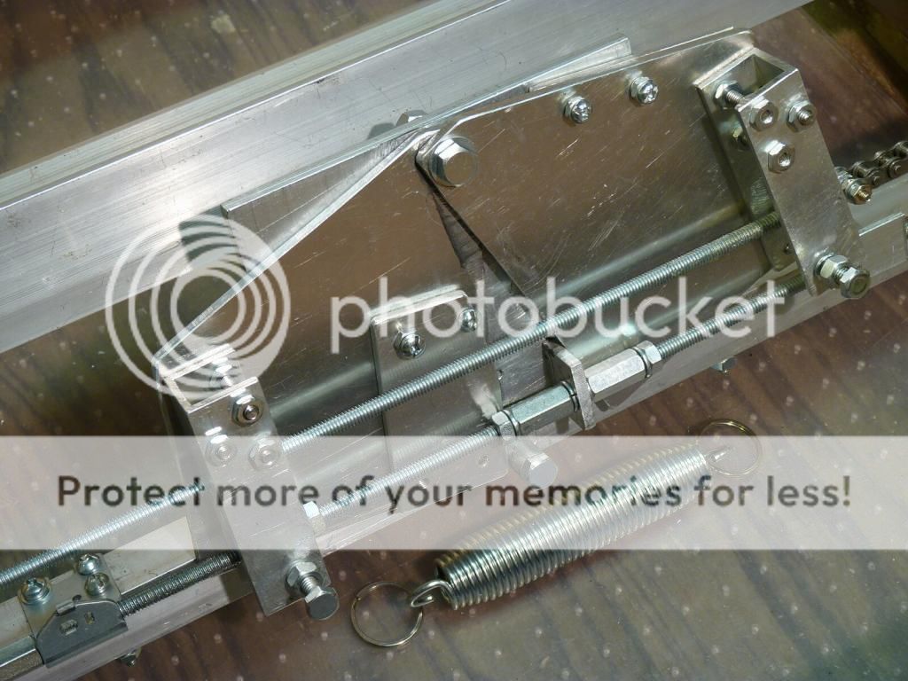

Here are the details:

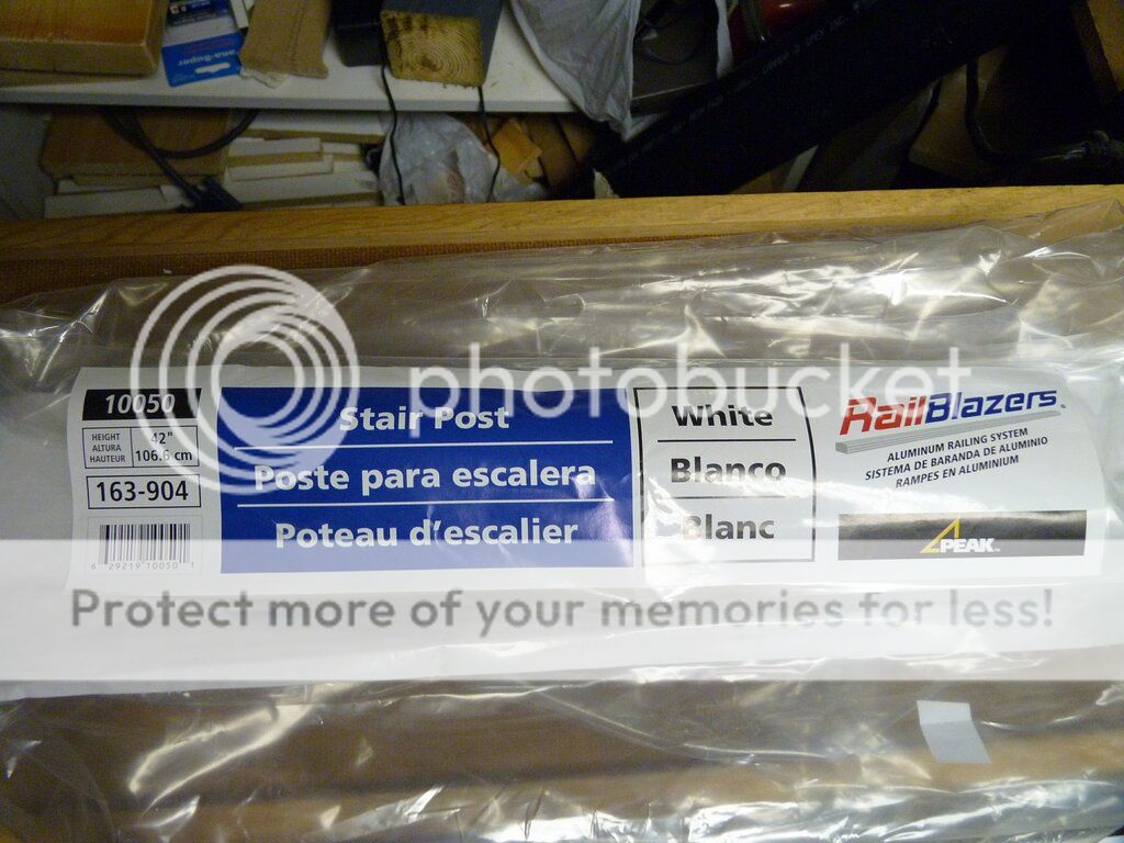

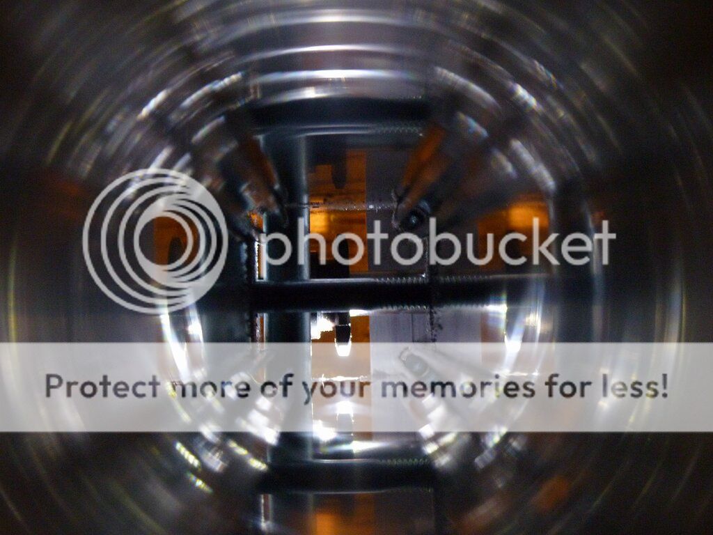

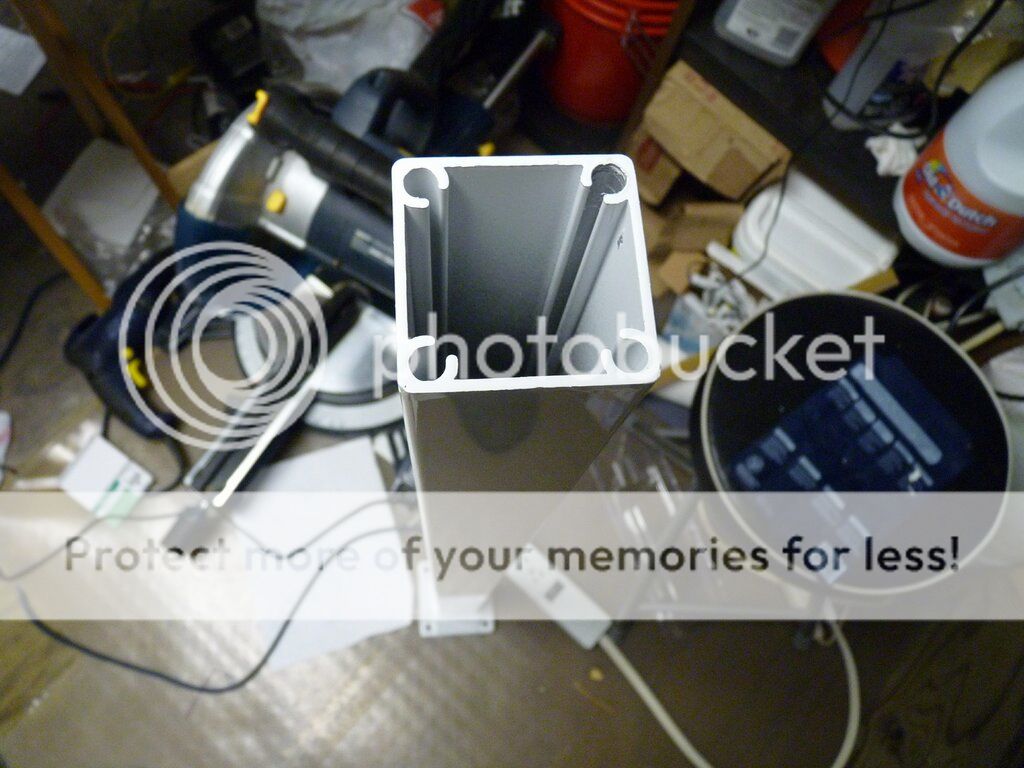

The inner columns made from aluminum railing posts (2 x 2 inches)  from Home Depot.
The threaded rod was temporarily installed for initial assembly and adjustments:
I tried to use all standard details that can be bought in hardware stores wherever possible. The outer columns supposed to be the familiar 3" ABS pipes from Home Depot ;)  Their outer diameter are slightly bigger that 76 mm real Boeing column diameter, but they will do. Especially in the dark cockpit.  :angel:

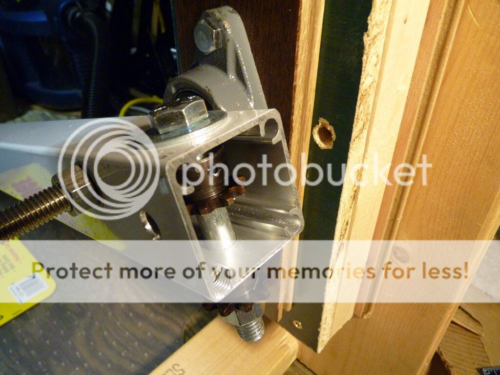

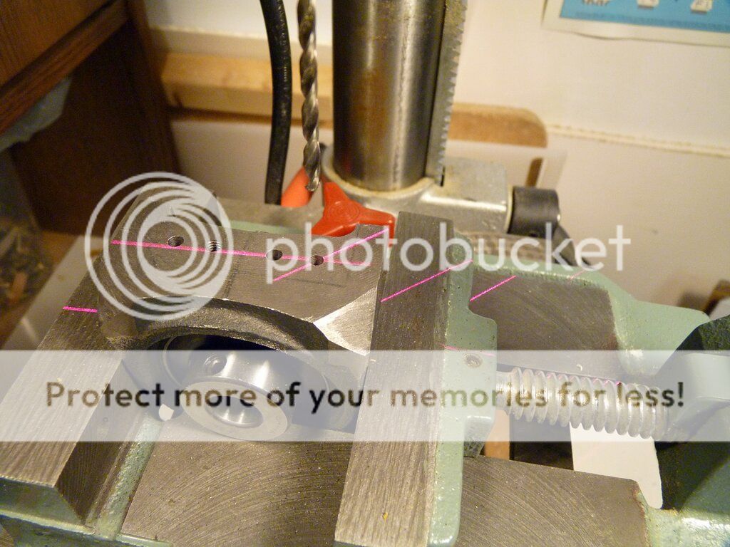

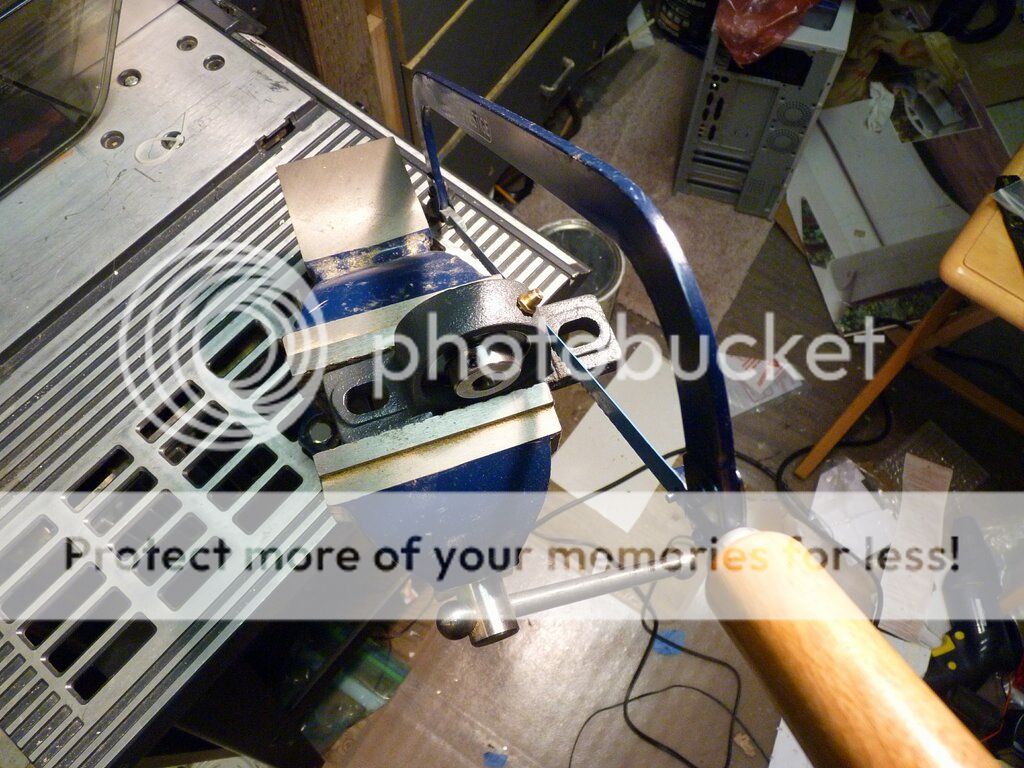

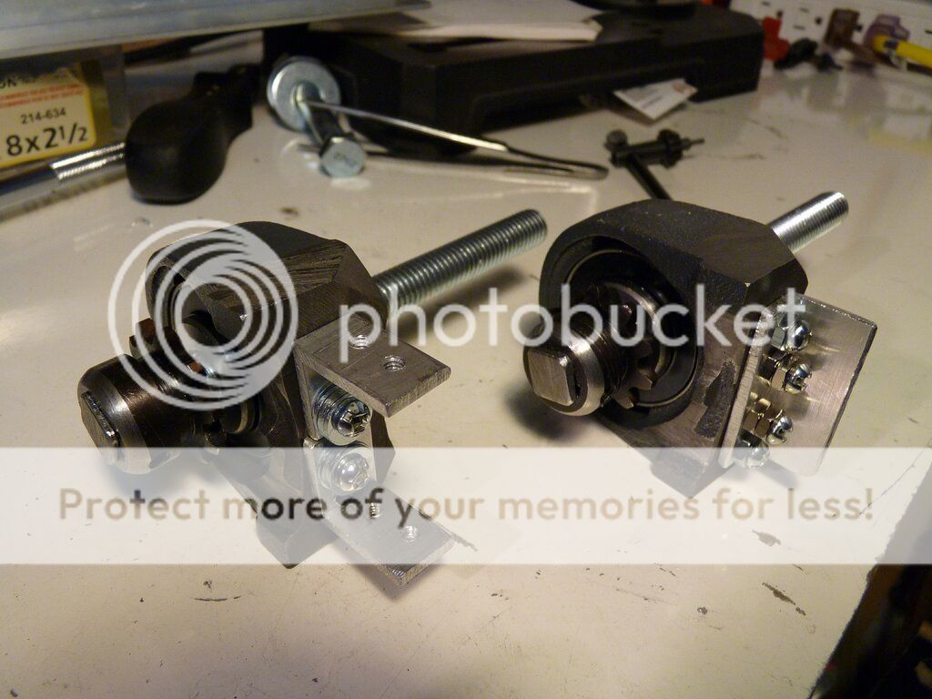

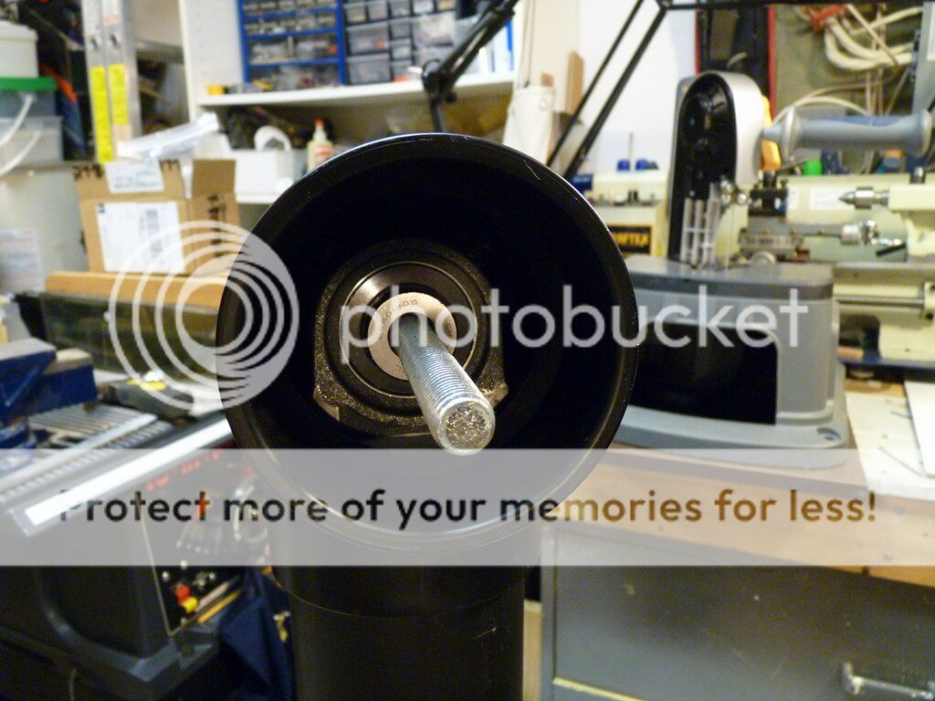

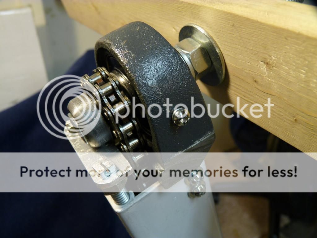

The standard 1/2" bearings used as top column units and for bottom fittings.
Sawing off the bearing "ears":

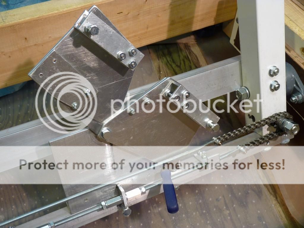

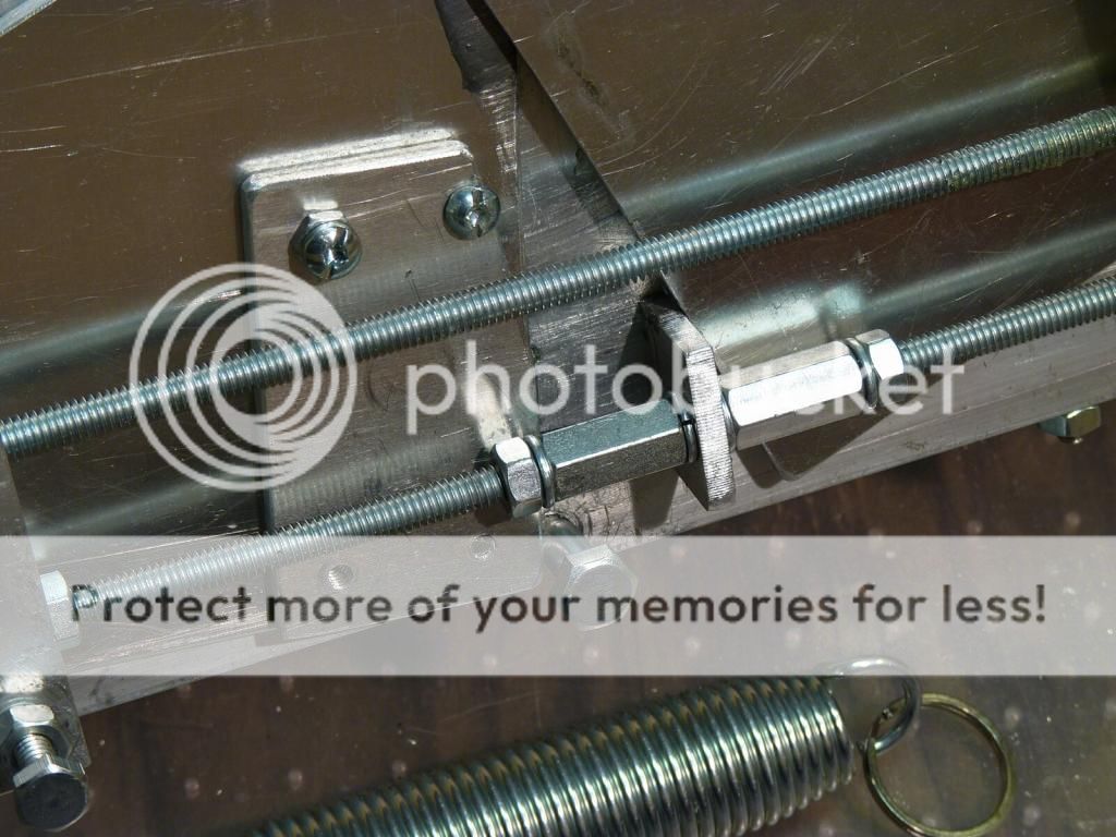

There are six 10-tooth chain  sprockets used with two  #35 chains. Two sprockets for the chain inside each column and two sprockets with the chain connecting the columns. Each chain  has two turnbuckles installed for adjustments (thanks for the tip about installing two, Edward! )

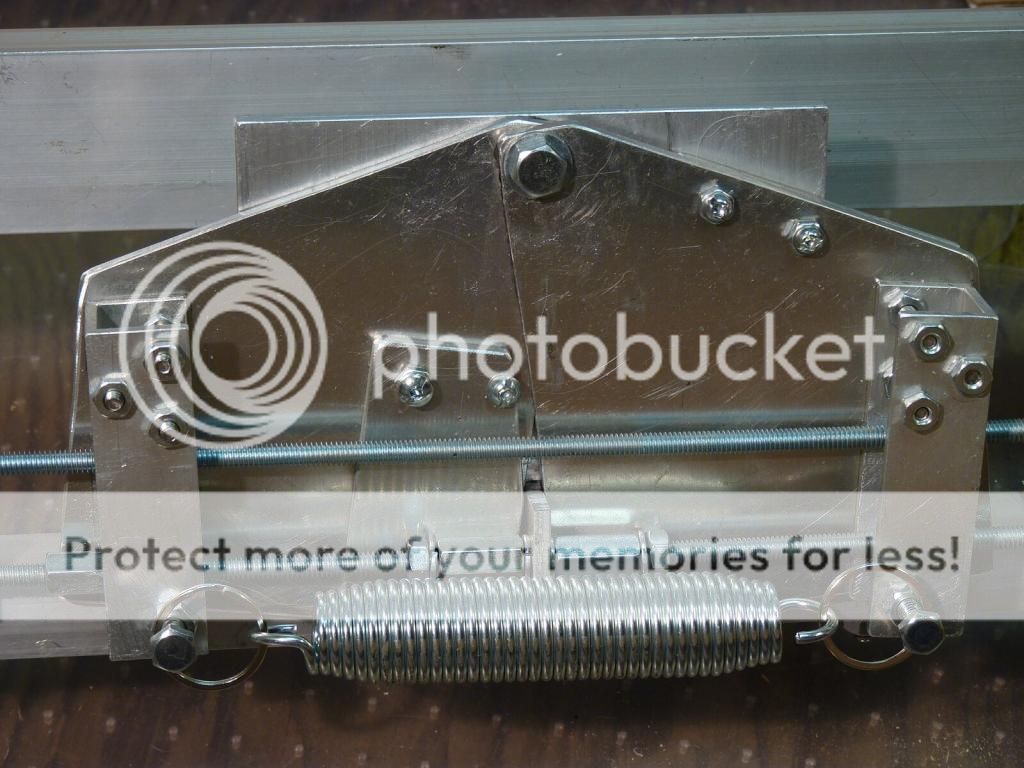

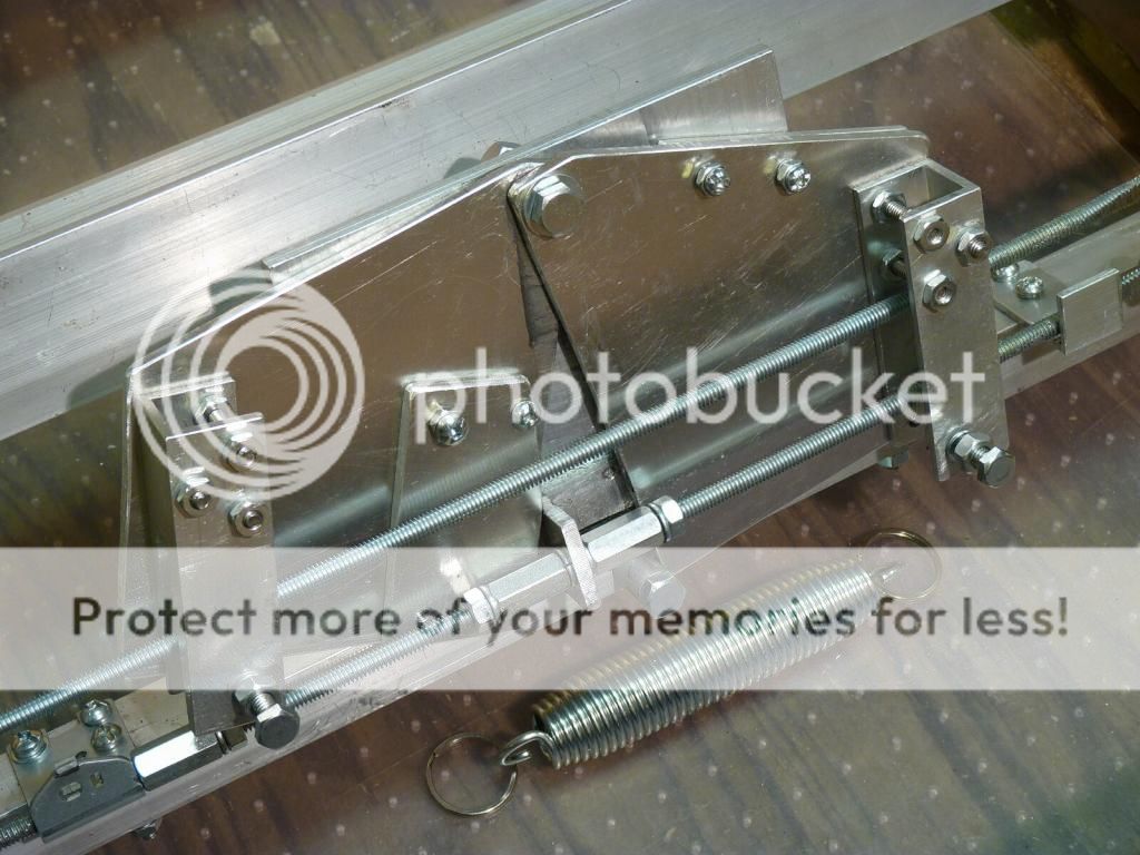

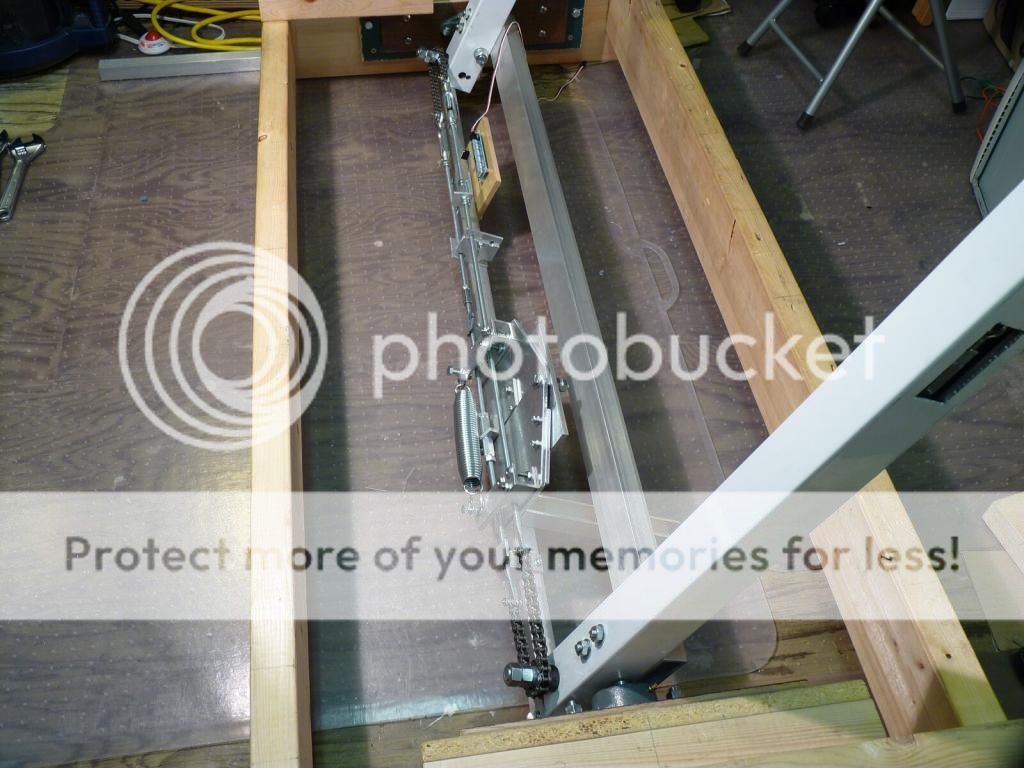

The mechanism works the same way as in Edward's case, however the design is somewhat different, adjusting to my local dimensions and requirements. I had only 200 mm gap between floor and simulator base floor, so I had to fit the mechanism there .
Turn left (spring removed for greater visibility):
Turn right (of course, depending where from you look at it  ;) )

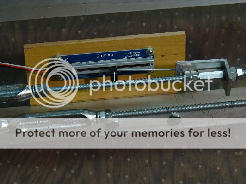

Since I used sliding (60mm) pot from Phidgets, I had to allow ~50 mm linking mechanism  travel to simplify pot's movement.
In this video you also can see the sliding pot movements:

Thanks for your detailed presentation. I choose for a similar approach some time ago. One remark: from the film I got the impression that the spring is quite light. The roll pressure as per the Boeing maintenance manual should be +or -15 pound
(ref. http://www.flaps2approach.com/journal/2012/8/2/construction-commenced-new-platform-to-mount-b737-yokes-colu.html).
Good luck with finishing your yokes.
Edward
Quote from: sluyt050 on November 26, 2013, 12:45:11 AM
Hi Nick,
Hi Edward,
The spring I bought was marked as 16 pounds. I did not measure its tension myself - will try. Your spring actually looks more solid to me.
Thanks again,

Hi Nick,
The spring should be much heavier than 16 pounds. You have to take into account the momentum ratio. For your information: I have about 12 lbs force measured at the yoke. In my configuration this requires a spring of approx. 126 pounds max. force (spring constant = 43 pounds/inch). Yah, I understood it really requires muscles to hand steer a 737!
Edward

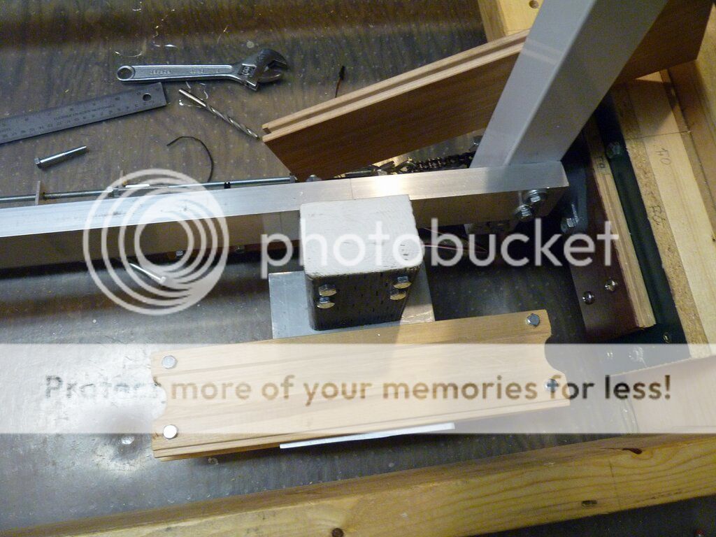

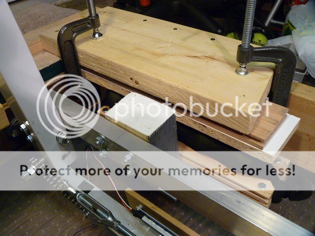

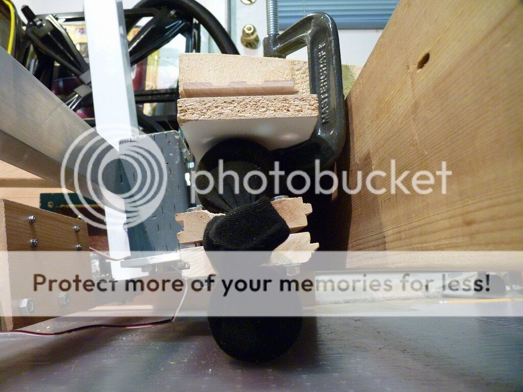

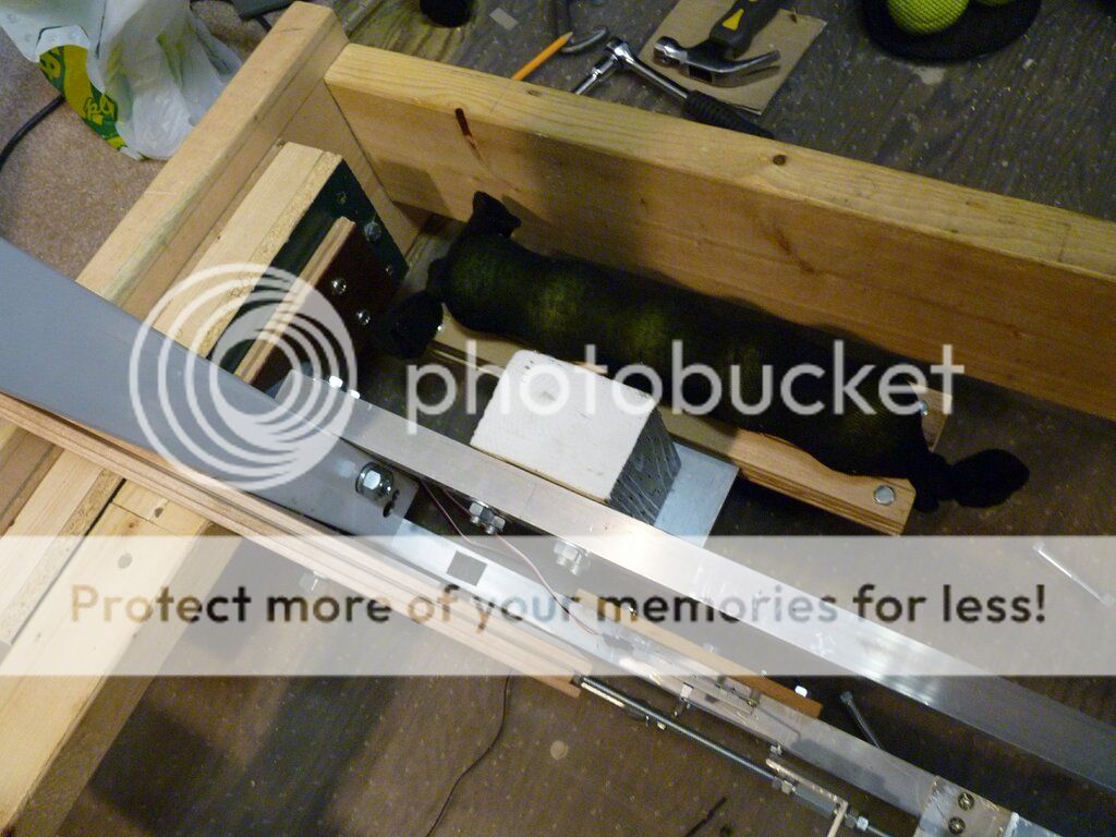

Here is my pitch amortization design. No springs, no gas springs. Then what?
A pair of socks and tennis balls.   :P
6-mm aluminum plate fixed between two hardwood pieces. Pieces may move in front/back direction - that's the way to fine tune the column angle in neutral position.

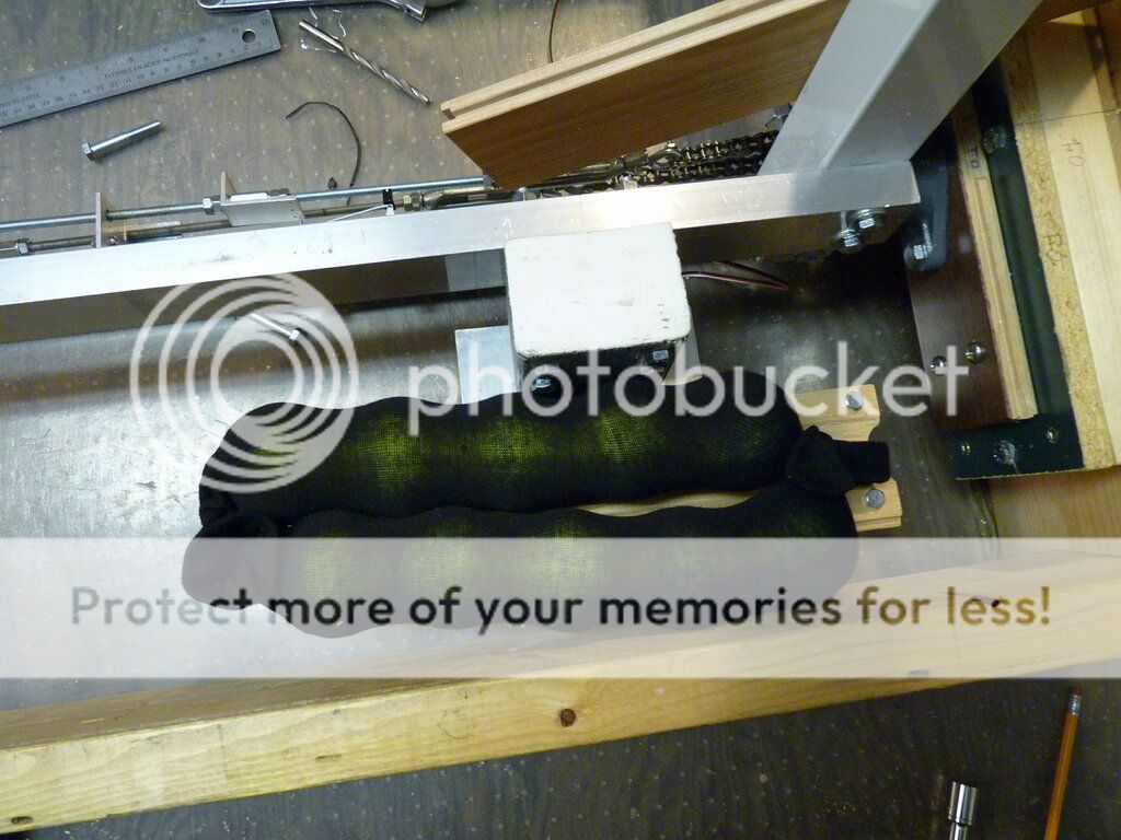

Two socks with 5 tennis balls each.
Socks are just tied up together and wrapped around harwood pieces. Hardwood pieces have small channels to restrict balls moving a bit.
Lower balls are hitting the floor. Top balls push into the sim platform floor through a couple of wood pieces that regulate the gap. In the neutral position (8 degrees forward) both ball rows are just slightly pressed on.
In both extreme positions the force on the yoke reaches above 40 pounds. The force can be regulated by the number of balls. Can't do more precise measurements as light test frame tends to jump itself.  ;)
Advantages? Cheap and easy. Absolutely silent movement.
Disadvantages? Will see how it will hold the correct neutral position - so far so good (however that's what trimmers are for  ;) ).
Nick   :2cw:

Great balls of fire!!!  :o Amazing use of lateral thinking Nick. Simple and quite ingenious I must say. The key to reliable self centering is not to apply any pressure on the balls while in neutral position.

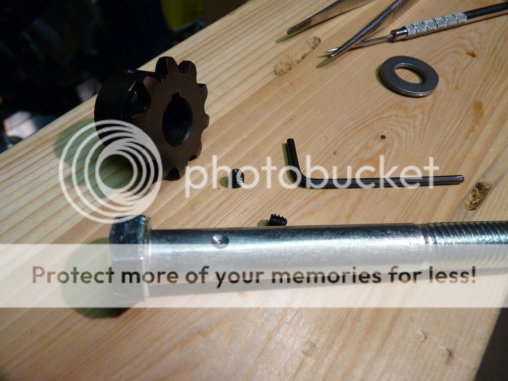

Hi Anthony,
Yes, that's correct - another sprocket is inside the bottom of the column:
Also, note that I drilled small holes in the axle bolt for the sprocket set screws, so they hold better:
It is possible to add some sort of bearings for this axle bolt, however for this version I decided to make it as simple design as possible.

Aha, thats the one. Many thanks Nick and very clear now. Will proceed to start getting the parts together. Good tip on the small holes on the bolt. The outer one does not need them as I think the sprocket will be on part of the threads on my bolts.
