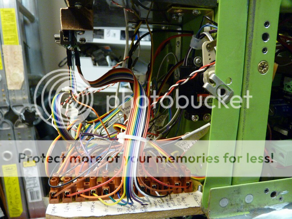

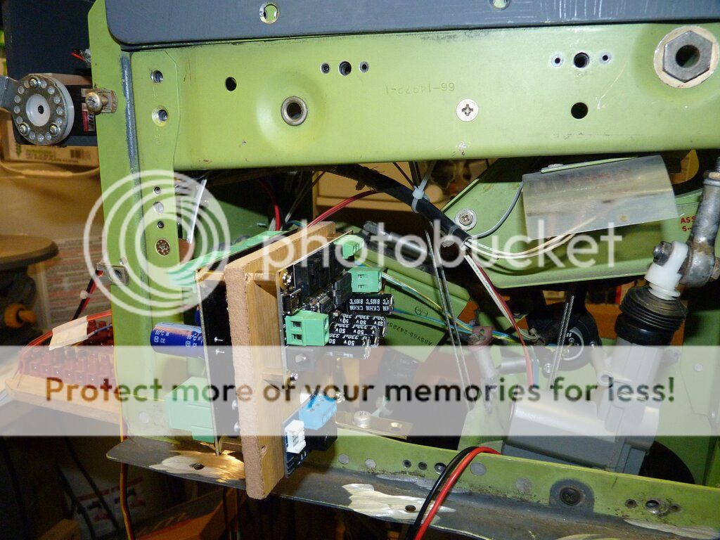

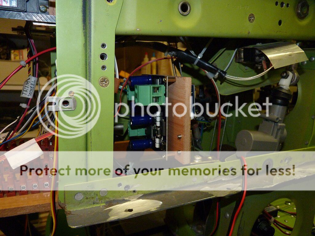

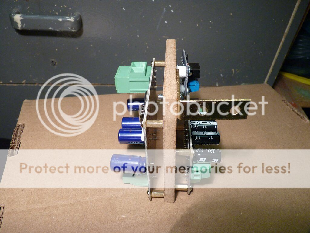

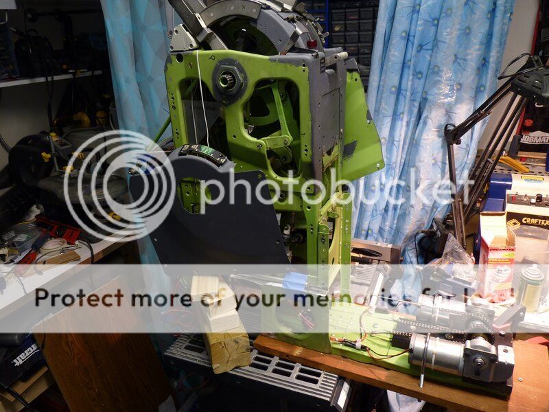

I placed Phidgets motors cards on a small panel that easily swings out from inside the TQ. Servo card is located inside the speedbrake servo housing in front of TQ.

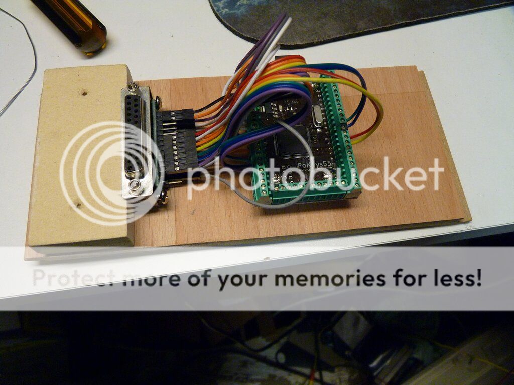

Pokeys card is on the MIP control block, connected to TQ by DB25 cable. Currently I test TQ in my workshop, not in the sim itself, so I just connected it to another Pokeys card.
Throttle levers are run by DC motors (I use 12v for them.). Trim wheel motor runs from 25v. Phidgets Servo card needs anything in 6-15 v range, so I also feed 12v to it.

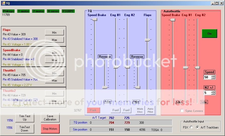

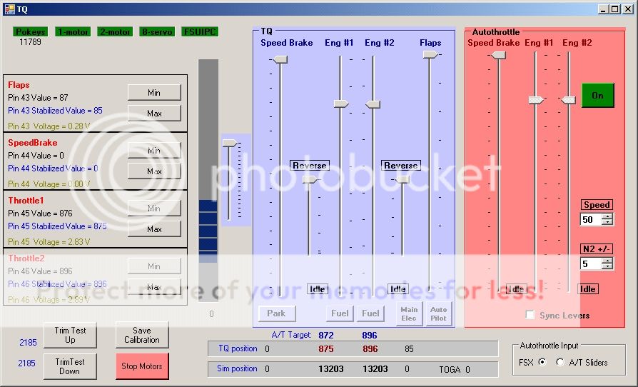

Here is current interface version (changes every day :) )
Four boxes on the left represent the analog inputs from TQ pots. The necessary number of inputs is defined in configuration file and the controls are  created dynamically. So, if tomorrow I want to add another analog input, I just need to change the app.config file to tell which Pokeys analog pin is used for new input and automatically will have all monitoring info on screen in additional box. Application supports both USB and Ethernet versions of Pokeys card.
Since analog pots always have also some "noise" and readings are fluctuating, I use so called "rolling average" value (calculated from last 10 readings) for pot position reading.  This is the  "Stabilized value" in screen above.  Smoothing gets the reading value fluctuations down to +/- 1 range. In addition to  rolling average smoothing,  there is also another smoothing level for throttle levers. The motors will react only if the lever movement is over the threshold parameter, for example  +/- 3 from current position.
The box in the middle represents the actual TQ and the sliders move when TQ  levers move.
The box on the right represents autothrottle  functions.  Autothrottle input  is switchable from FSX input to input from sliders (trackbars) in autothrottle box. That mode is typically used for testing or demonstration of levers movement. The levers can be activated from it separately or synced to move together. The advantage is that I do not have to run the actual flight in FSX in order to test the logic or algorithm changes. In fact, the application autothrottle logic just reads the position of autothrottle sliders to command the lever motors.
When in FSX input mode, the  FSUIPC throttle read values just assigned to the slider position value. All necessary FSX offset values can be monitored in screen. For the throttle levers the application reads from FSUIPC offsets 088C, 0924 and writes to offsets 089A, 0932.

Here is the latest version of program interface:
See the trim wheel?  ;)  Trim indicator is not working yet - next step.

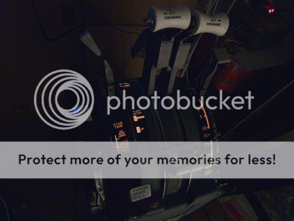

Just finished interfacing the trim wheel and trim indicator. Trim wheels are two-speed now, I will think about the logic I need for 4 speeds.
Trim indicator works through the Phidgets 1061 8-servo card. Currently I have only 3 servo for it - trim indicator, speedbrake and flaps indicator.

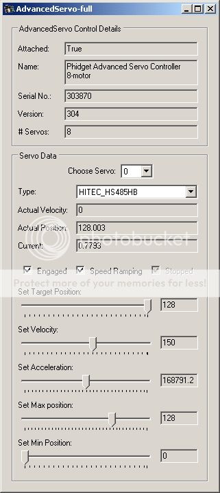

Configuring servo for trim indicator was very easy. I used Advanced Servo-Full test project supplied by Phidgets.
All I needed was to run it, select the proper servo from the list, click on Engage checkbox and move the Set Target Position slider to find out the proper needle movement range. In my case full needle range from Nose Down to Nose Up is 0 to 16 which corresponds the servo position range 128 to 0).
Then I just wrote the code that recalculates the trim position into servo position.
I read trim indicator position from ProSim through custom FSUIPC offset.
I have relays that turn servo power on/off, however looks like they are not even needed with Phidgets servo object that has .Engage property for the same thing.
