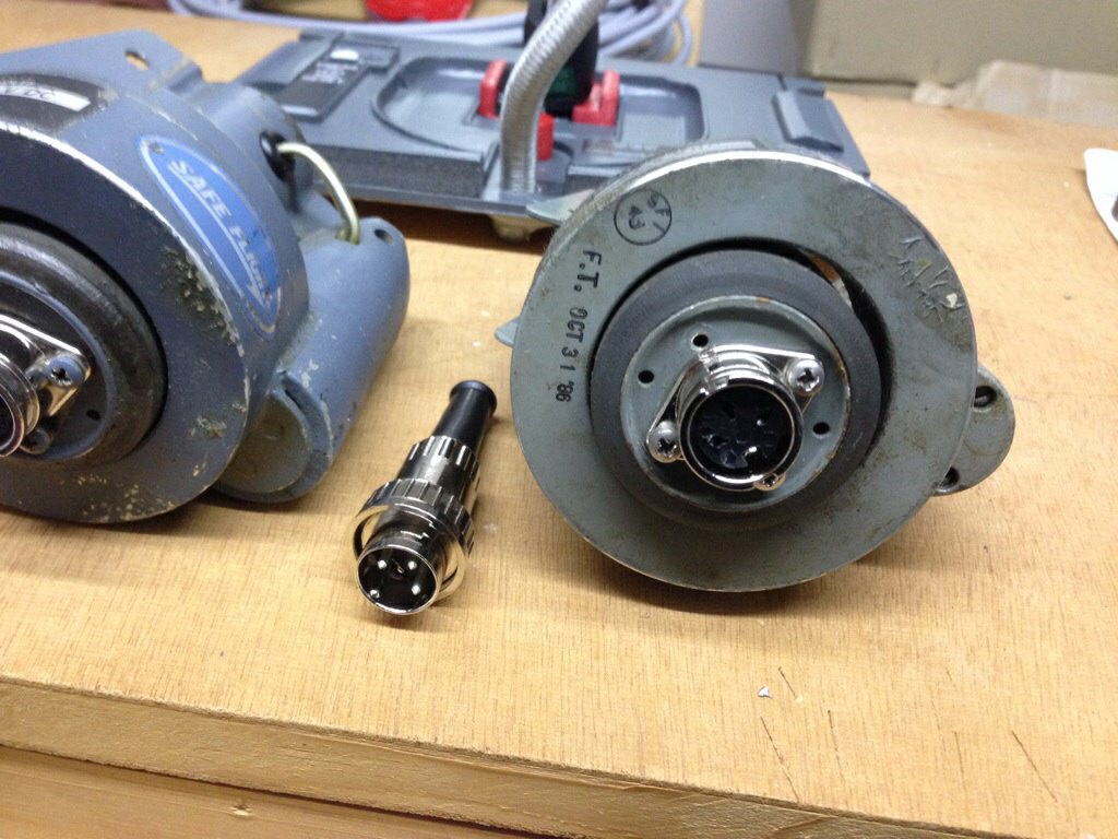

andthiel
Gwyn,
have a look here:
http://www.angelfire.com/il2/aphs/forsale/forsale.html
If there is nothing what you are looking for, send an e-mail to Cpt. Nick...
I bought mine from there and made some changes to get them work again:
Cheers mate - best regards from Germany to Down Under,
Andreas
Cheers,
Andreas
Best, Andreas

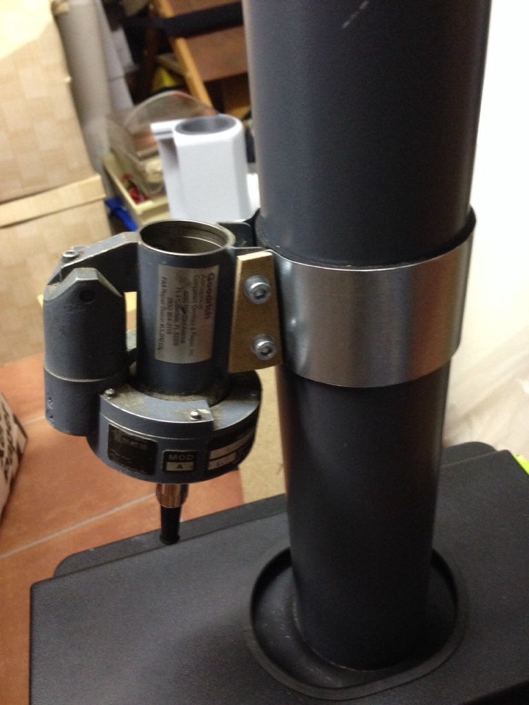

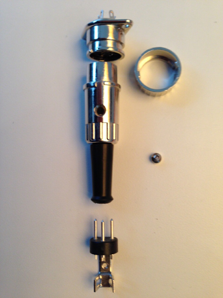

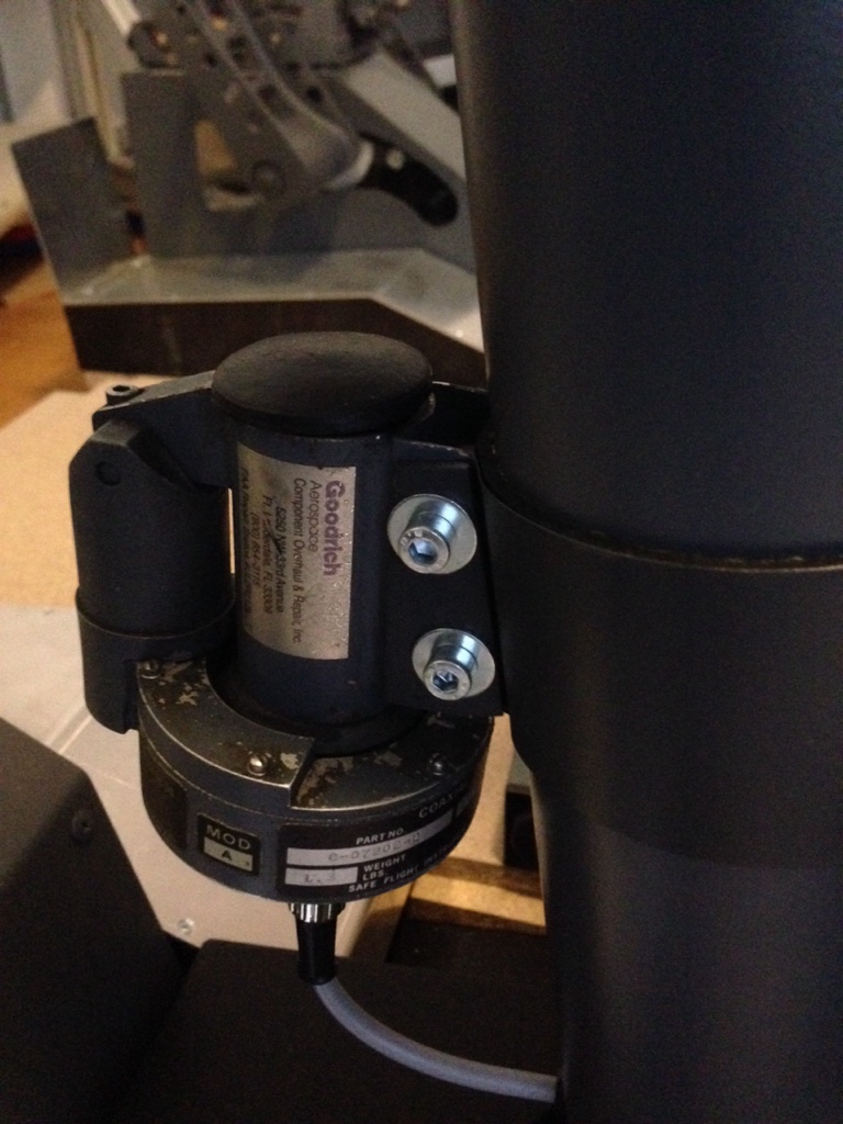

andthiel
Gwyn,
have a look here:
[img width=112 height=150]
Andreas
Cheers,
Andreas
Best, Andreas
andthiel
Sorry, the last pic from my first thread was not mine, I mixed it up when choosing from very small thumbs.
Here are the right ones:
Cheers,
Andreas
Best, Andreas
