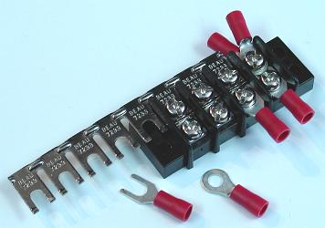

A common method for ground wires it to connect them from one component to the next in a daisy-chain fashion, so you have one wire that goes from switch to switch instead of individual ground wires to each of them.
RayS
Soldering skills.... It does take practice....
http://www.amazon.com/Elenco-SP3B-Practical-Soldering-Project/dp/B0002LUALG
As you build you'll notice an exponential accumulation of wires that need to be grounded or otherwise connected to a power source.
I have about 12 of these in my sim:
They work beautifully.
Ray Sotkiewicz

Ah smart! connecting all the ground component by component seems easier than my "rale-thing".

RayS
#18
You can see here in the bottom center the power distribution. After it is all said and done I am still in a bit of shock at how many terminations there are to power!
It has:
2 Ground rails
1 5vdc "Always On" rail
1 12vdc "Always On" rail
2 12VDC "Switched" power rails (Only 'on' after I turn on the BATT switch)
1 5VDC   "Switched" power rails (Only 'on' after I turn on the BATT switch)
The switched rails are controlled by a relay card that uses TTL logic inputs.
The workflow for the BATT switch:
BATT switched connected via joystick card directly to X-Plane (Leo Bodnar's BUX card) --> XPUIPC connected to X-Plane --> RUSCOOL's 64-Output card --> Turns on Relay channel on Relay driver card --> connects 12vdc power to Rail(s)
Seems convoluted. Why not just use the switch itself to provide power to the 12VDC rails? I tried that but I also wanted the systems logic that turns on other related systems within the aircraft (Like flaps won't work unless BATT power is on)
Another thing to keep in mind is current draw. Make sure those primary power cables are thick enough to handle the load. Also make sure your power supplies are beefy enough. I've blown up more power supplies than I care to admit because I underestimated power requirements.
