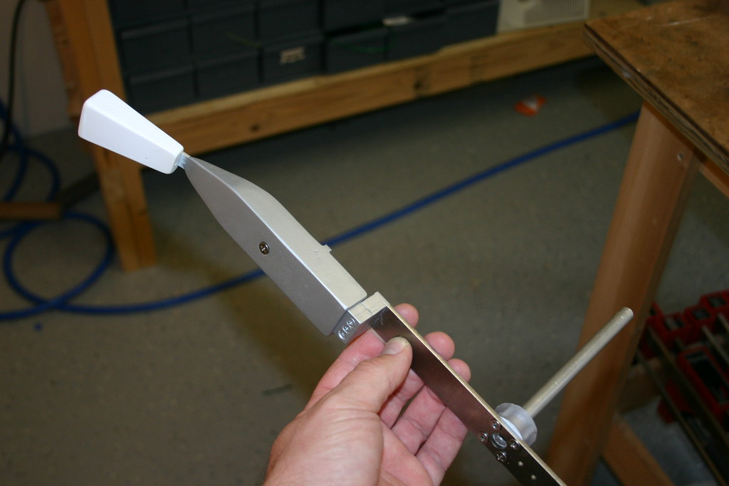

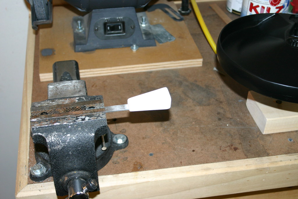

Thought I would put up a little thread chronicalling the build of my Simparts.de 737 Throttle Kit.   I made the choice on Simparts primarily based on price for the kit and the fact that it is almost all metal (steel and aluminum).   I also like the idea of the kit because I could throw my own level of detail in it and also know how to replicate any broken parts down the road and be able to maintain it myself.   I will say that after the Revolution guys changed stuff out to metal parts I was a little jealous as that is one beautiful TQ.   I also think they are great communicators and very responsive to questions.    I will say that Jorg at Simparts has been really great as well.   The Simparts thottle does not appear to be fully to scale as the handle seem a little larger in scale when I compared to the Marcus measurements.    I believe Ivar has a Simparts throttle quad and pointed this out.    Other than that, this thing is built like a tank.   I was very surprised when I unpacked the parts to see the main part of the throttle handles was actually heavy gauge STEEL!   I was thinking it was going to be aluminum.  No messing around here folks.  These things are industrial strength and very heavy.   Many of the other parts are steel as well.     The Trim wheels and handle parts appear to be molded and the mold material doesnt seem to like paint too well.   My auto paint really bubbled at first but seems to be working after a little finesse.  I had used plastic adhesion promoter on the parts and this is probably some other type of epoxy resin based mold so probably better to use an epoxy based paint.   You also need some pinhole filler to clean up some areas.  That said, they are molded beautifully and I am really impressed with the quality and how parts fit together.   Well enough for now.  Here are some progress pictures.

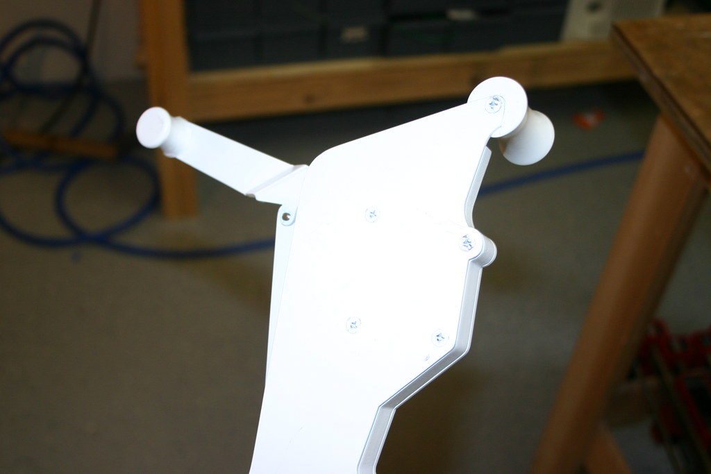

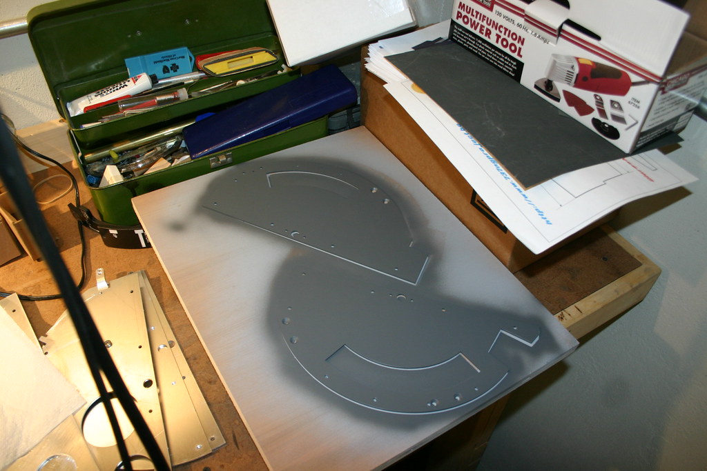

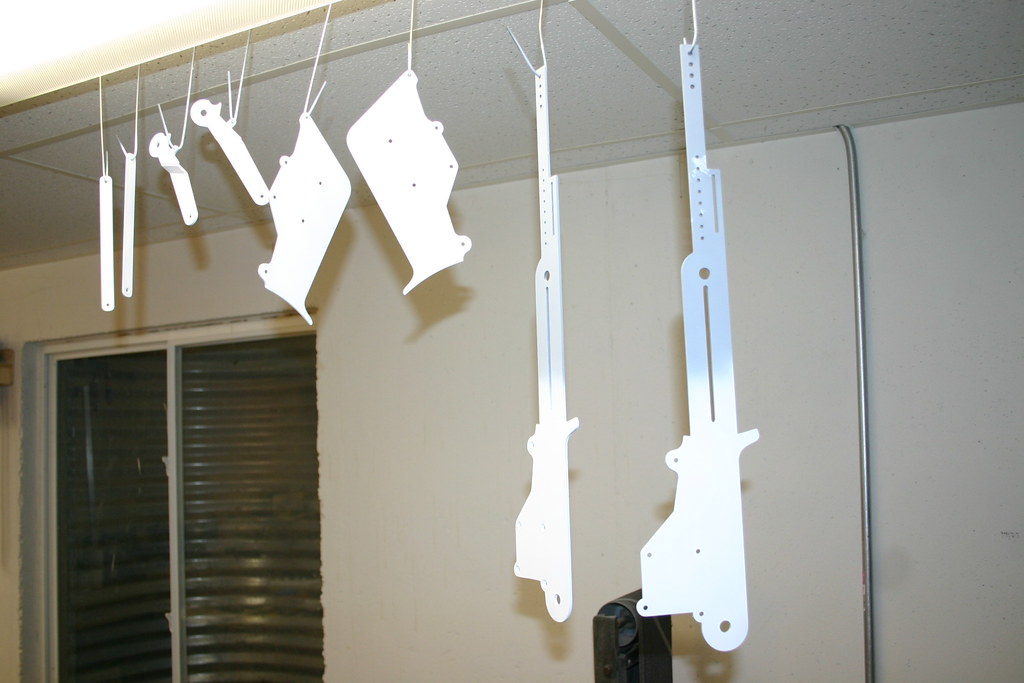

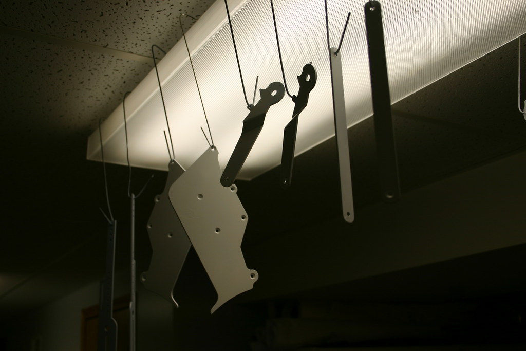

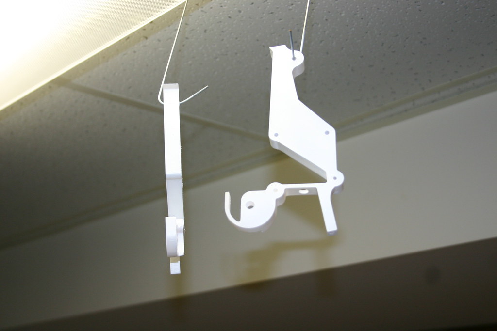

Here is the latest progress on the Simparts Throttle build.
Don Harrison (my co-pilot) is building this portion.   This is his handywork from last night.  Thanks Don!!
Full size pictures can be seen in my 737 photostream on Flickr.

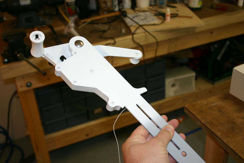

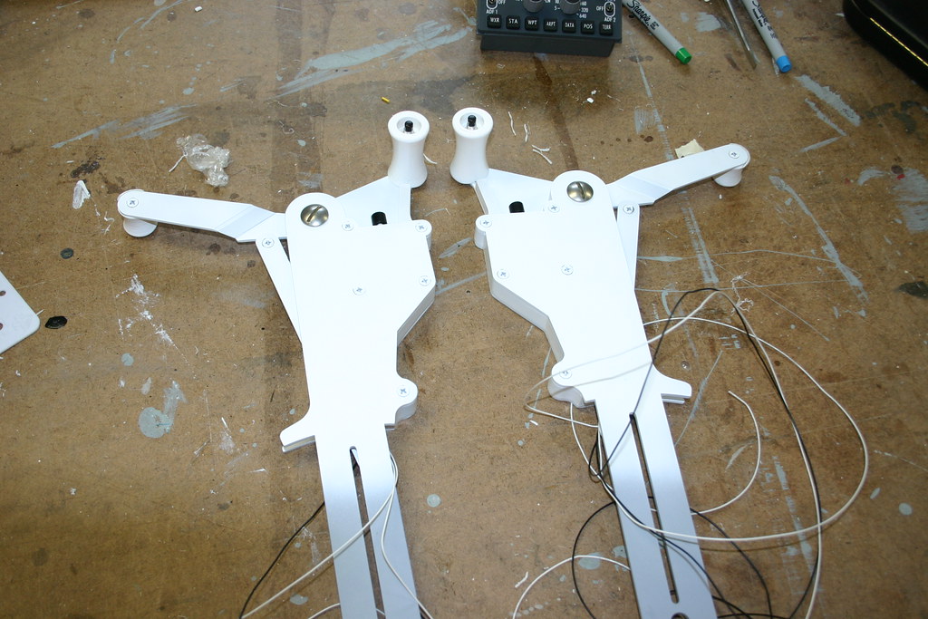

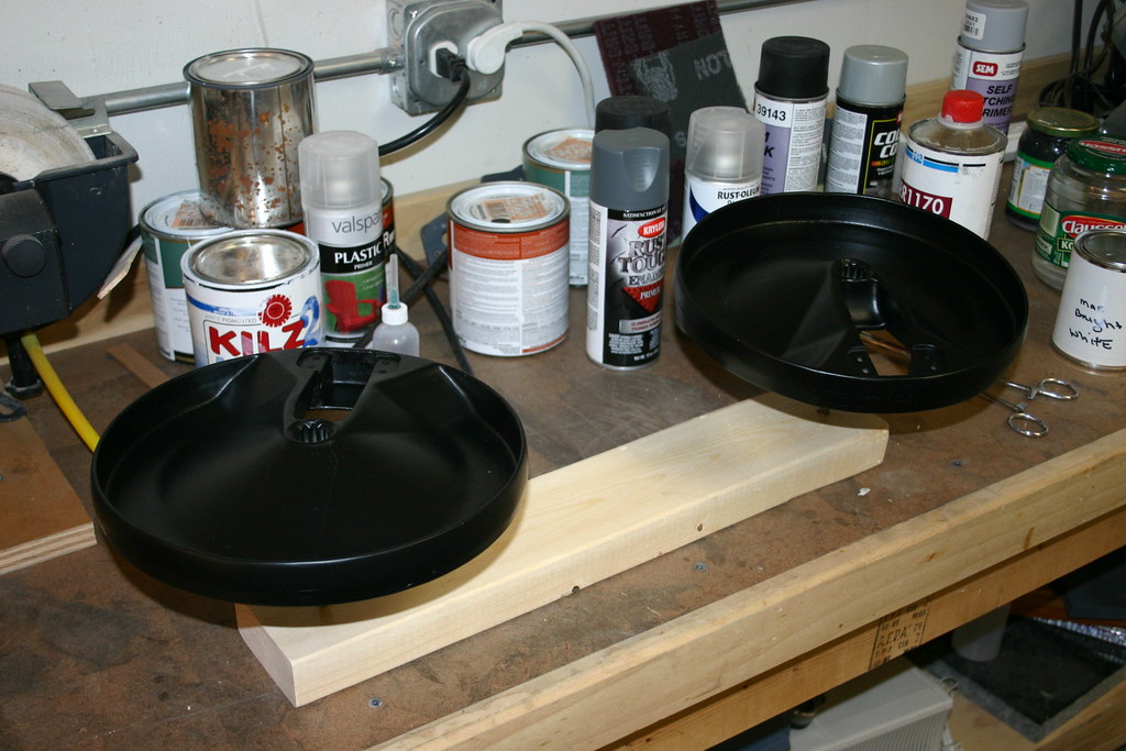

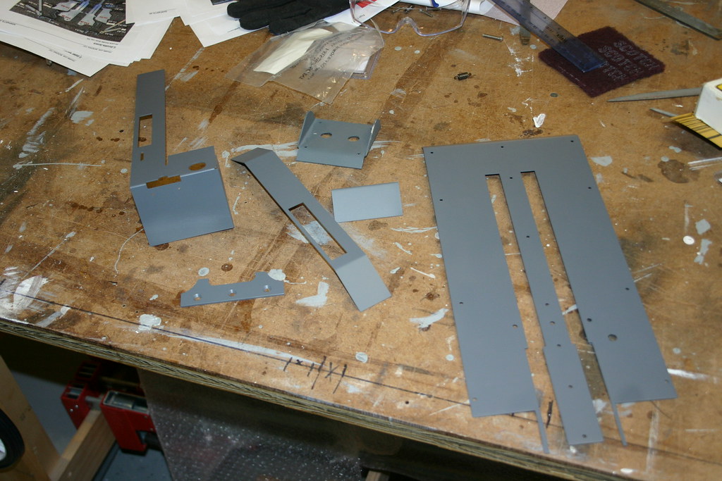

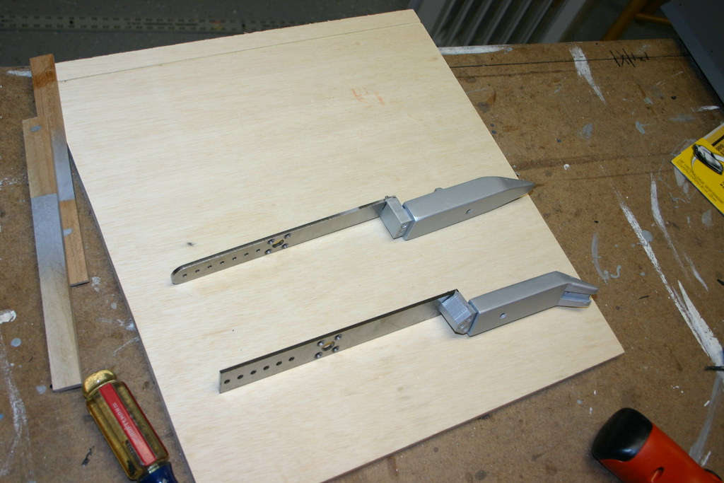

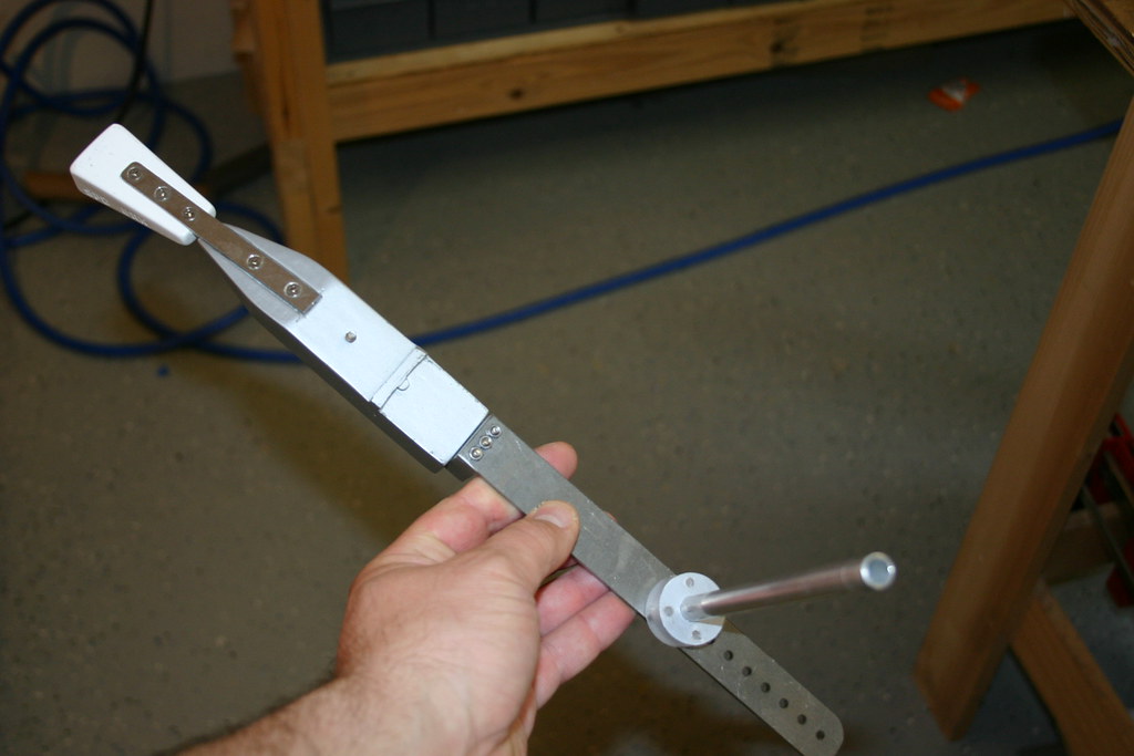

Thought I would post some more pictures of the Simparts.de TQ build that Don Harrison has been working so diligently on for the past couple months.  It is just about complete.  We only have to hook up some Phidgets cards now and program it.....only...
I will say that this is one heavy heavy heavy duty TQ kit.    Instructions are not that good and takes some ingenuity to assemble but the quality and design is excellent.   It is built like a tank and Don and I are really happy with the product.

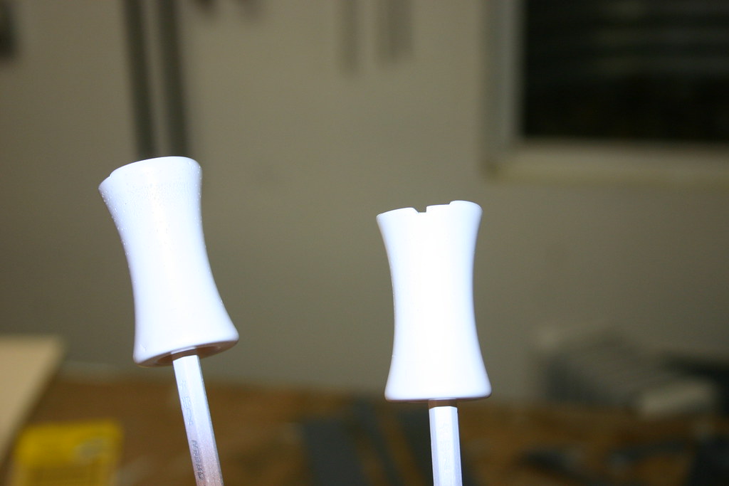

Question about the Throttle handles, how do you plan on putting the legends on the handles? Engraving or stickers for them? Reason I ask, i have a set from simparts as well and not sure how or what to do for that.

I will try to answer what I can and maybe Jorg from Simparts will be on and can answer some but I know the trim wheels and the TQ handles are not to scale to the real ones.  Both are oversized a little and I dont know why but that is probably just what Simparts came up with when they introduced it.   The handles for the Flap, full cutoffs,  an Spoilers were pre-engraved but not the throtte handles.    I havent thought about the lettering much on them as it wasnt really that important to me and a sticker would probably be fine.
