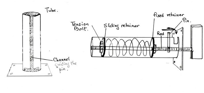

1) General principle

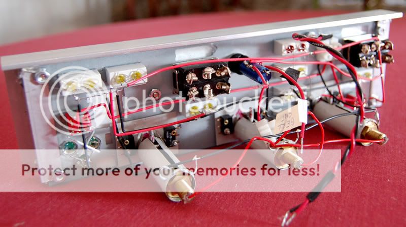

A threaded rod which links at one end with the Handle is inserted in a tube, with a spring contained between a sliding retainer (which moves in the tube) and another one fixed to the tube. .
The tension of the spring is adjusted with the bolt holding the sliding retainer
Another bolt. on the other side of the fixed retainer limits the travel backward.(See diag..sorry for the rough drawing))

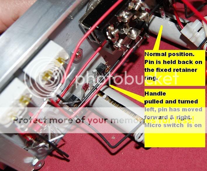

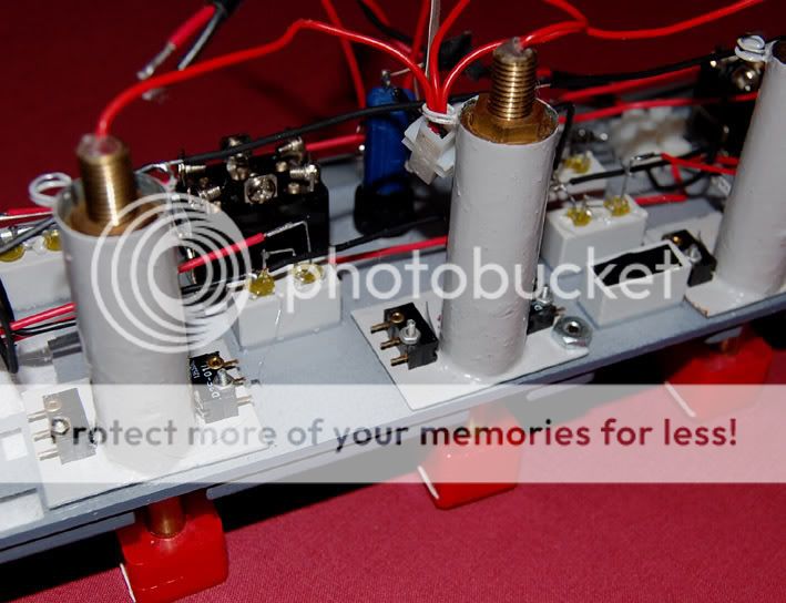

2) A pin, inserted in the rod, travels forward and left or right in the T shaped channel of the tube, guiding the Handle to do what it is supposed to. (being pulled and turned either side)
Two micro lever switches allow interfacing. (See Pic)

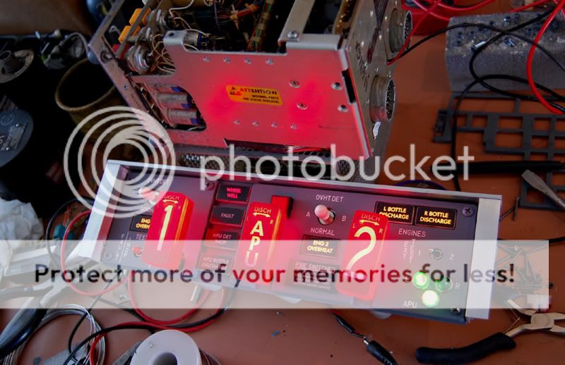

3) Handles are made of layers of plexiglass with embedded LEDs and the top part is engraved.
