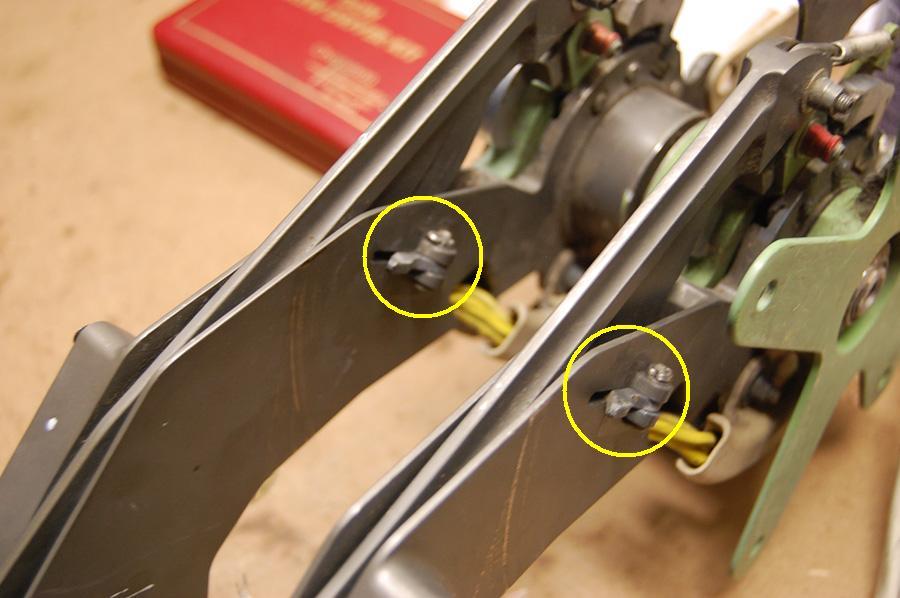

Besides Could you tell me what these two guys are for, they do not move when the reverse lever is cycled, should they ?
tomenglish2000
Hi Jack,
Happy to help.
Those two little things are the lever reverser locks. When you pull the reverser lever up those pop out and hit against a piece of guard metal.
These serve two functions,
When the regular levers are forward of idle, they hit against the guard metal and prevent you from pulling the reverse levers. Otherwise the throttle linkage would reduce throttle away from the main lever position.
When the forward levers are in idle, they extend behind the rear of the guard metal when pulling the reverser levers and that prevents you from pushing the main levers forwards while the reverser is deployed. The forward levers are locked in the idle position by this until the reverser levers are stowed.

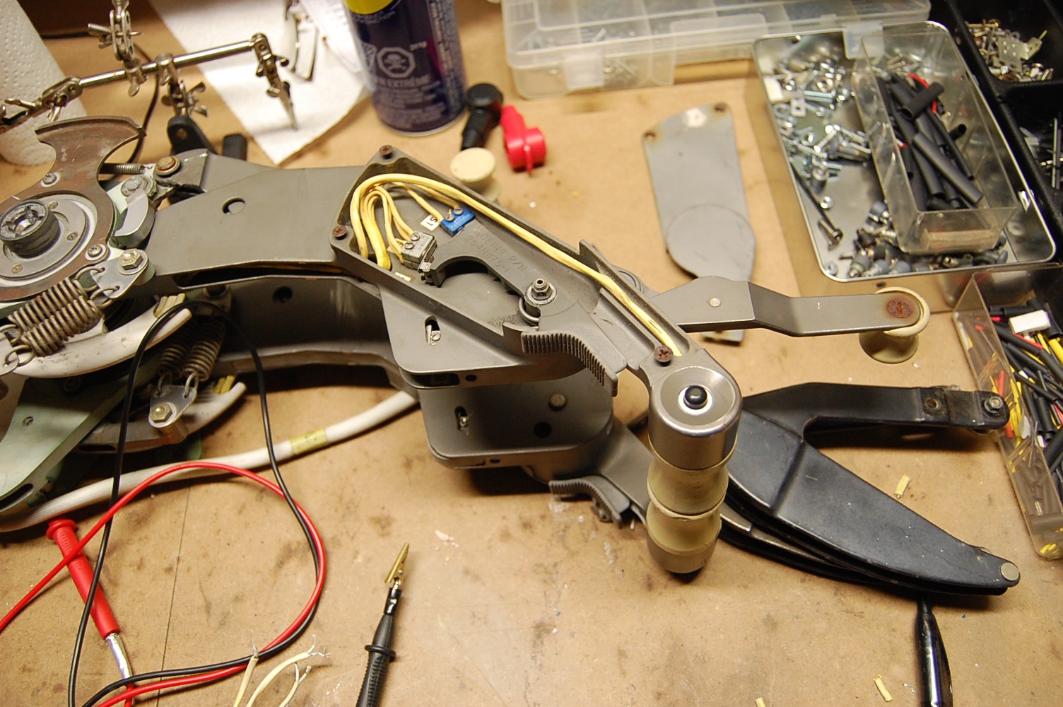

REV switches are inside the lever (arrow)
Do you know the use of the "skate" circled in red on the left (friction device)?
Thanks for your input
tomenglish2000
Hi Jack,
I completely forgot those switches were there! I believe they are independent. Not sure why they arent working. Maybe the metal arm has come off them or the switch has failed or something. They should just work. I will have a look at my set over the weekend to see what mine do.
The "skid plate" is actually designed as cam that pushes a follower when either reverse lever is moved up to reverse idle and onwards to full reverse. The follower actuates a lever that raises the spoiler handle out of its down detent so that the spoiler motor can deploy them. This ensures spoiler deployment even if they were not armed.

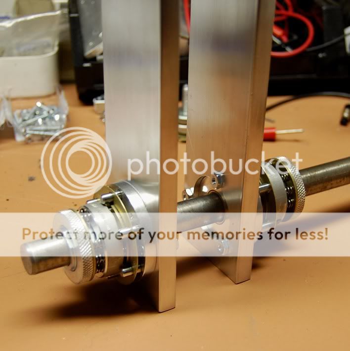

First idea was to separate them to install a new axle allowing a clutch setup for friction, same as my actual TQ which has worked flawlessly so far.
Just an idea though,
How did you manage that friction factor because right now they revolve loose on the axle?
matta757
Jack,
Well since I bought my real 757 sim, I now have the clutch pack that gives the levers their tension. https://flic.kr/p/EDtKLg
But before I had that, I built a make shift clutch pack based on Edoardo and Valerio's design. You can check out Valerio's flickr page for pics... https://www.flickr.com/photos/78279080@N04/albums/72157650785641286
The slip clutches are attached to the arms, which are attached to the throttle rods that attach to the lever arm. Whatever you do, I would strongly advise against taking the levers apart. The way they are built and put together means a rock solid feel, there is ZERO play between them. If you separate them, all bets are off and you could end up with lateral play in the levers.

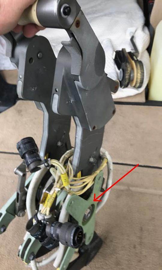

This X shaped bracket:
is used to hold the lever assembly inside the TQ I guess.
I have just one on the FO side
would you or someone  have one available?
matta757
Jack,
Yes that bracket mounts to the walls of the TQ. But there is one on both sides. I do not have a spare unfortunately. If you have no play on your design then it should be fine, I just know that from my own experience, treading lightly and trying to keep things in the OEM condition as much as possible.
