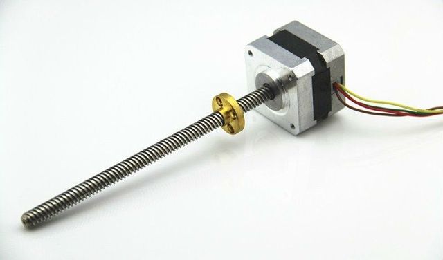

rudder crank with cables ... may i suggest an alternative    give it ekectric motor   might be easier
Cables ?
Linear motion is best obtained with this type of gearing
Can be manual, with a crank, or electrical with a motor
