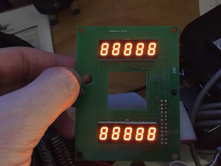

One of the things holding back MIP work- was the assembly of the COM and NAV panels.  I finally picked up some window tint for the displays and was able to get them assembled and installed.
In the middle of doing that I found the microcontroller on one of the Display Cards was bad. Luckily I had a PIC programmer already from my last cockpit project still, so I was able to purchase a replacement chip from DigiKey, copy the HEX code from the working chip and write to the new one.  Both Display cards are operational now! Yay!

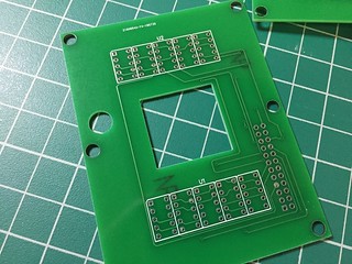

With the radio panels installed I was able to get nearly all the wiring completed as well.  I decided to make a small PCB for making the connection from the Flaps LED board to my custom I/O board a little easier.  So once that board arrives that I think will round out the wiring for switches and indicators.

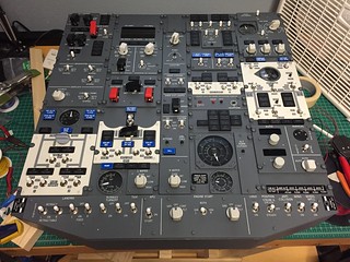

There's been a lot of progress on the overhead since I posted my last update here, but you can find a recap of everything in the link in my signature. But here's the lastest post I made on the overhead build:
While work has been progressing on the Overhead, I got little lazy in documenting it.  So I'll try to recap what's happened since the last update.

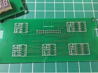

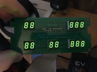

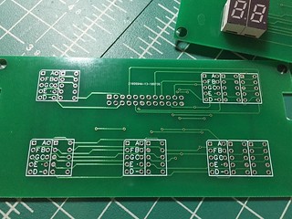

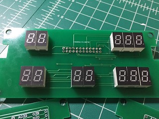

After my I/O cards came in for the Mastercards. I laid out the cars on the back panel and finished working on getting all the panels mounted to the frame.  The last two panels to install were the Electrical and Cabin Pressure Display panels as I needed to design and order some PCBs for them.

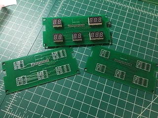

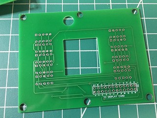

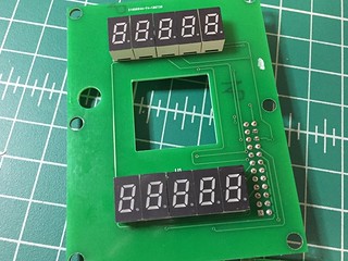

Here's a look at the PCB's made for the 7-segment displays:
The PCBs were mounted to the panels using 1/4" black foam board sandwiched between the PCB and back panel. I didn't take any photos of that unfortunately.  The black foam board helped with stopping light bleeding into the display windows and to hide the PCB.

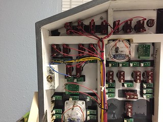

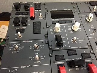

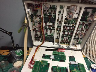

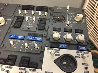

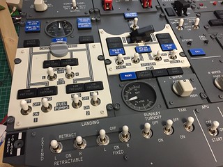

Here's a look at the overhead with all the opencockpits cards installed (though these will be rearranged little to make the boards connected in order 1,2,3 and not 1,2,4), the panels and all the switch covers and knobs:
Next I used black electrical tape to seal any gaps between panels to prevent light bleed. I stuffed the overhead with some white christmas lights I had on hand for backlight testing for this.
Once that was all done, I removed the lights and began the fun process of wiring all the switches and indicators.  I'm currently making my way down the first column of panels.
And that's pretty much it for now. I decided to go ahead and do all the switch/indicator  wiring first and they see how to add in backlighting.So lot's of progress made on the overhead since my last post here.  you can find a recap of of it all at the link in my signature.
