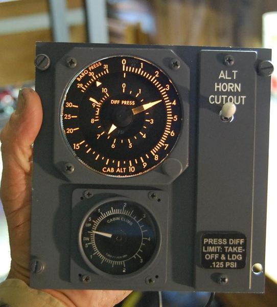

Here are some pics of another project I'm working on. I worked on getting some instruments painted for my B767 MIP. I got these on EBay for cheap and modified them to make them look like the real ones. It took some time with automotive paint and mixing together other paints to achieve a Boeing match. Still need to get the glass face put back in maybe do that this weekend.

Thanks.... I will work on getting more of the MIP populated when more instruments become available. My biggest problem is getting ahead of myself and not taking it slow. I have approx. 80% of the overhead instruments and 50% of the pedestal. Some of the higher price items like airspeed and stand by attitude indicator will have to wait until price comes down which may be awhile. I want to see if a LED strip can fit inside the instruments that you see in the MIP so they light up and if not then under the glare

Jack...I modified the RMI and replaced a few things like the broken glass, updated the frame, removed a few things  like the internal lights from this unit. Here is a picture of it....is it possible to reinstall and have it work?
I actually replaced my instrument bulbs with led's. Just find the size you need. I interfaced them with my FS Nav light fsuipc offset. So when the Nav lights go on, so do my instrument lights.
Goodenough
Trevor that sounds interesting...I will check it out. I figure its easier to stick with something that I know how to do. Here I bought the LEDS off Amazon and connected it to a power source.  Just need help with knowing what the best way is to connect multiple LEDS to one power source and interfacing it with a program like you have. I got the RMI lit....now I need the i struments in the MIP lit.
Not sure about the leds.
The best is to keep it as is ( do not remove lighting) with the 5V bulbs.
I have some real gauges on my MIP and OVH, all with internal OEM lighting.
Just use a relay card and interface it as Trev suggested.
Below are two pictures with the devices I use. Same idea as what is in your gauges. Mine just goes on the outside of the gauge.
My interface cards can drive 2 leds on each output. So I just put them in parallel.
The led strips you have are designed for 12V. That will be tricky on your interface.
Jack is right though if your not interfacing your lights and just connecting them to a 5v Switch. His idea is better.

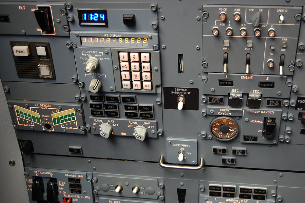

Here is what it looks like in the panel.

Looking good!
This is what I like to see...when OEM projects make progress lol!  ;D
