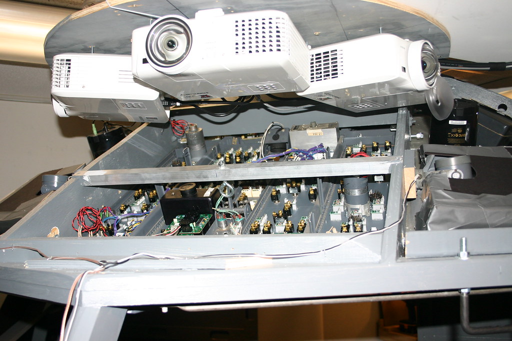

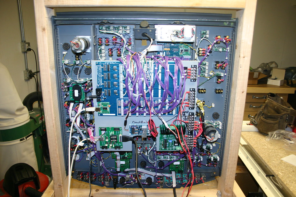

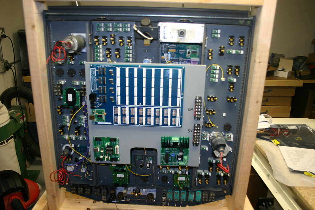

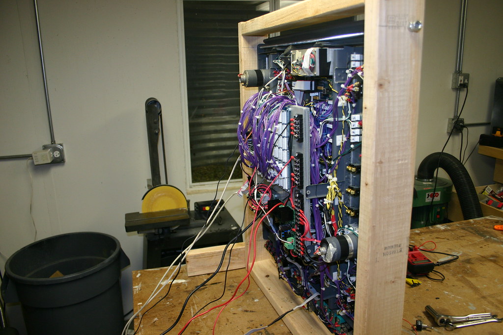

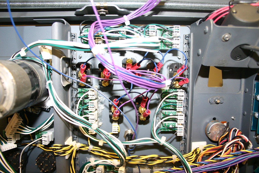

Well I finally got down to wiring the fwd overhead over the weekend.   After about 3 full days worth or work I am happy to say I am finished wiring!  Here are some pictures...
The first is a shot of test fitting the overhead into the pit to check clearances above it.   The second shows how the boards including the Flightdeck Solutions SYS1X board for interfacing are mounted.   All wiring harness will come over the top edge and down onto the board.  You can also see how the dimmers and power strips for the FDS IBL panel and guage lighting are layed out.     The third is a picture of the wiring completed at 1:30 am this morning.    The last is a close up of some of the wiring.    There are a lot more pictures on my Flickr Photostream here:
http://flic.kr/s/aHsjobjsVM
I will post more pics tonight or tomorrow after I finish putting board back on and interfacing on the bench with Interfacit and Sim-Avionics.
Enjoy,
Way to go Scott. Very neat & very professional. I guess procrastination may have been worth it after all since you probably spent a great deal of time figuring out the best way to do this rather daunting job :)
jetpilot
Great Job Scott,
I am glad I will be able to enjoy it this coming weekend.
Looking forward to seeing it in action
Roberto
Thanks guys... back to work on it now :-)

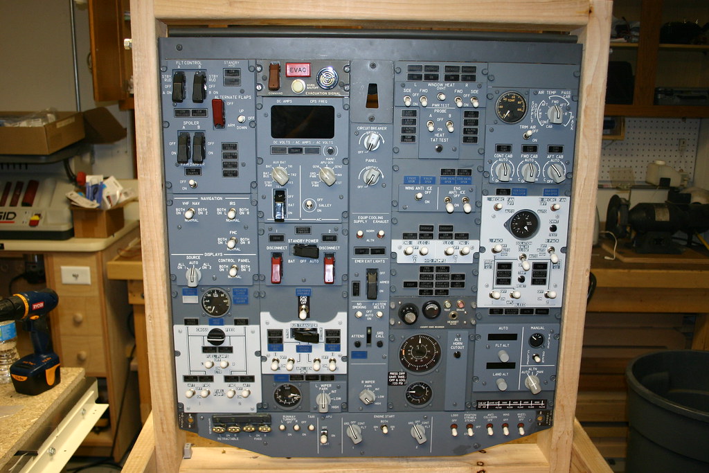

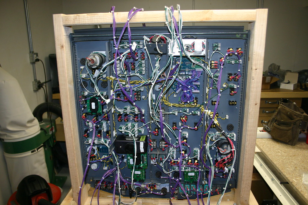

Here is the final finished result...I hope :-)
Wow, really nice work Scott.  That wiring is so neat and only 8 cables exiting the overhead!  Well done.
Nice EVAC and Voice panels!!!
Good job and all my admiration (U know Why!)  :D
