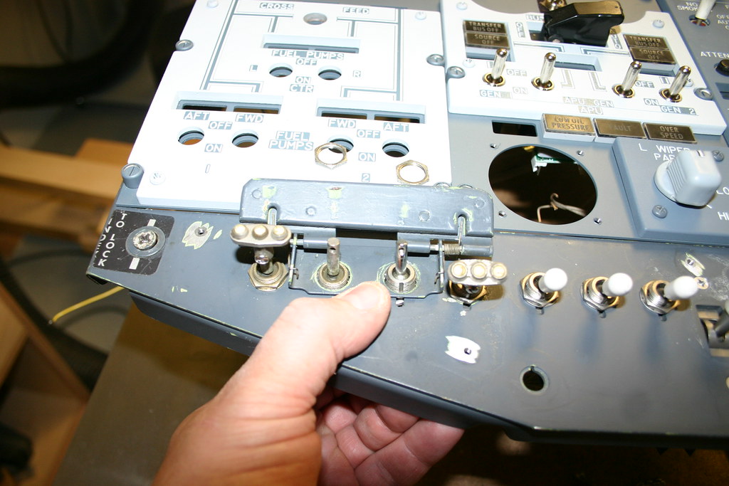

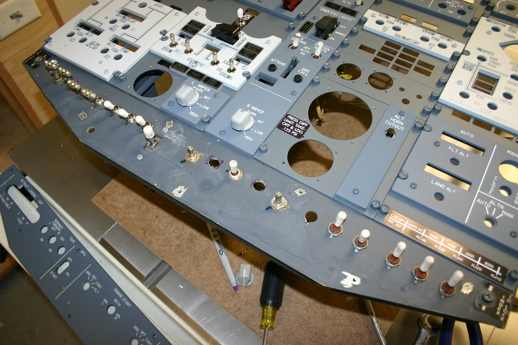

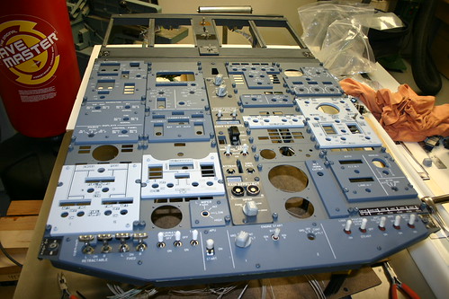

Well, thought I would start a new thread for my overhead build.    As I mentioned, I recently bought the forward overhead panels from FDS.    I had a set of fore and aft overhead frames from APHS along with a bunch of switches and such.    When I contacted FDS and placed my order I asked Peter to have the dzus fasteners added to my panels.    Here is the result.   Let me just reiterate that I am astounded at the quality and realism of the FDS panels.    No pictures of IBL here yet but tested between their panels and the real thing (which I have a couple panels) the FDS panels are superb.

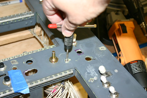

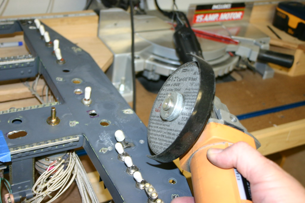

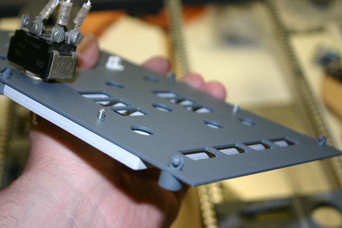

The first thing I had to do is work out some mods to the Overhead frame in the lower panel and center panel backer areas.   In the first picture I am grinding down the screw holders/standoffs for the lower panel light plates.
Here I am retapping the remaining portions of the screw holes for 6-32 tap which matches the original.

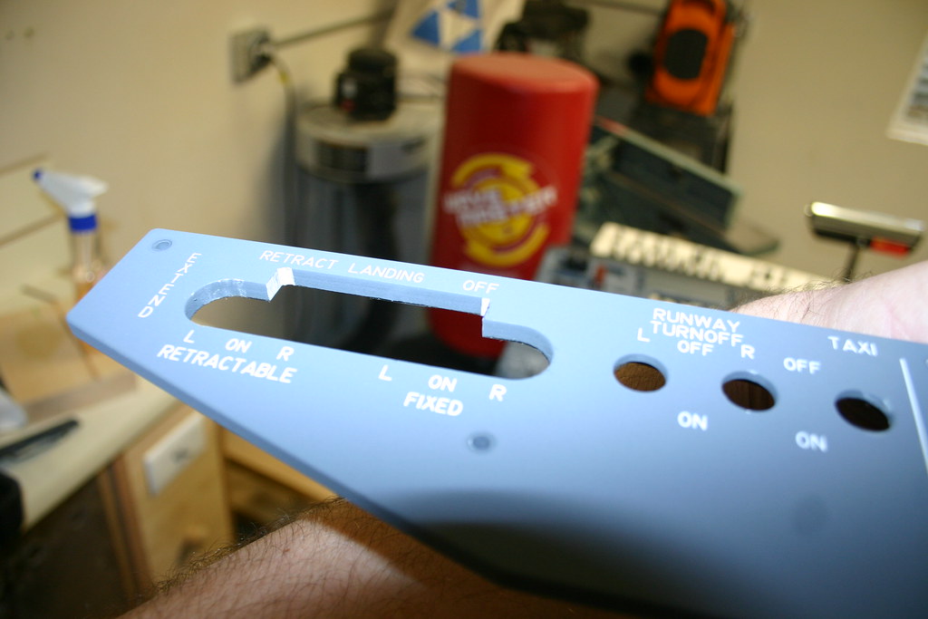

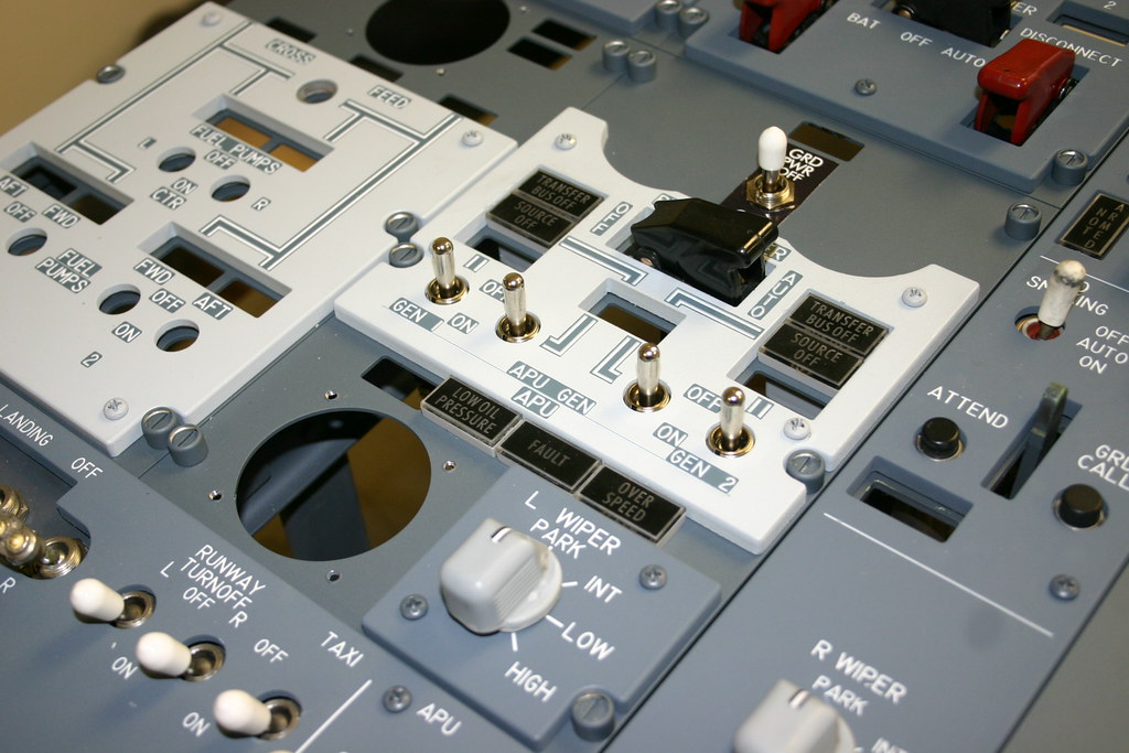

Next, I put the lower panel on.  This is really cool becuase the FDS parts match up exactly and are alll set to attach to the lower panel backer (built onto the overhead)

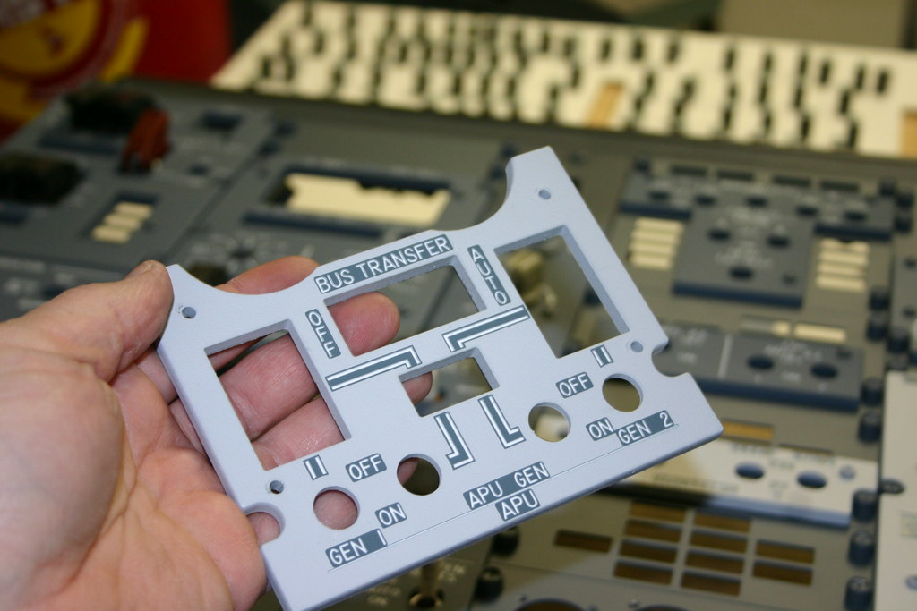

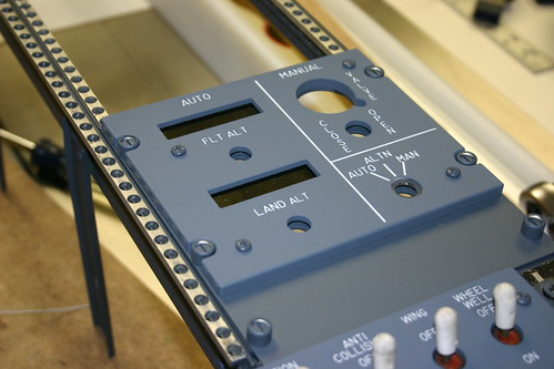

Now the middle panel in the above picture is the real panel .  Here I ran into issues with the FDS panel fit because of the hardware I am using mainly and because if I switched to more basic switches and rotaries then the holes in the overhead that were factory set in the center backer are too big for those cheaper switch types.   I decided to keep the origninal center panel despite some slight differences in color.    Since the overhead frame isf from a 737-300 I believe, it has a couple differences from the FDS NG center light panel but barely noticeable.   One thing is the presence of the Rain Repellent switches.   I kept these and figure I wiill use them for some function down the road.....
Here are some more showing the wonderful FDS factory installed optional dzus fasterners.   Really made my life easy!
And here are pictures of the panels installed.   I will have to take them out in order to install all of the switches but the dsuz make that simple.    I couldnt resist putting all the panels in so I could stare at them for a while :-).

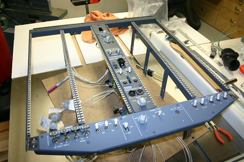

The actual ovhd frame has a lightbulb in it for shining down on the pedestal.   I think it is a grimes light but I suspect 28vdc.   There are also two huge reostats for light dimming (top center of panel - see picture attached).   These are for circuit breaker panel dimming and for panels dimming.   They say 0-28V on them and 6amps.
I would like to utilize them if possible.  Especially would like to make the flood work.   My power supplies are regular computer power supplies with 5 v and 12v outputs.   The IBL panels are all 5V (and I doubt these dimmers would work for that purpose but was thinking maybe I could get the flood light working somehow at least by changing the bulb to a 12v?   Do you or anyone here have any suggestions?

Can't use the rheostats without 400 cycle AC power, they'll burn up.  :(
Ah...ok
well I guess they'll be dummys for now.    :-(

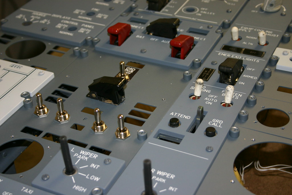

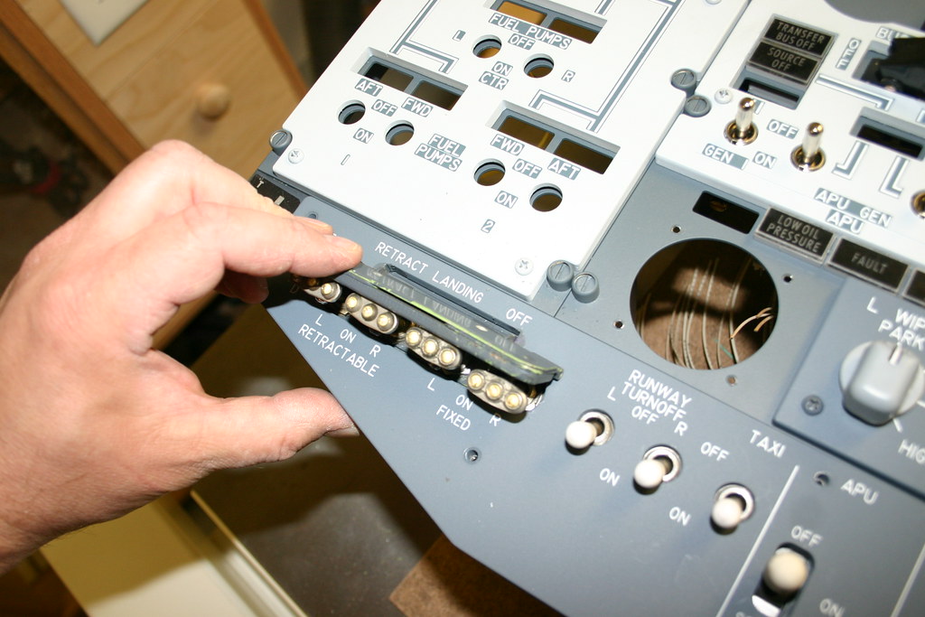

Got my hands on some gauges for the overhead thanks to some of Jack's advice.  I also could not resist getting a bunch of authentic switch guards.   My days as a P-3 Flight Engineer and mechanic are etched in my head and I always remember the deep red (almost red/brown) of the phenolic switch guards.   They were also rarely shiney looking after years of use.   I had to have some of that worn look in my overhead and by using some authentic used guards and switches I am getting that feeling of realism.   Again, not to mention the superb look and match of the FDS panels with real Dzus fasteners.
So here a few more pics of the overhead with the new guards and my used switches along with (thanks to Jacks advise and help) my real Temp and O2 gauges.  Sorry about the blurrieness of last picture as I didnt have my tripod out for the time exposure.   Cabin Press, Duct Press, APU EGT, and Cabin Climb gauges will come from Flight Illusion in a couple months and are on order.
Enjoy.....I sure am :-)!

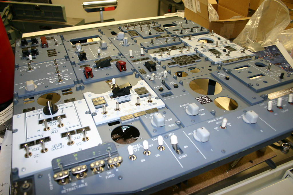

Well, while some of you where cutting grass.....:-)

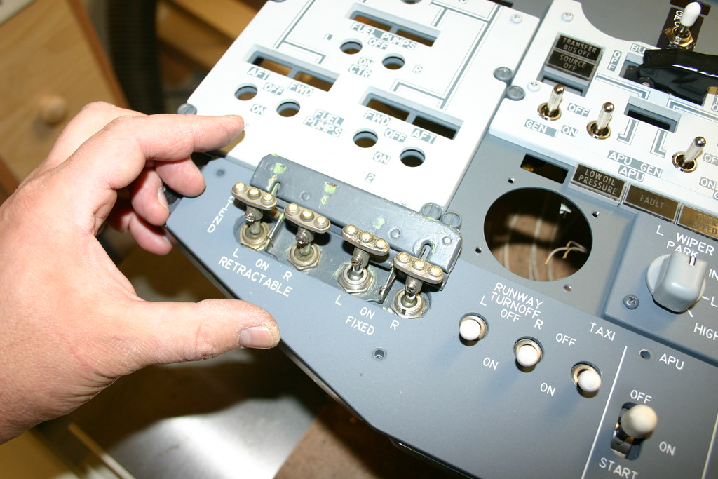

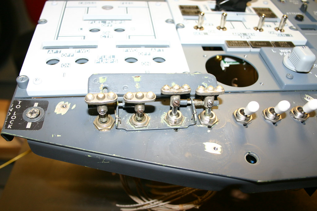

I did manage to get some more done on the overhead last night.    I decided to go ahead and pull the real center panel and replace it with the FDS one after all and after reworking some of the underlying switches was able to fit it onto the frame without any issues.  It worked out great.    I also really wanted to utilize the little light switch cover from the actual frame so I had to cut the FDS lower panel slightly to accomodate this (YIKES!).   Again I cannot express how well made and thought out the FDS stuff is.   They even included a little bottle of touchup paint with my order that has a brush build into the cap.   They have everything thought out to the nth degree which really makes the build go so much better.    Here you can see some of the panel work coming together.  I am using a combination of real ac switches along with heavy duty Carling switches.   All guards came from real aircraft also as stated earlier.
On another note, I found a helper who is joining me in my build.  His name is Don Harrison and he lives nearby in Aurora.  He is a CFII and had asperations of building his own sim but does not have the full time or resources right now as he has a newborn at home.   He is very skilled and has been simming with the PMDG 737 and Vatsim for a long time.    He came over last night and began the assembly of my Simparts TQ and is a great help.   He will be my copilot and 737 instructor once we get the bird finished.   I think this is a great way to allow some that may not be as fortunate with the finances, time or space to still participate and have a good time plus it is a great help to me as well.
Enjoy the pics and again, if you want to see larger goto to the link at the bottom and see on my Flickr Photostream site.   As a little challenge lets see if anyone can spot something a little unusual or out of the ordinary on the panel in the last picture..... :-)

switch bar on the landing lights??
