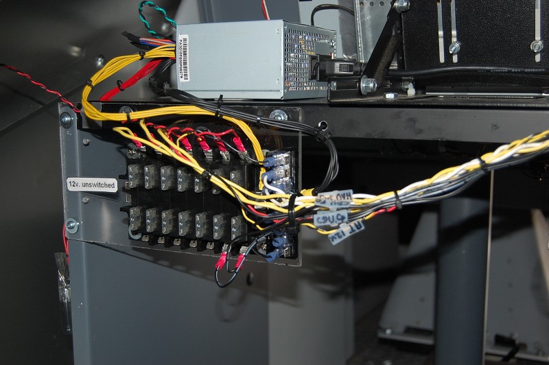

Great picture Jack. That one's going in my overhead archive. Nice and neat. I have one of those coming in the mail. What size fuses are you using?

I have two of these "buses" in the OVH besides the relay card, one 12v one 5V.
Fuses are 1/2/5 watts depending
Nick: Very neat way to do it.
Thanks Jack!
It looked scary in test mode:
but just like this when ready:   :idiot:
