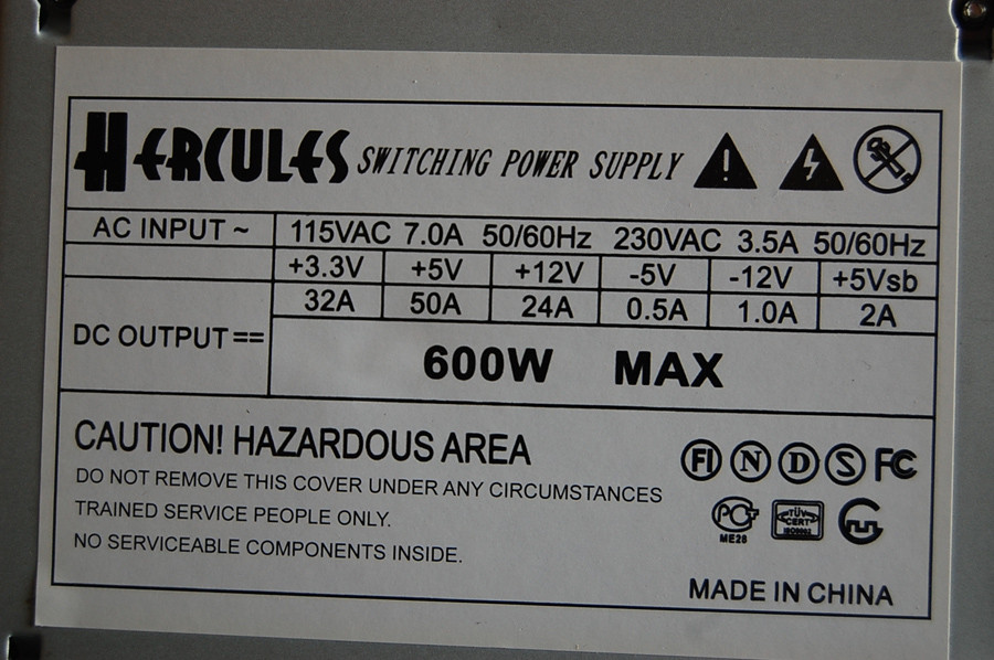

Get any PC Power supply new, or better second hand, in shops that do computer maintenance. Around  $20 . You will get 5V (red wires) 12V (yellow) ground (black) To make it work you need to
Join the green wire (there is just one) with any ground.
Piece of cake!

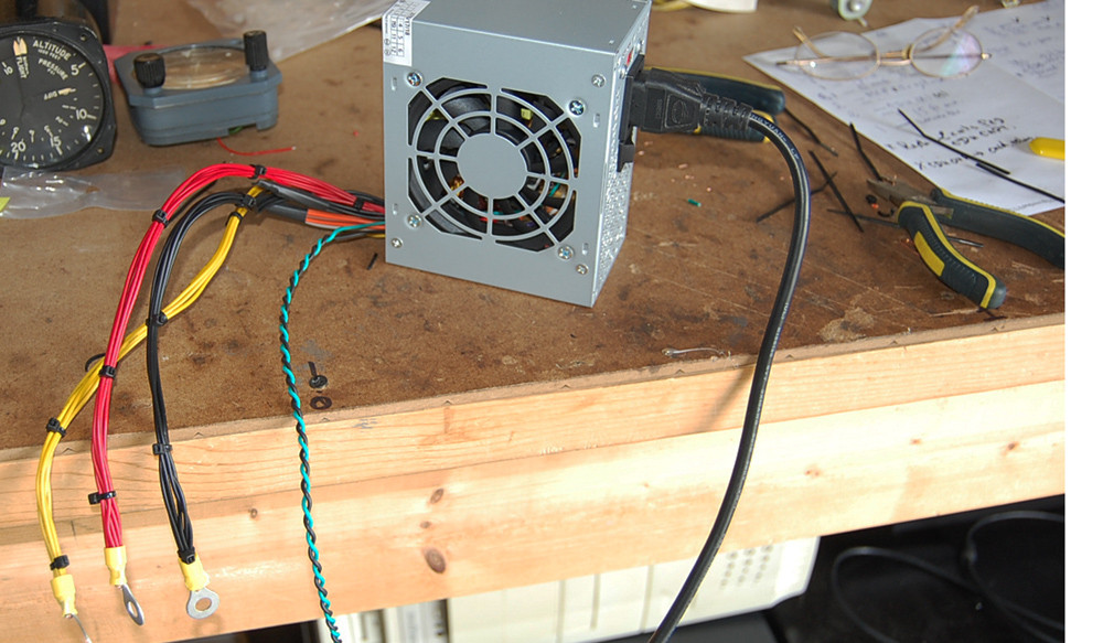

Will i cut off the additional wires from it? Also what if i need longer wires?
Hi Vernon,
A computer power supply has connectors normally for internal connections. However, to use it for your needs, do as Jack suggested, but only cut the connectors off the wires you need. For myself, I'd just remove the connector and wire it to whatever I need it for.
As for extension wires, use those that are about the same size as the ones your cutting the connectors off of. If you look at the wires on the power supply, they might have the sizes written on them. Look for AWG and a number, that is the wire sizing, then head off to a hardware store and buy some spools of wire of that size...
The best is to cut off all terminals and arrange your PSU so that you can use it for other applications
Something in that vein.
Besides, the FDS lights use LEDs, AWG 20 is more than enough
What Jack is doing looks very nice and neat, plus he's using wiring blocks/connectors with fused sections. Having things like this is much safer and makes it easier later on to find errors with power and fix them; a lot of other builders use block connectors as well.
