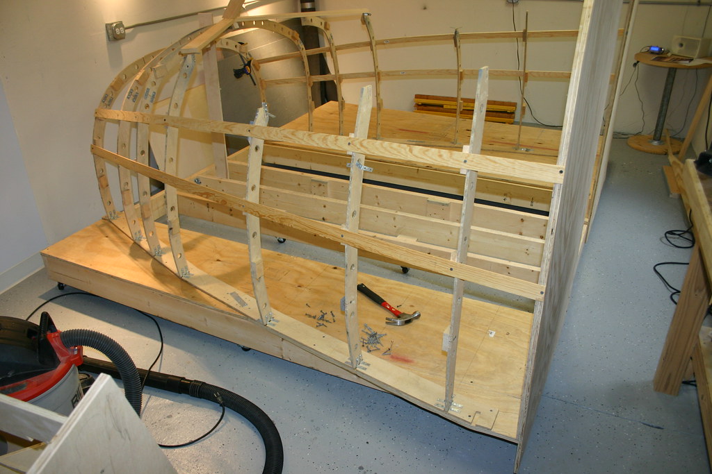

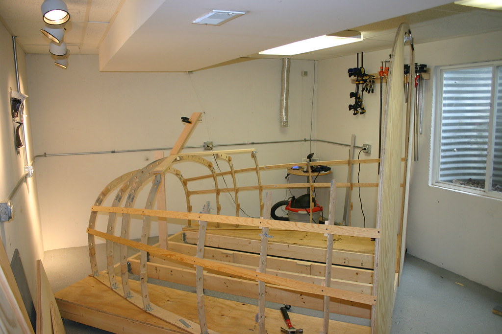

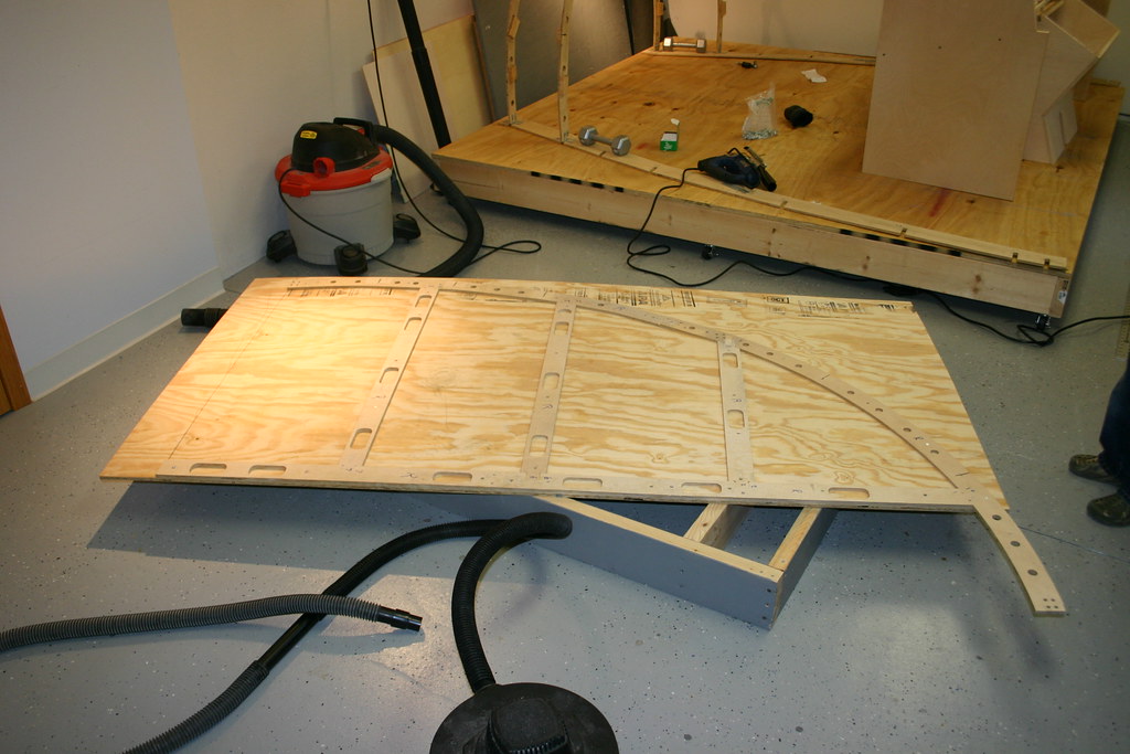

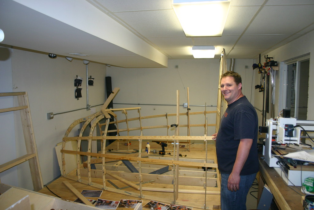

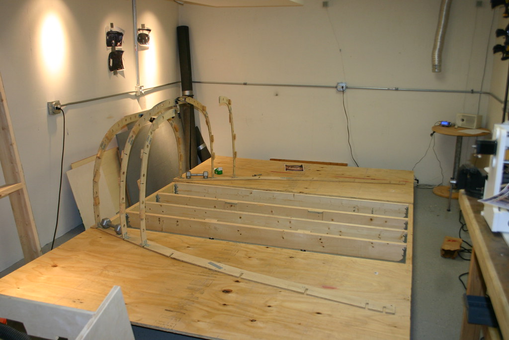

Well, finally got started on a shell.  This is the Flightdeck Solutions old wood ribbed shell.  I picked it up from someone who wanted to get rid of it and am working on piecing it back together my way.   I am going to remake the window frames as I wasn't happy with the ones that were with it and as some of you know this is tricky but having the basic shape really helps and hopefully will have them done in the next week.   I decided based on advise from Ivar to try and angle it into the corner of my room and it worked out perfect.  This will allow me to have a 6-7ft radius screen going around the nose for the projection and I hope to get 180-225 degree wrap around with TH2GO, NTHusiam, and 3 DLP WXGA short thow projectors.  All in good time.
Due to the way the shell fits in the room the outside will never be seen which means that I wont feel the need to finish it (phew....).  Afterall, it is the inside perspective that really matters!
You can see my co-pilot Don Harrison in one of the pictures.  He was kind enough to come over and give me a helping hand.   He also brought beer!  With his help what you see was accomplished in about 12 hours of total build time.
My plan is to finish the windows then the top.  It will be able to break down into 5 pieces (two sides, top, and two back walls).   Next I will work on interior panels, placing the MIP, pedestal, seats, dual linked real rudders, and my yoke setup.   Finally I will finish it off with the glorias FDS overheads, CDUs, and CP Flight MCP and Efis units.
PS-Full size pictures here

Hey Scott,
Glad to see you are at the point that you can start on your shell . . that is going to look great.  Looking forward to seeing the interior components installed.
That looks great.  Much better than mine turned out...  Good luck!
Looks Great!! I had one of the first, maybe even the first wood shell from FDS years ago and gave up after about 2 weeks! lol
Keep up the good work! Looking forward to seeing the progress.
Wow that's one hell of a jigsaw Scott, but looking great.  Must be satisfying, not to mention inspiring, to have the shell from the start.  Reminds me of Ron's L45 kit.  Incidentally what's your room size and the shell footprint?
Quote from: Kennair on June 13, 2010, 09:37:19 PM
The room is 12ft wide (3.65m) by 16 ft (4.88m) long.  Ceiling height (except for vent duct area) is 7.5 ft (2.28 m).
The base frame you see the shell sitting on is exactly 8ft by 8ft square (2.44m sq).   The back wall of the shell is a little wider than the platform (approx 9ft) and as you can see the back wall almost touches the ceiling.  Platform floor height is about 9 inches so shell height on top of that is about 81" tall (2m).
It is tight but should work.   Toughest part will be getting projectors squeezed in right above and aft of the windows on the ceiling.   I will likely use the BenQ 782st's that Ivar used  or InFocus 1503's and throw distance (screen radius from TQ) will be about 6 ft.
Looks great Scott. That's a lot of work in a short time.
Can you get the MIP through the cockpit door?

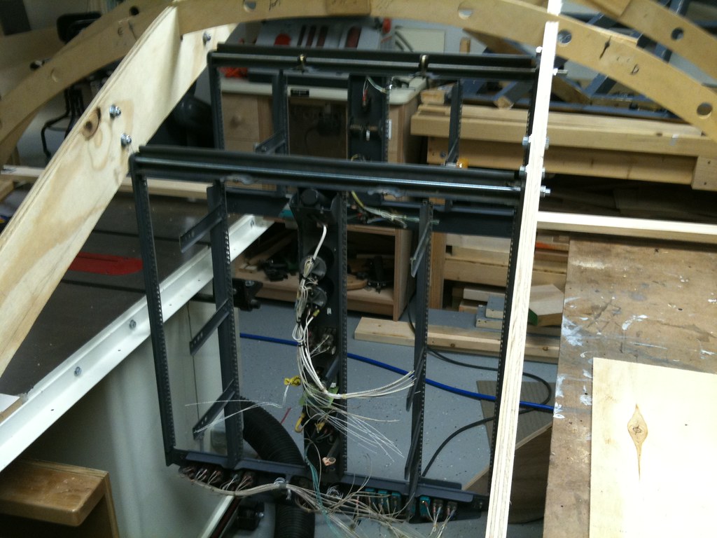

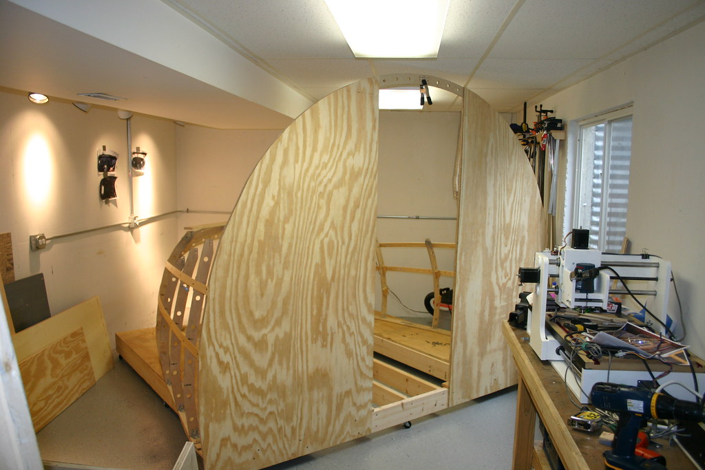

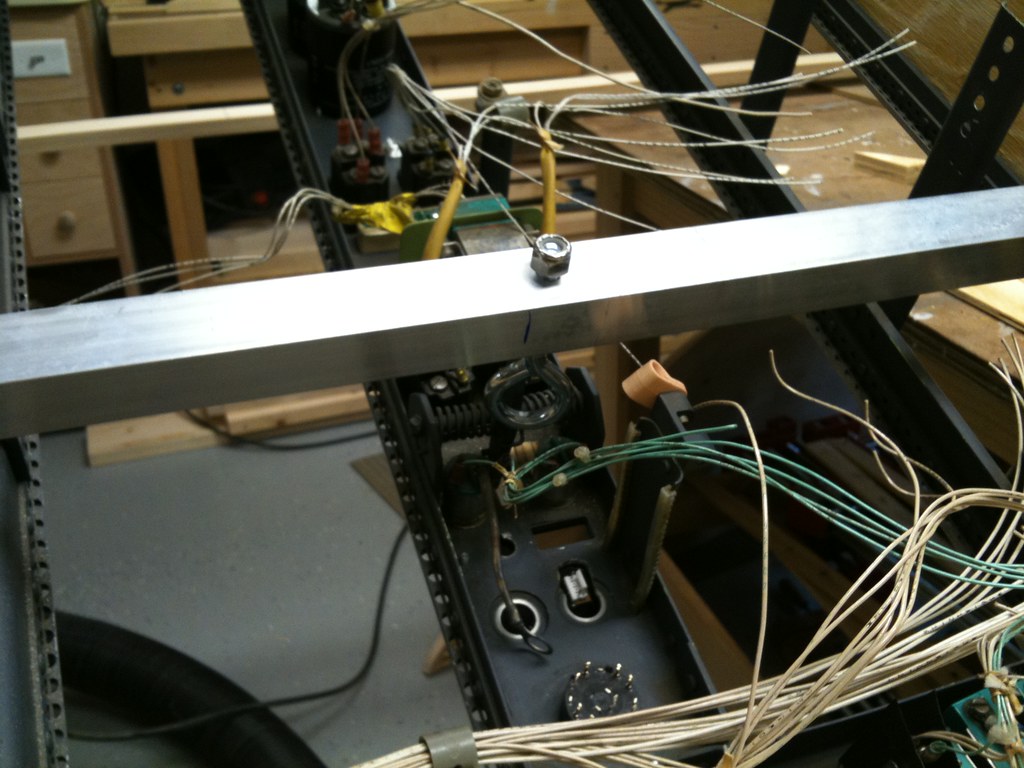

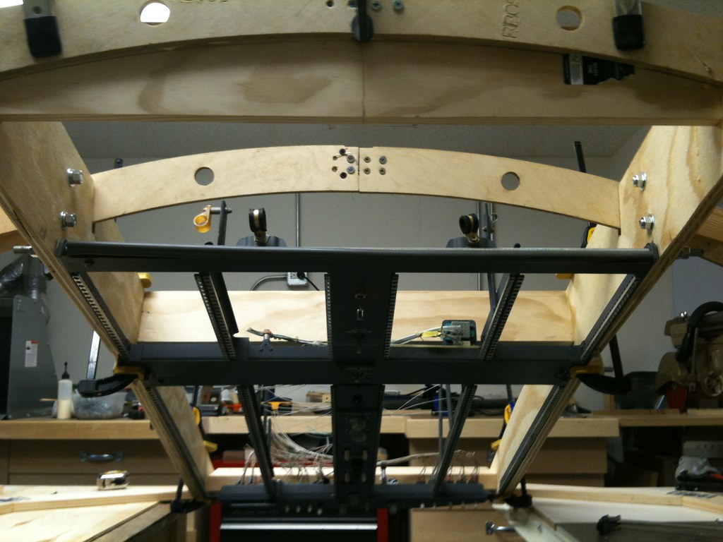

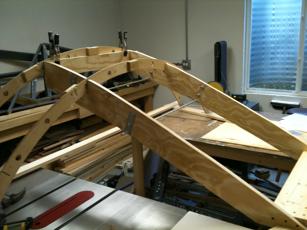

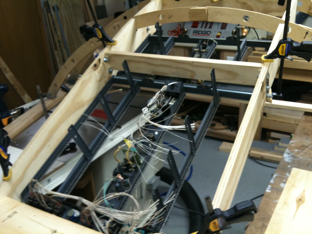

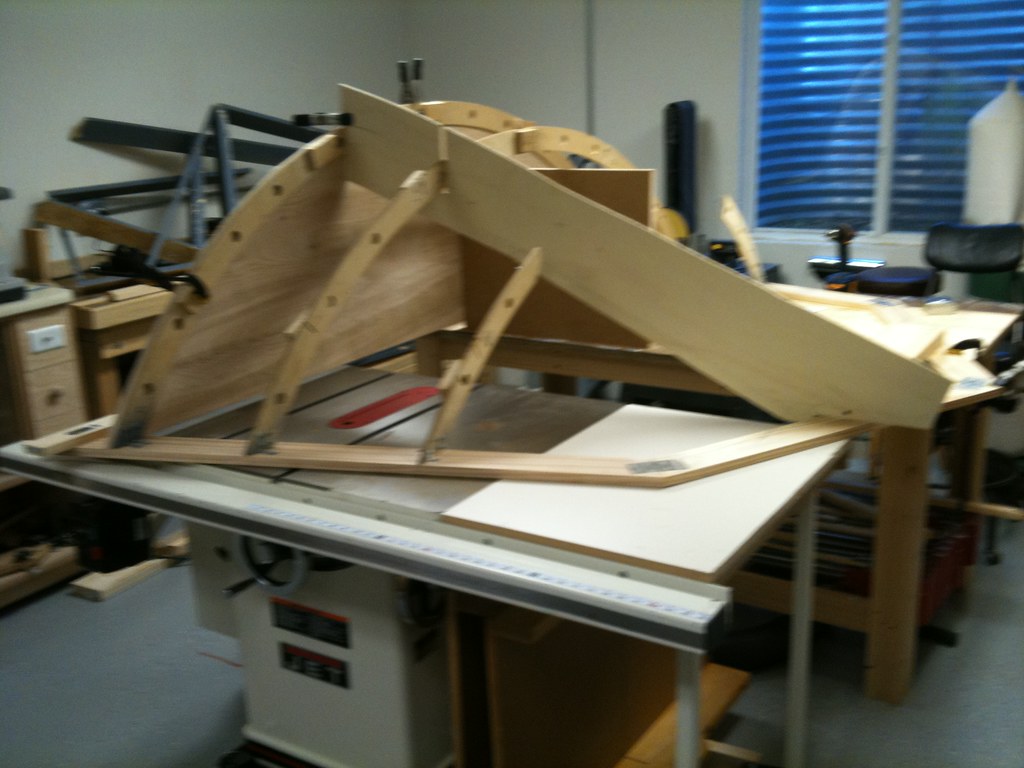

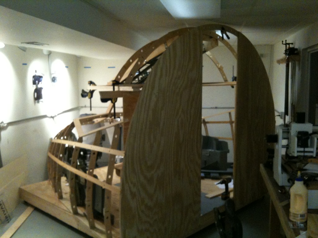

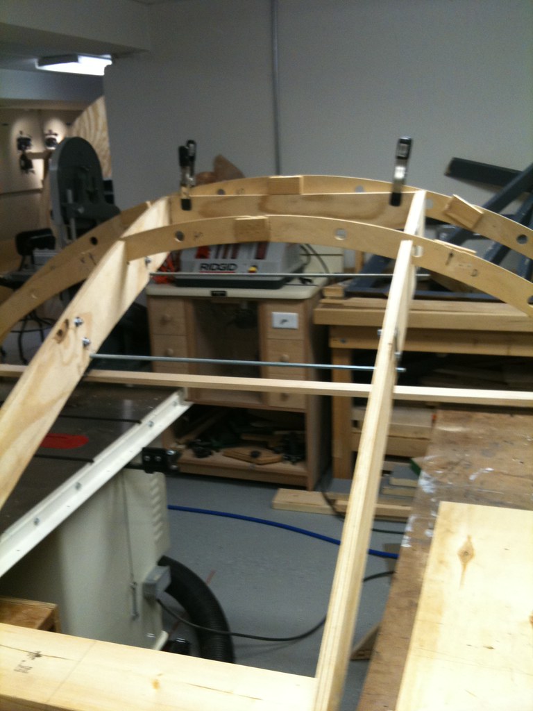

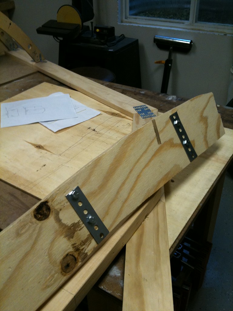

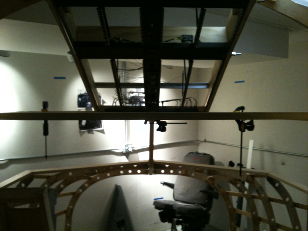

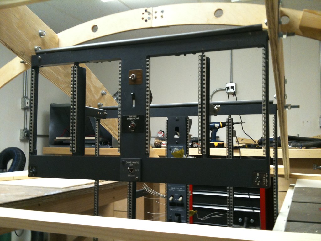

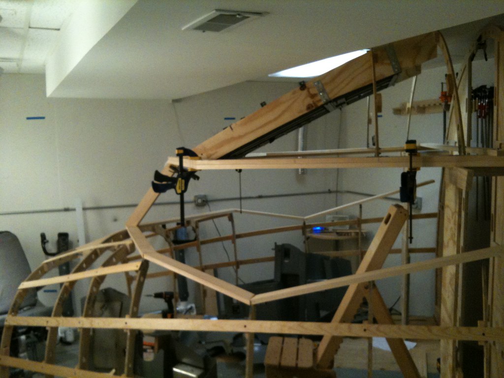

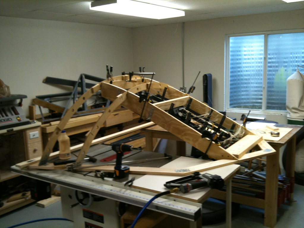

I am on vacation this week and just got back in town yesterday.   Had a chance to get back in the shop last night and make more progress working on the upper shell piece including the overhead frame hanging.    I managed to get both overhead frames fitted along with brackets for the safety latches which work perfectly.  I have to do this very carefully with lot of planning as I have to fit the authentic eyebrow window frames and overhead panels next.

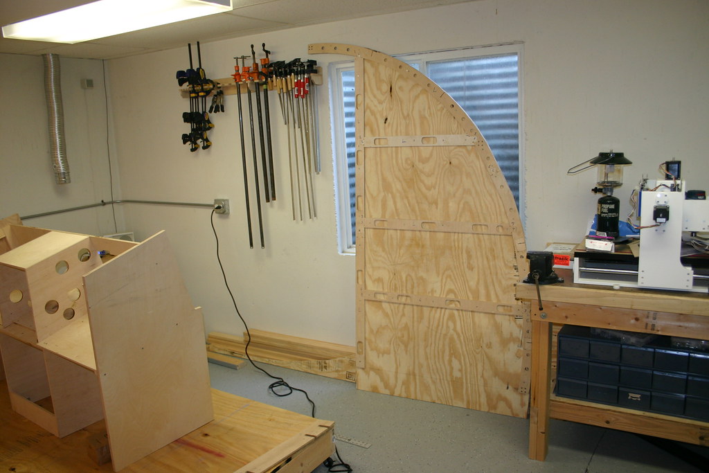

Today I will work on finishing up the window frames and attaching the upper to the lower and shell back wall.  After that I will need to await the arrival of the FDS MIP and CDU bay I have on order as everything else in the cockpit really will need to rely on that for placement.    This is all exciting seeing things take shape finally.   Long way to go....

Looks very good Scott.
Wish I installed all my components before I covered the shell. Would saved me several hundred hours of work.
I can see now how that would make it difficult.  Still, yours is the standard by which many of us build :-)
I am not sure if I will even cover mine at this point but I figure I will decide once the inside is done.

This is getting fun for me now.   I am still hoping to squeeze projectors in but it is very tight for sure.   My biggest issue may be the soffit that protudes from the ceiling right in front of the windows.   Very little space to squeeze the projectors.   Definitely have to be BenQ MP782St's in order to get the throws right.  If those dont fit then plan be will be 5 32" LCD monitors using dual TH2Go's or 1 TH2GO and 1 Wideview computer but trying to avoid the later.
