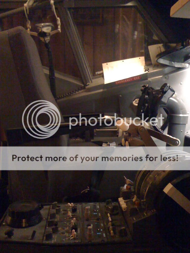

Someone here asked for a shot of the seat/throttle/yoke relationship in the flying position and I posted this for them.
Don't know if it will do any good for your sims, but here it is.
