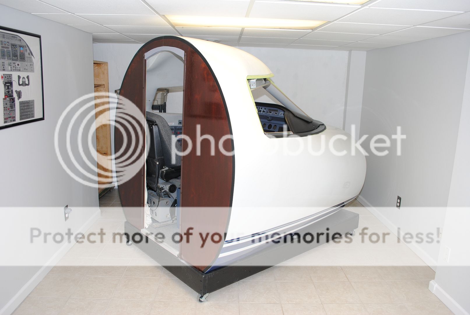

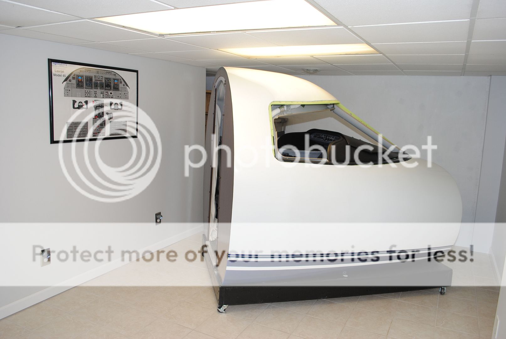

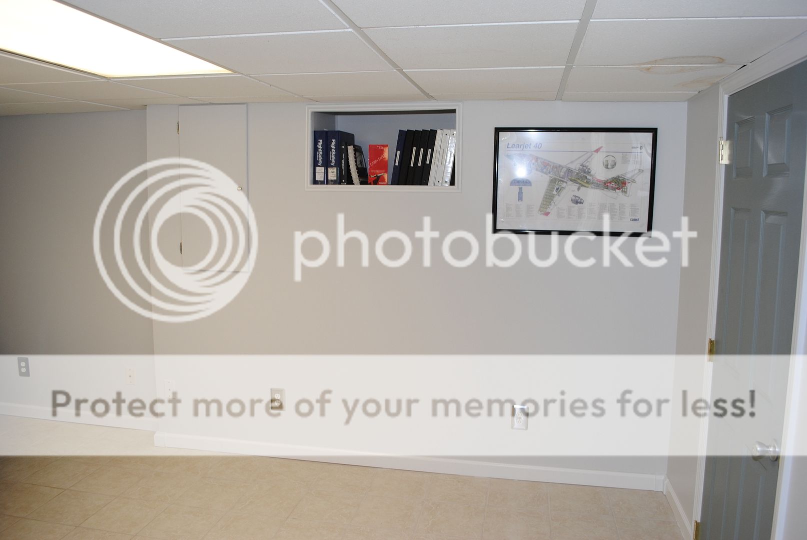

It has been over a month since I posted an update . . . and I have not done any work to the sim.  I have been busy  remodeling the sim room.   The room needed a face lift and I have been working hard to get it finished so I can get back to work on the build.

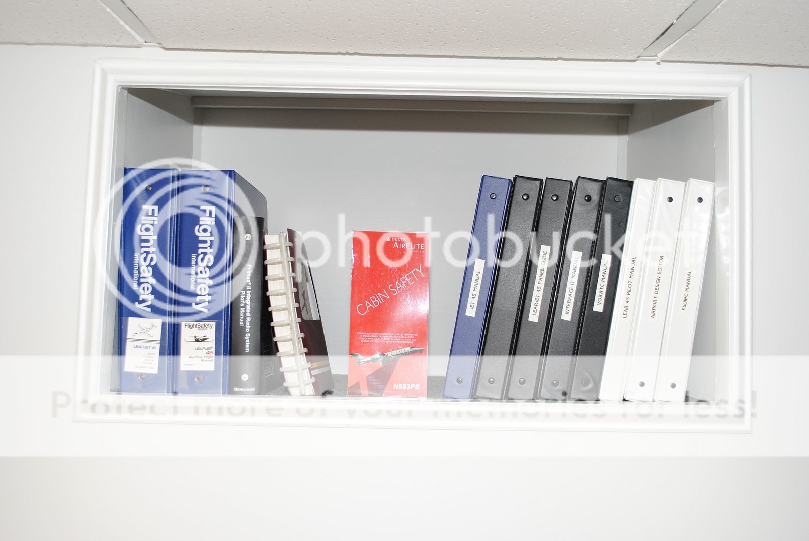

Tonight I finally finished the majority of the work and was able to hang a couple of Lear 45 posters on the wall, move my small Lear library and associated manuals into the room, and move the parts not installed in the build to their new location within the room.   Here are a few photos of L45-007's new home.
The plan is to use a curved projector screen . . it just fits the room and the shell is sitting in very close proximity to where it will be positioned with the curved screen in place.
So awesome- you've done a great job. Really looking forward to making a trip up there one day!

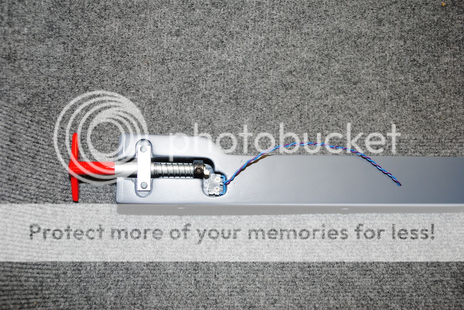

Hey guys,

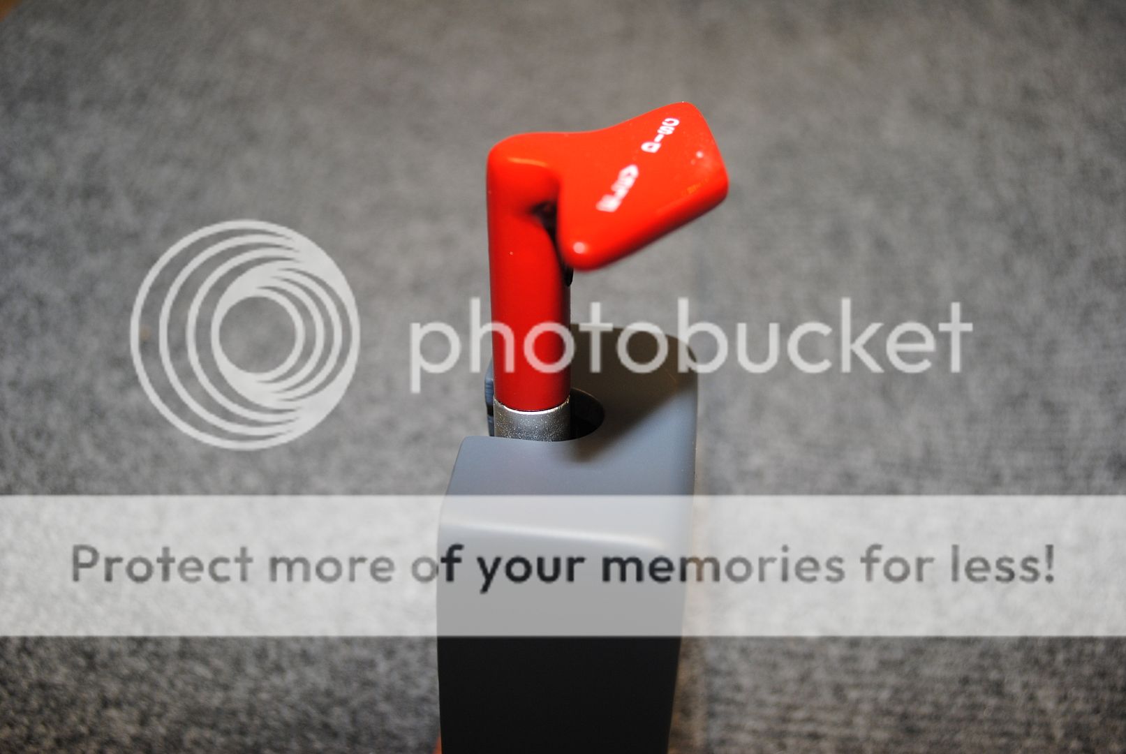

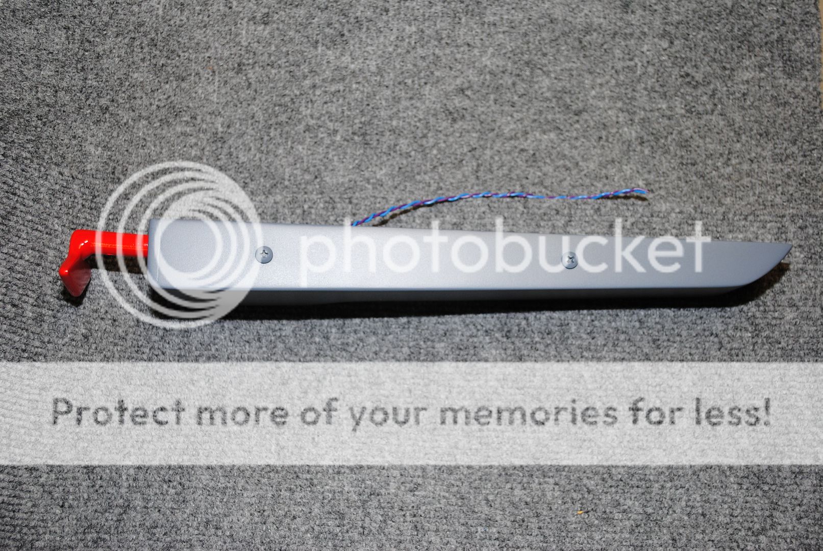

It has been quite a while since I updated my build . . between working overtime and trying to keep all my work at home caught up I have fallen behind in my build. I do have a couple of small updates.  I have completed the prototype of a newer design of the elevator disconnect box located on the pilot side of the TQ pedestal. It now features a switch that can be interfaced and the handle can be pulled up and rotated 90 degrees to lock the handle in position as in the real world Lear 45.

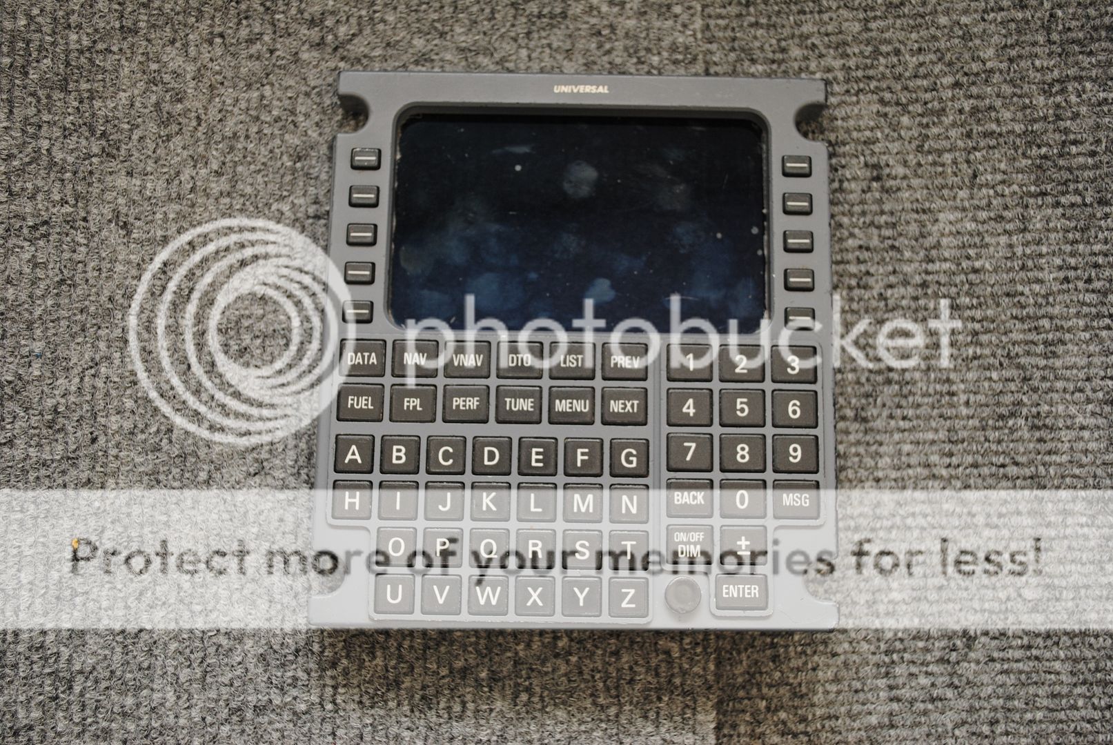

I also found a Universal  FMC  on Ebay and added it to my collection of real parts . . I plan on using this one for a dummy and most likely add a small LCD for ATC or other programs.

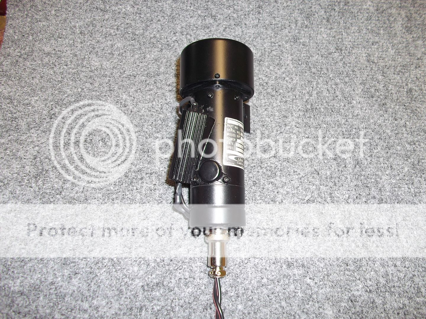

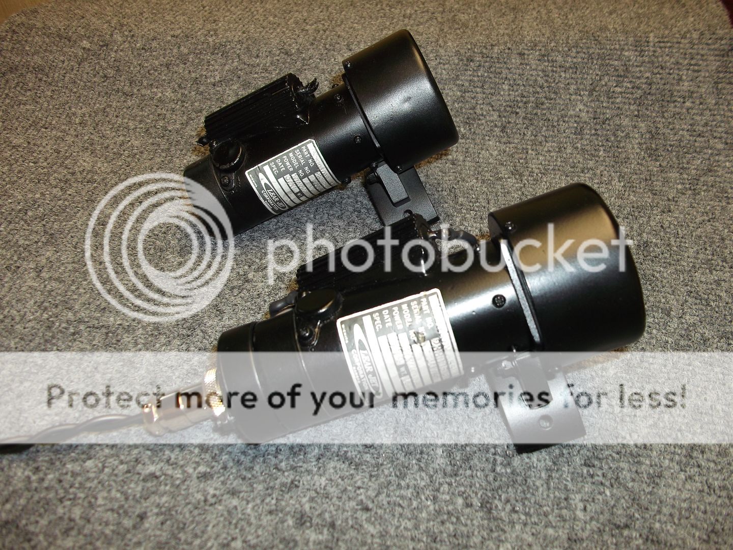

Now back to work on my project . . the last few days I have been working on stick shakers for my project.  Awhile back I was able to pick up two stick shakers from Ebay and confirmed that they worked once I received them.  These are not exactly like the shakers in the Lear 45 but are close enough and will provide the function needed.  I am using a 24V power supply to power the shakers.
Here are some specs on the shakers:
Part number: 2380051-2
Manufacturer: Lear Jet Corporation / Kansas
Voltage: 27VDC 5A
Here are a few photos of the stick shakers . . .
The one on the left is stock . . the one on the right I have modified by adding a connector that looks similiar as to what is found in the 45.
I was able to clean these up with some dawn dishwashing liquid and water. After cleaning, a few of the parts like the cap, and attachment bracket assembly were removed, sandblasted and repainted. I was able to tape off the foil label prior to painting. I then painted the parts a satin black then applied a flat clear to dull the paint down a little.
I had to fabricate an end piece that would accept the silver connector.  By adding this piece I was able to preserve the stick shaker if I decided to convert it back to stock configuration . The only change made was replacing the two 4-40 screws that held the end cap in place with longer 4-40 rod so the end cap addition with connector could be fastened onto the end of the shaker  I replaced all of the external wiring on the shaker to ensure a longer life in the sim .

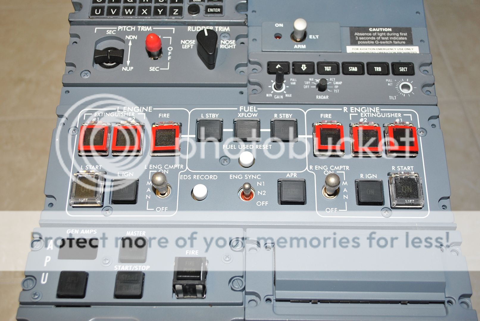

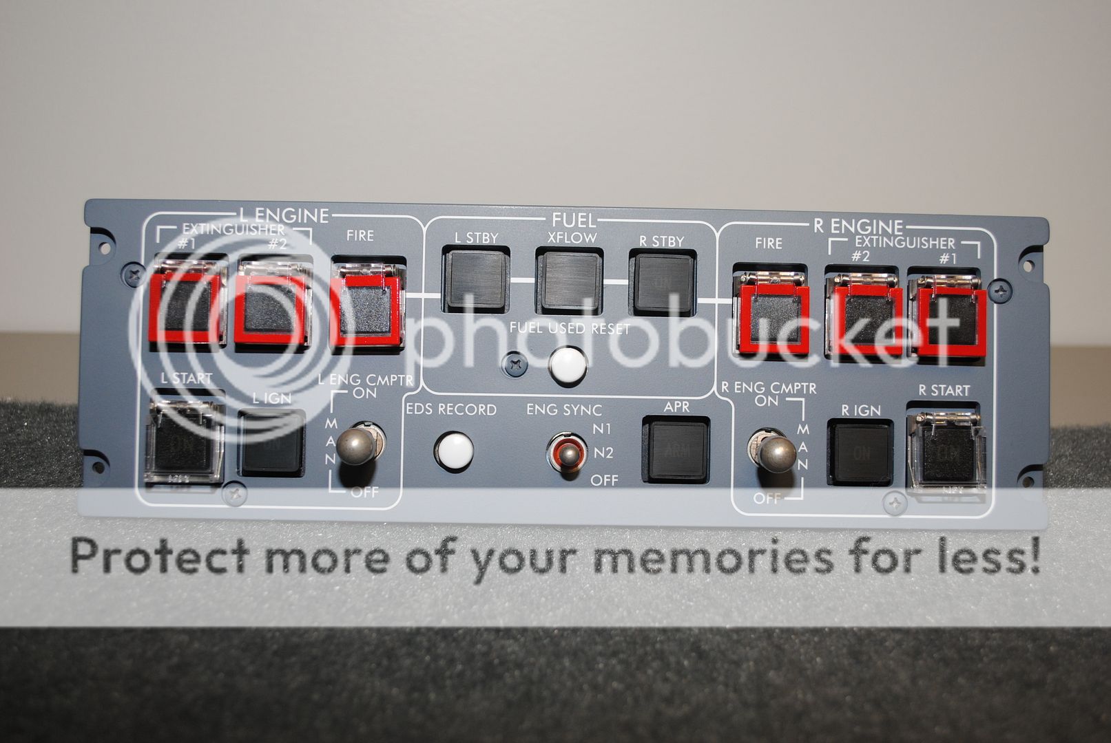

Hey guys,

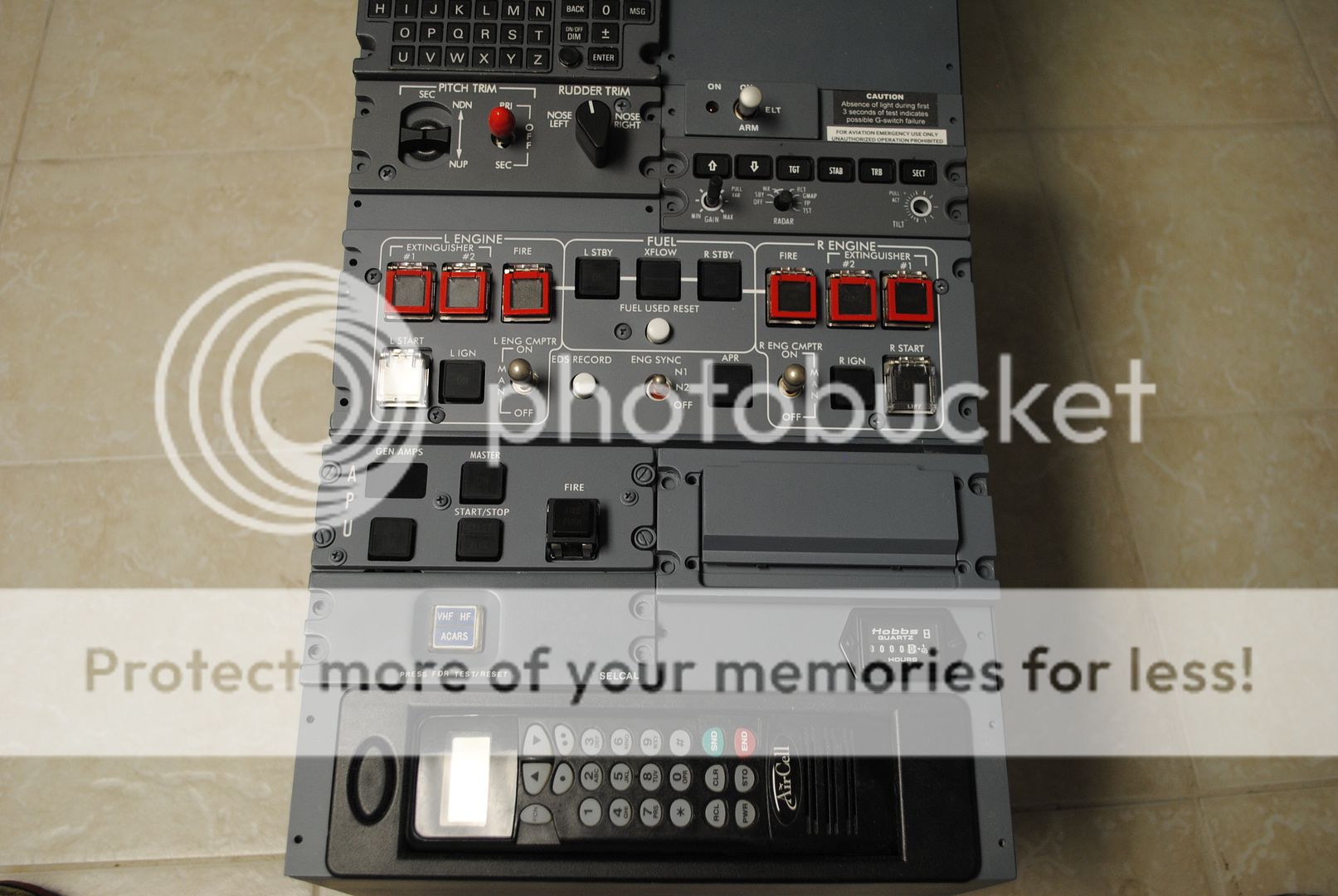

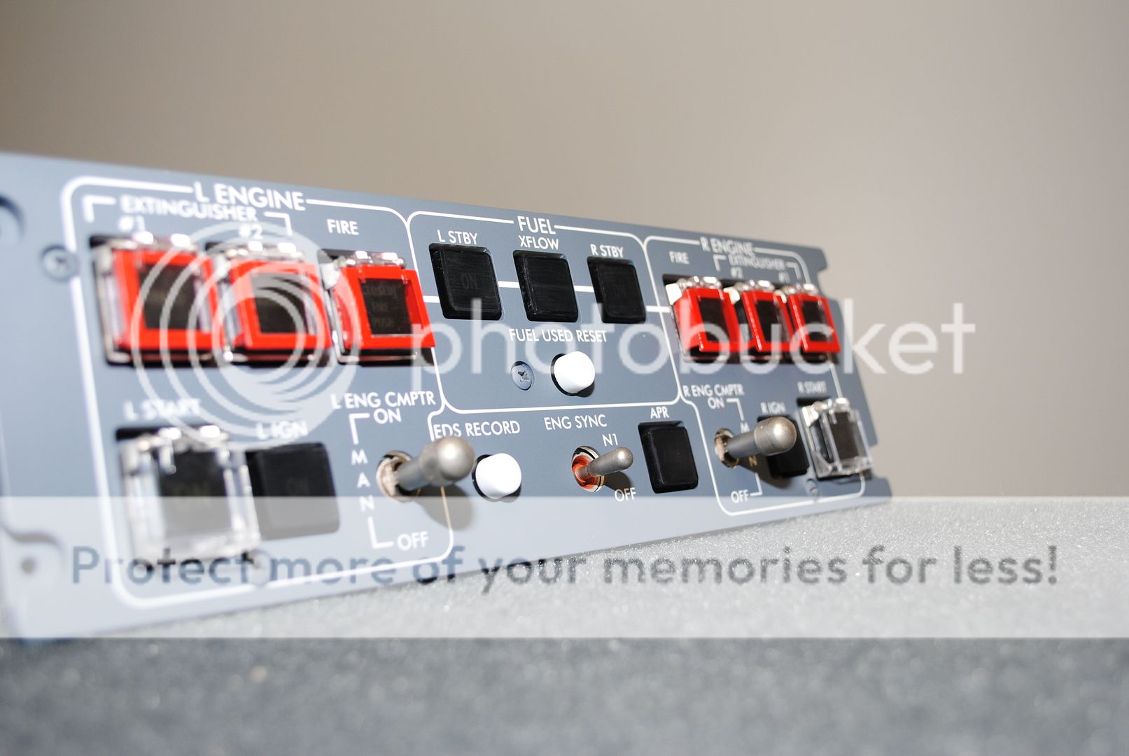

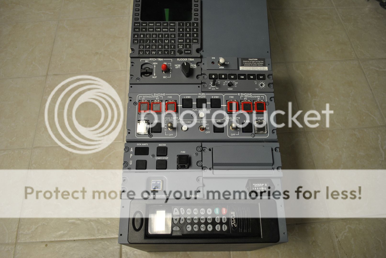

I had some time this weekend to finish up my switch guards for the engine start panel.  Awhile back I ordered the Engine Start Panel from Eric T.  and the panel has been sitting patiently waiting for me to finish the guards and get them installed.  Here is a few photos of the panel with guards installed. . .
and here it is sitting in the center console with a few other panels . . .
I really like the looks of the Engine Start Panel sitting there . . one step closer to having a flying sim  :)
Wow Shane, that looks really great! Love seeing the panel withe guards.
Sahne's stuff always looks like someone just dropped a Lear in his work area..... LOL Wonderful build!
Super nice Job Shane and Eric.
Eric does some great panel work!  Only credit I can take on this panel is modifying/painting  the switch guards to resemble the guards found in the Lear.
