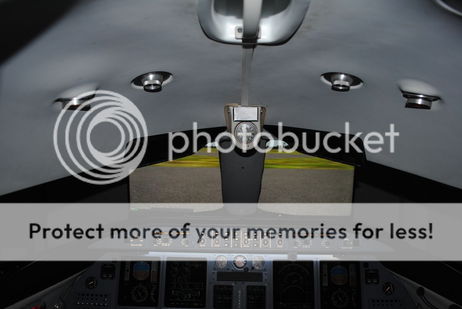

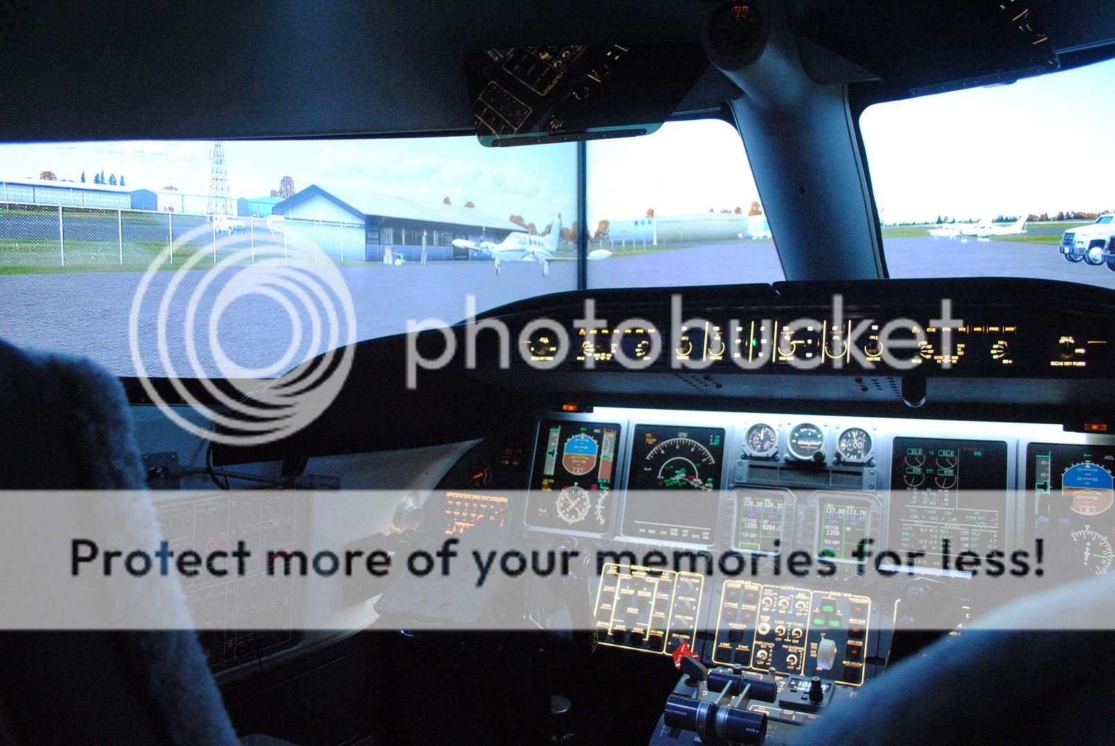

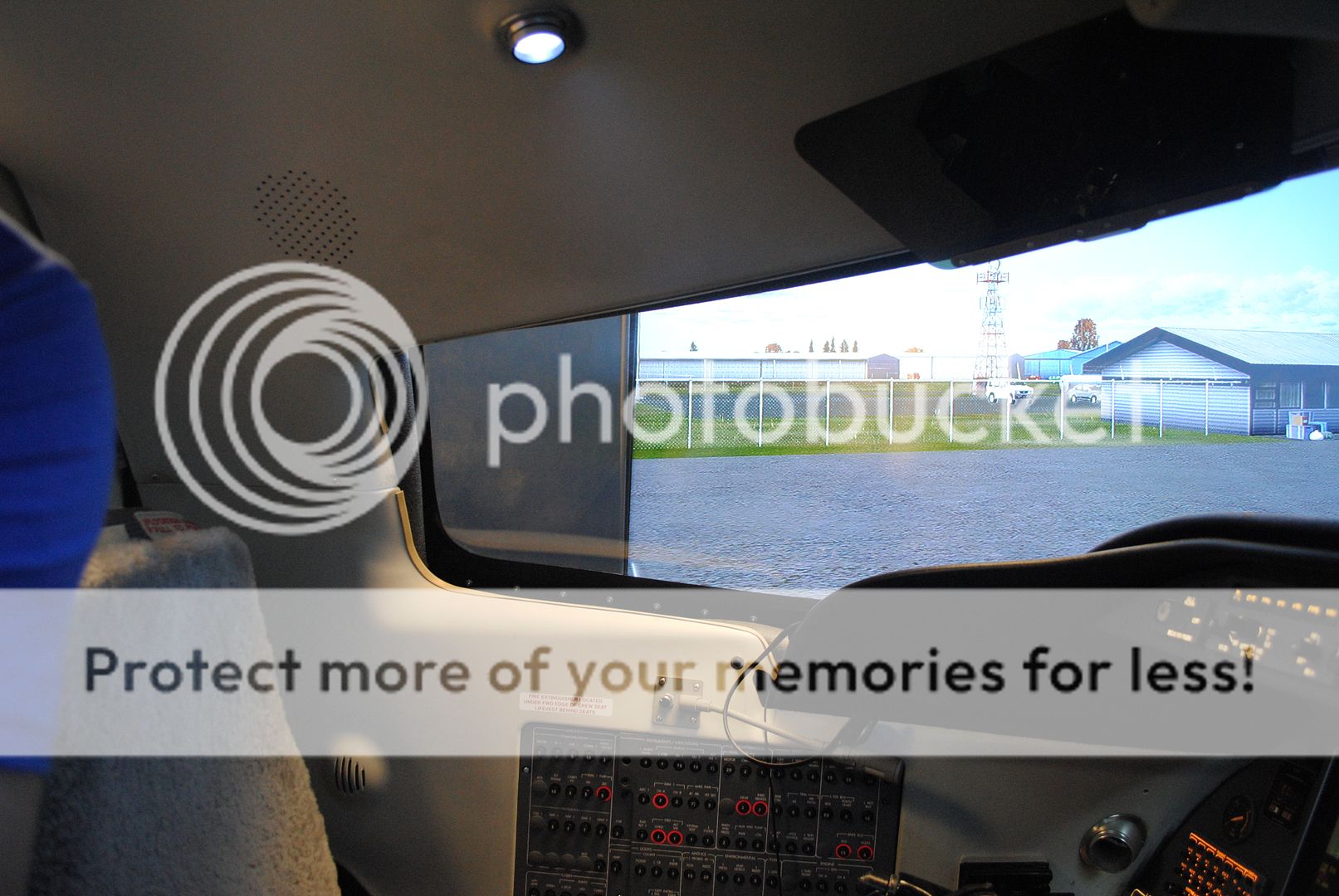

May 01, 2009 I officially started building a Lear 45 sim build number L45-007. . .  6 YEARS later and I am close to completion.  I would say that the project is close to 85% complete.   As of this date I need to install a third computer to run the JET45 CDU software,  install Audio panels once they are developed . . and purchase 2 more 60 inch TV's to finish my outside visual.   So far everything is working good.

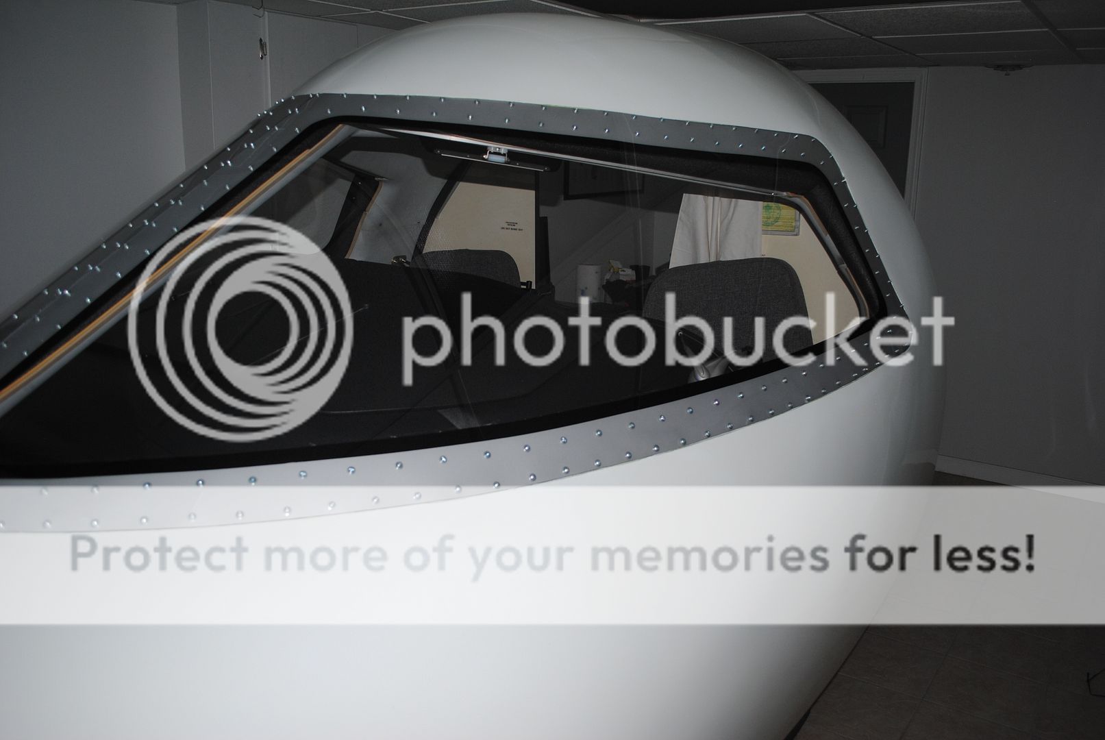

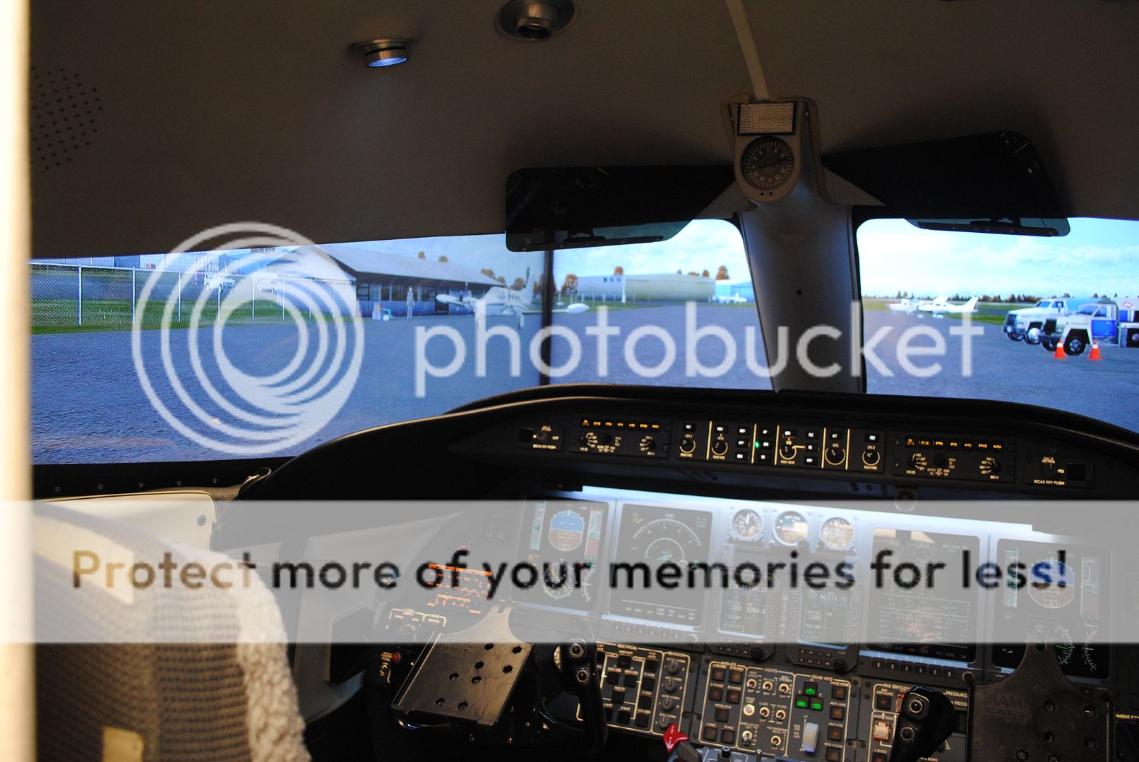

Here are the latest photos of my build . . .
Windscreens installed . .

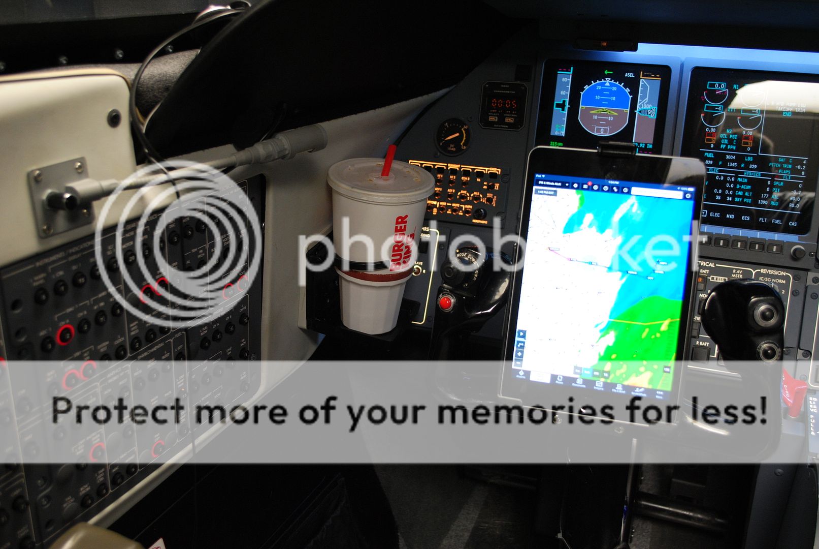

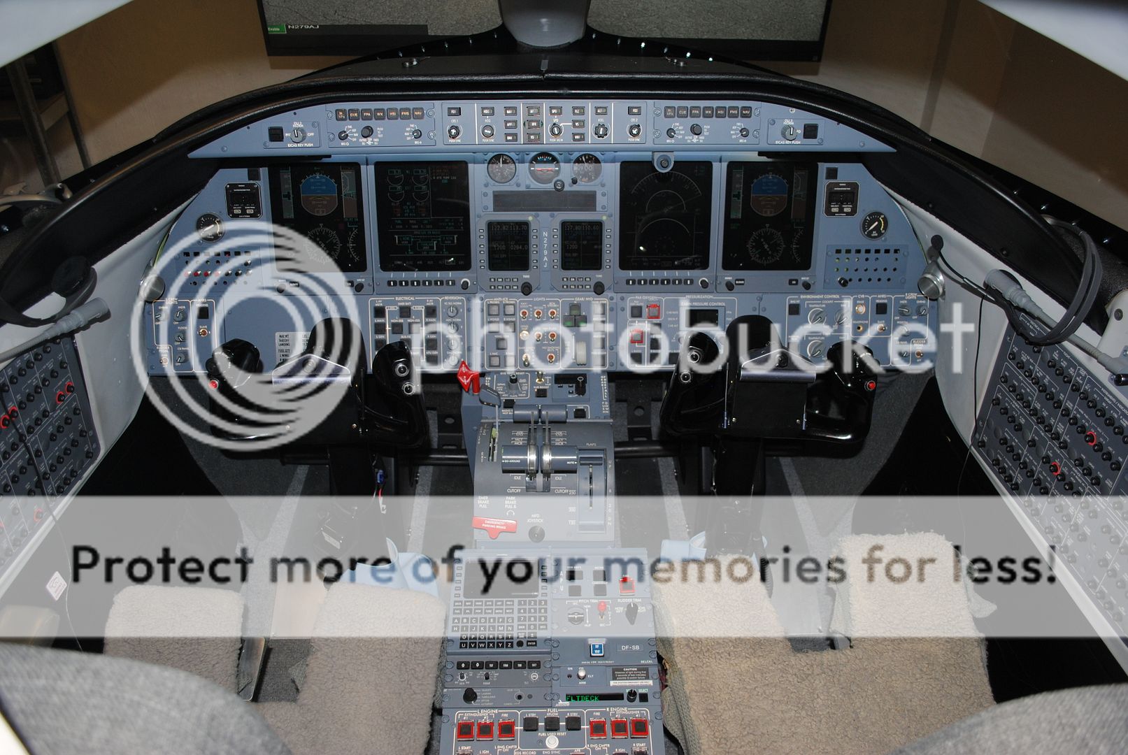

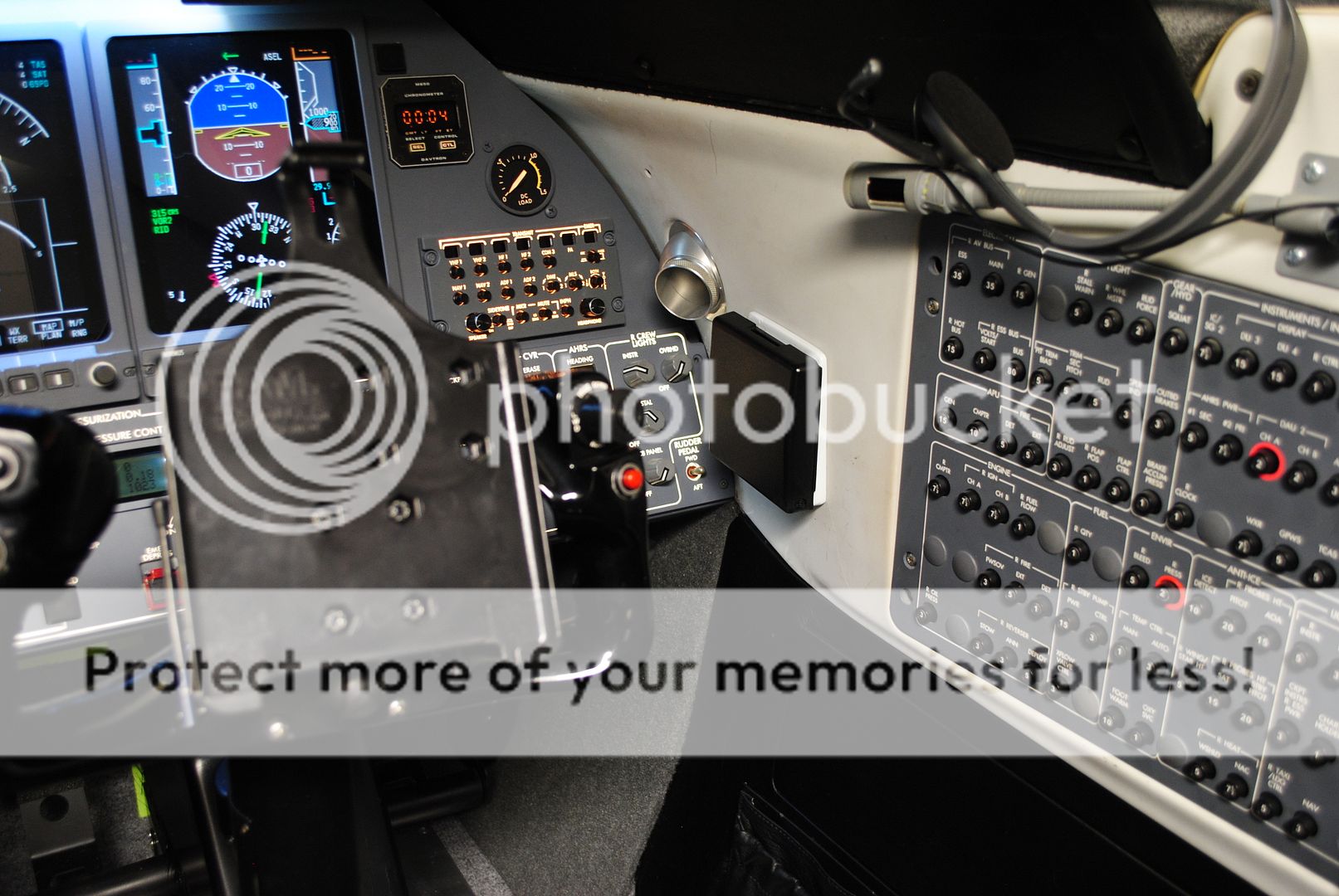

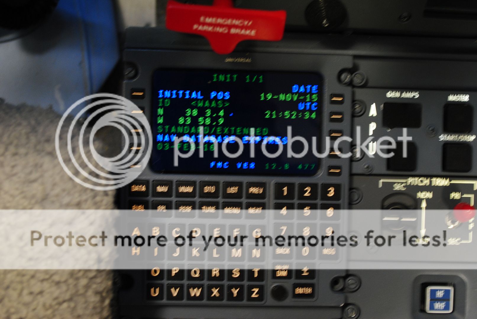

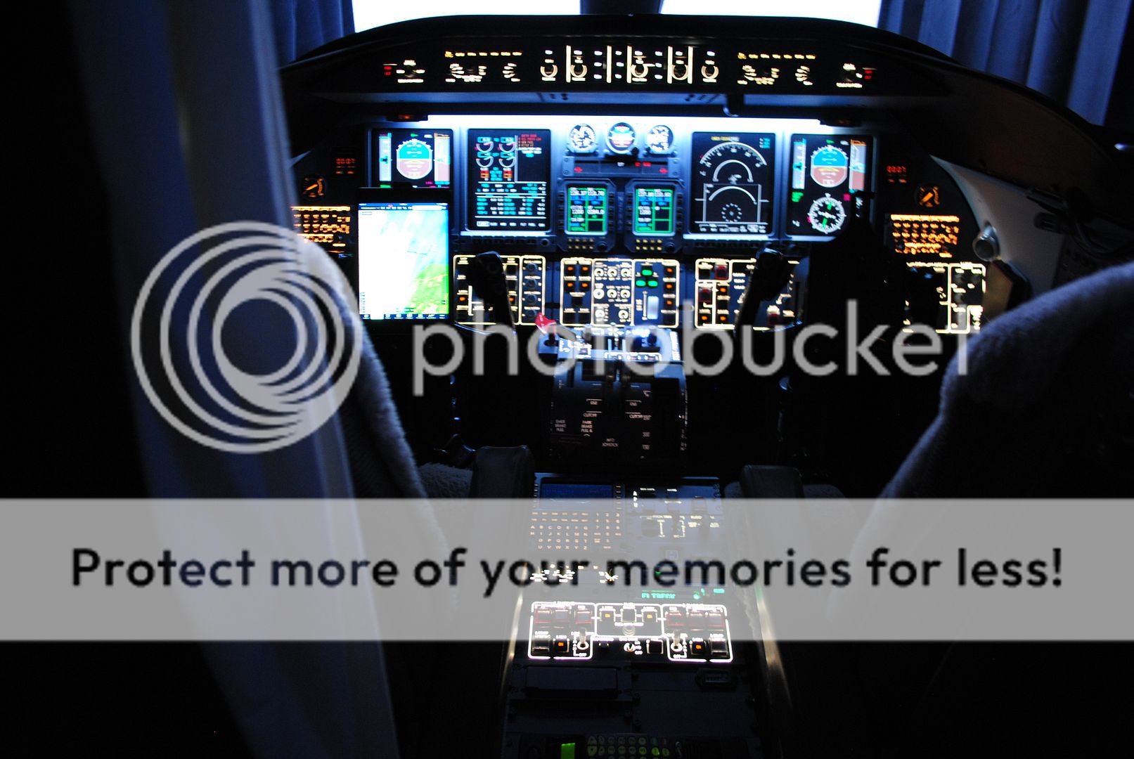

It has been a while since I updated my build thread here at CB . . since the last update I have installed the beta version of FLIGHT DECK SOFT's JET45 CDU software and am using it with a real Universal Avionics UNS-1 CDU.  I replaced the CRT with a 5 inch LCD screen and interfaced the keypad using a Hagstrom board.  Nothing like using real parts . . you can't beat the feel.  The JET45 CDU software also has an updateable AIRAC cycle thru Navigraph which makes it easy to stay up to date.
I have also added an Ipad mini running the FOREFLIGHT app.  The Ipad mini is mounted to the chartholders on the yokes by a Ram mount for the Ipad.  This was also a nice addition to my build.
Stick shakers were also added in after I replaced my first set of pvc control columns with real control columns out of a Lear 25/35.  I have them working with 24v and you definitely know it if they activate.  I've scared myself a few times not paying attention . .  kinda embarrassing    :o
As you can see I have finally reached a point in my build where I can fly more than build . . but I still have a few small areas to finish out and I marked one of those small areas off the list.  This weekend I finally had a chance to make a mold of the mounting bracket for the cup holder that is mounted on the middle interior panel.
I had one real one that I could use to make the mold.  The mounting bracket is needed on the real panels due to the curves in the interior panel. The bracket allows the cup holder to mount flush with the panel. Here are a few photos of the final result.
F/O side . .
Capt. side  with a cup for your viewing pleasure . .  and no I'm not a paid sponsor of Burger King . .
Also a photo of the  JET45 CDU  running with an updated AIRAC cycle for February 2016 . .  looks like I was a little shaky with the camera . .

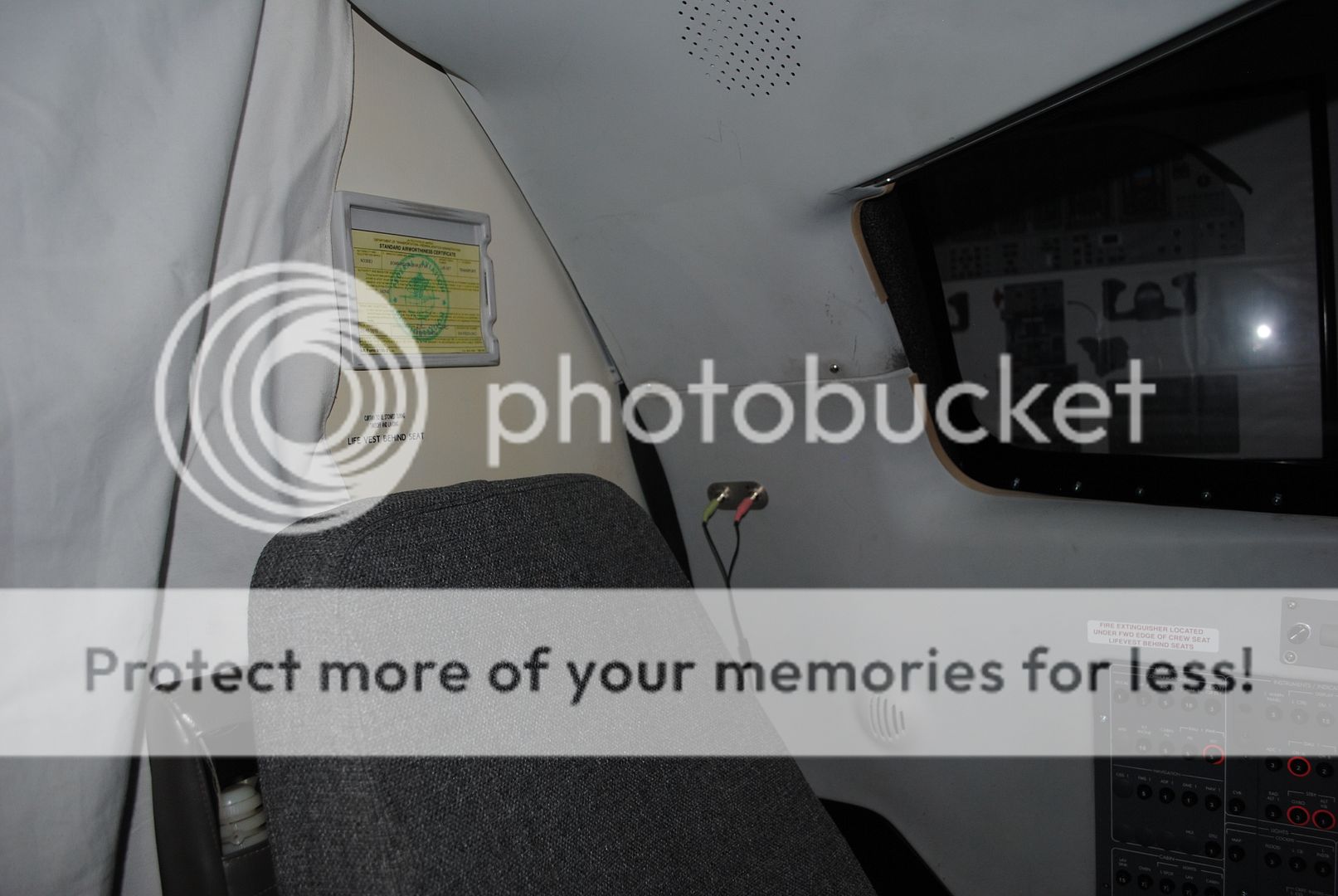

and a few other interior photos . .

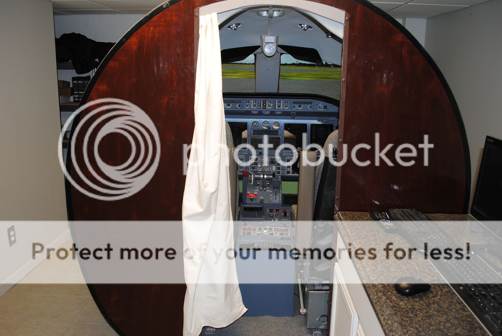

Hey guys,

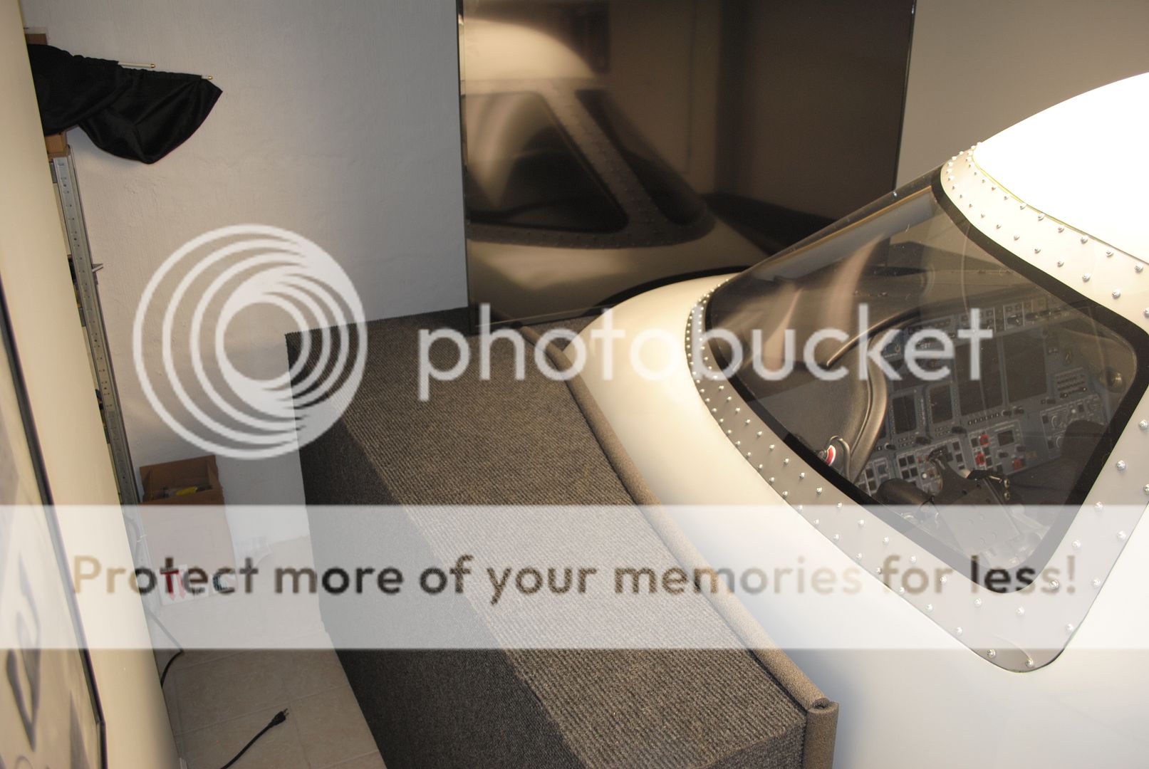

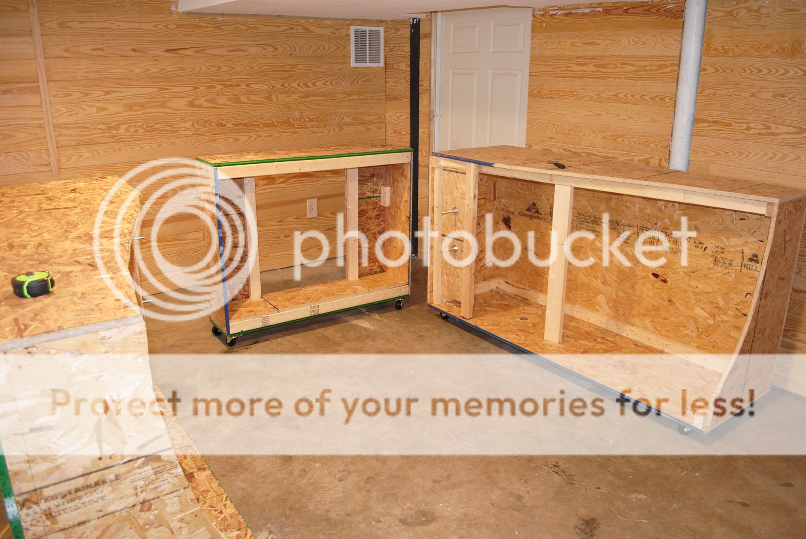

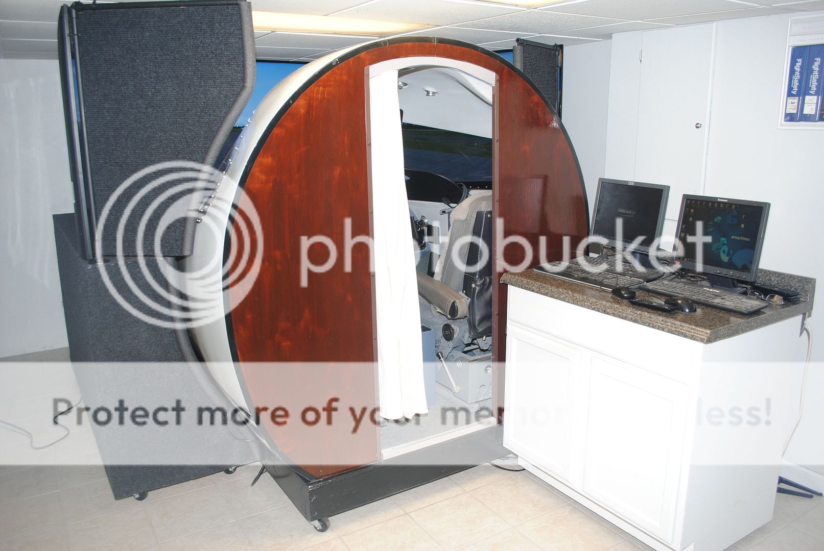

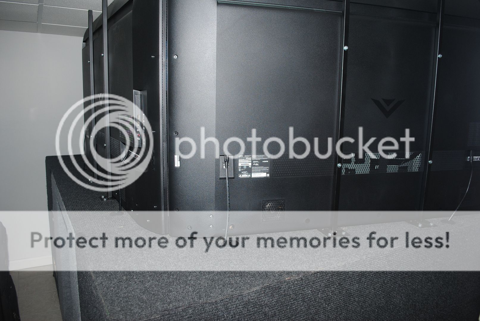

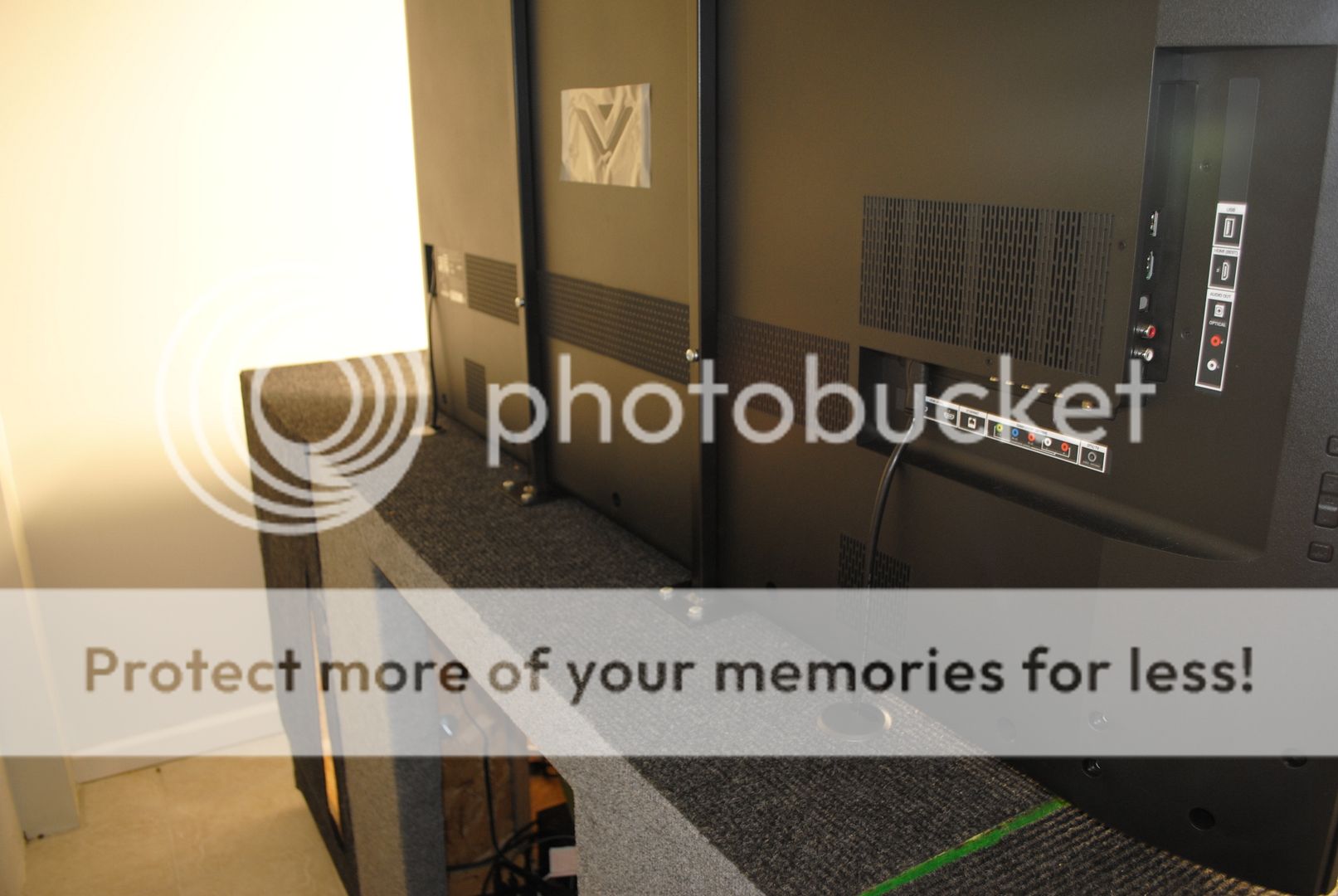

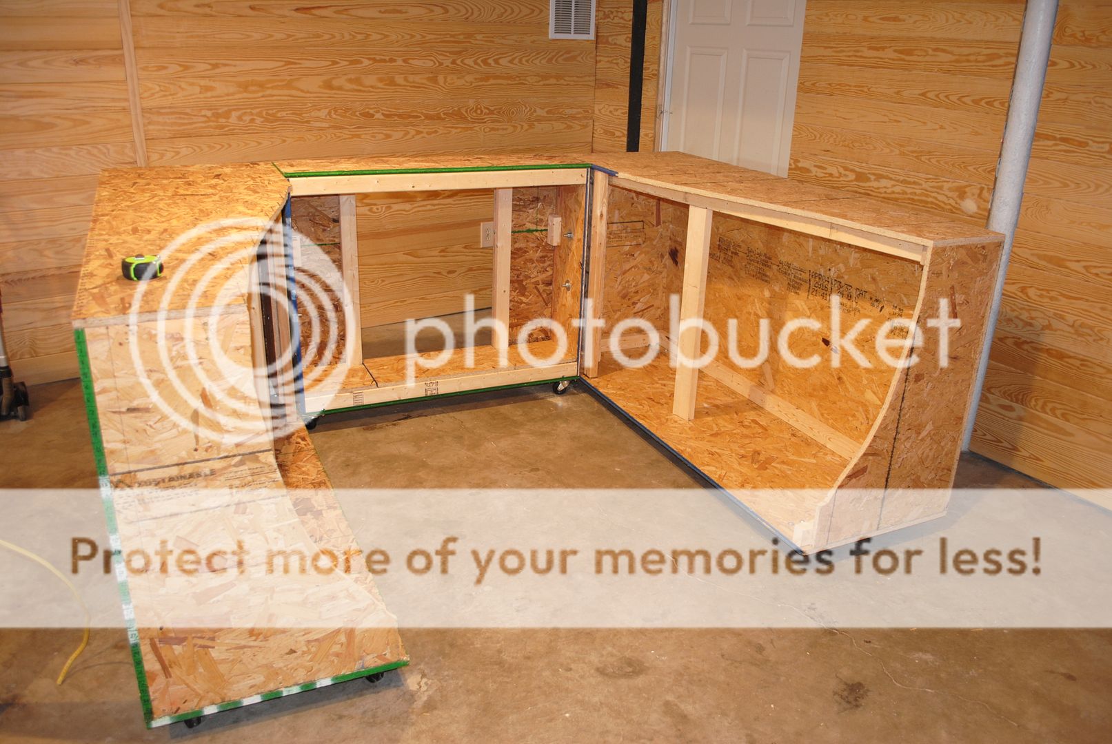

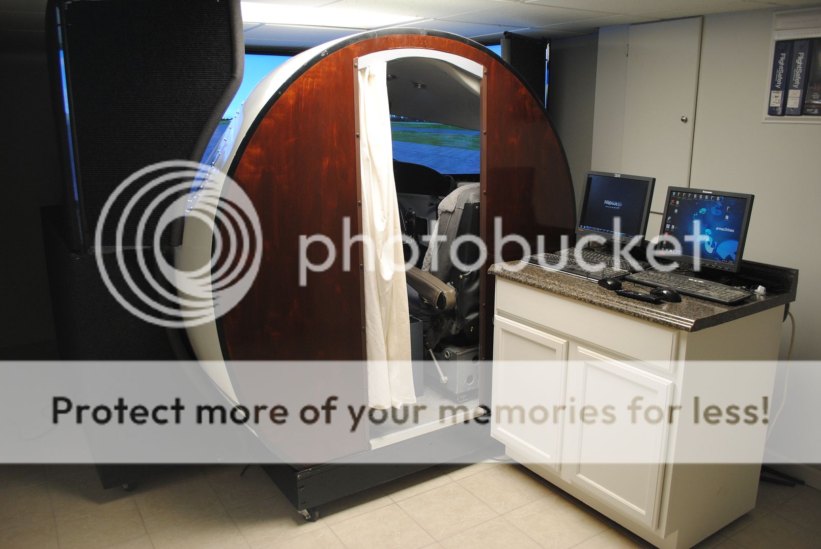

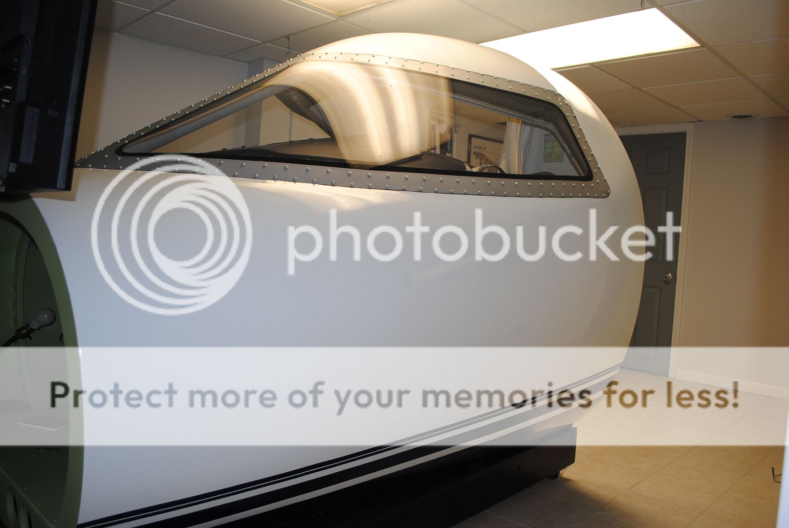

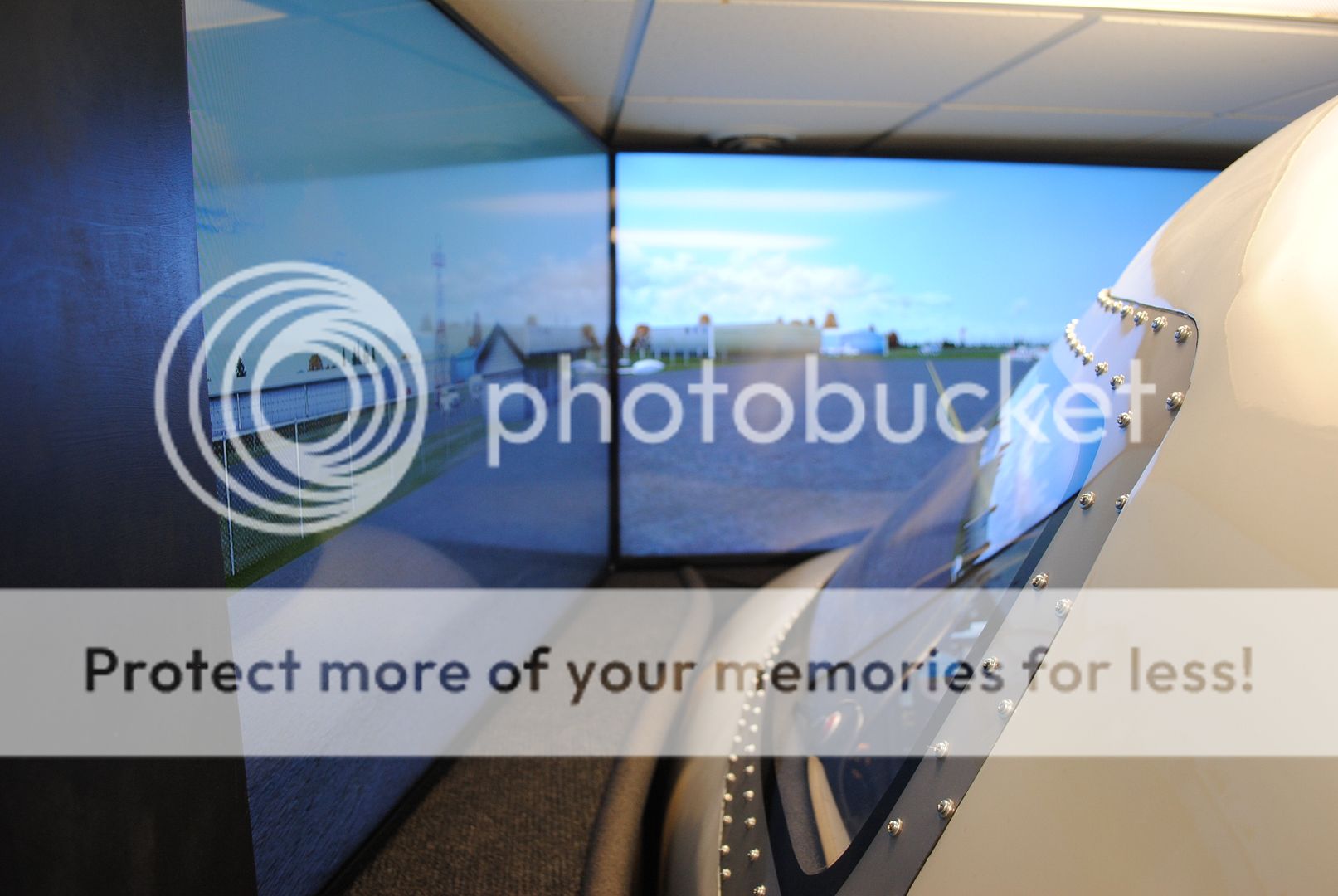

Let me bring you up to date on my build.  A couple months ago I started working on my visual system.  I've chosen three 70 inch TV's for my outside visuals.  Going this route I needed a base to mount the TV's.  I wanted something that appeared to be a part of the build. With that in mind I built a rolling TV stand that is U shaped and fits around the front and sides of the shell and conforms to the contours found on the sides of the shell.  I covered the stand with carpet to give a finished appearance.
Here are a few photos of the progress:
Early stages of the build . . I built the stand in 3 sections so I can move the pieces into position around the sim and easier transport if I ever have the need to move the sim.  The three pieces are bolted together once in place around the sim.
I left an opening in the front stand to be able to access the avionics area in the nose of the shell. At the bottom of the opening I added foam padding covered with carpet . . . much easier on the knees when working in the avionics bay of the shell . . .
A couple of photos demonstrating how the stand contours to the curves of the shell.
One TV mounted . . two to go . .
I fabricated six mounting brackets out of  3/4 inch tubing.  Two stands are used on each TV.
Four TV mounting brackets and two 70 inch TV's ready to be mounted to the stands. Takes two people so will have to convince the wife to help me . . .   :D

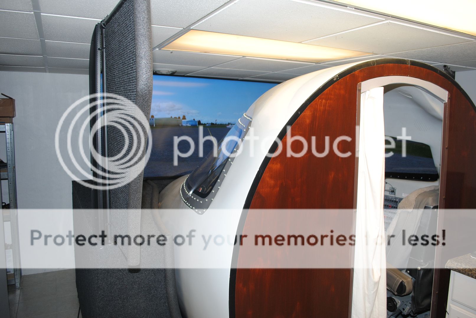

Reference photo showing the front left corner of the visual system. . .
I can rotate the back upper wall section out to gain access to the windscreens for cleaning . . .

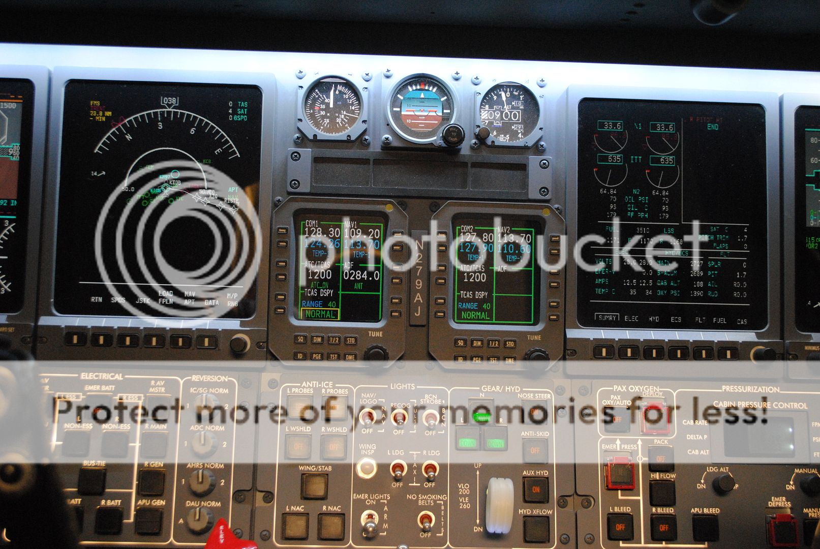

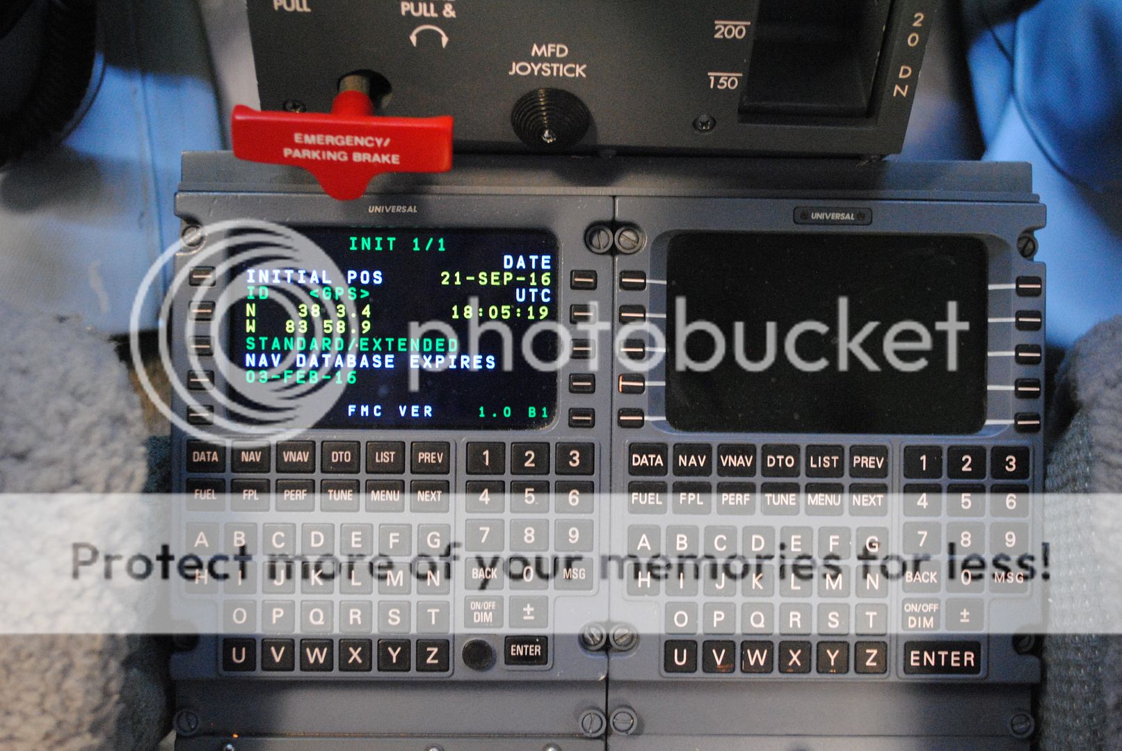

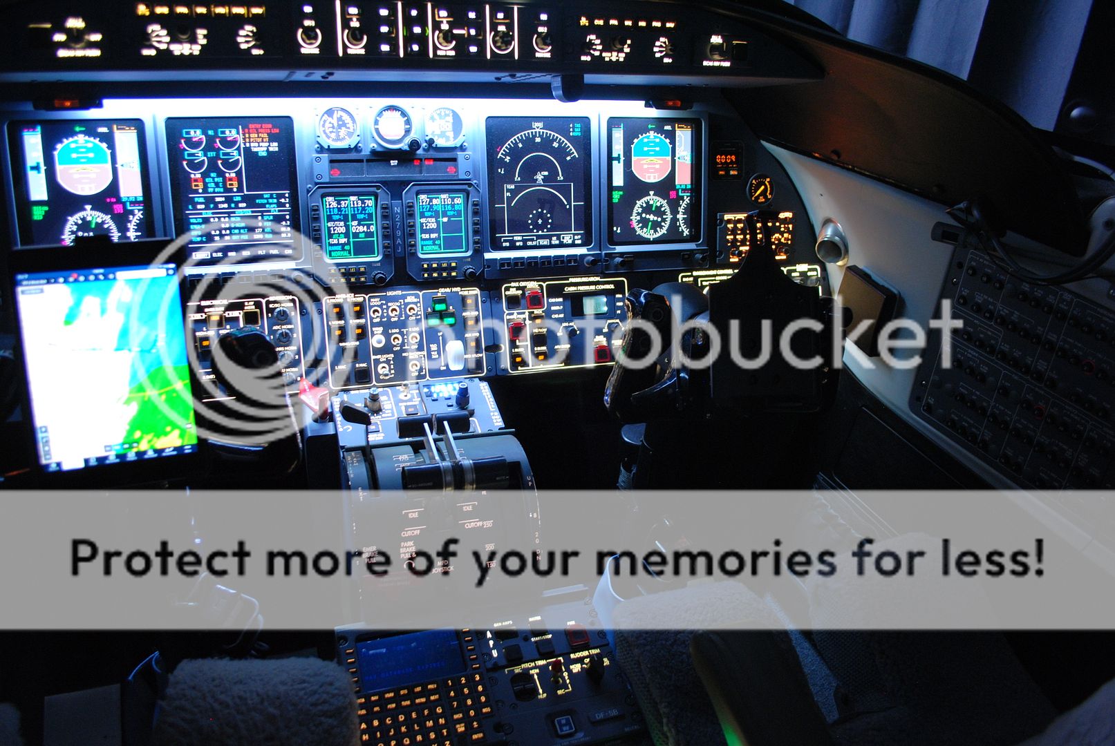

A few photos of the Universal Avionics UNS-1 CDU running FlightDeckSoft CDU software and the DU'S and RMU's running FlightDeckSoft JET45 software . . .
