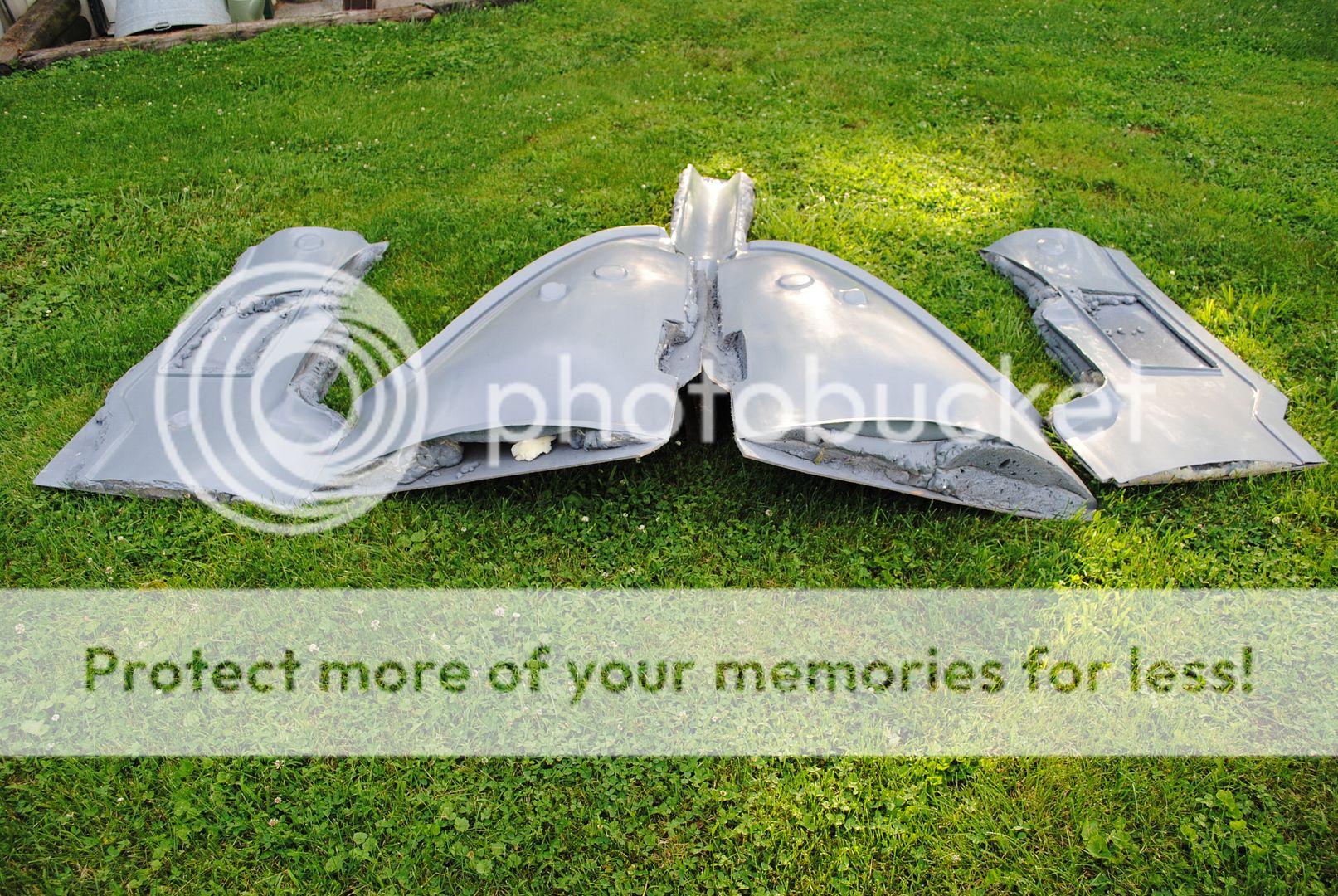

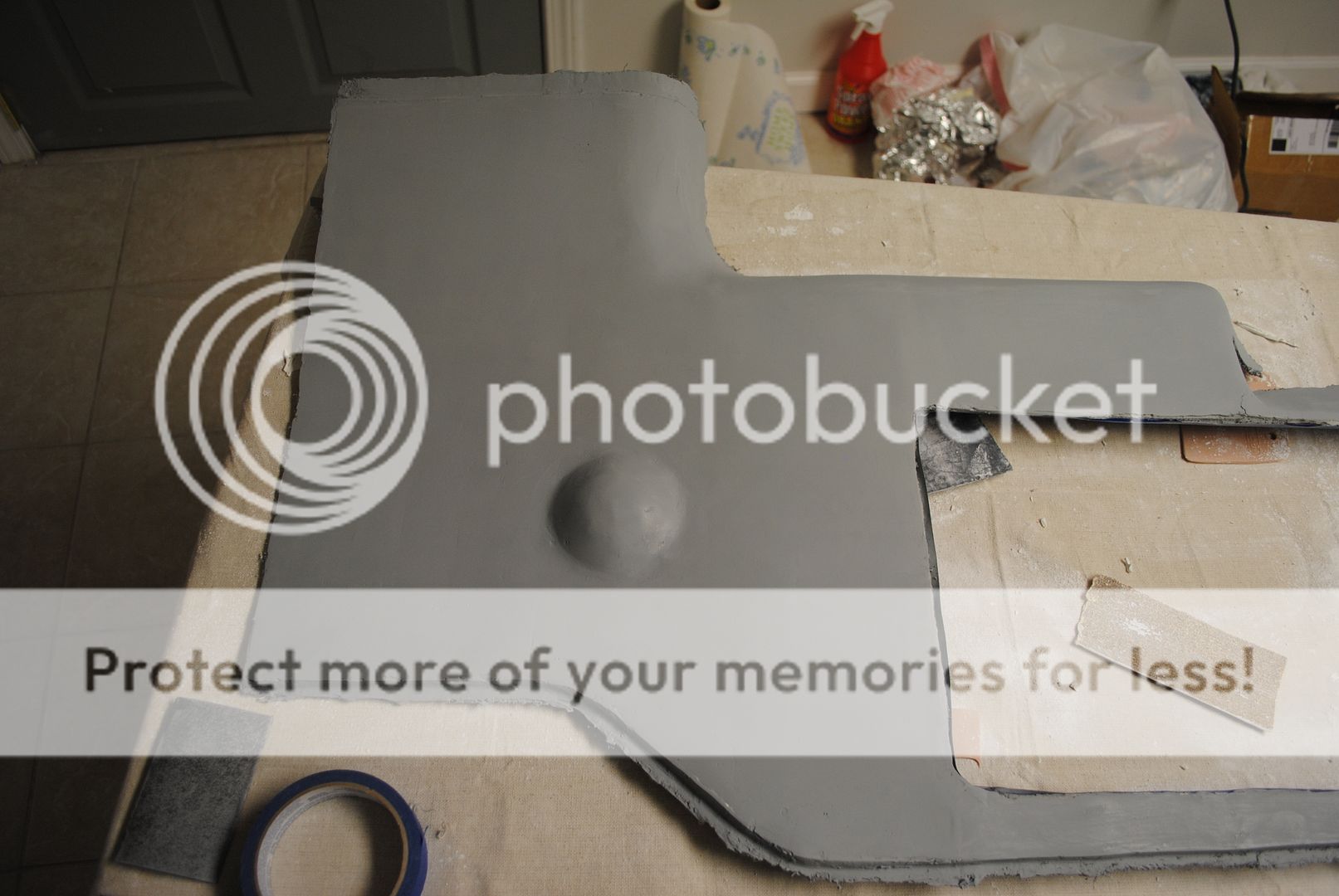

I've been quietly working on a project in the background for several weeks that hopefully will benefit the  Lear 45 builder community .  A couple years ago I was able to purchase the real interior panels out of a salvaged Lear 45 and debated for quite a while on whether I could use them as a mold to make more interior parts . . . first course of business is that I did not want to destroy/damage my real panels in the process.
So . . . a few weeks ago I started experimenting on ways to make a mold of the real panel.  First attempt with expanding foam  . . total disaster . . a waste of money  :/
Second attempt at the mold . . plastercloth and patching plaster . .  it worked!  :D

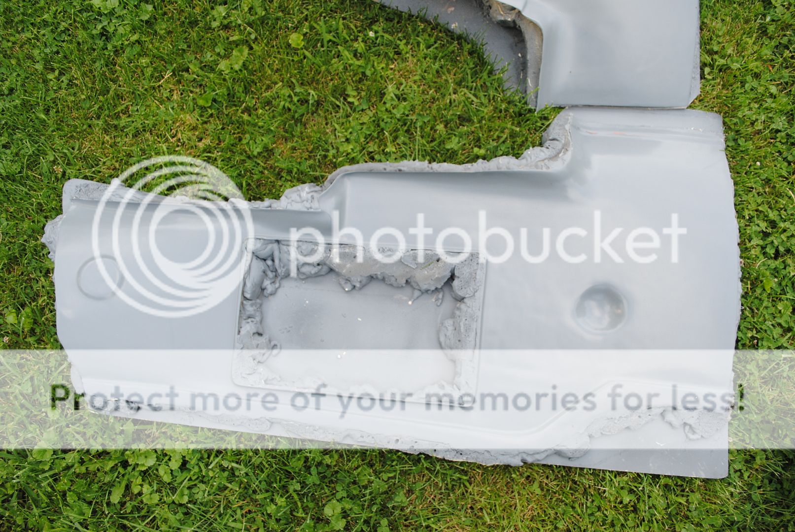

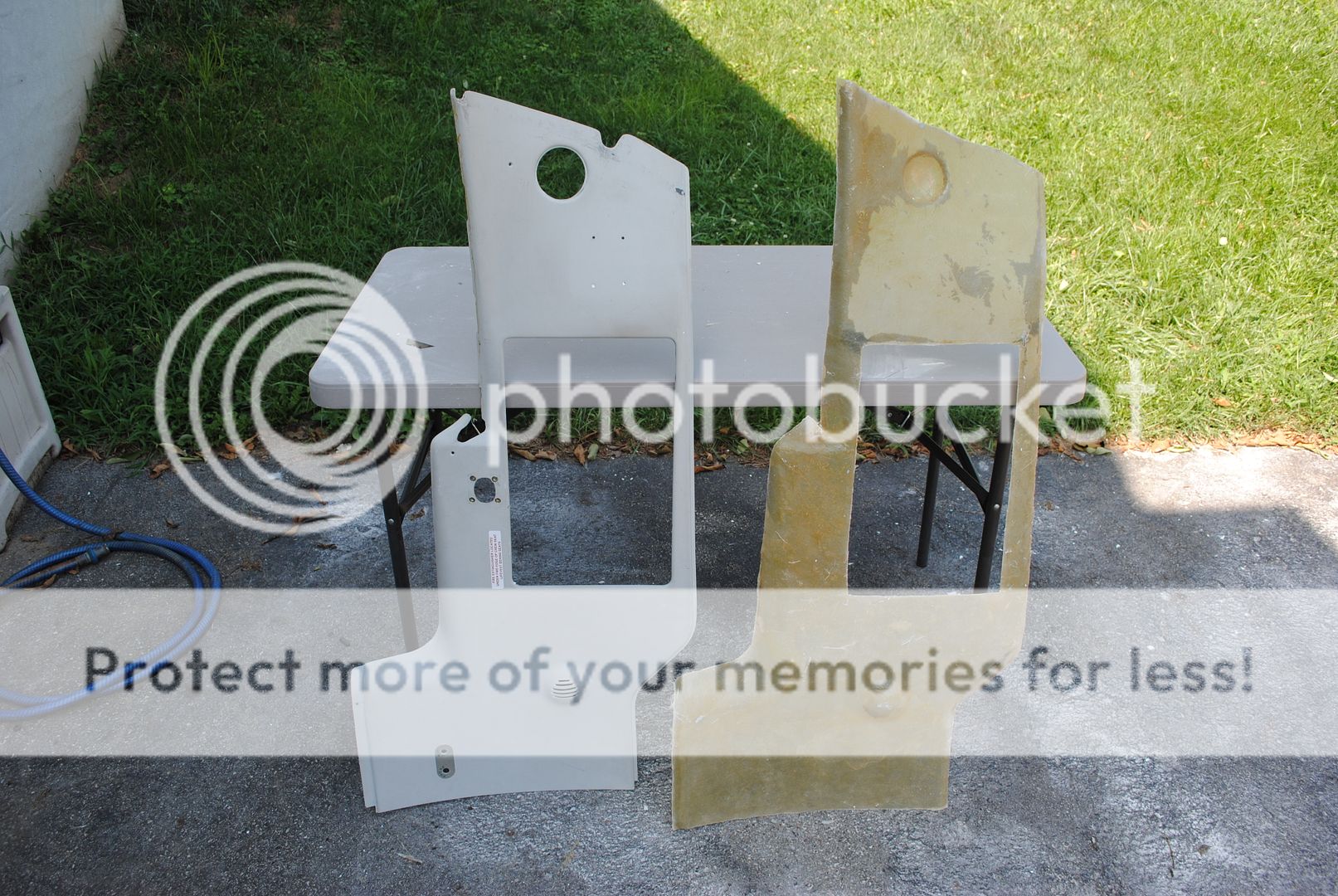

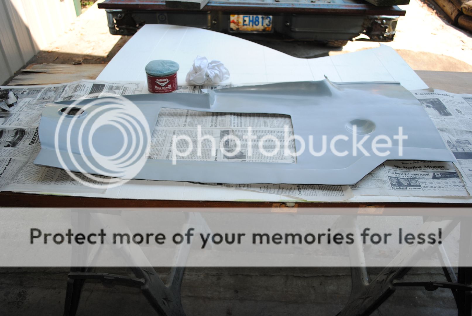

Here is a photo of the real interior panel covered with plastercloth and patching plaster waiting on a couple of layers of fiberglass to make the mold.  I had to cover the real part with plastercloth and plaster to protect the real panel while applying the fiberglass.
photo of the real part after sanding the plastercloth and patching plaster smooth and priming with gray primer . .

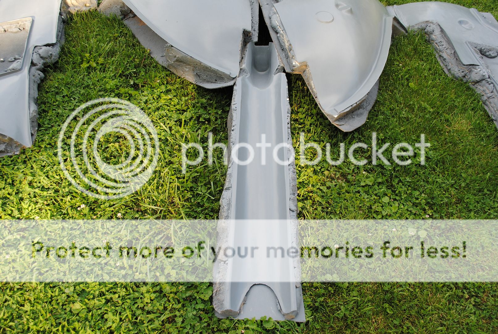

and after applying fiberglass to the plastercloth mold I had a mold . . this is a photo of the fiberglass mold after cleaning away the plastercloth and plaster.
I then applied primer and putty and sanded to a smooth finish . .  this is a photo of the inside of the mold with 10 coats of mold release wax . .
and a photo after the mold was sprayed with polyvinyl alcohol (PVA) . . used to cure the gelcoat and helps with the release of the part from the mold.

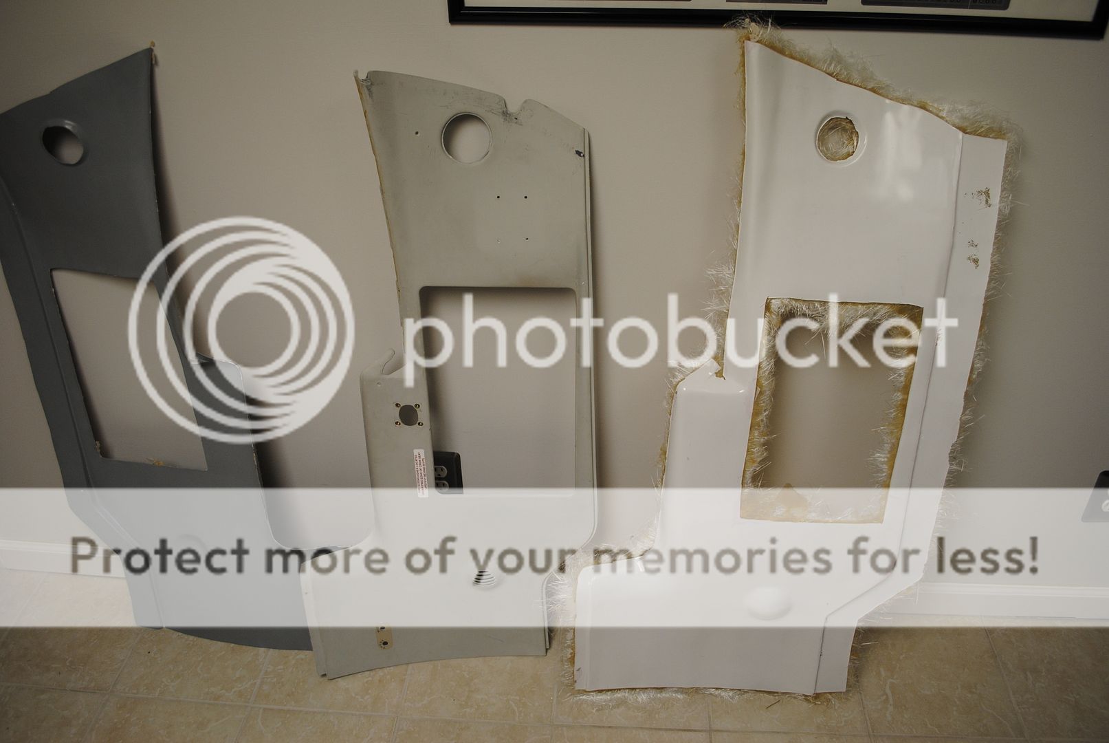

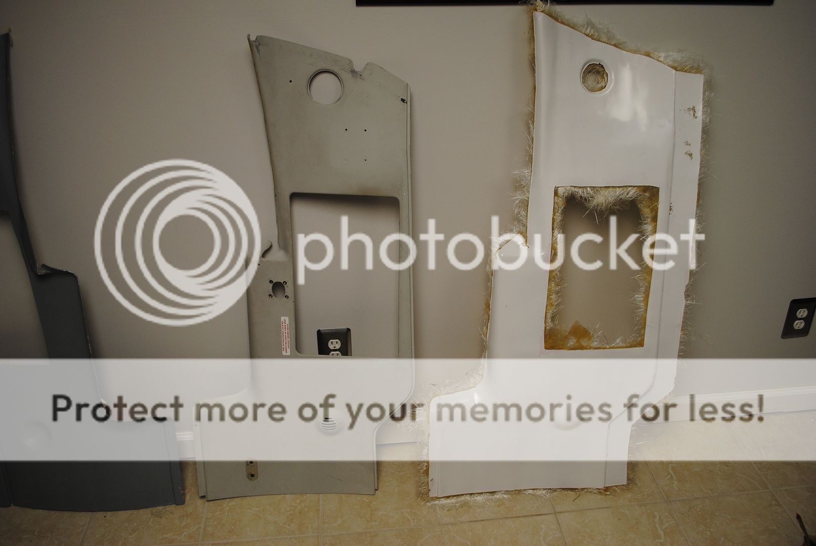

and here is a photo of the new interior panel . . the grey color panel on the left is the mold . . the middle panel is the real panel and the panel on the right is the new interior panel fresh from the mold.
and a closer photo of the new interior panel on the right . .  awaiting final trimming of the fiberglass strands
making the molds is quite a time consuming process as well as molding the actual part.   Molding the new part is a 4 step process . .  1) waxing the mold 10 times . . 2) spraying the PVA over the mold release wax . . 3) spraying the gelcoat . . 4) applying the fiberglass to the mold.
It is worth the effort as the final product is a very good representation of the real panel, is lightweight and flexible like the real panel and has a white gelcoat finish ready for scuff sanding and painting to the final interior color which would be left to the builder as some final fitting/sanding may be necessary to fit to the builders shell.

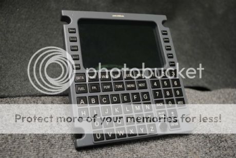

It has been quite a while since I worked on any parts for my build but thanks to Alan and Vince (Hangar 45 Lear builders) I was motivated to refurbish the real Universal UNS-1 CDU that I purchased last year.  After seeing Alan's CDU and Vince's updates on the interface for the keyboard I decided to get to work on mine.  I completely disassembled the CDU including the glass falling out . . didn't plan on that but worked out ok.  After several hours of checking each switch to ensure they were working, checking the lighting to ensure it was working,  cleaning each button with Dawn dishwashing liquid, sanding and painting the metal housing and a small amount of masking to save the Universal white lettering at the top, cleaning and reinstalling the glass with hot glue, I had a near new looking UNS-1 CDU . .   Thanks Alan and Vince for the motivation . . I was needing that!  :D
Here is a photo of the CDU after all the work . . .
Nice crazy job!
You think they would all use the same format hey! would be too easy..
I have a real INS on the overhead and the feel of the keypad is special, I suppose it is the same with your CDU.
well done
Yes . . the feel of the buttons would be hard to beat.  I love the feel of the real parts . . just have a heavier feel about them.   My weakness . . real parts!  Cost more sometimes . . and harder to interface sometimes but gives you a good feeling when you can get them to work!   :idiot:

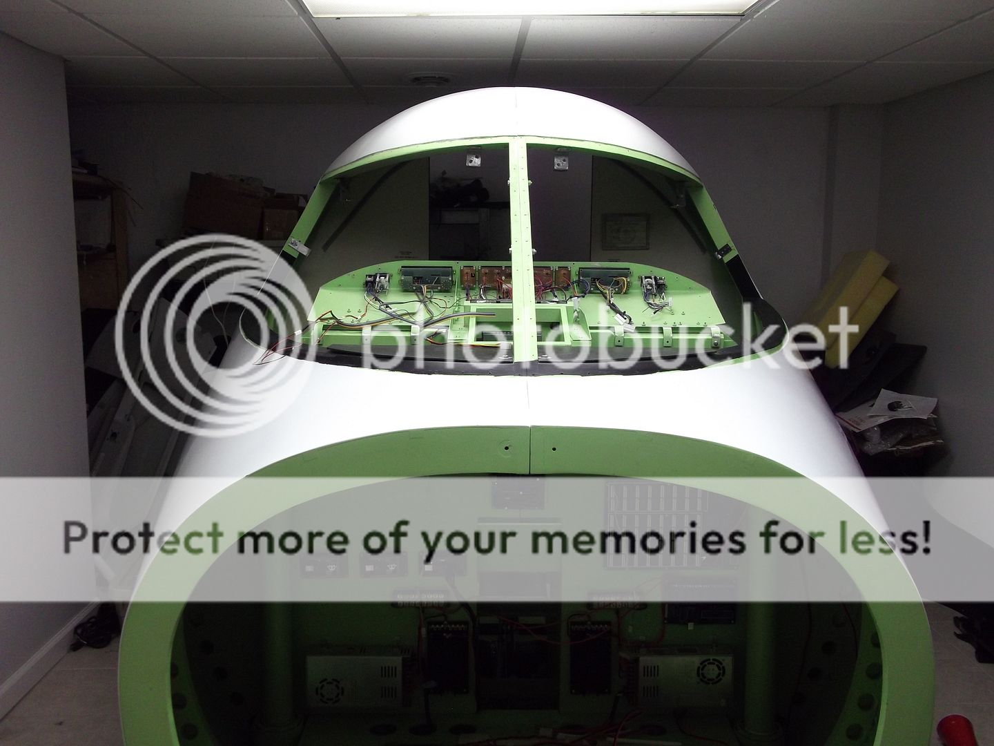

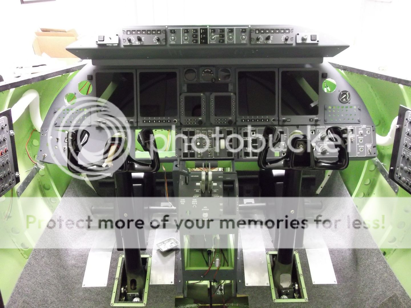

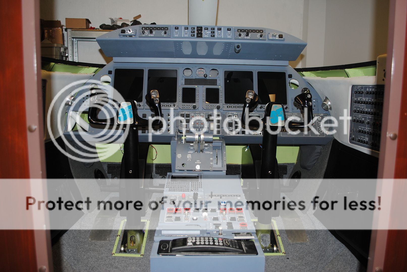

Wow . . it has been over a year since I have added any updates to my build so I think it is time I done some updates.  Over the past year I completely took my build apart to do a few modifications. One big modification that I completed was installing real control columns from a Lear 35 . . had to do a few modifications but I am very satisfied . . as most of you know I really enjoy using real parts if possible .
After completing that task I started reassembly of the interior . . at this point I have the TQ pedestal and MIP tower installed . .hopefully for the last time!  I also installed the MIP and upper MIP/Glare panel and started the wiring process.  Here are a few photos of the progress . .

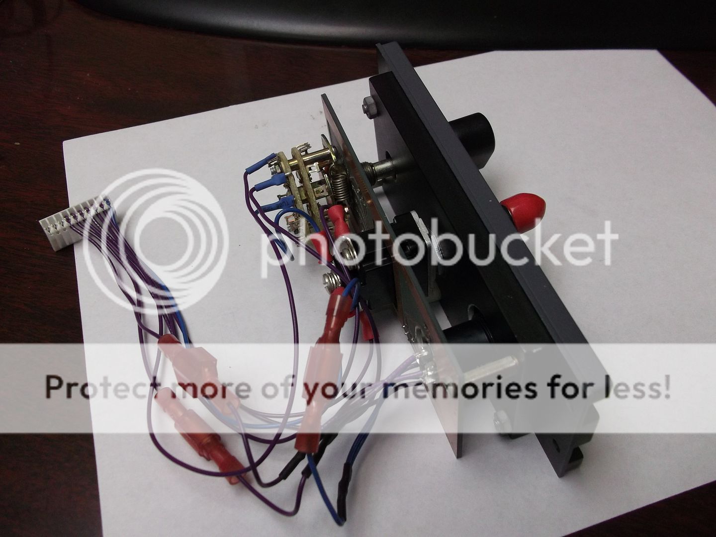

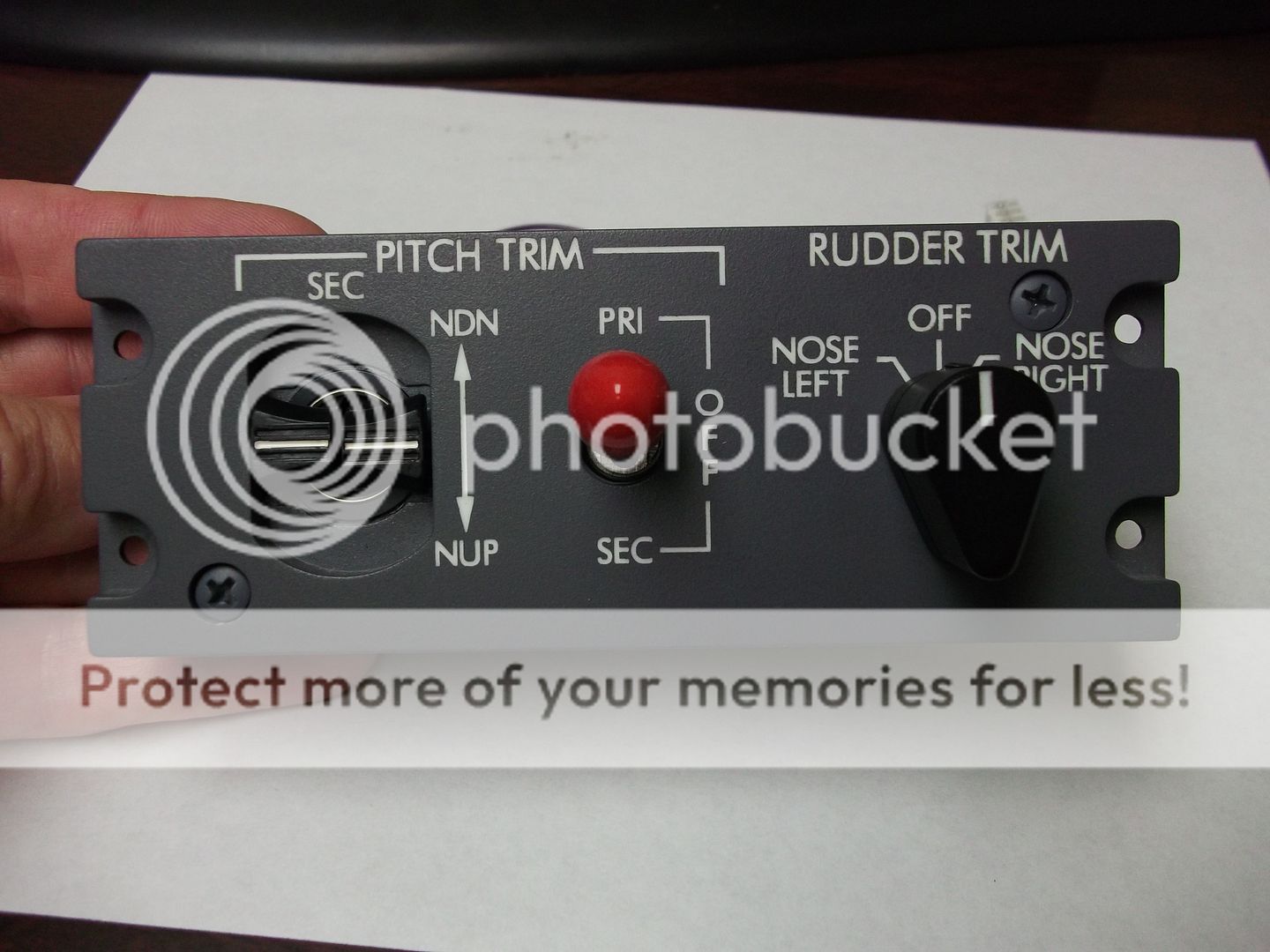

I also worked on the Trim switch panel that is located on the center pedestal.  Last year I found the real trim switch so had to install it and while working on installing the switch I started thinking about a way to make this panel function as in the real aircraft . . think I found a way with a DPDT switch but more on that later once I am sure it will work.   Here are a few photos of the trim panel . . .
N737AG
Awesome job Shane.
You'll have a lot of people (myself included) lining up to fly her.
Axel
Wow...wow and freaking wow!
Absolutely gorgeous Sim Shane.
ABSOLUTELY SIMSATIONAL!!! You will have to tie it to the ground!!

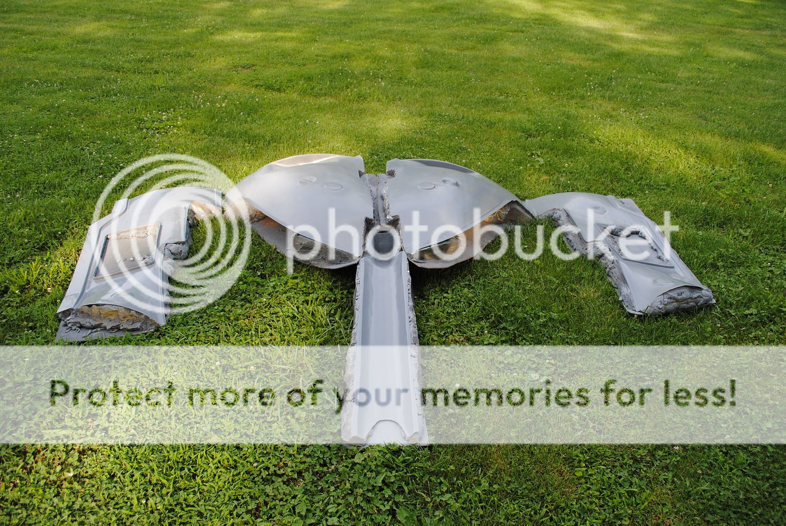

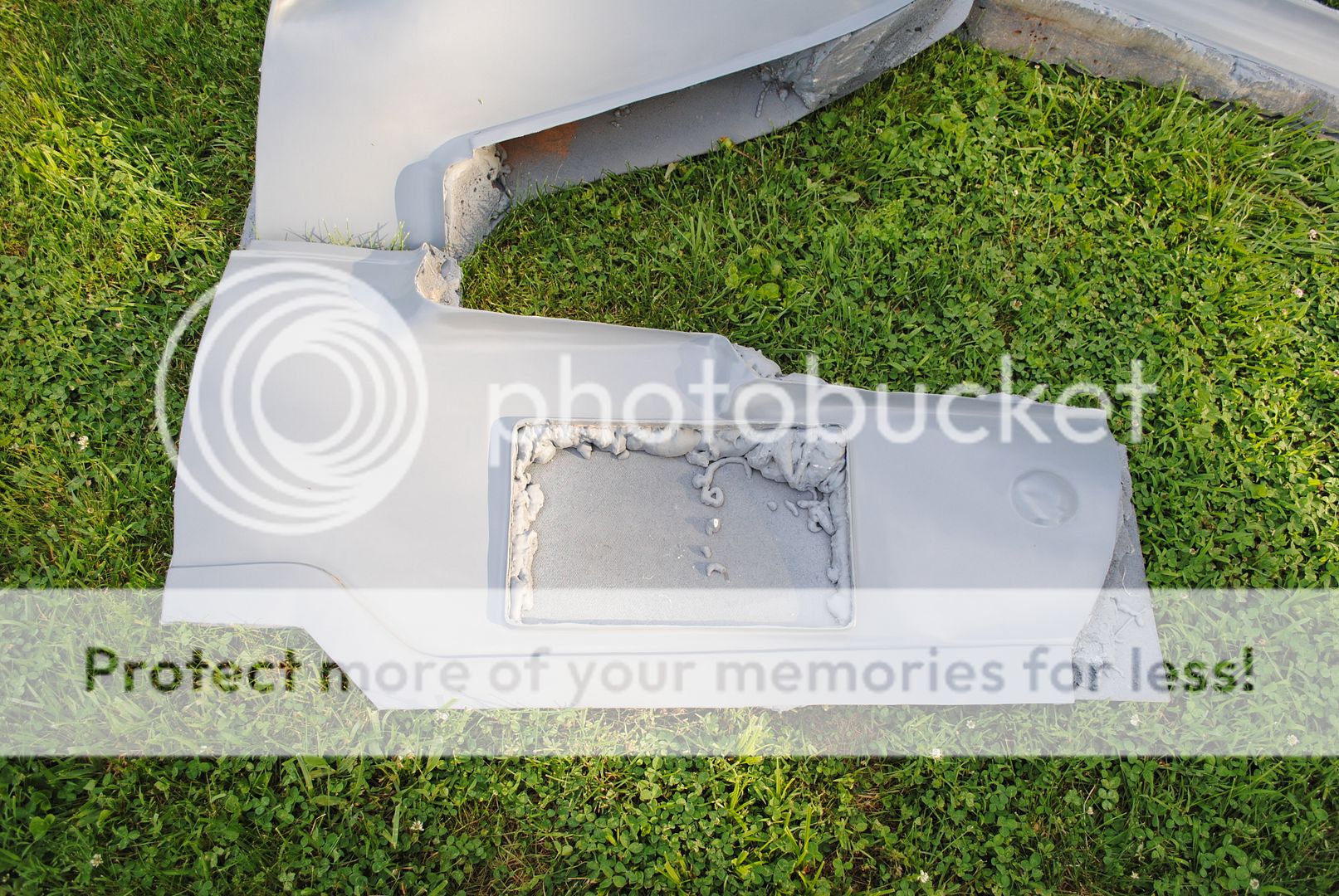

Almost a year and ten months I started a side project to my Lear 45 build.  I was able to get the real interior panels out of a Lear 45 a few years back and I made molds of them using fiberglass.  I started this project to be able to provide replica interior panels for Lear 45 builders over at Hangar45.  I didn't anticipate it taking me this long but finally I completed the molds this weekend and am now ready to do a test run to see if I can successfully mold the replica panels.   Here are a few photos of the molds with ten coats of mold release wax on them.  Next step will be spraying them down with polyvinyl alcohol (hairspray), then a couple coats of white gelcoat, then lay up the fiberglass.  That will all wait till later . . currently waiting on supplies from Jamestown Distributors . . .  :idiot:

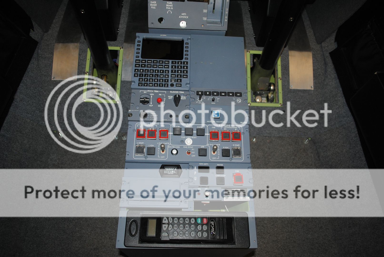

Here are a few updates to my build . . finally was able to purchase the computer parts I needed for the main flight sim computer and a couple of photos of the sim . . .
A list of components in my build:   Intel i7-4960X LGA 2011 / Asus Rampage Blk edition MB / EVGA Geforce Titan Blk video card / Corsair Vengeance 2400mhz 32GB / EVGA 1300w PSU / Samsung 840 Pro 512GB SSD / WD Black series 1TB 7200rpm HD / CoolerMaster Seidon 240 liquid cooler /  CoolerMaster 932 HAF case / Windows 7 Pro 64

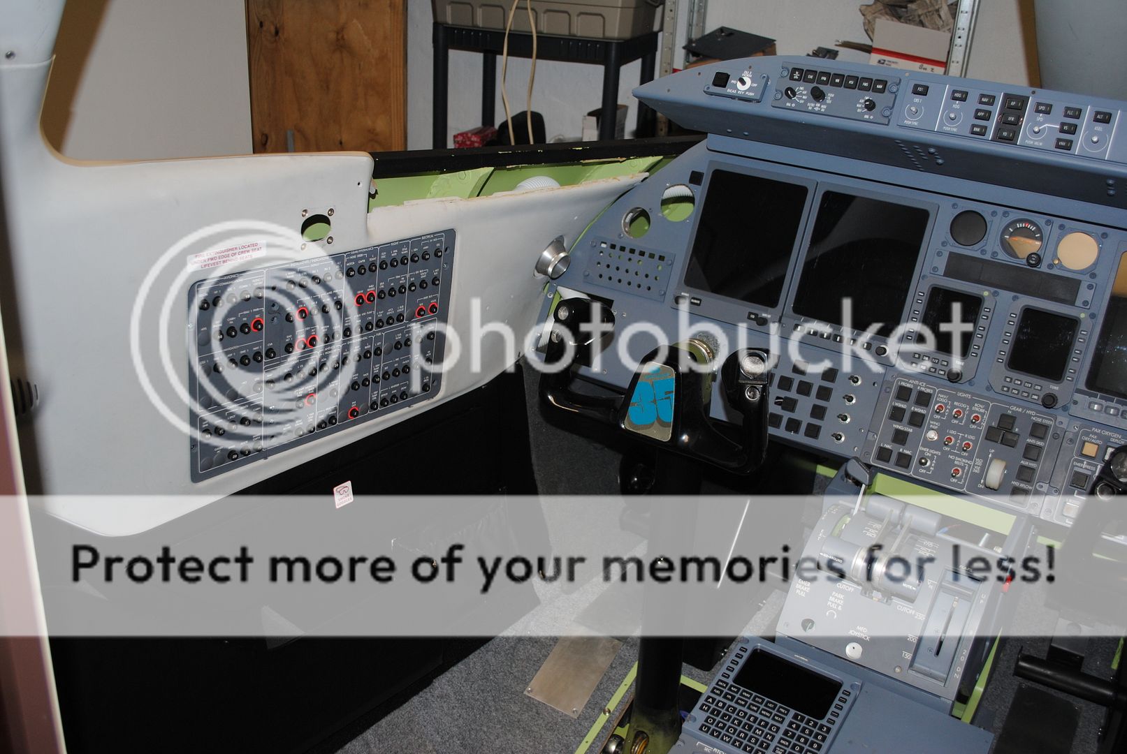

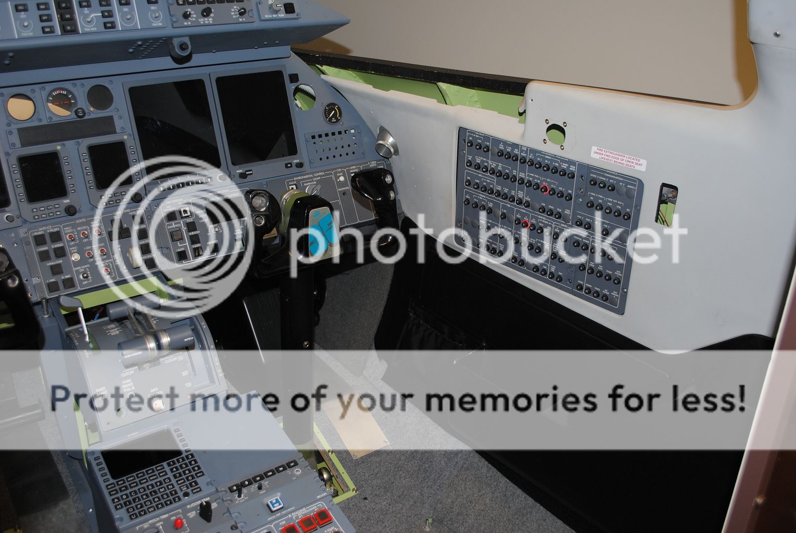

I was able to get some of my interior panels back in the build after finishing up the interior molds . . .
A few of the panels in the center pedestal .. waiting to be wired in.  Also I've added the switch bezels that Ron Rollo made for the engine start panel . . a nice finishing touch to that panel!

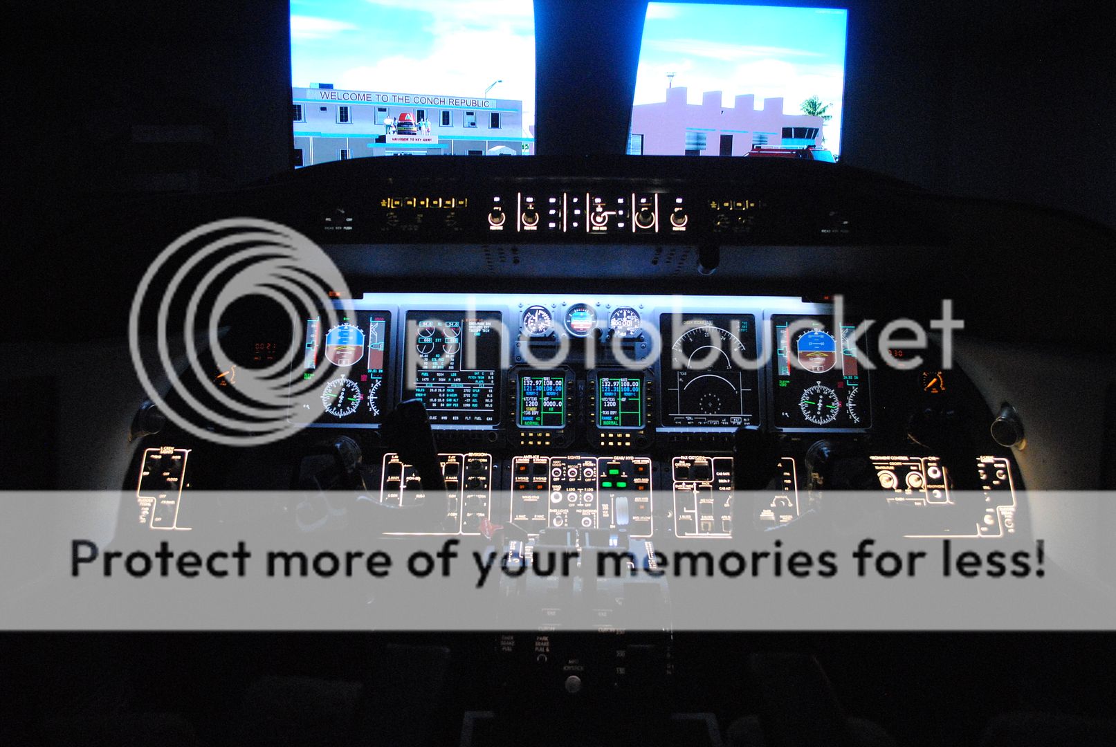

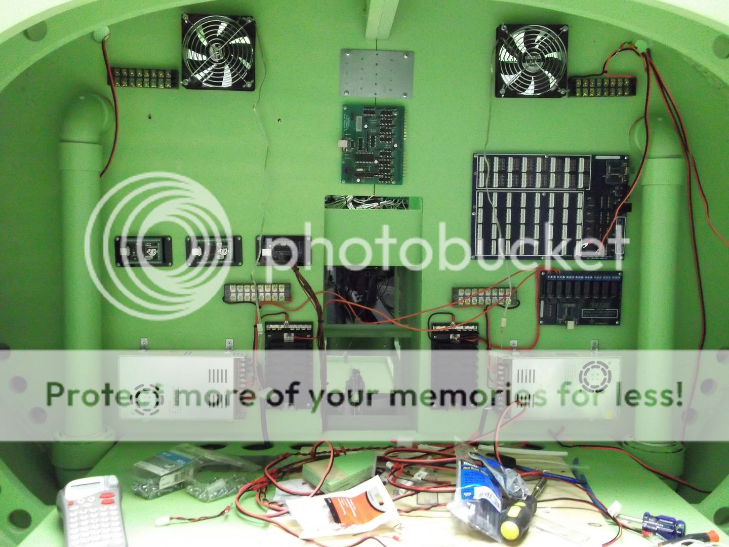

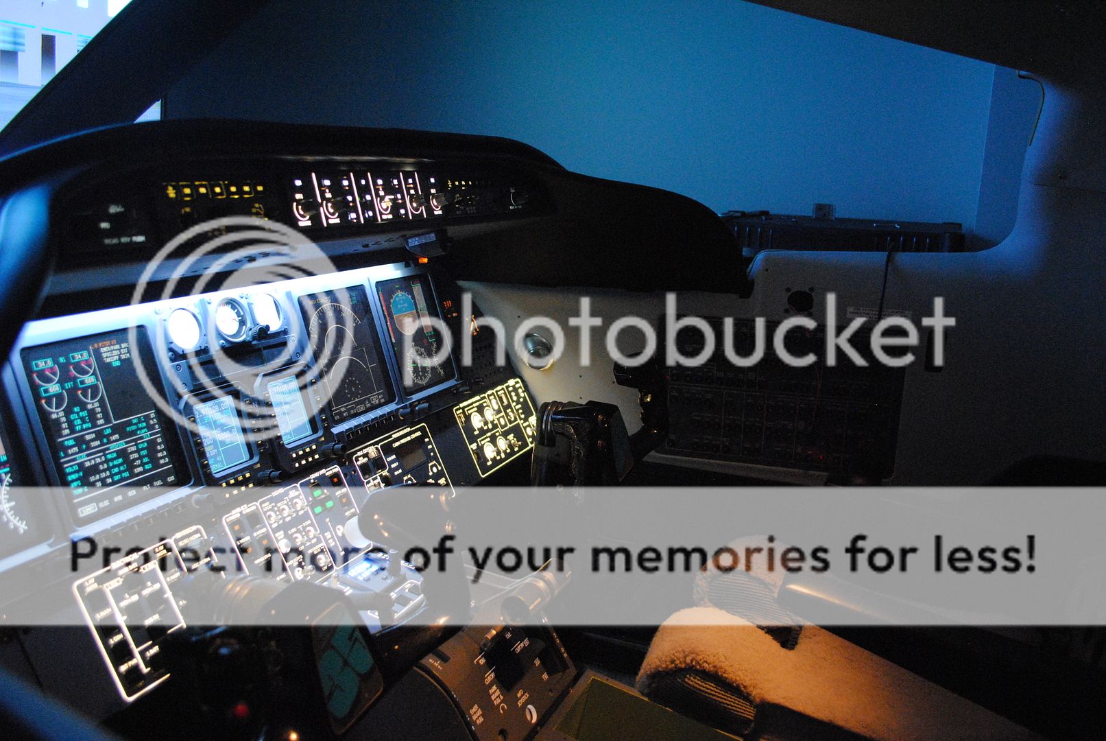

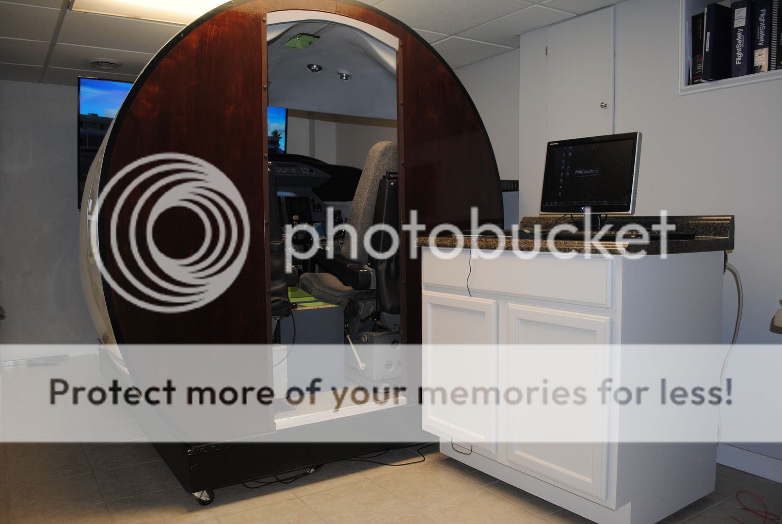

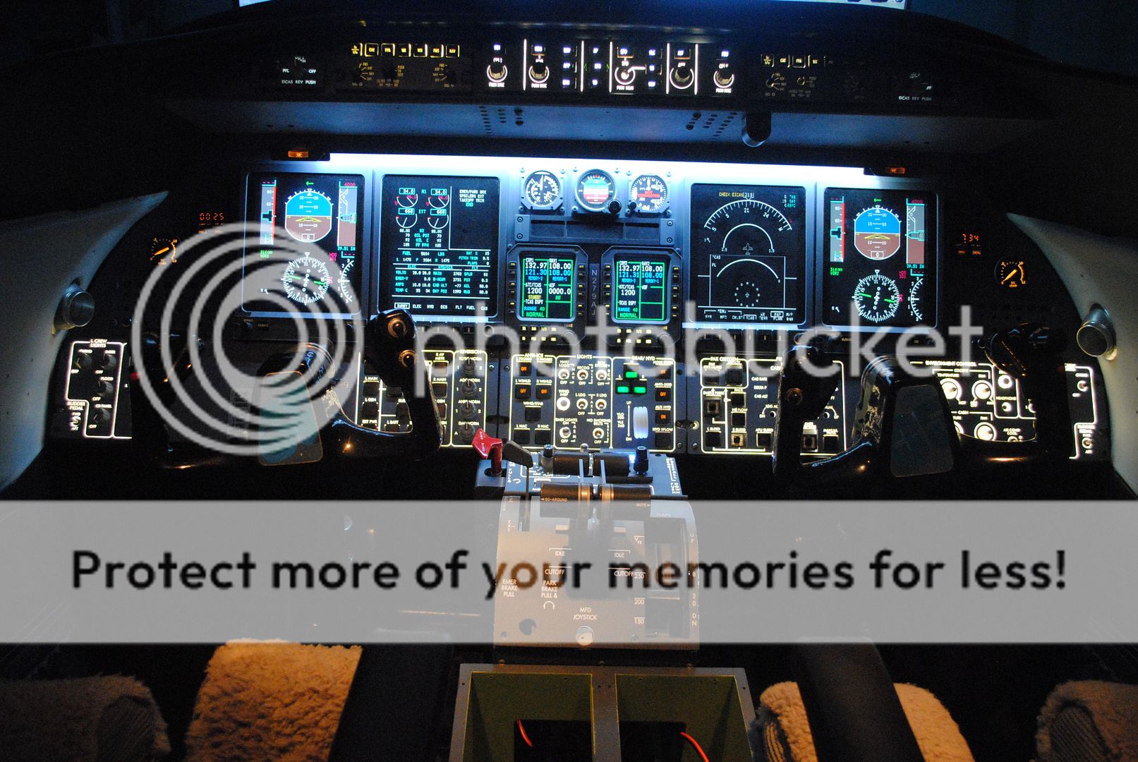

Four months since my last update . . .  but I have been making progress.   During this time I built an instructor station to house the 2 computers (later will be three). I also have the two Davtron clocks online, and several smaller areas finished that needed a little attention.
Instructor station at rear of shell:
Photos of interior lighting:
