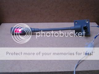

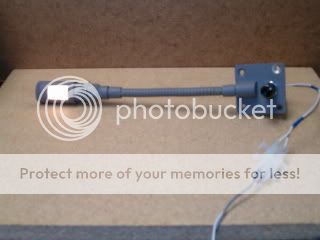

I finished the conversion from 28v to 12v on the gooseneck maplights found on the interior side panels tonight.  One step closer to starting the assembly of the interior of the Lear shell.
White light . .
Red light . .

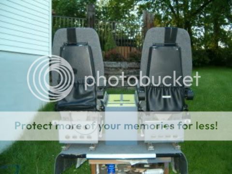

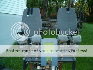

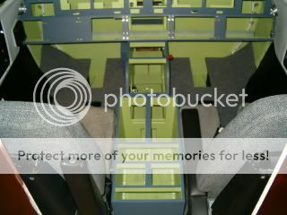

The seats are IPECO and I think may be out of a 737 . . if anybody recognizes what they are out of let me know.  The seat cushions are 17 inches wide . . perfect for the Lear and the distance between seat rails center to center is 9.5 inches . . seat bases are a little narrower and once again a perfect fit for the Lear.

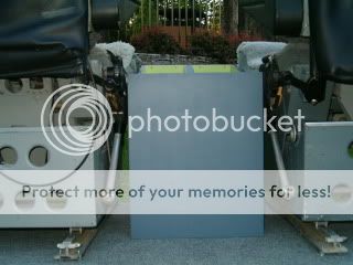

Scott . . you will appreciate this photo . . knowing first hand how tight the Lear cockpit is . .

Those are almost definitely from a 737. They could have been from a retro-fitted 727, but it's doubtful. Nice seats!
Im a little confused with that picture. Is that a picture with the seats coming off another sim or is that part of the real airplane there? Looks pretty tight there not to be on J-Rails.
Good looking seats though either way!! Nice find
Hey Mike
That's the raised floor section from Shane's LJ45 sim with the seats attached to it. All of us who have the Rollo shell kit for the  LJ45 have this rear raised floor section, and that's what you are seeing with the center pedestal on it.

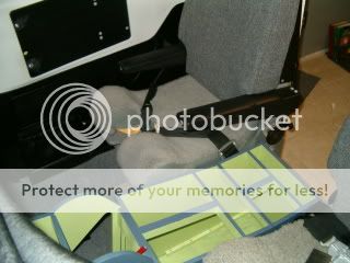

As Eric stated that is a floor section that is removable from the Lear project . . I had it outside of the shell as it is easier (more accessible) to work on.  I had set the seats in place on the floor section and then set the center pedestal in place to show how close the seats sit to the pedestal in the Lear.  In the photos you can see the floor carpeting hanging over the sides of the floor section . . that carpet actually lays up along the sidewall of the cockpit . . kinda gives you an idea of how tight the cockpit really is . . I cannot gain weight or I won't fit!   Thanks for the comments guys . . I thought the seats were 737 . . but not sure, I figured somebody could identify them.
Ahh i see, my bad.. Guess i didnt read back far enough! Yeah they definately look 737/727 to me, and in good shape!
I remember flying Lears and your right on the tight fit.. Hardest part of flying that thing was getting into it without breaking stuff! I remember a few new FO's stomping on some fuel switches :)
Hi Mike,
Yeah that is one of my concerns . . getting in and out without breaking parts.  I've thought about fabricating some type of shield that will set in place on top of the pedestal while entering / exiting.  It could be removed and stowed behind one of the seats . . if there is room while using the sim.  Hate to do all this work then break something first thing.  It would be easily done even if being careful entering and exiting.

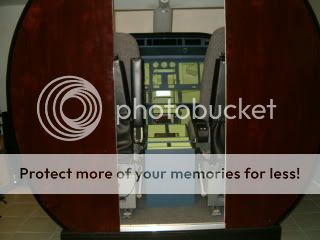

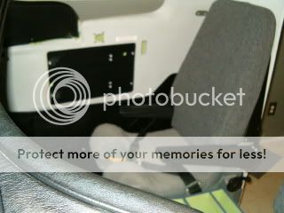

Seats installed . . .
Sweet! I love the stained wood on the outside as you enter the deck.. Just like the real ones :)
As far as breaking stuff getting in i think some type of cover is a good idea. I would mostly be concerned with others getting in and out!
Hope i get an invite when that thing is flyable! Really looks cool.. I kinda miss flying those things.
ahh,  you noticed the "simulated" stained wood.  I had thought about painting this section white like the rest of the shell, but I opted for the stained look.  At some point I am considering adding a few of the details that you would see in this area such as the exit sign etc.    Maybe when I have it all together you can give me some flight instruction on the Lear.     :idiot:

Nice bulkhead!
We used to have a nice name plate holder we would slide our engraved gold name plates into on the left (captain) side of that stained bulkhead.. Kinda a nice touch, or something else to add there. There may have been a magazine rack on the FO side as well. O and maybe you could print out or recreate an airworthiness certificate to put there as well behind some framed glass. I think that was on the low Captain side? not sure.

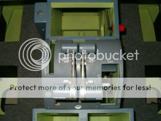

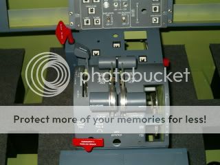

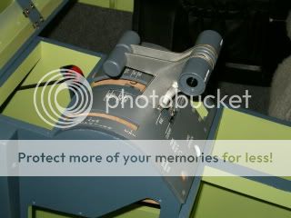

I received my TQ back from a buddy of mine (Ron Rollo) who built them up for me . . I picked up these real TQ, spoiler and flap levers over a year ago and now they are ready to install.  The spoiler lever is not shown as I will need to do a little modification to it so it will fit the real TQ light plate . . I know you are wondering why won't the real spoiler lever fit the real TQ plate . . well the TQ pedestal side panels are thicker than the real ones leaving less space to work everything in so the spoiler lever needs to be moved a little.
Looks good, and a great color match between the lever knobs and the housing plates.
From experience I know that you have been sitting there, moving the levers slowly forward while making engine noises!!!!
Great TQ Shane.
Looks awesome Shane.

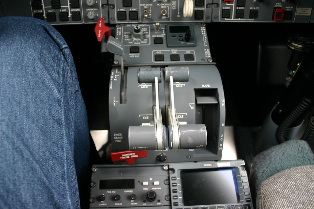

For comparison guys here is a picture I took in an actual Lear 45 at my local airport.     Shane is spot on.

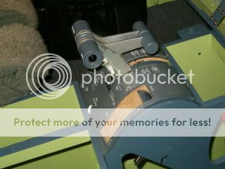

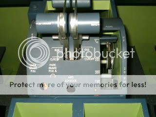

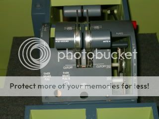

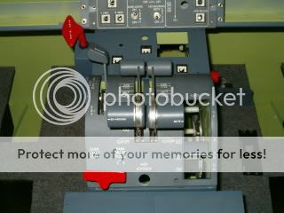

I finished up a little tweaking on the spoiler lever and parking brake handle assembly so that they will work with the real Lear 45 TQ lightplate that I found.  I still need to paint the parking brake handle red and apply the lettering . . always a little more work to do .  Update . . painted the parking brake still need lettering.

Finished up a few small details . .  applied the lettering to the parking brake handle and I located a real SELCAL panel for my project.  I will need to paint the SELCAL panel the correct color . . but in the meantime it fills space on the pedestal.
