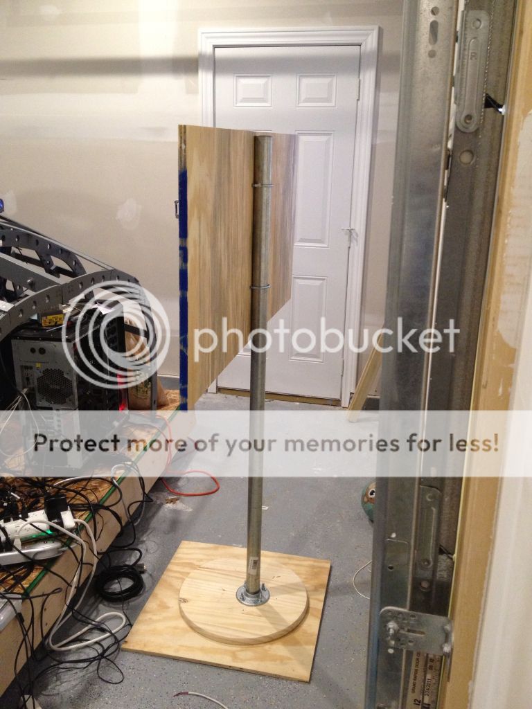

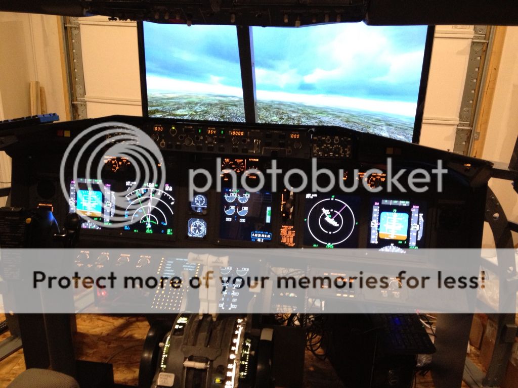

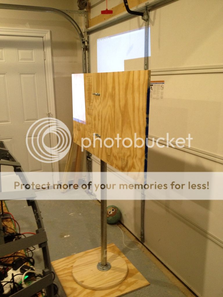

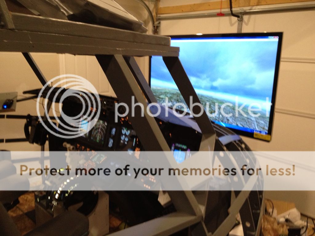

So Scott, like this?
Really ingenious idea, gotta hand it to you!

A little off thread here, but I noticed in your pics the power cords you're running and how you have a long extension cord with a power strip, and then you have another power strip plugged into it. And, in your last power strip you have multiple items plus some power blocks (wall warts). Well, that is exactly what I use to do and I melted two power strips, as well as I had brown melting spots on the power blocks.
Plus, I used to do several extension cords in this manner because I only had 3 outlets (1 outlet on 1 circuit and 2 outlets on another circuit) at the time. Anyway, I will never do things like that again; especially, because the melting actually melted the fire rated carpet (not easy to catch fire carpeting) underneath. It happened when I wasn't home no less...scared me into adding a 100amp subpanel with 12 circuits (11 are 20amp each for the sim and 1 is 15amp grounded for outside pole light).

Awesome.  Thanks John.  Yes, we spend enough money on everything that I figured I didnt need to spend $400-500 each on a bunch of crappy Chinese made stands that probably arent anywhere near as solid as these Home Depot McGuivered specials.... ;)
Looks like your all set!!
BTW - for the heck of it I tried FSX/Wideview this morning and looked really good!!!.....Until it crashed  :huh:   Just sayin......
Scott, they work really well.  Still going to find a way to further brace them when they are all installed.
John, that's just for testing.  I have two dedicated 20 amp circuits for the sim.  Most of those wall warts go away as well as I'm wiring the 12v to the PC power supply (SYS cards, LED lighting, etc).
Good point though!
